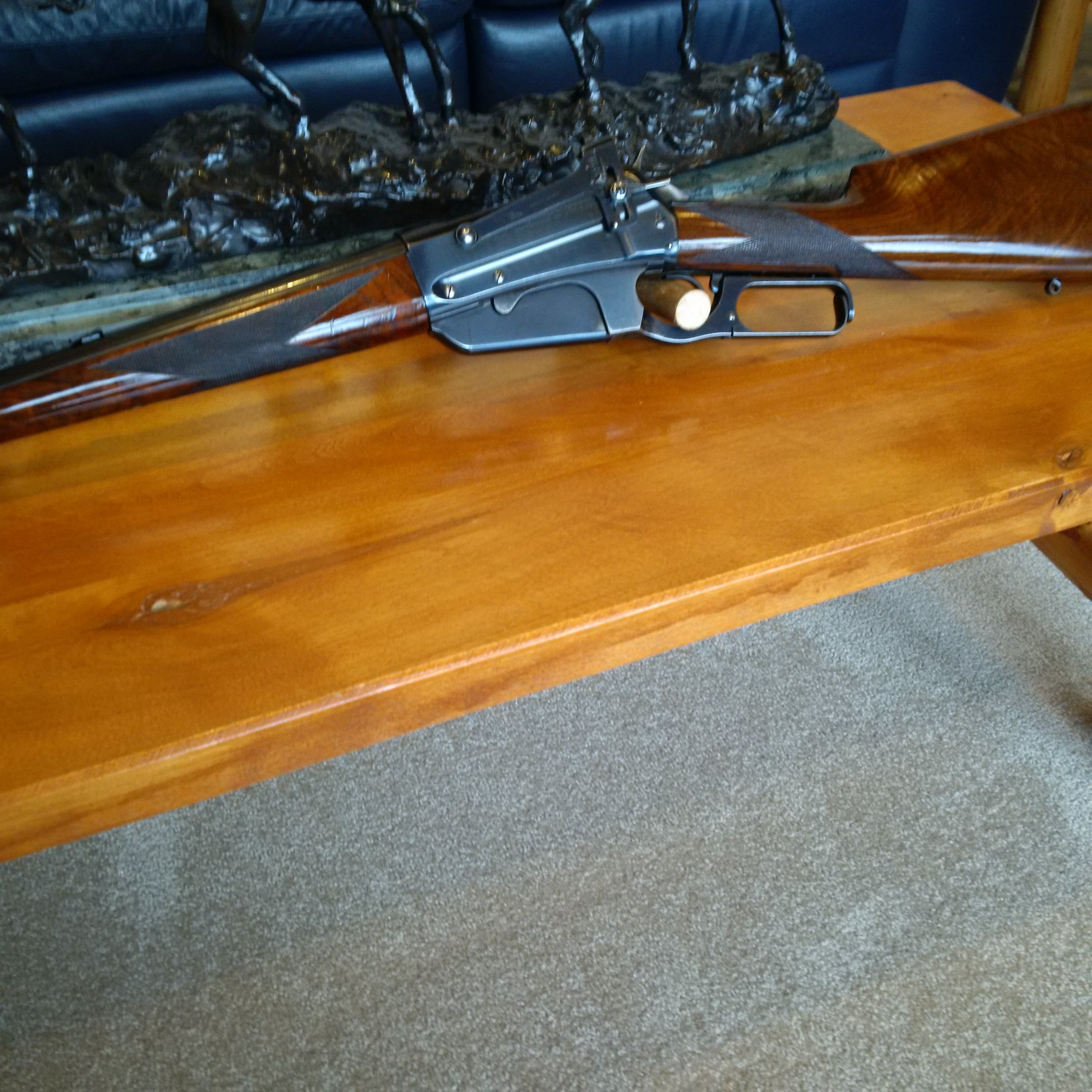

Indeed, this is not the only problematic firearm in Mr. Bentley’s collection. The following Winchester 1895 has a couple of serious originality issues not addressed in the description and one issue that is erroneously addressed:
https://jamesdjulia.com/item/53091-211-402/
The first issue is probably rather obvious to most Winchester aficionados.  The sling eyes aren’t factory Winchester pieces and don’t even appear to be of the same vintage as the rifle.  They also don’t appear in the letter.
Secondly, the Lyman 38 receiver sight is misidentified as a Lyman 21 sight.  This may not seem like a big issue, except the model 38 sight wasn’t patented until 1899, so it couldn’t be original to a rifle manufactured in 1896.  It also doesn’t letter with a receiver sight.  Although many Winchesters don’t have the sights noted on the letter, it should be of the correct vintage to be considered original to the rifle.  To say the least, it would likely be a difficult and costly task to find a correct Lyman 21 with finish to match this rifle.
In my humble opinion, the description for this rifle as it relates to the checkering borders on fraudulent.  The checkering is described as “H-style checkering”, but acknowledges that the factory letter specifically notes, “not checkered.”  They go on to explain this inconsistency by saying, “This appears to be a misinterpretation of the records or oversight in record keeping.”
It is common knowledge that there were mistakes and oversights in the factory records.  Add to that, the fact that it would be unusual for a beautiful deluxe rifle like this to be produced without checkering and, at first glance, this explanation seems plausible.  The problem is that the checkering on this rifle is not “H-style” as the description claims.  It appears to be a custom style not offered by Winchester.  I have a couple of checkered 1st model 95’s and discussed this with a couple of other collectors who have checkered 1st model 95’s.  All agree that the checkering on this rifle is substantially different than on ours.  A web search for other checkered 1st models and referring to Started47‘s picture of a beautiful rack of deluxe 1st models on this forum confirm that this is a custom pattern.
To believe that this rifle was factory checkered and that the letter erroneously states it is “not checkered”, the checkering would at least have to be of a known factory pattern.  It’s a shame that is was not left as it letters, because it would likely be a unique combination of deluxe, pistol grip, uncheckered, crescent butt.
It is certainly a beautiful rifle and Mr. Bentley may have known its flaws and added it to his collection anyway.  After all, not all collectors are hyper vigilant about originality.  But it is definitely not appropriate to offer this rifle as correct at auction.  Especially going so far as to claim that the factory records “appear” to be in error.
I don’t mean to disparage Mr. Bentley’s extraordinary collection.  The vast majority of the guns look right to me.  However, there are at least a couple of suspect guns being offered.  My advice would be to carefully research any of the guns being offered and don’t take the descriptions at face value.

Yes, this M1895 would have been a wonderful and striking (with greater rarity) rifle if left alone.  In my mind, it is clear this rifle was specifically ordered without checkering.  Particularly given the checkering on it does not match a known pattern.  The factory letter is very clear to me on this point, and I would not interpret it any other way.  I also do not trust that the checkering addition, when it was done, was done, “honestly.”  Had this rifle been left alone, I would be lusting strongly for it.  I suppose the good news for me is that I have no desire for it.

The beautiful 1895 Mark discussed is rather troubling. If they actually believed the letter was a misinterpretation they could order a new letter. Bentley did indeed have a spectacular collection but not every item is spectacular. I agree that Bentley may not have been overly concerned with originality but I expect better from the folks at Julia.

Great discussion guys, I too agree that 1895 deluxe is suspicious with reference to the not checkered note in the letter. And the fact that the checkering is completely different then any 1895 deluxe I’ve seen. A gun in this sale (Lot 2055)the Cody letter states it’s a 45-70 and the gun is a 45-90. After looking at the photos I’m convinced this is a lagitimate arror made in the original recording at Winchester. As a collector I can except this kind of discrepancy but not some of the other stuff we are seeing.

What bothers me the most is the attempt by Julia to legitimize the checkering or lack of it. Don’t get me wrong, I really like the 95 but as Gary said, the checkering is not the Winchester H style pattern as we know it. It is certainly a professional and well done job and was probably done a long time ago – maybe when the gun was new. The original owner may have ordered it without checking as noted in the letter with the specific intent of having it checked in a pattern of his choice (non-factory). The attempt by Julia to BS prospective buyers does not sit well with me. Burt
