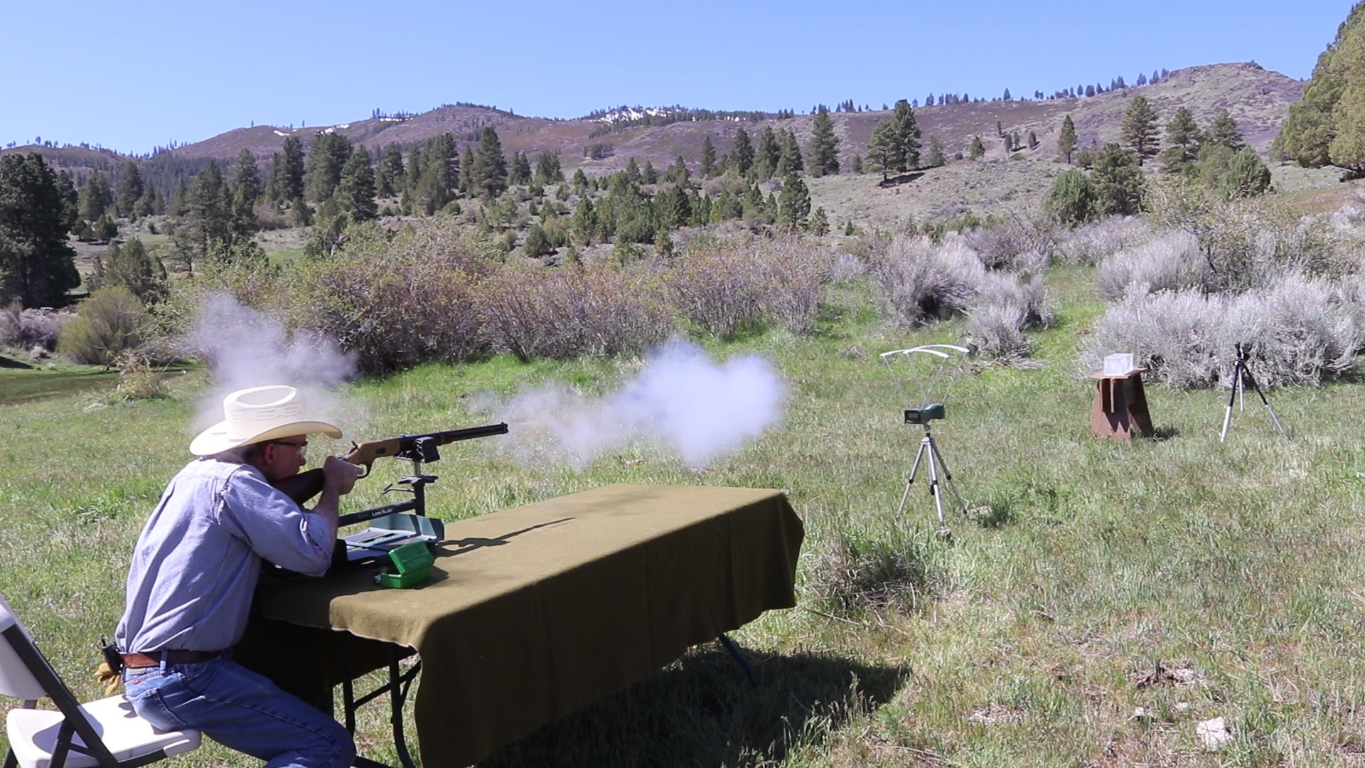

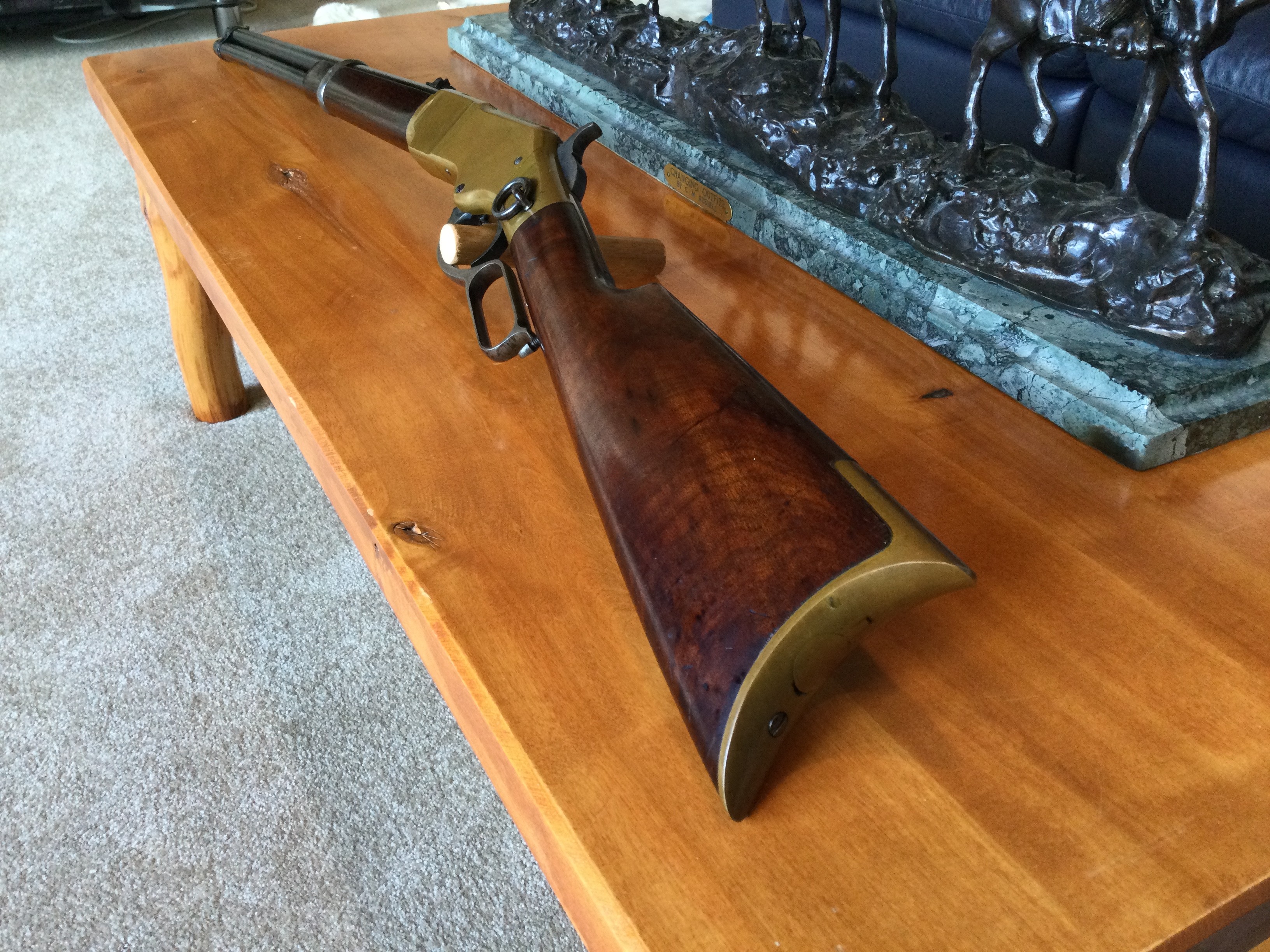

Believe it or not, my wife recently acquired that 1866 and encouraged me to make the video.  I married far above my station. Laugh
Just yesterday, I loaded up some black powder cartridges and did some more shooting with it.  Mark

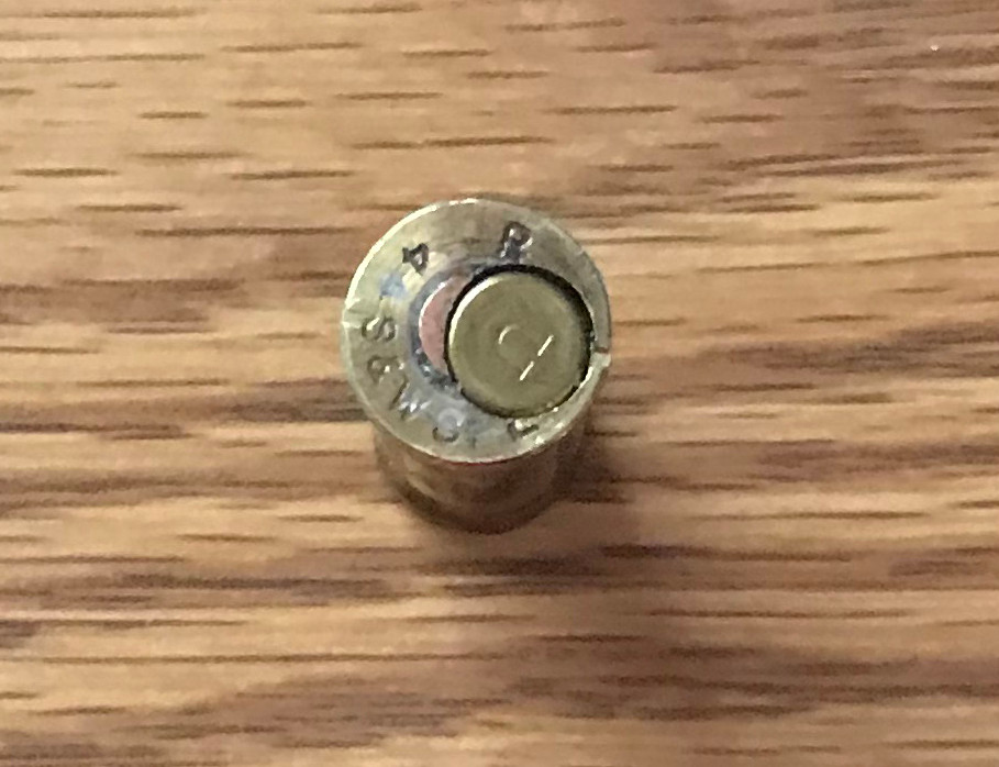

Bob, you didn’t post the link.  You used to be able to buy loaded ammo that used the blanks.
You can make the ammo yourself once you modify some cases or buy a couple parts and modify them.  S&W 44 SPL or Russian cases will work.  They have to be shortened.
If you don’t mind single loading the cases you can have the primer pockets filled.  I’m not sure if it is done by brazing, soldering or what?  Then you drill an offset hole for the blanks.  After firing pop out the blank and start over.
Or buy a new firing pin and the striker and modify them.  Grind the pins off the striker and have a pin inserted in the end of the firing pin.  This will allow you to shoot center fire.  It is extremely important to get the new pin the correct length so you don’t get slam fires.
I use a die from Lee Precision to swage down 45 ACP bullets to .443″.  Then I heal the bullets.  I don’t have a die so I squeeze the seated bullets by pushing them into a chamfered hole of the proper diameter.

April 7, 2026 - 10:35 pm
I went through my pics and don’t have one of the striker?  But here is one of a modified case.

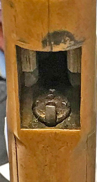

But here are some pics showing the bolt face of an unmodified rim fire and a modified to center fire.
On the top is an original 66 RF bolt face.  See how it is flush.  The second pic show the conversion to center fire.  NOTICE that the bold face is raised to alleviate the excessive head space.

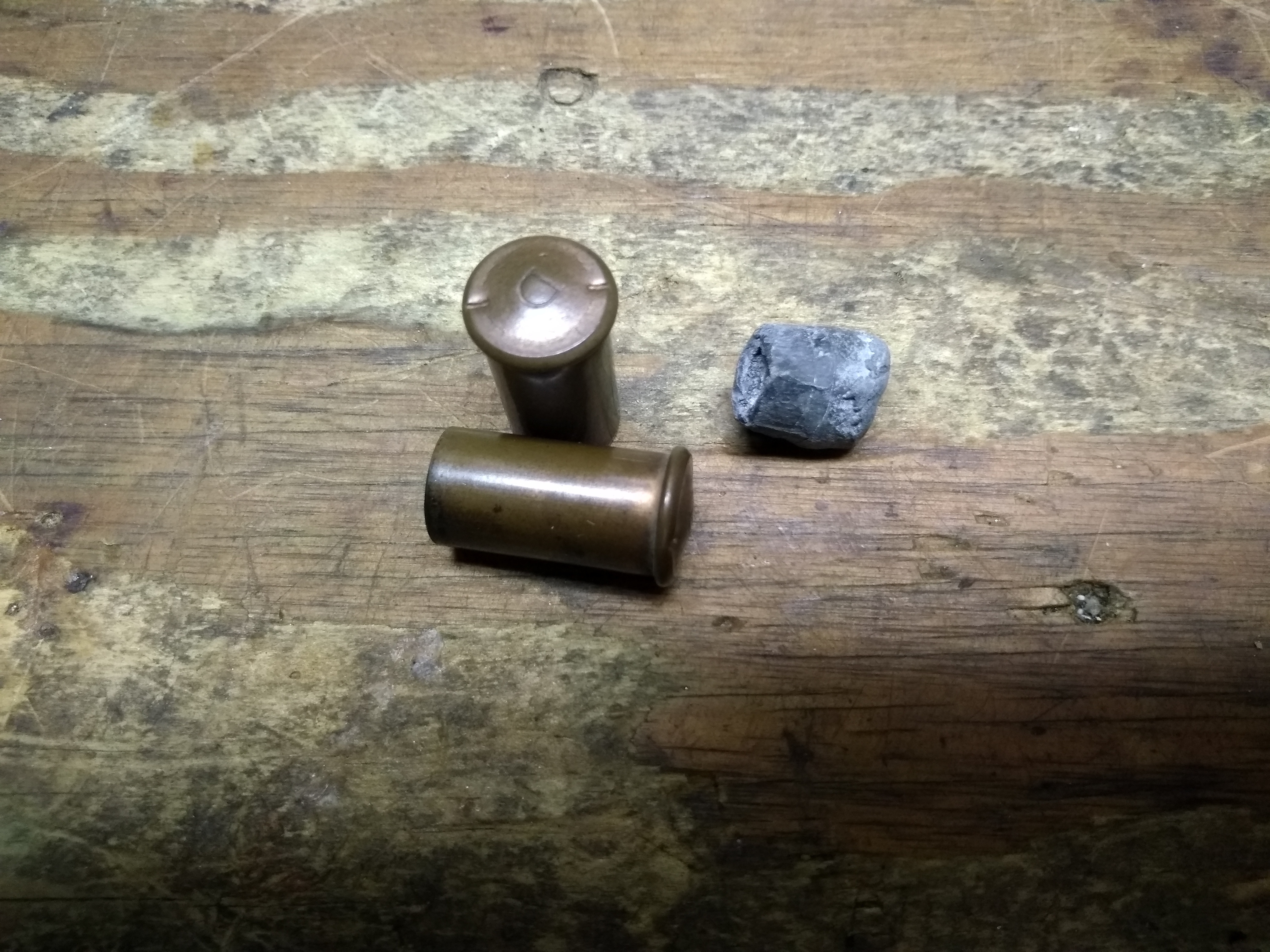

80
April 10, 2026 - 5:54 pm
Here are the bulged cases from firing in my 66.
