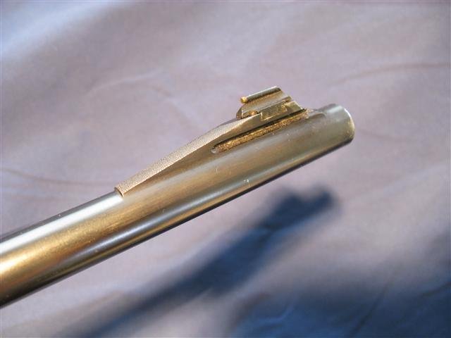

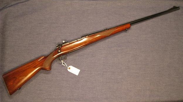

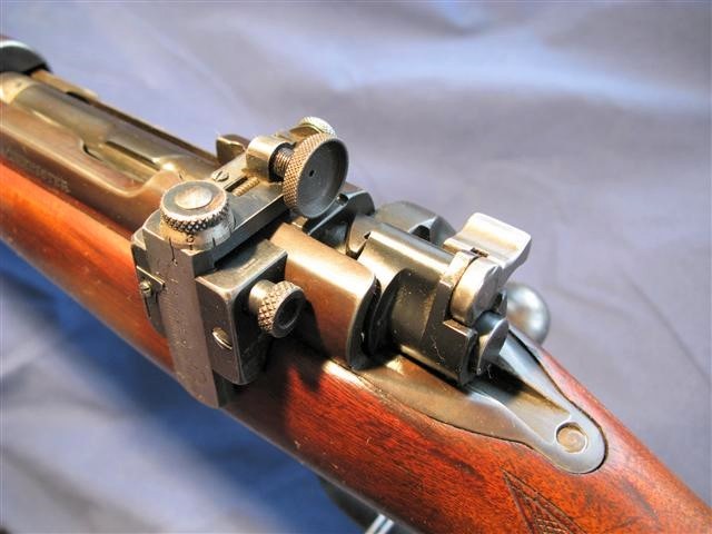

A few pix below of my 1935 vintage Model 54 Standard Rifle as illustration.R440-2U.jpgR440-16U.jpgR440-4.jpgR440-9U.jpgR441-6U.jpg

Hi John-
Thanks for photos.  Good illustration of what a M54 22 HORNET with factory Lyman 48W should look like, including the integral ramp and correct Lyman 31W front sight.  Because the Hornet was added in 1935, in standard grade it only came with the “NRA standard stock” like yours, not with the slender schnable tipped fore end that characterized the M54 First Standard rifle (the stock I think most people associate with the M54).
The Lyman 48WJS was, I think, first available in 1936 and one might (???) have found its way onto some parts clean-up M54s made at the very end of production (???), but the 48W on your gun is the right factory receiver sight.

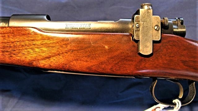

Forum Posts: 1537
March 8, 2020 - 5:13 pm
Hi Steve-
The first one (Shooting Investments) looks legit but obviously well worn.  The disproportionate wear to the bottom metal is typical of M54s.  That one used to have a Lyman 48W sight on it, hence the “T” shaped inletting for the long slide receiver sight.
The second one (Custom Shop) looks to me like a fairly nice restoration.  The metal has certainly been redone.  Even the most mint condition original survivor doesn’t have that much blue on the floor plate.  The Unertl scope is a nice touch but is notably later than the rifle itself.
The third one (also Custom Shop) is a nice G&H upgraded gun.  The stock is upgraded, the G&H side mount added, etc.  At least it’s described as what it is, and it has the correct Lyman 48W that’s missing from the first gun.  The period Zeiss scope is a nice touch.
