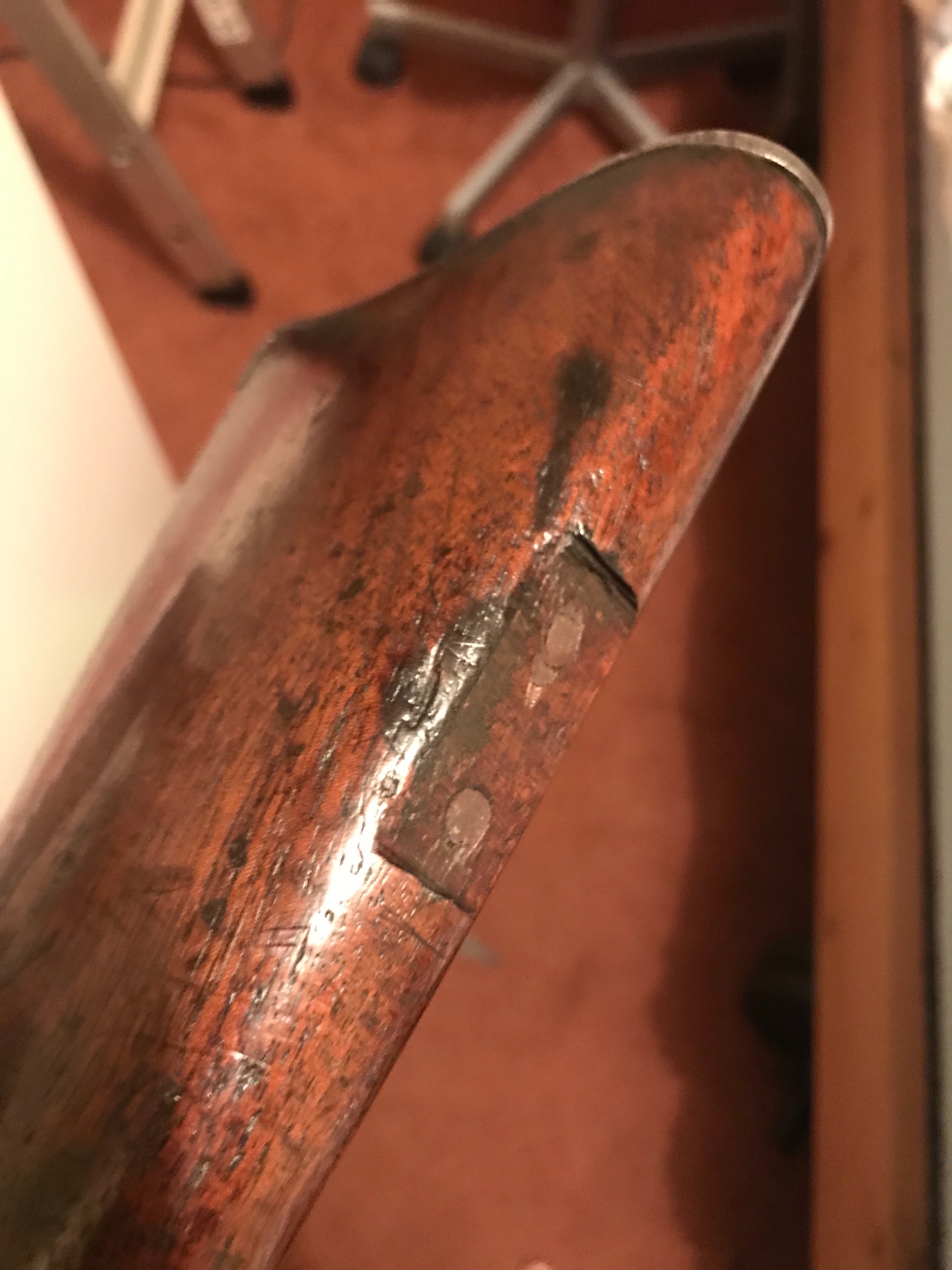

Hi folks
Here is a picture of the sling attachment point (missing) on the stock of my 1873 2nd model. Im assuming this was  fitted post manufacture – am I right? Wondering whether to leave it or find a period sling attachment of some description.

 Judging strictly from the picture you are right. If your gun is original otherwise, I would fix it. Does it letter with sling swivels? A wood craftsman can graft a piece of wood with matching grain and darken the wood to cover, it’s still there buy not obvious. Do not putty it! Is there a front swivel and is it original? T/R

Thanks. No evidence of swivels elsewhere, letter does not mention swivels at all. I’m inclined to find a good craftsman to get it put right.

The notch was not cut by Winchester.  It is far too crude to be factory.  I don’t remember swivel bases being rectangular?  Someone with a lot of walnut could find a piece that might match. After installing the new piece sand the entire belly just enough to blend the new area with the rest of the stock. Experiment with stains until you get what you want.  You can apply the new stain to the entire stock (over the existing finish) to help blend the whole piece.

Thanks, planning to get it fixed. Far as I can tell the rest of the gun is original or near original – that big chunk of stock missing stocks out a mile!

Just don’t get your hopes up that it can be fixed and not be able to tell. Grafting in wood does show.

Maybe better to take the Japanese route to repairs and not try to hide it.  Maybe shape and fit a piece of copper and use the filled holes to attach it and be proud of the guns history.

That’s an interesting idea – it has some appeal. Thanks for the input!

Stock appears to have been refinished at some time, little to lose by grafting in a bit of similar walnut and blending in the finish. My shooting buddy has the patience of Job and his grafts are hard to spot unless he points them out. I believe he has an old walnut stock that his “patches” come from.

Believe me it can get done.  Ask Bert, he has seen a shotgun that I did.  One side and the belly are perfect the other is pretty close.  I hand select the wood to match the grain as best as possible.  I also know how to add grain so the original part will blend with the new piece.  Actually the staining and finish matching is the hardest.  Even a somewhat bad patch will look better than it does now.
