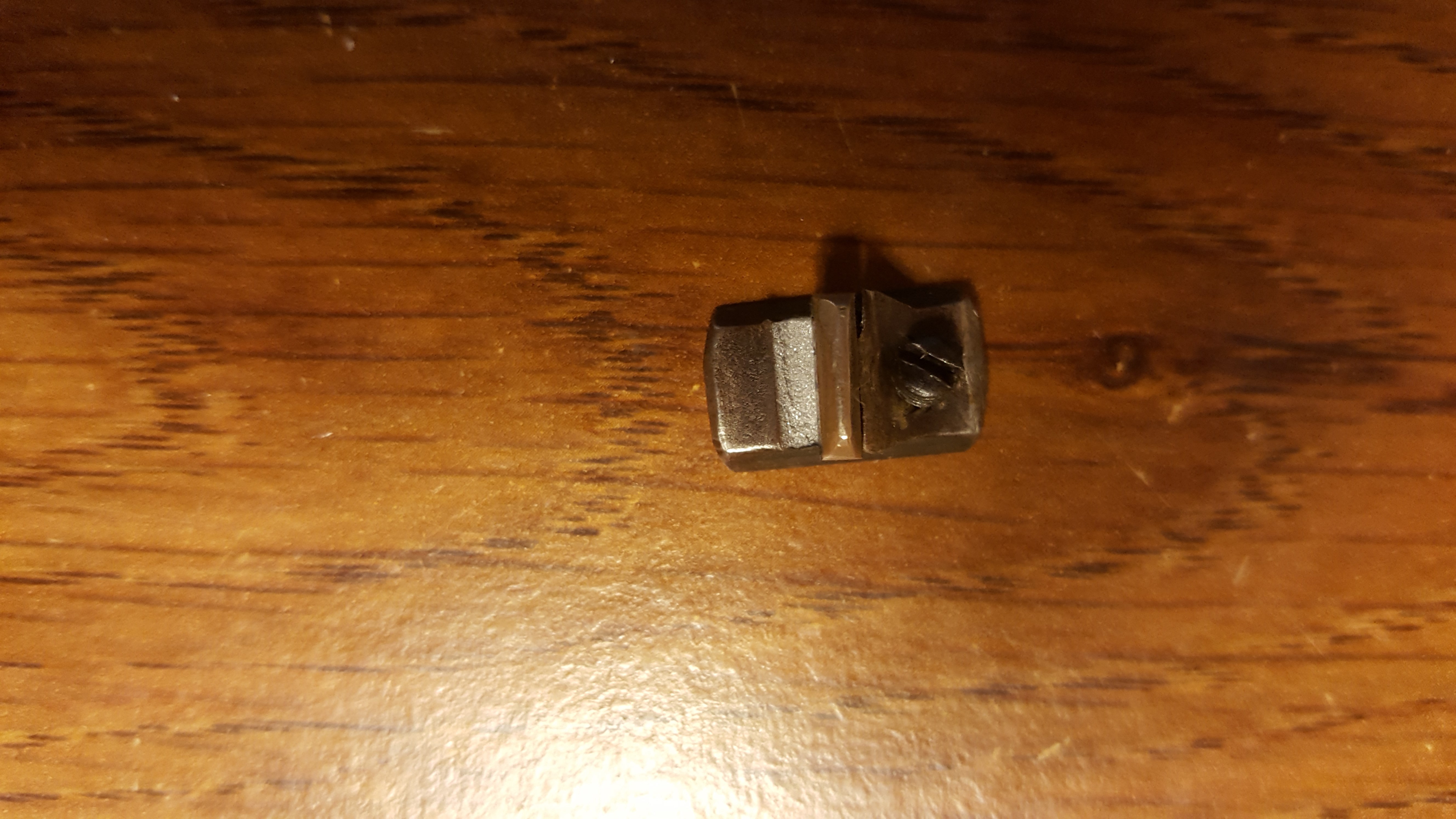

May 12, 2017 - 2:33 am
1873_Front_Site.jpgI received the correct semi buckhorn rear site, I am good there now. However in trying to remove the front site with a poly punch the front site broke, unfortunately an expensive mistake on my part as now I am on the hunt for a new font site. Attached is what came with the rifle and I am assuming even though the rear site was not correct that the front site is correct for a Winchester 1873 32-20 caliber rifle that was manufactured in 1903.
Phil
Forum Posts: 4990
May 12, 2017 - 2:52 am
Phil,
 I use a brass punch on sights. Just a reminder, the sights are removed tapping them to the right hand side of the gun.
