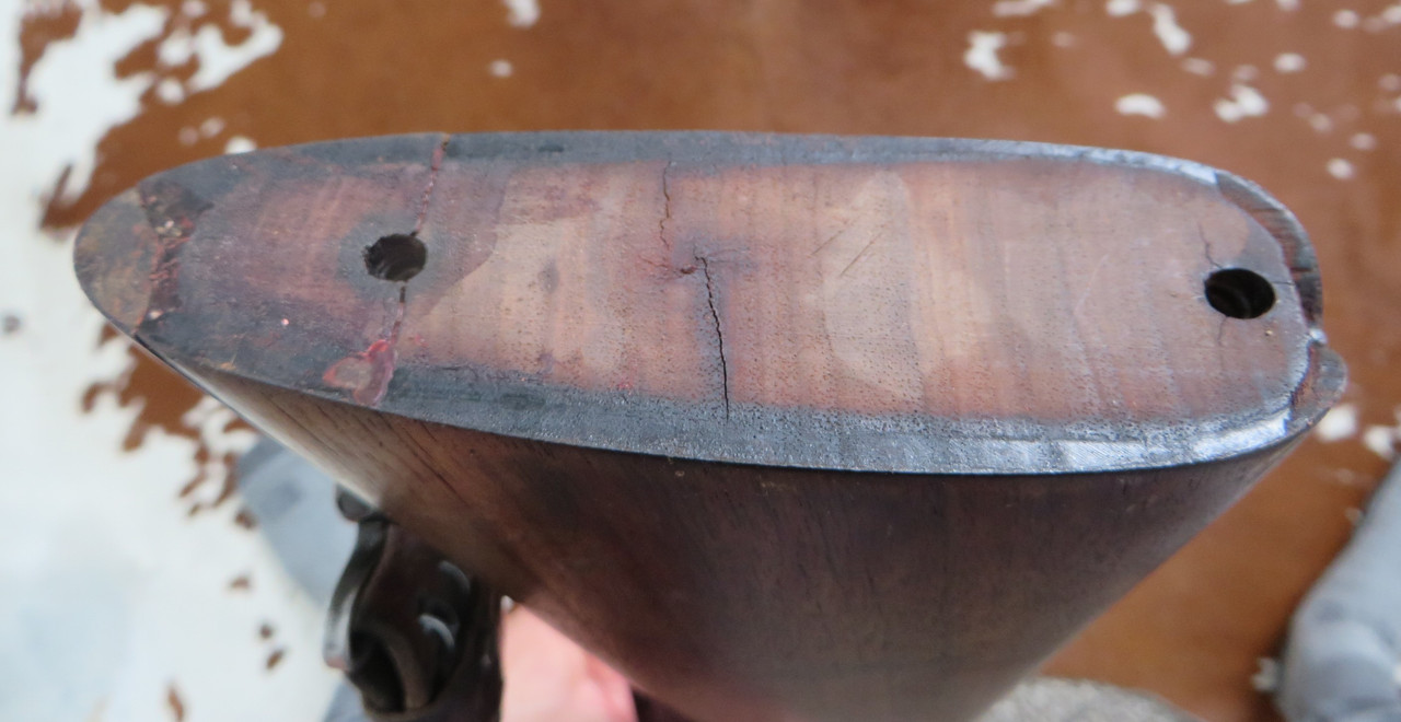

OK, I will remove the butt plate and take a look and add photos.

I removed the butt plate and here are photos…..certainly looks like it has NOT been cut based on the wood stain along the edges.
Looking at the grain of this wood, it’s no wonder that it cracked the way it did!
Thoughts??

Your stock hasn’t been cut.

I concur, and that is precisely why I asked to see what the end grain of the stock looked like.

Thanks again to everyone for helping me with the stock questions, I am pleased to learn the stock has not been cut!
My guess is the way the grain is on this butt stock the cracks may have been inevitable.
