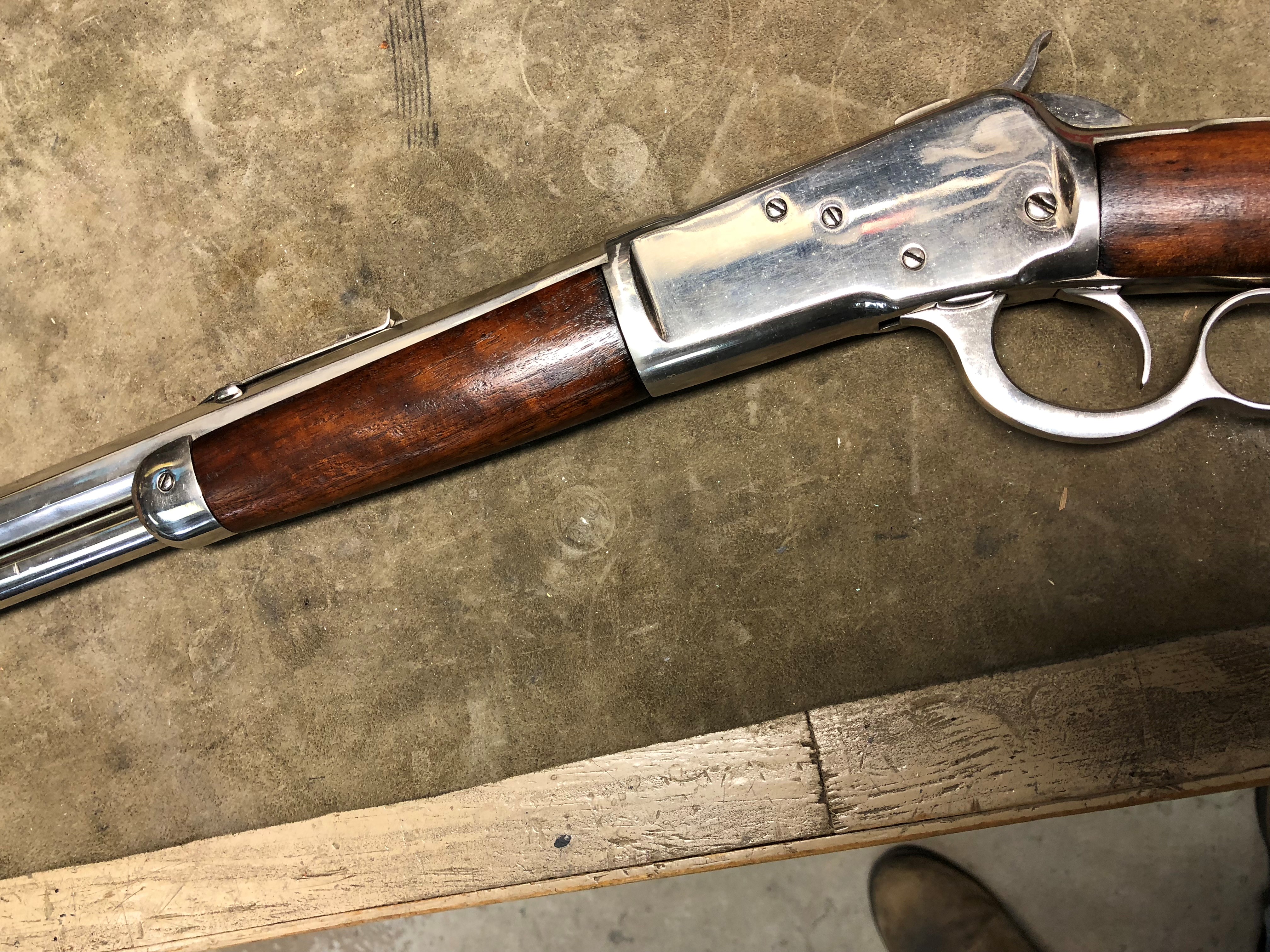

A nice fellow I know came by for a CCW renew today and pulled out a rifle that he knew I would like to see. He had a 92 that was nickel plated and a 12″ barrel. I told him right off I thought it was a cut off standard 92 oct barrel in 38-40. He said he had talked with Jessica at CFM and she thought it was legit and ordered a letter which says nothing about nickel or short barrel. He said he has talked with the ATF and they told him it was “grandfathered” in.
My question…… can this be legit with nothing in the letter about it being short? SN 268228
I have plenty of pictures of gun and letter if things go that far which I doubt.IMG_1730.JPG
Thanks, Charles

i’m not at the level of expertise as some of the members here…..but the rear sight looks to be too far forward for a 12″ short rifle?  Shouldn’t it be set back closer to the receiver?

No offense, but it looks horribly buffed and overly sanded/refinished to me.  Screws holes are dished out from over-buffing.  Wood to metal fit is bad.  Definitely not Winchester work, instead the work of bubba “gunsmith.”  If the letter says nothing about nickel or the short barrel, it’s been altered after-the-fact.

Like Don said, The nickel is not original because of the terrible buff job. My guess its not a original 12″. In the 73’s the shortest I heard of is 14″.

Jessica never offers opinions about the legitimacy of any firearms, and it is prohibited by CFM policy for her to do so.  Further, if the factory ledgers do not indicate full nickel plate and the 12-inch barrel, the odds are 99.999% that it is not original in that configuration.  I sincerely doubt that the owner spoke with the BATF about this gun.  There is no “grandfather” clause for a SBR under the purveyance of the NFA.  The only SBRs that are automatically exempted from the NFA are those manufactured before January 1st, 1899 (antique).

 Is it nickel or is it chrome? T/R

I would tell your guy to screw the barrel off until he gets it figured out.

Pretty much what I thought about the gun. I told him I would forward any info from you guys to him. As for the info I posted about CFM and ATF was just relaying what I was told.
