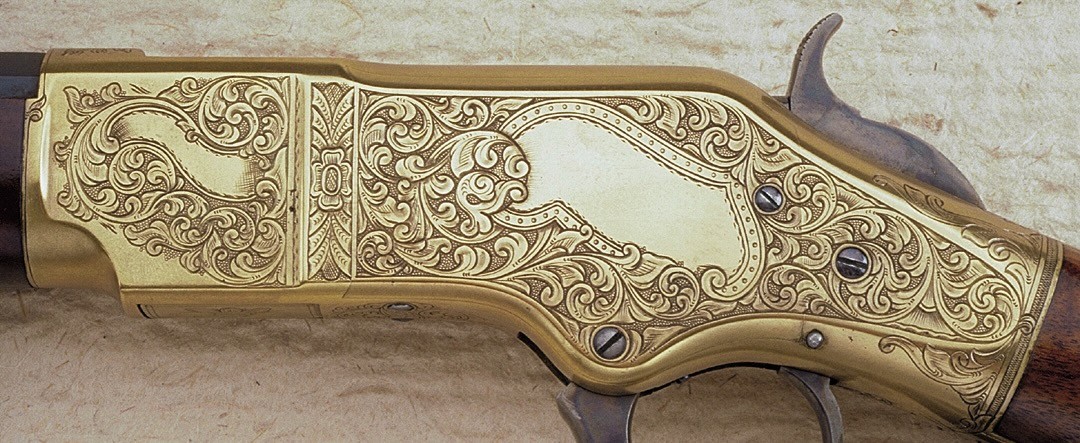

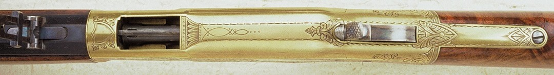

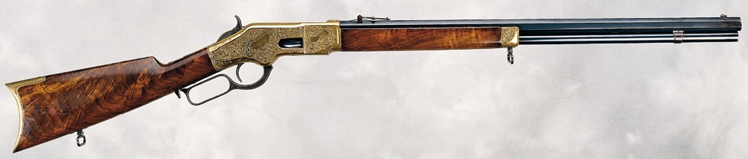

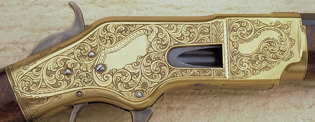

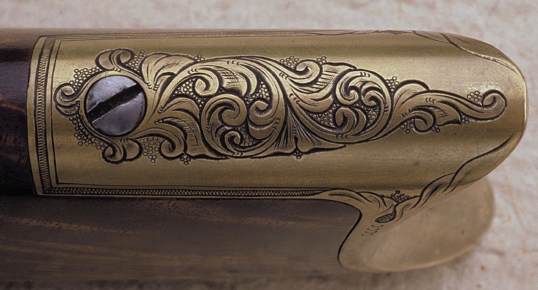

I’m hoping to connect with anyone who has deep experience studying the engraving work of L.D. Nimschke.

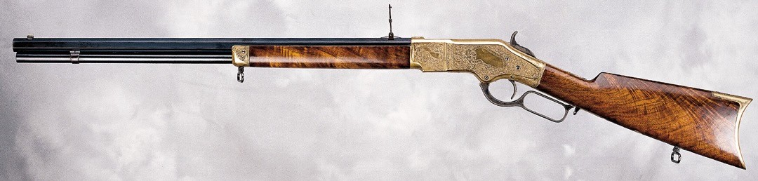

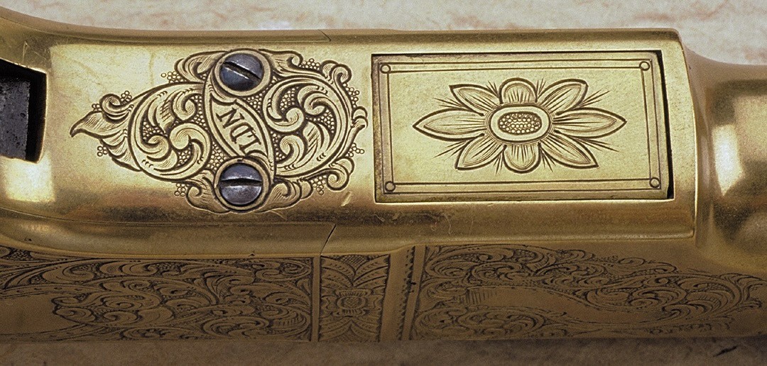

I was recently gifted a small collection of antique firearms and am working to document provenance and historical context for several of the pieces. One of them is a Winchester Model 1866 deluxe rifle with extensive scroll engraving and what appears to be an “LDN” signature on the Bottom of the receiver.
From what I understand, that mark is sometimes associated with Louis Daniel Nimschke, but I also know that attribution of his work can be complex and that some pieces were engraved “in the Nimschke style” by other hands.
A few details about the rifle:
• Winchester Model 1866 deluxe configuration
• Full receiver scroll engraving with punch-dot background
• Engraving also present on tang and forearm cap
• High-figure walnut stock
• “LDN” engraved on the top tang within scrollwork

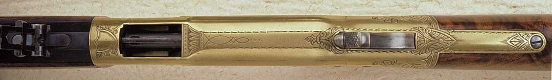

I have attached several photographs of the engraving and signature area.
I would greatly appreciate any thoughts from members who have studied Nimschke’s work closely, particularly regarding:
  1. Whether the engraving style appears consistent with documented Nimschke work
  2. Whether the “LDN” signature placement and letter form look period-correct
  3. Any recommended experts or references for further attribution work
Thank you in advance for any insights.

The first person I would ask about it is Pauline Muerrle who was a Winchester engraver. As a engraver she would have a good knowledge of the early Winchester engravers and does authentication of engraving. She authenticated a engraved 94 for me.

Thanks for uploading the pictures. It looks like a very well done and engraved piece. I’m no engraving expert, but it most certainly looks correct. That said, I would wait to see what Pauline’s opinion of the piece is.
If it is not a genuine engraving Pauline will certainly tell you. Nimschke’s work has been and/or is often faked as his original engravings are highly saught after.

Went thru the Wilson book he lists SN 72133 then SN 118353 but not your gun. It sure looks correct to me..Bill

I’m looking forward, as the others are, I’m sure, as to what Pauline has to say.
It sure looks good to me!

I can tell you, this is trying to appear to be Nimschke.
The design is close to a known plate, but has discrepancies.
The initials are not correct.
I would want this one in my hands for too many reasons to mention here.

Your gun was in a Butterfield auction in April of 1993.
You will need to take many high resolution pictures so Pauline can zoom in and see the engraving detail.

Reply from Pauline: “This gun was not engraved or signed by Nimschke”
So my question from here, what to do next? Is it worth spending any more time or money on it, or do I have her try to look up the serial number and just authenticate it’s date of manufacture, at which point, it’s just a nice old Winchester with some very cool engraving on it. Maybe it was done of someone with the initials LDN?

It’s just like Jeremy said, I would want to have it in My hands, plus a couple of others more knowledgable than I, to verify originality. Just by yhe pictures it certainly looks “to pristine” to be an original gun from 1873. It is a gun that would be in the value range where it entices “enhancment” by someone with that kind of ability. I am not offering any thing but My humble opinion here.

I think that at this point, you have your answer… it is a nice old aftermarket engraved gun.  “Who did it” is quite probably not worth the time and effort.

  You stated you were gifted this gun so no money lost. It’s an upgraded gun that will display nicely in a man cave, gun room, or the office wall. I would if it was mine do just that.
  You can figure out what’s it’s worth by checking out last weeks Poulin’s auction, Feb. 28th. They sold several upgraded 1866s, several engraved. They keep past auctions up on their web page so anyone can see. The descriptions were very honest.

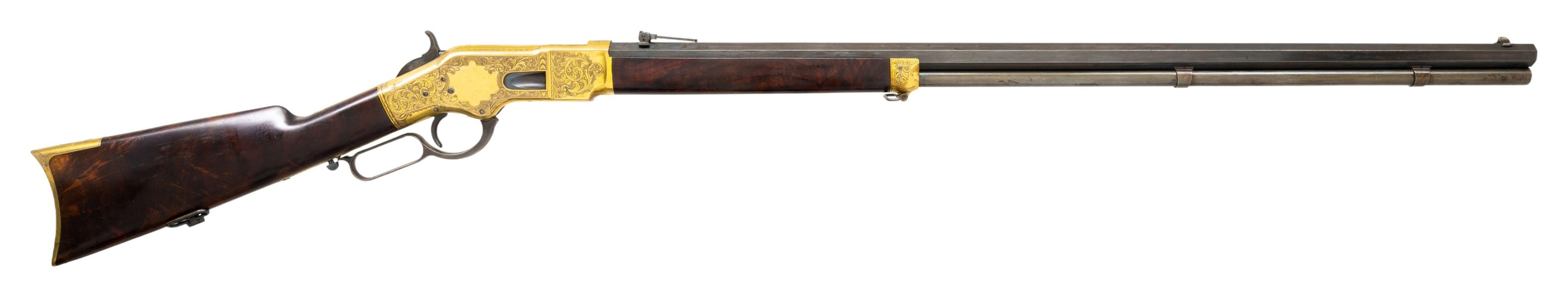

I just wanted to say thanks to TR for the Poulin’s Auction lead. It turns out they sold a gun that is nearly identical in style, quality and finish to what I have in my hands.
https://www.auctionzip.com/auction-lot/impressive-custom-extended-barrel-engraved-early_c7299d36d1
It would have been amazing if it was a real Nimschke, but hey, for a free gun, it’s not worth “nothing” and its a gorgeous piece to look at!EXAMPLE0-Comparable-Winchester.jpg

 I think the comparison is a bit of an apples and oranges scenario.  Your rifle presumably has the original barrel and the Poulin rifle has a custom after-market barrel added.  If the only alteration to your rifle is the added engraving, that may make a difference in what it’s worth.
