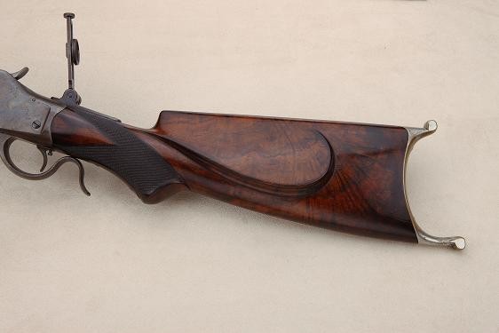

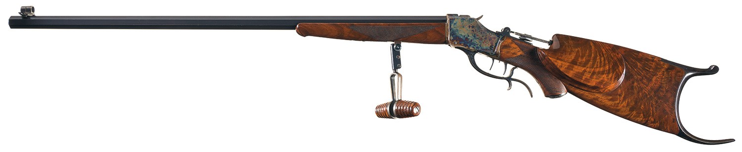

Bob,
You were very close.  In the Single Shot records, “SB” is the abbreviation for Shotgun Butt.  When a Swiss butt was ordered, they listed it as “Swiss butt” or “Swiss Plate” (see entries 83, 85, and 88).
It is very common to see sights recorded in the Single Shot records, unlike the lever-action models.
The “Dutch cheek piece” entry was very common for the Schuetzen Rifles.  For the Special Single Shot Rifles, the entries usually read “Swiss butt & cheek piece”.
