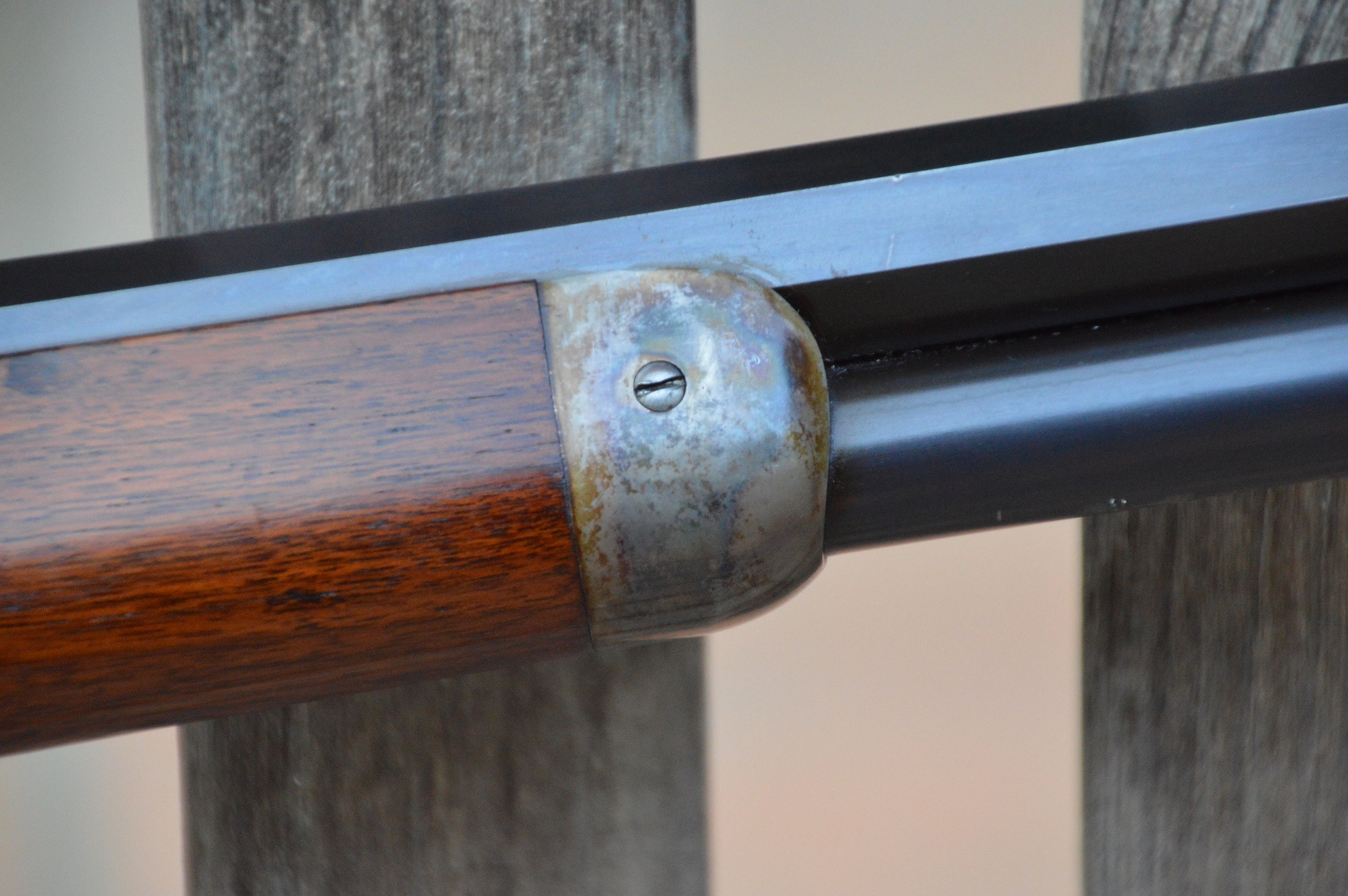

A short while back there was a thread or comment about the subject of Winchester using a clear lacquer (?) finish on color case hardened (CCH) parts.  Attached is a photo of the forearm end cap of a CCH Model 1886.  Is the yellow-brown scum the remnant of this coating?  The receiver shows no sign of any coating or it’s there and completely intact and not yellowed…OR more likely, I just don’t know what I’m talking about!

More than likely, it is old dried gun oil.

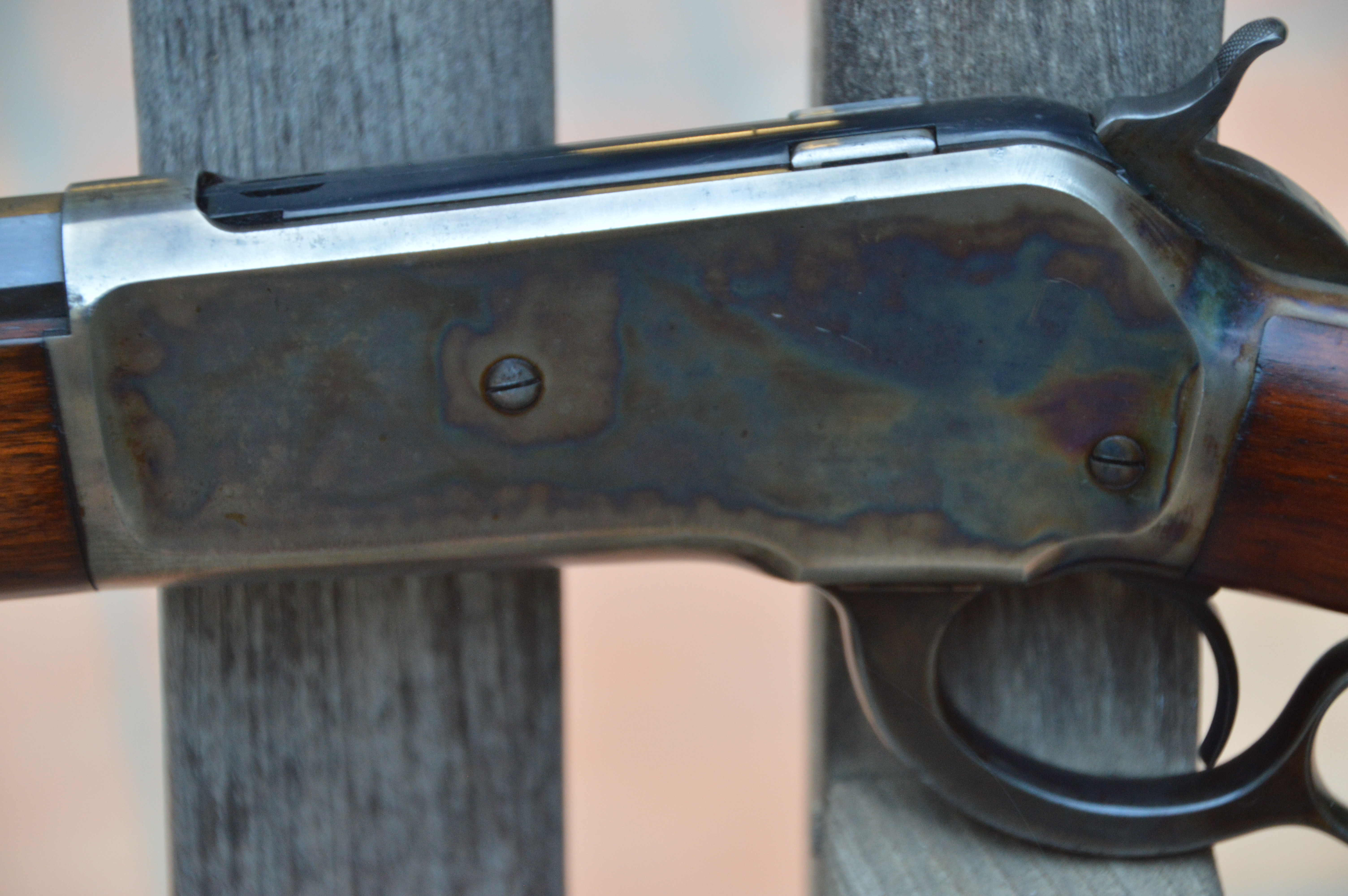

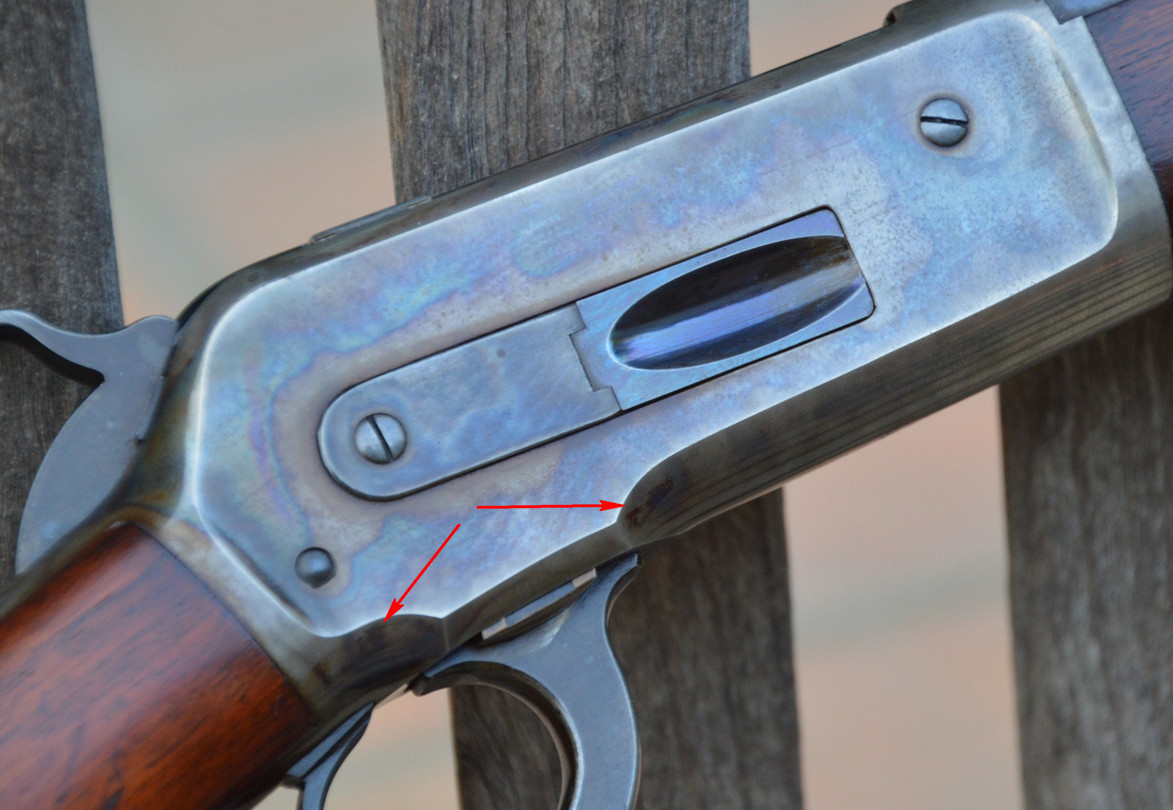

I pointed some spots on the side of the receiver which are the coatings we were talking about in the 86 thread (case-hardening-86)
I have seen forearm caps like that many of time and it is a coating but its not dried oil. When I get home this weekend I will see if I have some like that and take photos.

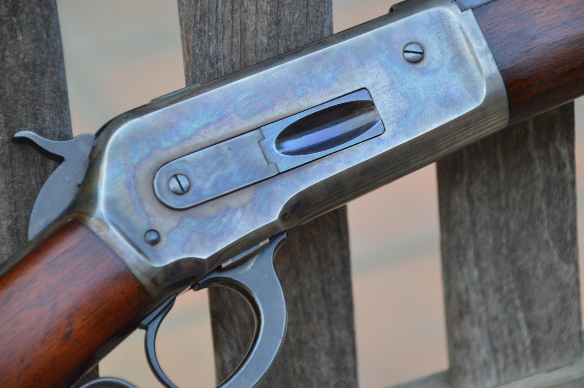

I do agree with you on that. I can’t say with 100% certainty that it was done at the factory just like Bert can’t be 100% certain that Winchester didn’t do it until you find written proof. I’m basing my assumption on that I have seen many of cased guns with this same process done to them and they all looked about the same. If this process was done by different individuals I think you would see a wide range of workmanship. I’m 100% certain its not dried oil since its has a smooth shine to it and you can see through it and its always on high condition guns where the they were taken care of and you don’t see it on the blue parts. Dried oil is always in the protected corners were the rag can’t wipe the excess oil away. That is a topic for another discussion why people feel the need to remove the seal of originality (dried oil in the corners) from the gun.

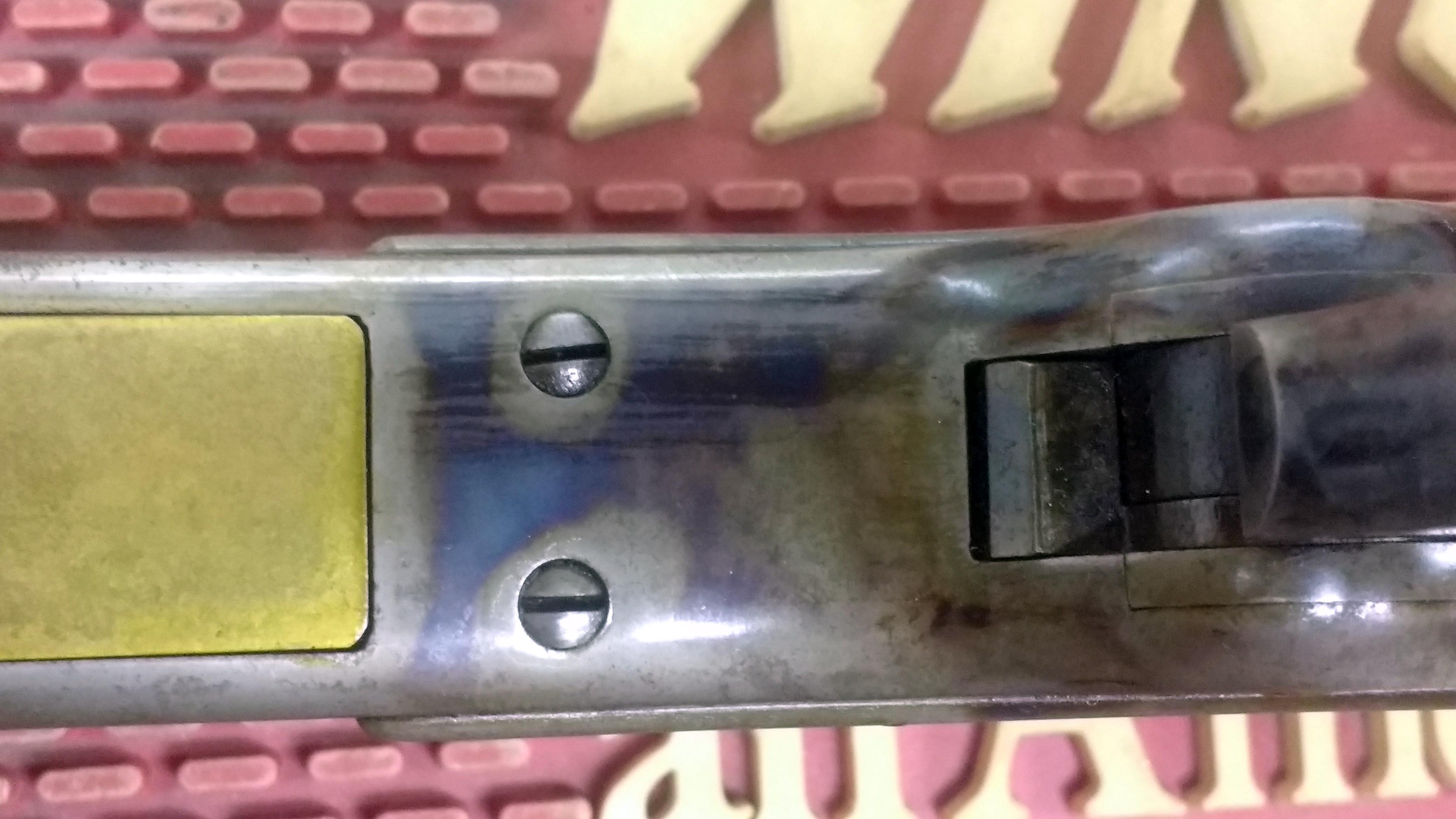

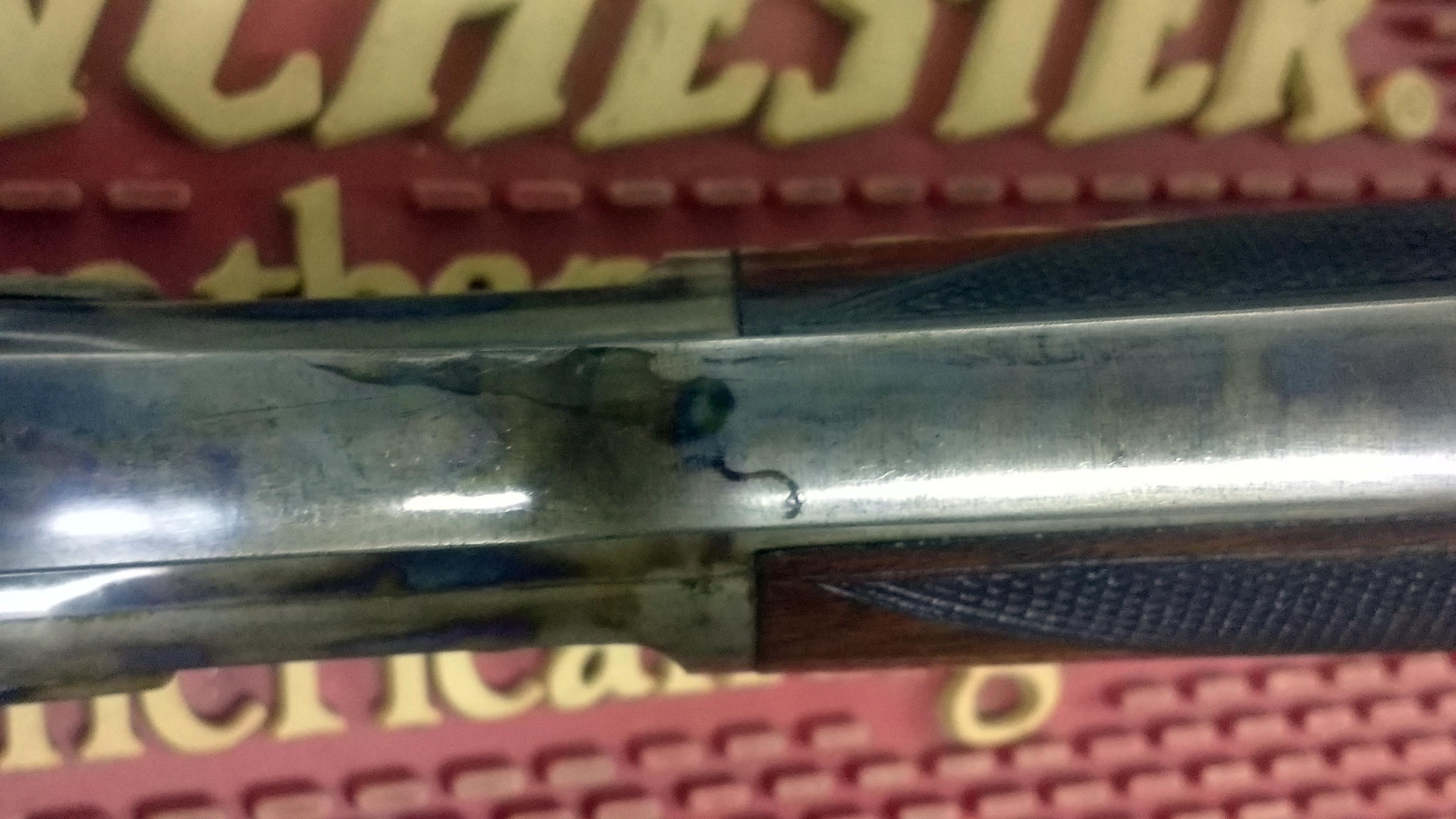

Here are a few more pictures from the same gun. The interesting one is the lever, it has a run of the coating on it.
September 9, 2017 - 6:56 pm
Bob,
That “run” in the clear coat is just another clue to me that it was not Winchester that applied it.

I think this will be one of those items that we can’t prove one way or another but one thing it proves that its not dried oil.
