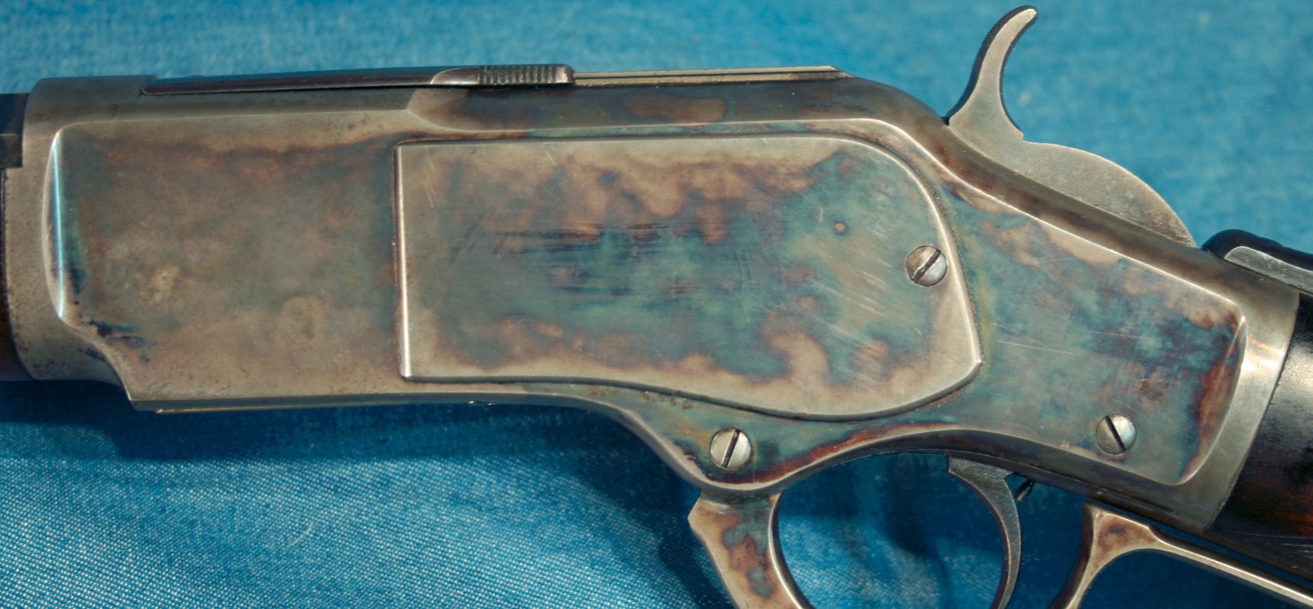

Here is one of mine that shows the affects of the lacquer or varnish protecting the colors.
Wincacher
New Mexico
Forum Posts: 1167
December 1, 2012
August 30, 2017 - 3:15 pm
There ought to be a better way to preserve the case coloring without clouding over it.  Is that a factory applied coating, Bob, or as they say now, “after market”.
Forum Posts: 4995
August 30, 2017 - 3:24 pm

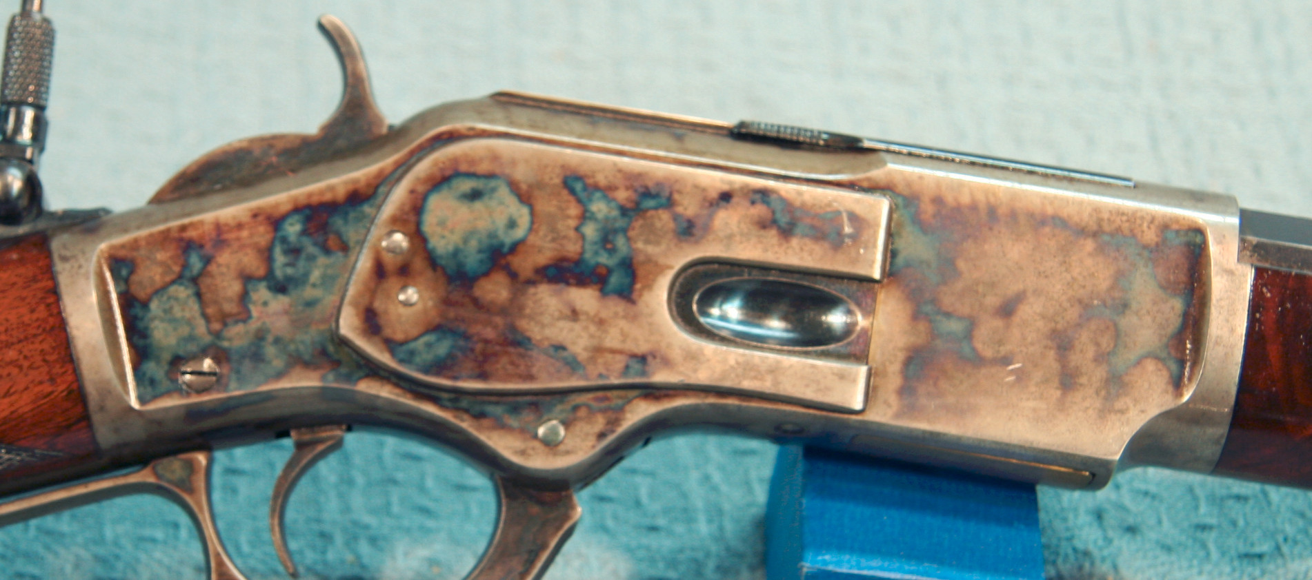

That is factory coated. I’ve seen that on many case colored guns now and it all has the same look to it. Here is another and if you look right behind the loading gate you can see where the coating starts
Good looking 73 receiver!!!!

That gun has the most case of any gun in my collection. The gun is kind of rare, the other side has a monogram.
