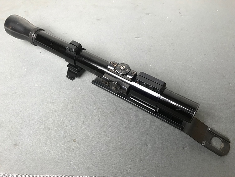

I do not know much about these early Lyman Alaskans.  The one I have has an aluminum tube and steel ocular bell.  Picture below is of the scope, which you can tell I am currently using to hold together a Miller Kodiak Dreamount (a true Rube Goldberg contraption from the ’40s that was billed as a ‘universal’ no-drill scope mount):
Looking closely at the markings on the scope (using my 3X Optivisor on top of my bifocals) I can make out a VERY TINY stamped number on the tube (behind the word ‘ALASKAN’ in the location where the easier to read serial numbers were stamped on later Lyman scopes).  Even with all the magnification I can readily bring to bear I cannot be sure, but I think is says ‘490’ stamped very lightly with individual number stamps (so numerals are slightly misaligned).
#867 is the number on mine–hand-stamped in echelon. Required a 5x glass to make them out.  This one has old leather lens covers that wore off the anodizing on the objective end; nothing to be done about that.
Intended to remove ocular lens to clean the inner surface, until noticing that, rather than being retained by a tube-nut, it’s burnished in, a method usually seen only on lower cost optics.  No doubt Lyman employed a special tool to remove it, but not possible without it.
