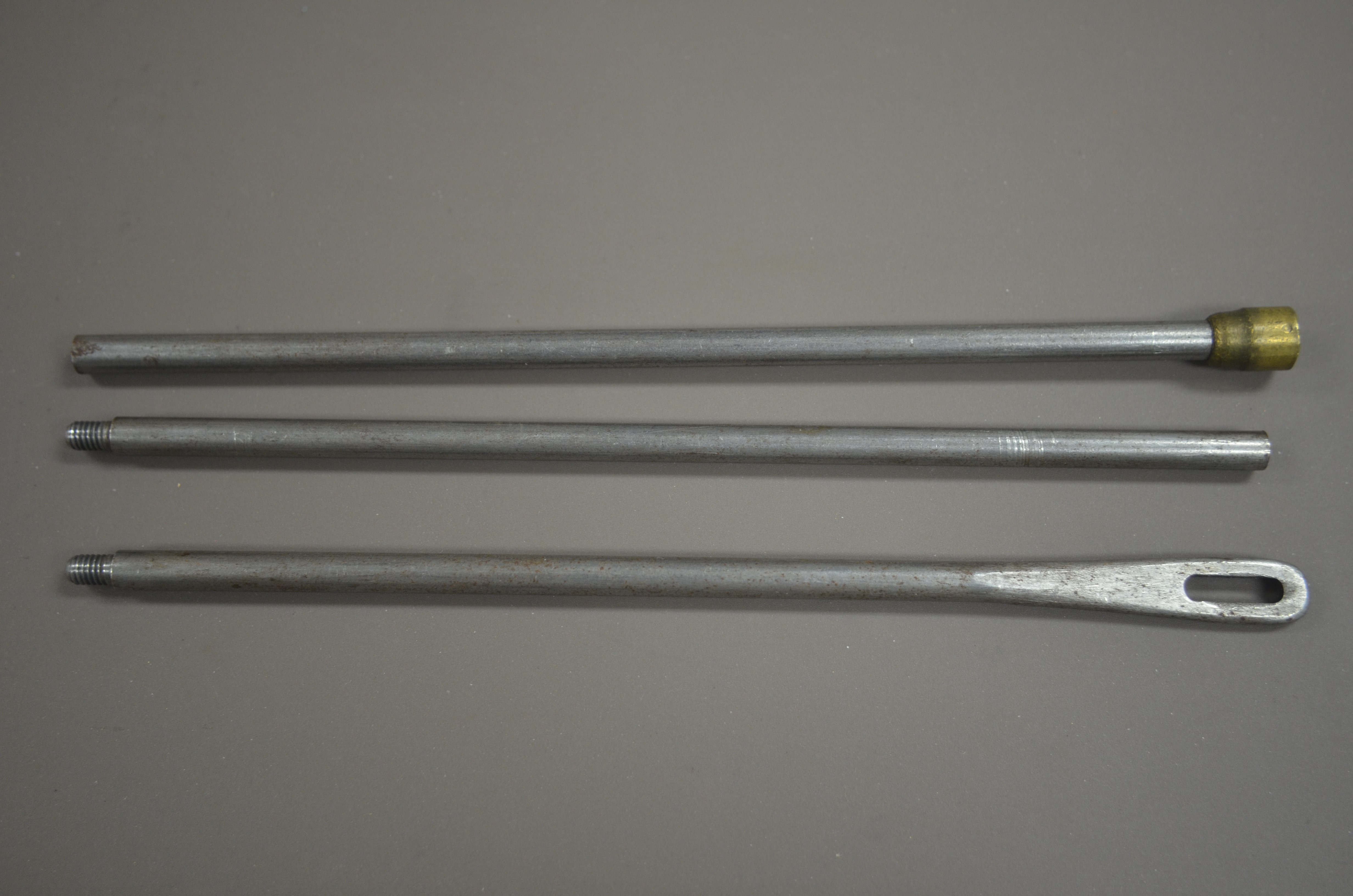

I have purchased one of the rods, I hope it is original, if not, I can go back to the seller, but I hope it is.  thanks, ElliotDSC_2480.JPG
Forum Posts: 4995
February 28, 2017 - 6:59 pm
Elliot,
Rods look real to me.

Elliot, here’s a couple sets I have that I’m told and believe to be originals by the ends and the dimensions.
The top set is for my model 1873 Carbine (3-piece); notice the individual rod lengths differ from the 1873 Rifle (4-piece) rod lengths.
