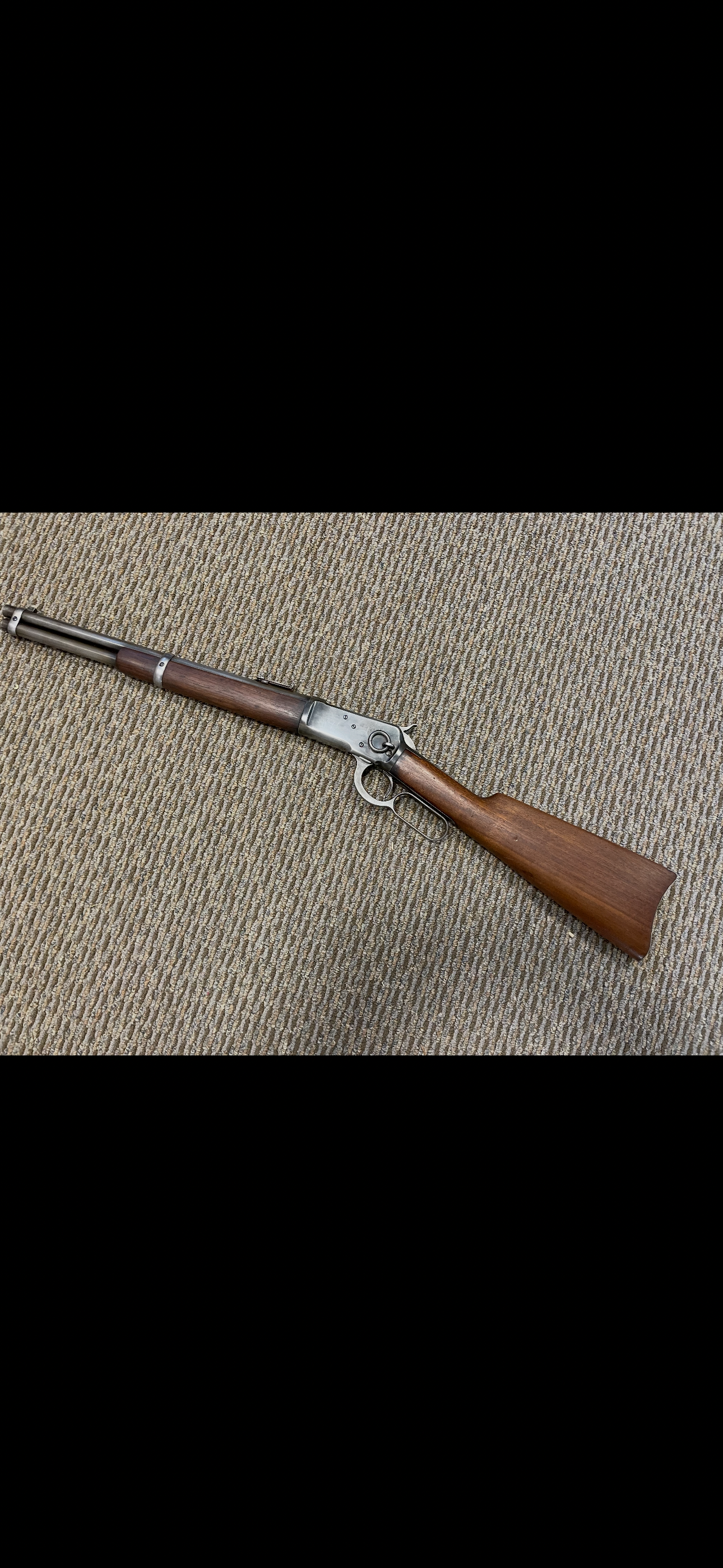

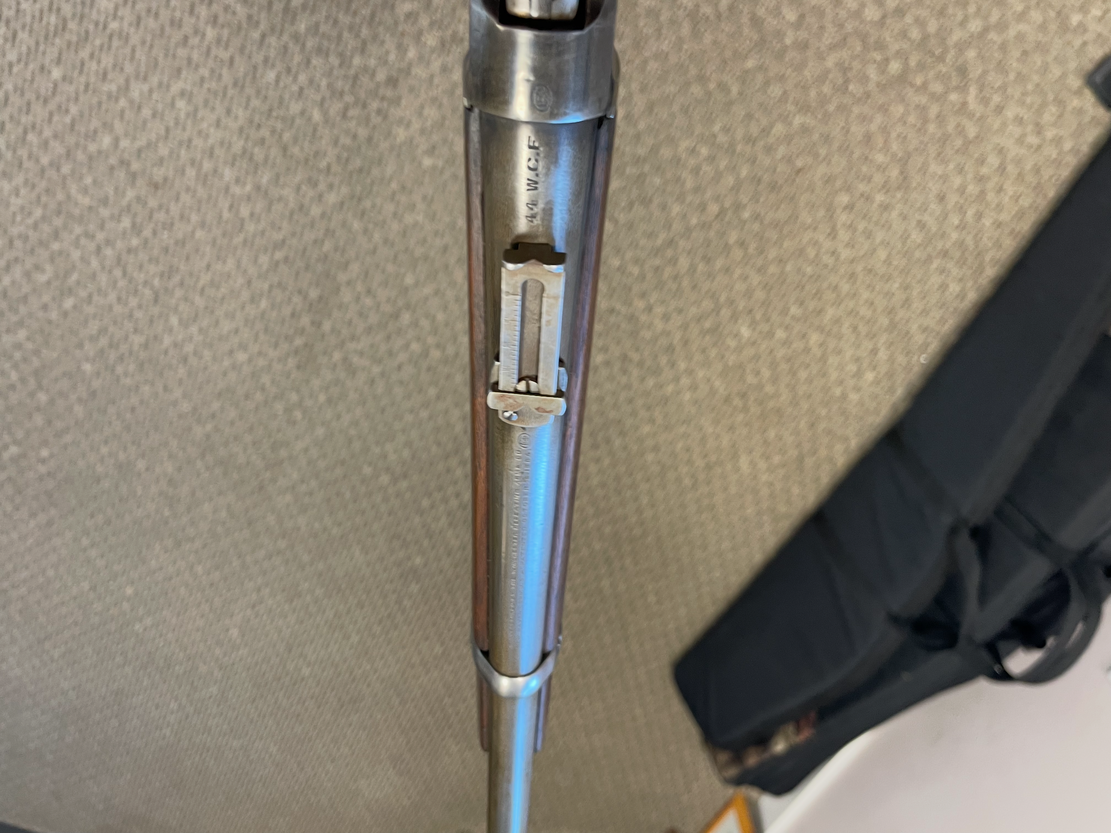

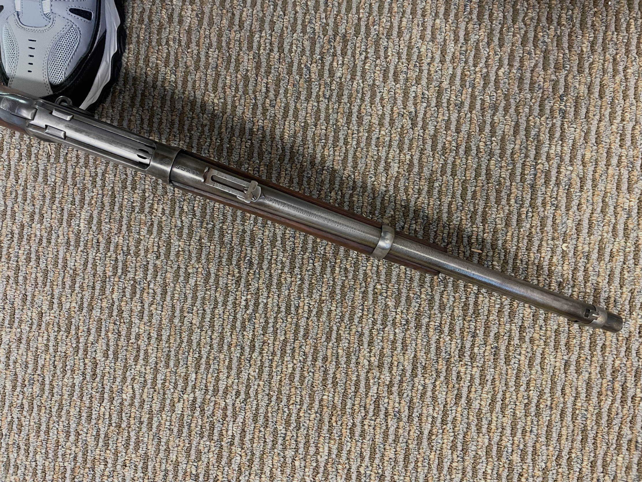

IMG_3116.pngIMG_3115.pngIMG_3114.pngATTN — Fellow Collectors:::: Looks to be a legitimate 44 WCF Trapper serial 365xxx 16 inch barrel. May become available soon.
Just have these pictures for now—
Will have opportunity to physically inspect it before I commit.
Haven’t had much exposure to the Trapper models.
Chime in with any thoughts/input.      Thanks PH

What is the full SN? of the rifle?  The forend wood looks like a standard length which would NOT be correct for a 16 inch carbine.  Is the muzzle face cut flat or is it crowned?  Is the barrel band positioned across the barrel address stamp?
Forum Posts: 2553
March 23, 2026 - 2:28 pm
Also, the wood has been heavily sanded.

Not a waste of time at all.  I would definitely ask for some further photos before the drive.   Get one of the top of the barrel, the full serial number, and one of the forend wood with a measuring tape next to it.

Is the front sight base part of the barrel? If not, is it perfectly attached.

I would get a cody search on it firist . From the photos  forarm wrong lenght . Writing should not be on top in front of sight should be on side with writing end at the rear sight dove and front sight looks  back more then an inch from end of barrel .

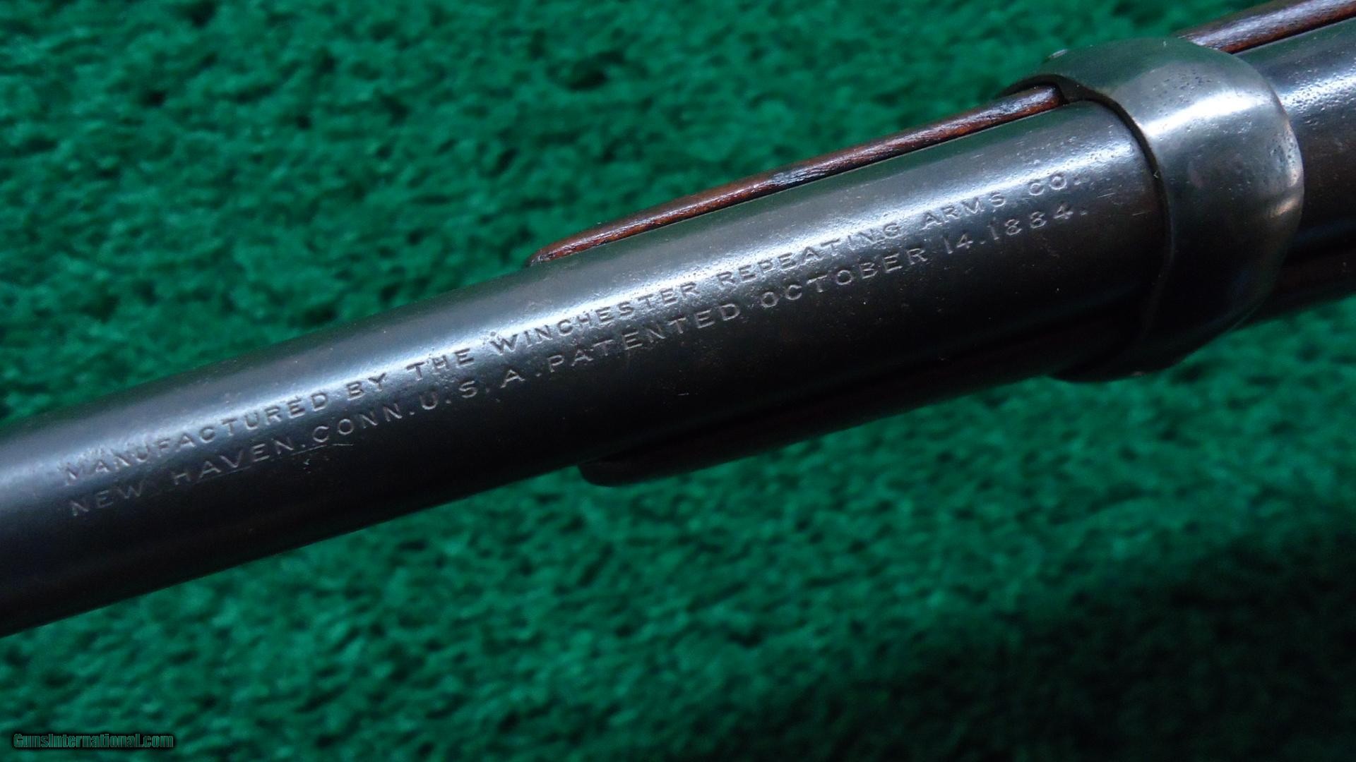

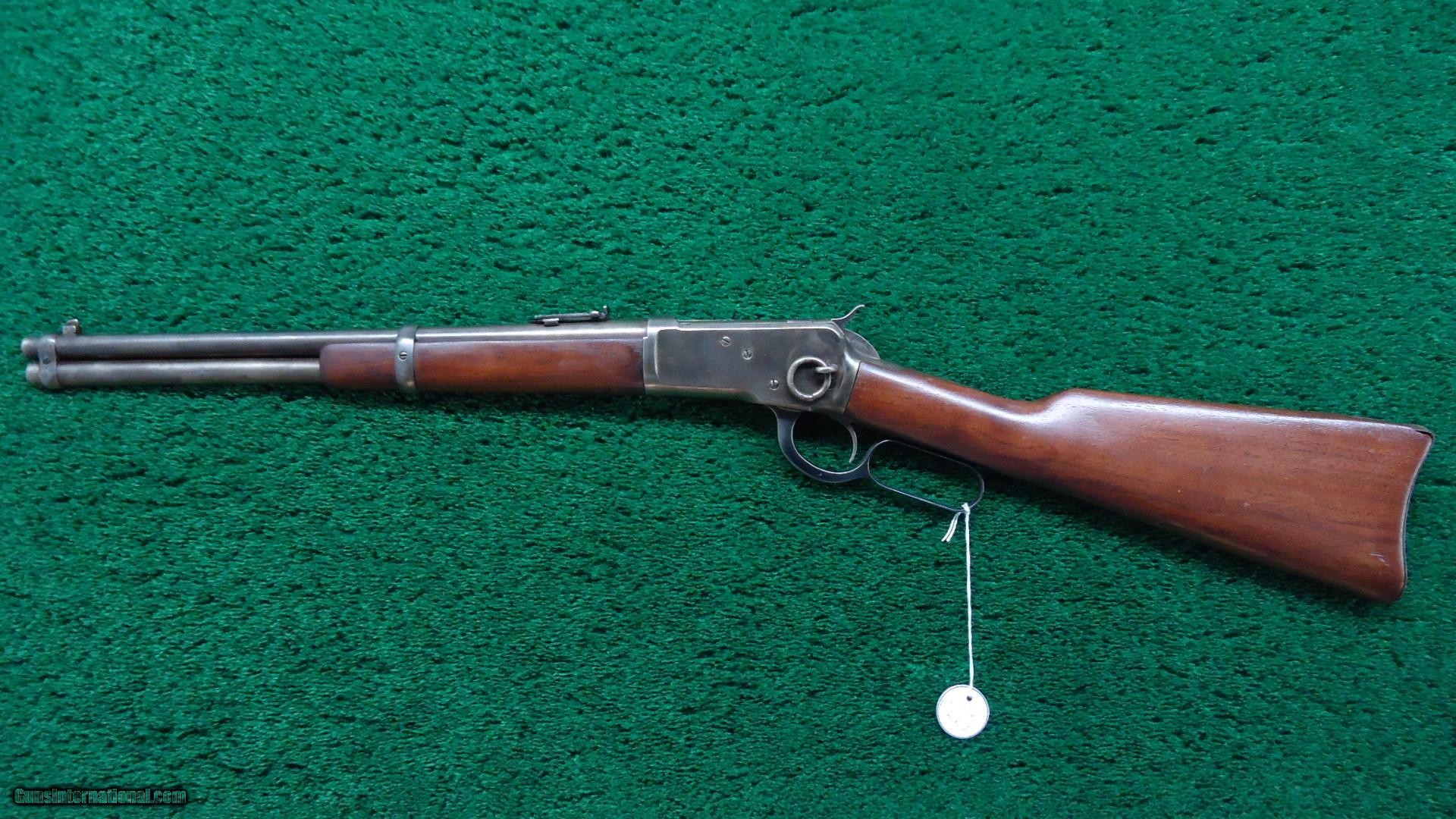

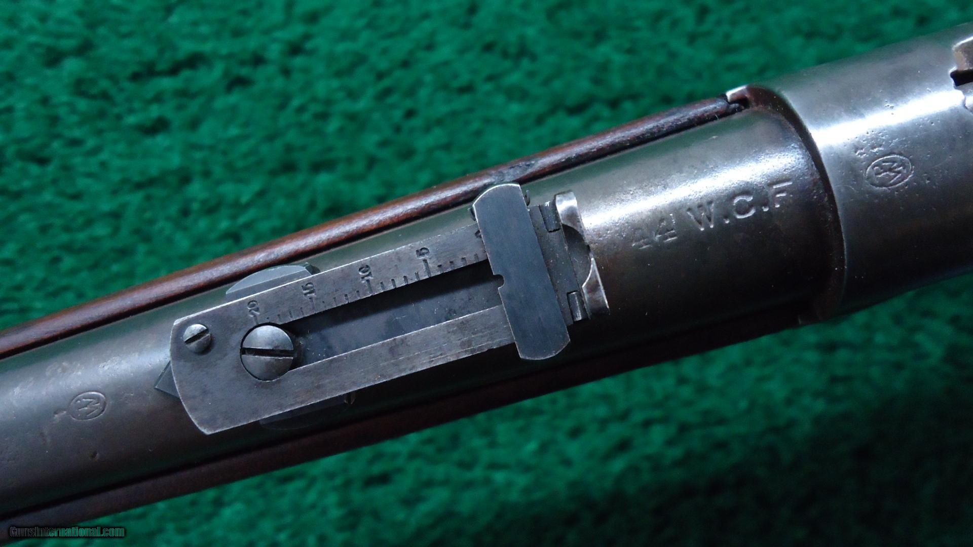

Here are some images of an original 16 inch carbine with SN 380394.  You can compare the relative length of the forend wood, position of the barrel address and the front sight position.  Based on the OP’s original 4 images I am thinking that the rifle is not original and that the barrel and magazine have been cut down.

Your written assertion is not correct.  The rolled stamped Winchester address marking is in the correct position on the top of the barrel for the Carbine in question.

Bert not on top of barrel in front of sight on a 16 or shorter gun should be a head of barrel band like the one Tobit posted if if it on top and has short wood band would be through wrighting.

Again, I disagree.  The factory barrel roll marking for that serial number should be on the top (12 o’clock position) of the barrel… not on the side of the barrel as you stated.

the roll marking sould be on top of barrel yes but not in front of the sigh . On top of barrel ahead of the barrel band on short barrel carbine . On top ahead of sight on standard cabine

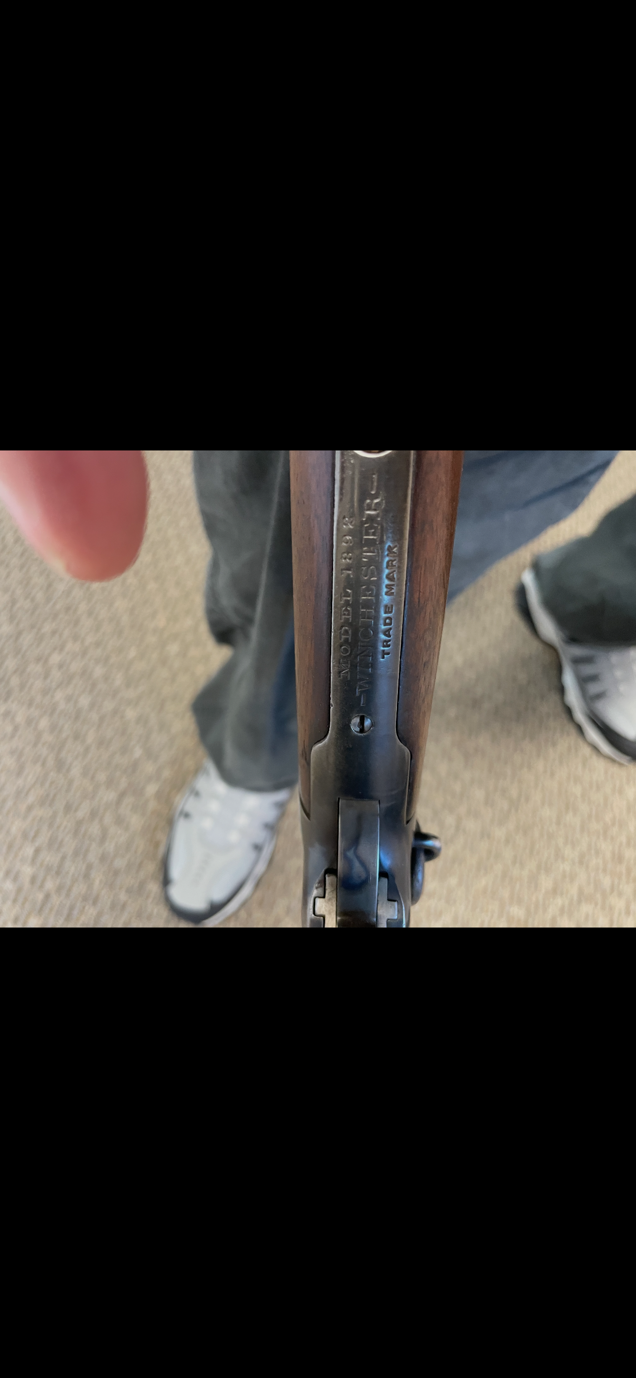

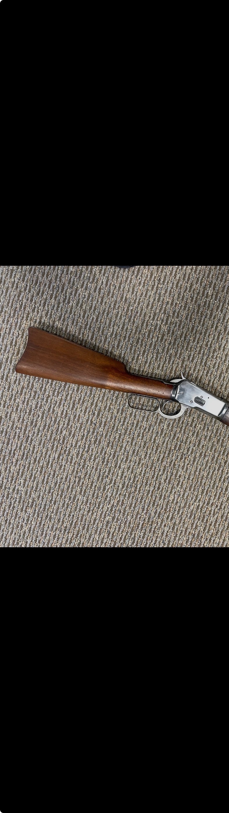

Trying to load a couple pictures—best I can do for nowIMG_0795.pngIMG_0796.png

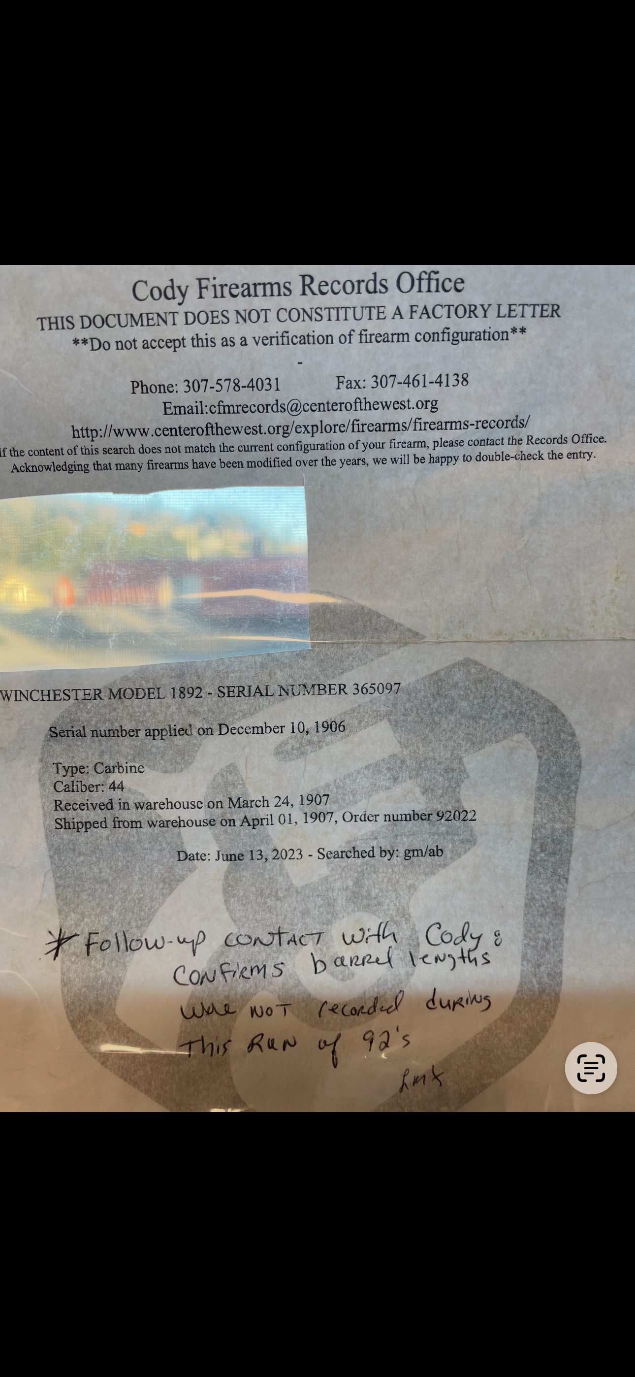

Copy of Cody letter from 2023 with handwritten notation that says the barrel lengths were not recorded on this batch??? FWIWIMG_3121.pngIMG_0798.png

Have the seller mic the end of the  barrel it should be .600 to .615  thousands. The front sight looks  like its been put on in the picture . It letters as a carbine that is more then likely what it left the factory as.
March 26, 2026 - 12:56 am
Paul,
With no barrel length mentioned in the factory ledger records, that is a very strong indicator that the barrel length was the standard 20-inch.  The front sight does look suspicious, indicating a cut-down barrel.
Hard pass on this gun
Forum Posts: 2765
March 26, 2026 - 12:20 pm
Thanks for the additional images.  As Bert mentioned the rifle was originally a standard 20 inch length barrel carbine.  Standard length barrel in either carbine or sporting rifle configurations are NEVER noted in the production ledgers from which the factory letter data is derived.  Only other than standard length were noted.  So the rifle is not original and that highly detracts from its potential value.  I would pass on the gun and save your gas money.
