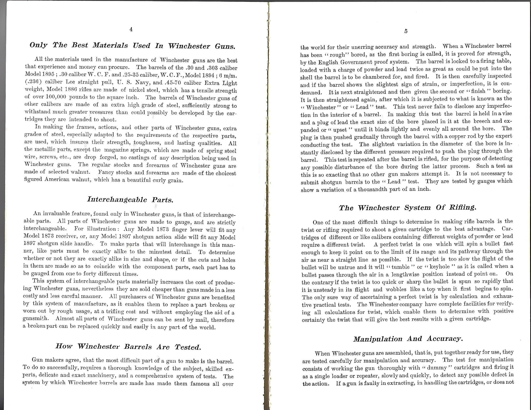

As recorded by Winchester in their own notes, the “VP” stamp was for “Violent Proof”, and it was applied after passing inspection following firing a 200% proof load through the barrel after it was initially bored but not yet rifled.
Question:  How does one Violent Proof using a 200% proof load using black powder?
With smokeless powder, it would be a matter of selecting a load that takes up less than 50% of case capacity and doubling it.  With black powder, as black powder reloading necessitates the case be filled to capacity, how is that accomplished?  The only thing I can think of is to load a case using FFFFg (4F) powder instead of FFg (2 F) powder.  But that’s simply finer granularity allowing for more powder to fill a case, but that be twice (200%) a normal load?
Forum Posts: 14866
37
September 9, 2023 - 4:21 pm
In answer to your question…
After the barrel was initially bored (but not yet chambered) it was locked into a device and then loaded with the proof load (not in a cartridge).  The barrel was still a smooth bore and not milled to final length and contour.
This information was published by Winchester in the front section of nearly all of their pre-1910 catalogs.  I have attached a scanned copy of the January 1899 catalog that describes the process that Winchester used.  As an added note, most people (in my experience) tend to gloss over the information that Winchester so painstakingly published in their catalogs.
