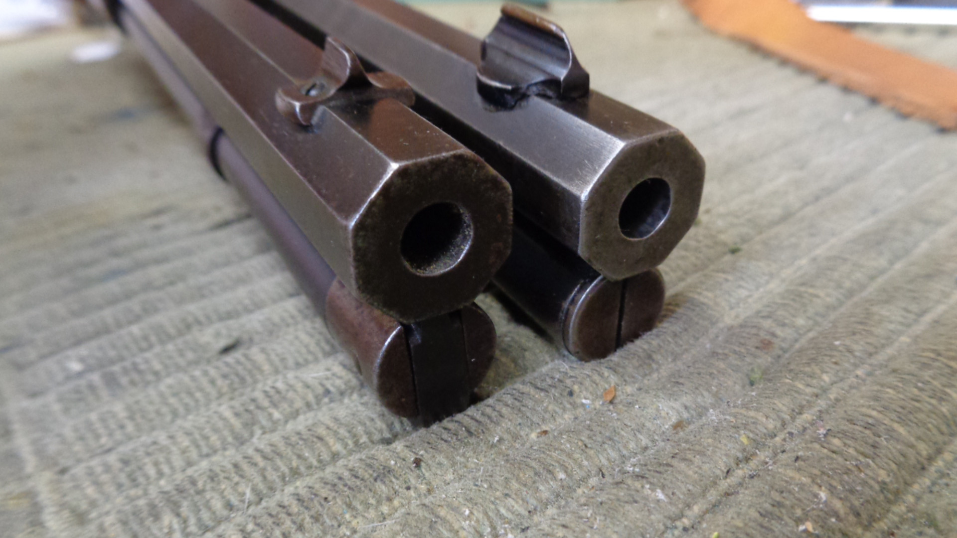

There are a couple things that you can see in the photos that would need to be confirmed.  The barrel doesnt seem to have much of a taper at the muzzle, would want to have the dimensions across the flats, that would definitely confirm whether it has been shortened or not.  In photo 15 there are some odd marks in the top barrel flats on either side of the front sight that cant figure out the cause.  In photo 18, the muzzle face has concentric rings on the muzzle flat, the champfer is a bit deeper than would be expected maybe, and the edges at the octagon points are a bit rounded at the muzzle, whereas the outside barrel bevel at the flats should be directional bevels and squared, not rounded.  The pic below is of 2 20″ short rifle muzzles, the left is in the 599k SN range and the other much later in the 858K range.
You can see a lot of the screws have been tinkered and the buttstock corners at the tang are broken, gives you kind of an idea of disassembly or curiosity by folks.  The receiver looks like it could have been paired with the rest of the rifle for a long time, and we know that rifles with a saddle ring can exist from the factory, is this one of them?  Neat old gun, but those those are the things Id be vetting or would want to firm up before I made  the call.  Would make a good truck gun if it shoots good.

Your right , he does mention the shorter forend.  I didnt read the description.  Either way, there are still some things going on at the muzzle end that dont quite look right.  Maybe someone trued the muzzle up a bit as Ive seen before, the rifle has had some hard use.

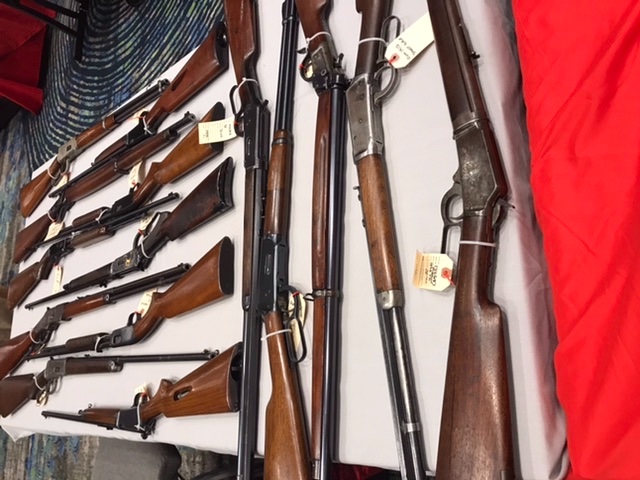

Looks about right to me, I have a very similar rifle (534866) in somewhat better condition. Magazine hanger looks a bit odd on both rifles. (Second from right) You may have seen this one in San Marcos, Chris. Too late to dig it out for better picks.
