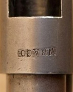

I found this on another forum from a few months ago.-
I had asked him about some of the things I had read or heard as to why serial numbers would have been intentionally removed and asked him to verify the story that Sears and Roebuck removed the serial numbers so they could sell them at less than Winchester’s recommended retail price. I found his response very interesting, and have included it below:
For years I have heard that Winchester marked these Sears guns with the “WRACo” stamp (when they found them). I have found no documentation of this stamp being used for this purpose. Also, the problems between Sears and Winchester started in 1904 and continued until about 1912. Winchester stopped using the “WRACo” stamp in 1903.

In my research, the guns I have found with the WRACO marking were all manufactured pre-1899, and in at least one case, the serial number was still decipherable beneath the cross-hatched stamping.
One question I have, is where did Dan Brumley find any verified documentation that corroborates Winchester intentionally defacing their own products with the WRACO stamp?  I have spent years looking through the information stored in the McCracken Research Library and the CFM, and as of yet, I have not found any evidence of what he states.  If  Winchester actually defaced the serial numbers, I am certain that they would have noted that fact in the factory ledger records, and based on my detailed examination of the Model 1893 records, there were no such entries made in the records.  I have encountered at least a dozen different Model 1893 Shotguns with the WRACO over-stamp marking… early Pre-A guns, “A” series, “B” series, and even one “B Star” marked gun.
One other fact that does not add up, is why is the WRACO marking only found on 1892, 1893, 1894, and 1897 models?  Why not the Single Shot, Model 1886, 1887, 1890, and 1895 ?
Last comment, Winchester had the requisite skills and tooling necessary to repair a damaged serial number.  It is my belief that is what they would have done during a Repair & Return vice intentionally defacing the gun with a crude over-stamp.

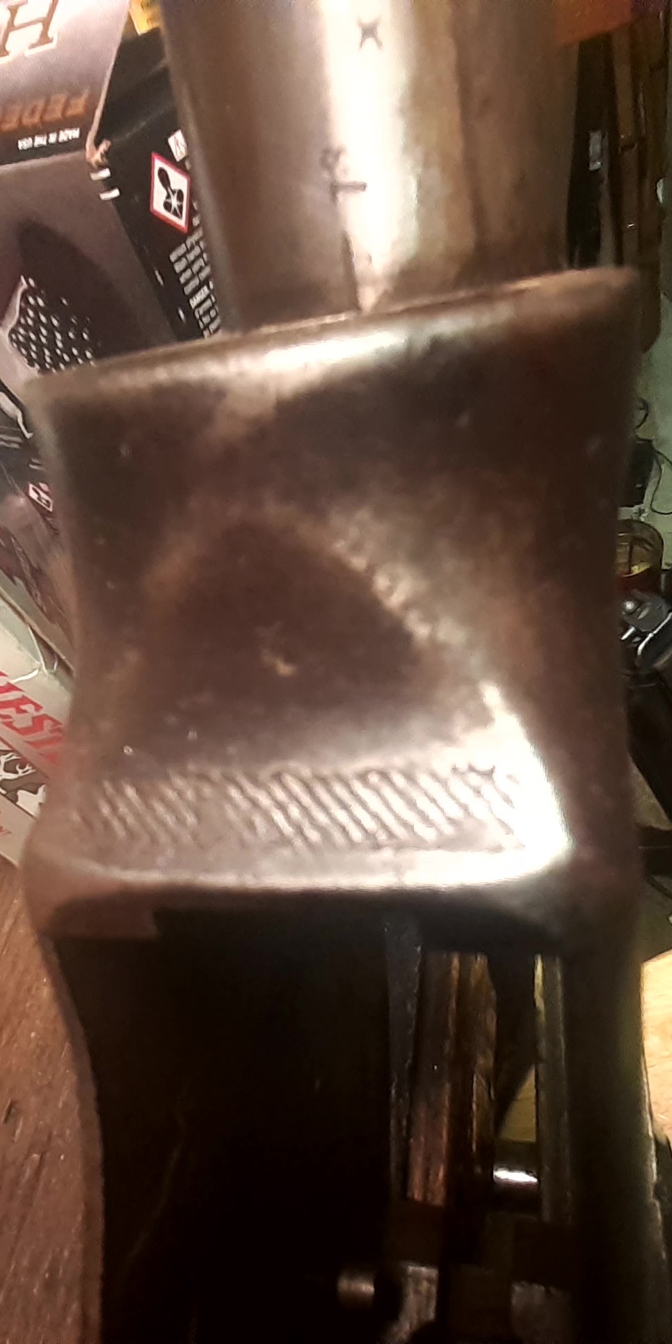

I have either a 1887 or a 1901 Receiver that was defaced with the cross hatch pattern, but I believe does not have the WRACO marking in the cross hatch pattern. I believe that the serial number was slightly visible underneath it as well, and someone tried to remark it or figure out what the serial number was. It is a parts gun with only the receiver, barrel, a few screws and trigger. I’ll have to look at it again to if I can determine was model it is for, because I don’t remember the gauge or markings on it.
Anyway when I get a minute I’ll look it over.
January 7, 2021 - 2:26 am

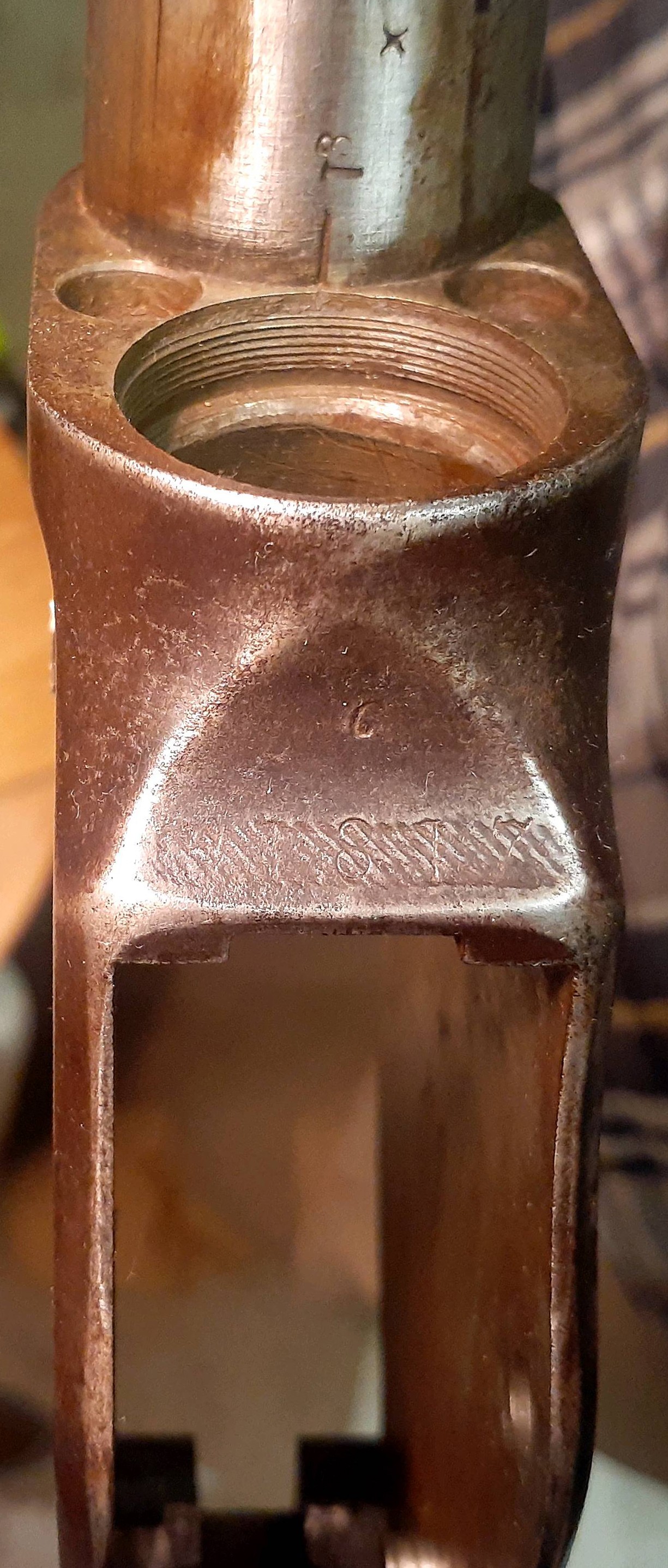

It is a Model 1887 receiver and a 30 inch 12 gauge barrel. You can clearly see where the hatched markings were applied over the serial number. The barrel is marked “12”, per Madis puts it past the 30,000 serial range. Which is also supported by the lack of the brazed magazine retainer, and would use the later magazine band with retaining screw. The receiver has the earlier trigger that is pre-47,000 serial range. So I believe that puts in having been produced in the 1891-1892 timeframe.
I believe the last three digits of serial maybe 817, but not sure. I do wonder if the original serial would be recoverable in some way, but have never tried to do it.
Any thoughts appreciated.

Thanks for posting the pictures.  While it is remotely similar to the specimens I have found, it is definitely not the same.

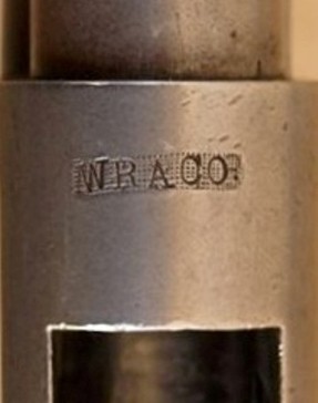

Note the difference in the background pattern on the two Model 1893 shotguns shown in the pictures I have attached.  Also note that on the second gun, the “A” is still discern-able, and if you look closely, the serial number “17422” can still be seen under the hand stamped pattern and WRACO marking.  It was this specific gun that convinced me that it was not Winchester who tried to obliterate the serial number.
On the two I have inspected in person, and the ones I have seen on the internet, the number was definitely gone or unreadable. On the 2 inspected closely in person, the receivers where the serial number was was perfectly rounded, no evidence of distortion of the metal from filing or grinding the metal.
