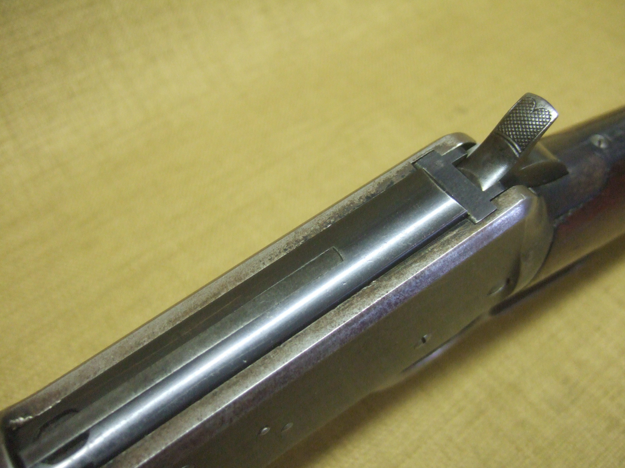

I’ve never seen a hammer on an 1894 (or any other model) look like this.  What would be the reason for such a modification?  Surely not Winchester factory work, right?
http://www.gunsinternational.com/guns-for-sale-online/rifles/winchester-rifles-model-1894-pre-64/winchester-model-1894-deluxe-takedown-30-wcf-antique.cfm?gun_id=101010121
Forum Posts: 1178
April 10, 2018 - 6:17 pm
Looks like the hammer is rubbing on the frame at or below the upper tang on both sides.
Forum Posts: 3077
April 10, 2018 - 7:48 pm
Perhaps an optical illusion, but it looked like the hammer was machined down on both sides.
Forum Posts: 1178
April 10, 2018 - 8:10 pm
Looks like there is a dent on the right side of the hammer in the upper tang.  Could be causing the problem.  Almost looks like a punch mark.  Ive been trying to figure out what that circle imprint is in the blue on the left side of the receiver??  Cant zoom in enough to really see.
win4575
Montana
Forum Posts: 744
November 2, 2009
April 10, 2018 - 10:58 pm
I was able to enlarge the photos and see that each side of the hammer has been milled down slightly.  To the point where the thin border edge on each side of the hammer knurling has been removed.  In doing so, the outside curve on the scallops has also been removed.
Forum Posts: 1178
April 10, 2018 - 11:41 pm
I see what you mean now.
win4575
Montana
Forum Posts: 744
November 2, 2009
April 10, 2018 - 11:56 pm
It also appears that the hammer has a lot of original case color.  If this is true, I’d say the milling was done at the factory, but why?
April 11, 2018 - 2:25 am
Might have something to do with the rifle having double set triggers. But seems odd indeed.
Without disassembly it would be hard to make heads or tails of whats going on, but I wonder if it has been messed with.
Forum Posts: 1652
April 11, 2018 - 11:08 am
I’m wondering what that little symbol is below the serial number.
cjs57
Forum Posts: 273
November 17, 2011
April 11, 2018 - 12:17 pm
The hammer is re-case colored among other issues. Those are not original Winchester colors or pattern.
April 11, 2018 - 5:37 pm
I don’t see any case coloring at all. Case coloring doesn’t have a pattern to it, as it is always random. If there is any color at all, it is merely from the heat of the friction of having turned the hammer down.
What I do see is where someone turned the hammer down a few thousandths. You can clearly see the circular motion cut into the metal, and if you look at that groove you can see where it was done unevenly, and done more than once.
I have no idea why anyone would need to do such a thing.
