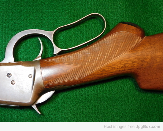

Louis Luttrell said
Hi Michael-
Let’s see if Bert or one of the other experts weighs in…
I know nothing at all about Winchester lever guns and have no experience with this stock maker.  I would like to hear what somebody might say about the product, as I have a “project” similar to yours in mind.  A “family” gun (M1892) with ZERO collector value that I’d like to put back into working order…
Lou, I’m no expert and about the time I make a recommendation it will come back to haunt me but I have purchased wood from this company 4 or 5 times to restore rifles.  The first time for a 92′ and the top tang was opened just a little too much and left a gap.  That was about 40 years ago when I think it was Columbia Precision.  I recently restored three 94’s and they were all good. Nice grain flow and no pin knots.  The wood is a little softer though and probably comes from the south.  Here’s one I did a couple of years ago
https://www.jpgbox.com/jpg/71591_600x400.jpg
