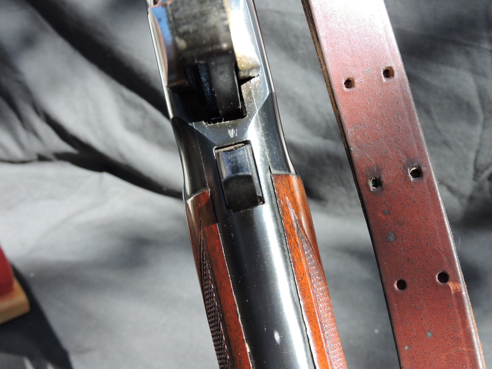

May 15, 2026 - 5:52 pm
I took pictures, but for some reason the camera isn’t connecting to the computer.  Haven’t figured out the problem.  Embarassed
I noticed this model 71 has the “W” stamp on the lower tang, in front of the trigger.
It does have the bolt peep and a filler in the barrel dovetail.

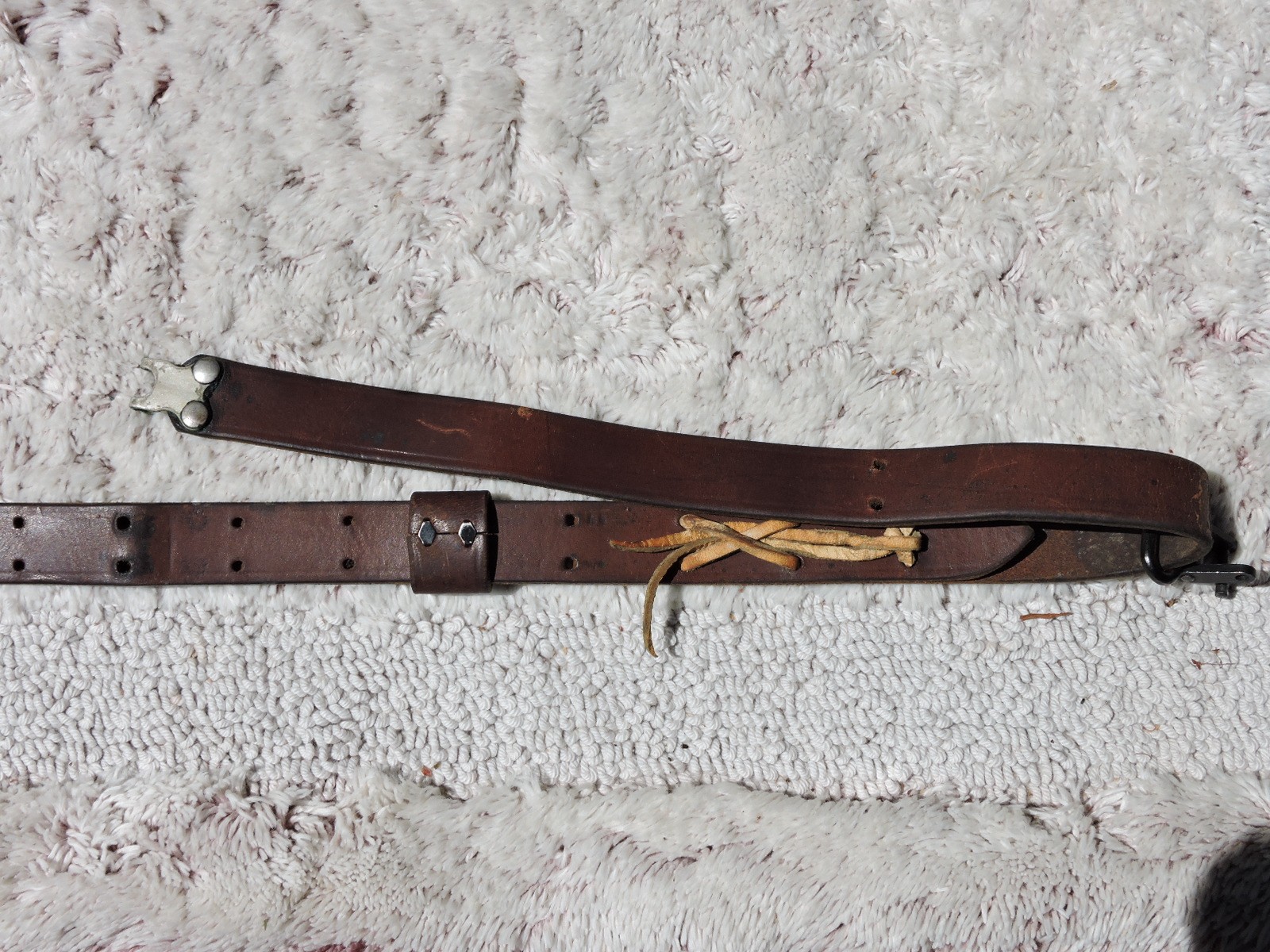

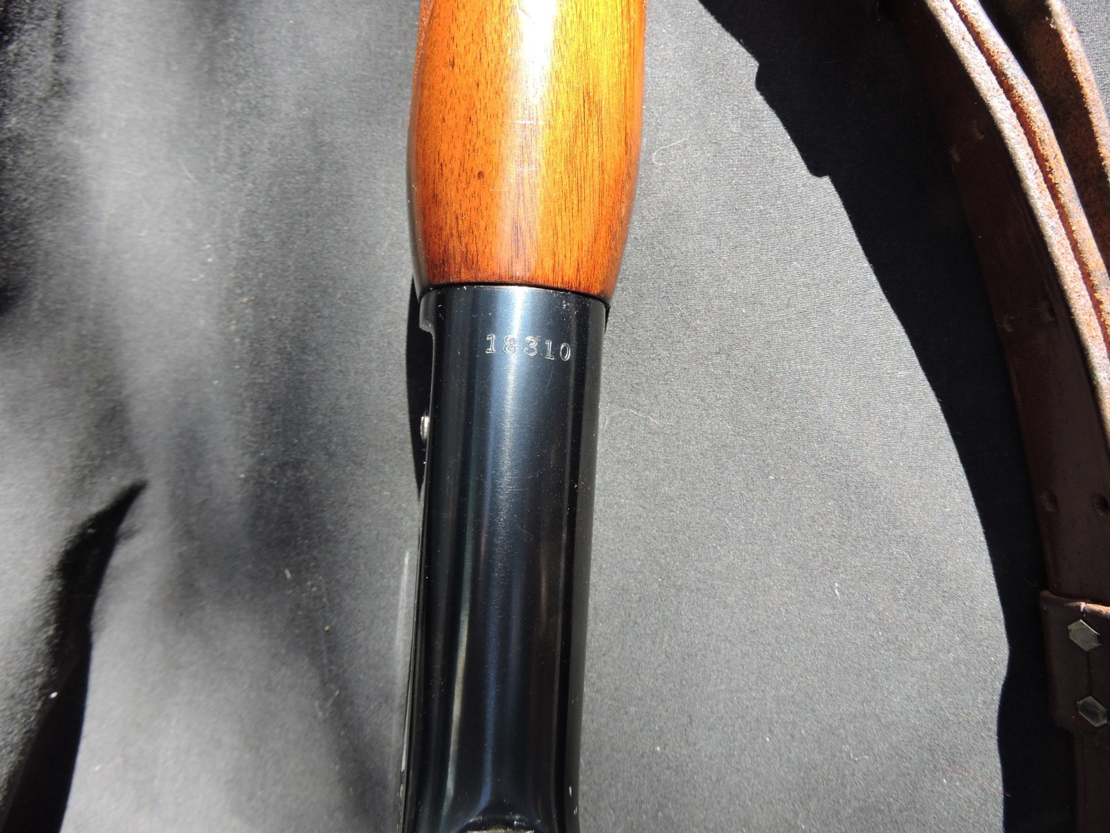

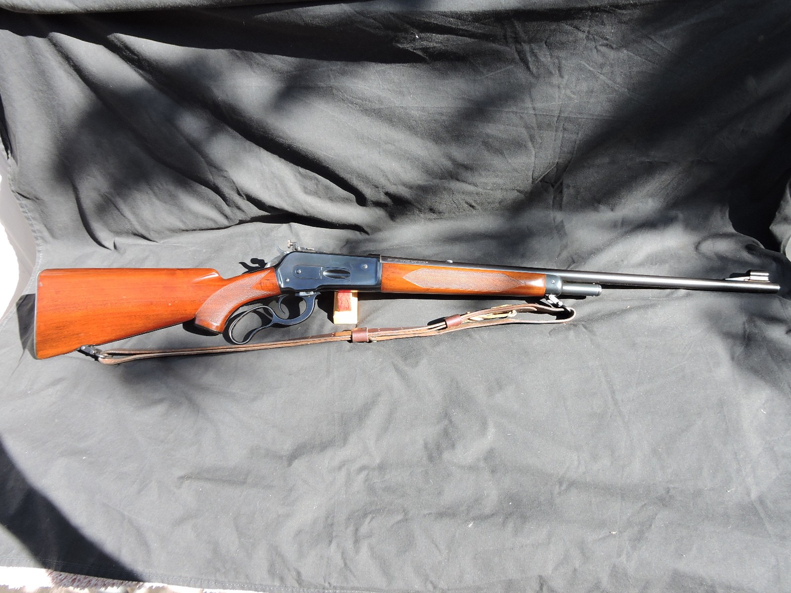

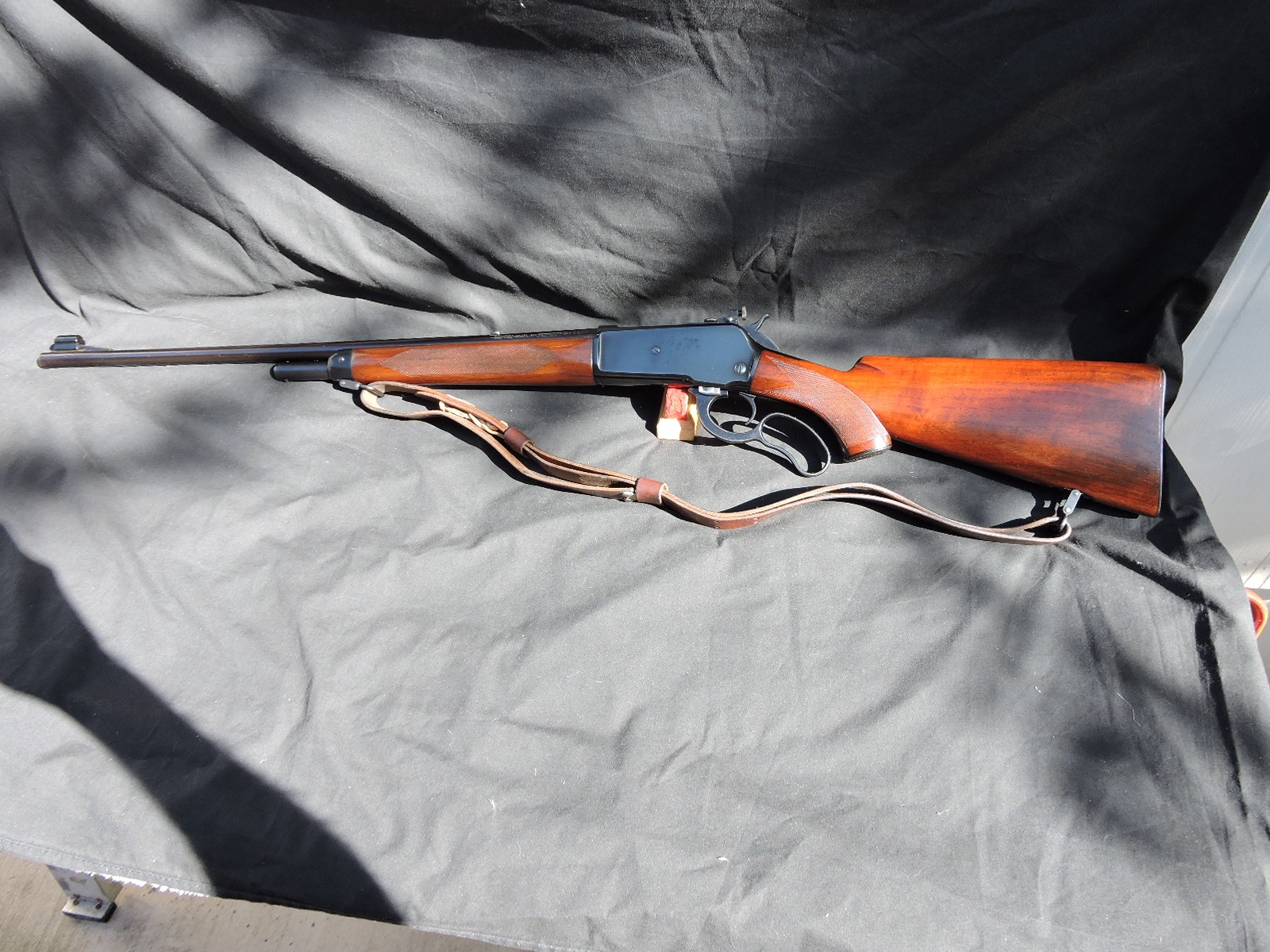

Looks good to me.  It obviously hasn’t been reblued – the serial was applied after it left the Dulite tank. For some reason, the Model 71 serials were applied in a different order. Look at the extruded borders.
It still has its #3278/M WRACO hood – sign of a meticulous owner. And the sling swivels. That’s 3 or 4 hundred bucks saved right there.
Tell us some more about the strap – indicia of factory original. I’ve always wondered.
Is that an oil stain on the left face of the buttstock, pore filler, or the natural grain of the wood?
I like this gun a lot. It needs a range session.

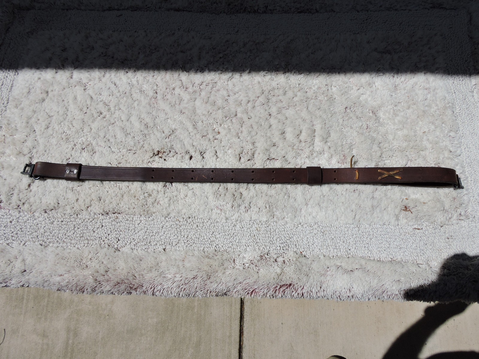

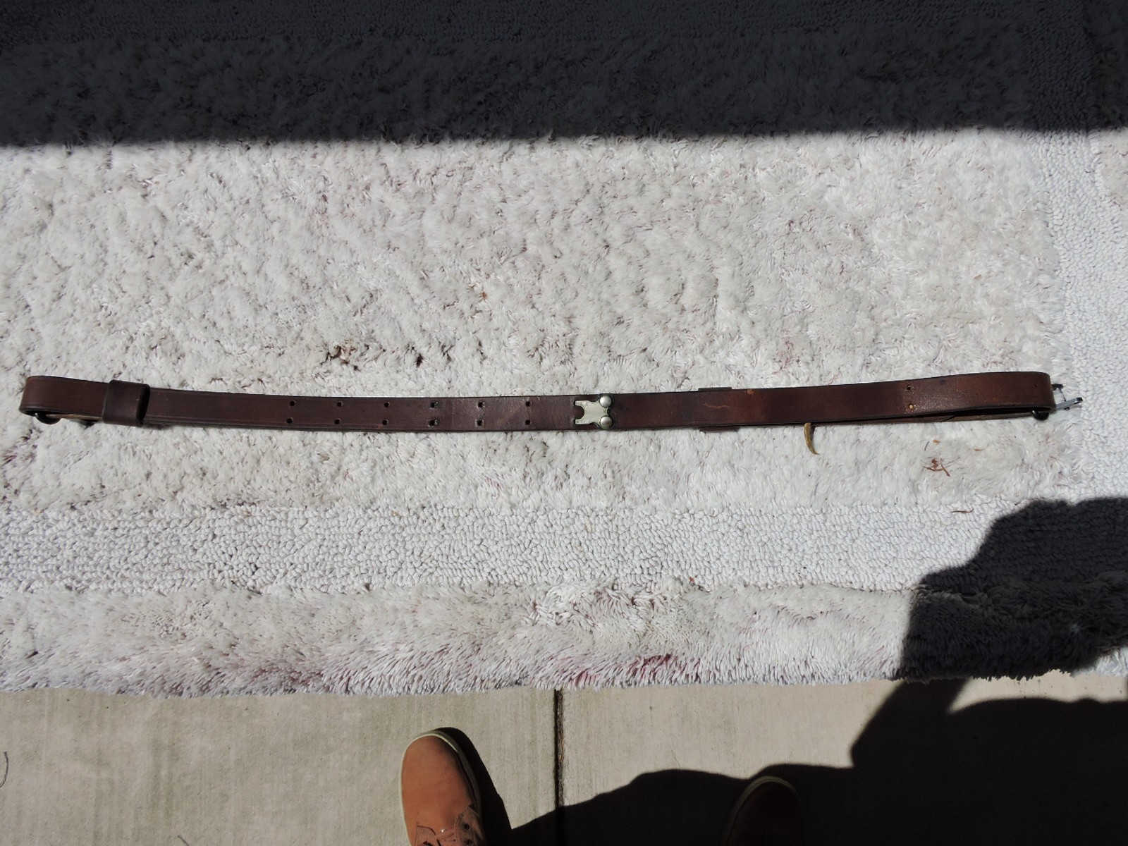

May 15, 2026 - 10:09 pm
The “stains” are shadows cast from a tree limb.  Poor light sourse choice, best I can do for now.  Even harsher when I took the strap pictures.

Roger,  I don’t know what to look for on the strap for clues it might be original issue that came as part of the 71 Special style. I’ve seen them coiled inside the box but have not read who made them and how they might have been marked.
This one looks like a 1907 shooting sling, the one standard for the 1903 Springfield, 1917 Enfield, and Garand M1.
At a guess, Winchester probably changed suppliers at least once and may or may not have had a Winchester part or catalog number put on it. A further guess is that, toward the end of production, as sales slackened, the company may just have bought stock from Redhead or somebody, with nothing to identify the sling with Winchester.
My assumption has always been the same 1″ military 1907 style leather shooting sling was furnished with the Model 70 Supergrade, the Model 71 Special and 64 Deer Rifle, and the 52 Sporting Rifle. The ones I’ve seen had brass keepers.
Anyone with knowledge will please correct me.
