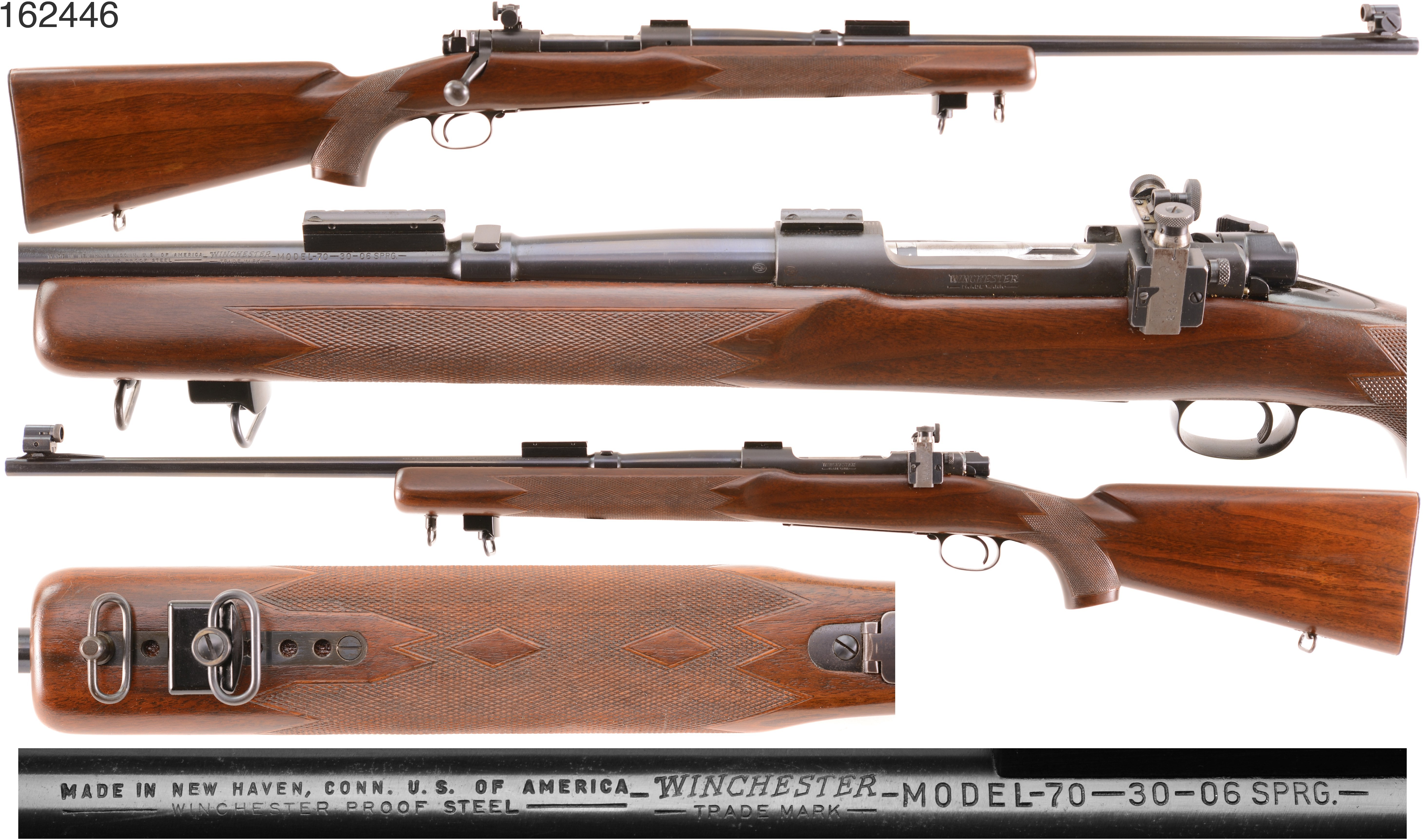

All this talk about M70 Target Rifles, has reminded me . . . .
I was privy to the extensive gun collection that Ken Waters had. (He was a noted magazine writer for Wolf Publications.)
In his “stash” was a M70 Target (don’t remember the caliber) but, it had a Marksman stock that, according to Ken, was Factory Checkered!
I actually got to HOLD IT IN MY HANDS!
Forum Posts: 1539
June 1, 2026 - 10:24 pm
Hi Jim-
Such things (factory checkered Marksman stocks) do exist, and in rare cases can be documented as factory work.  I know of one that belongs to a Member of this Forum (not mine) that has perfect provenance.
The factory pattern was somewhat specific, although I think (???) that whether the grip checkering went over the top of the wrist (Super Grade style) was variable.  This (below) is a gun I bought…  It’s got the factory pattern (matching known ones), but whether it was done by the factory or not is a mystery…
