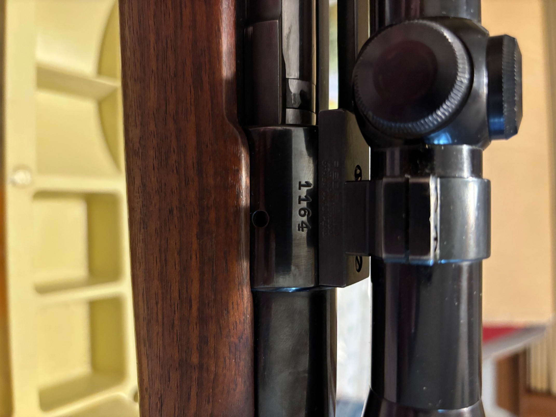

Hi, I’m a newbie here hoping to obtain any insight or info you gentlemen would care to share with me.  I just acquired a 1936 model 70, serial #1164, in 30 govt 06 caliber with a 24 inch barrel.  Looks like it’s got an aftermarket stock. The underside of the barrel indicates year of manufacture as 1936 also. What has me stumped is that the barrel has no front Iron sites at all and the rear sight has the stith mount plug.  As I understand it, the front iron sights on these early Model 70’s were integral to the barrel and not screwed or soldered on, correct?  If so, could this possibly have been a custom order barrel?[Image Can Not Be Found]

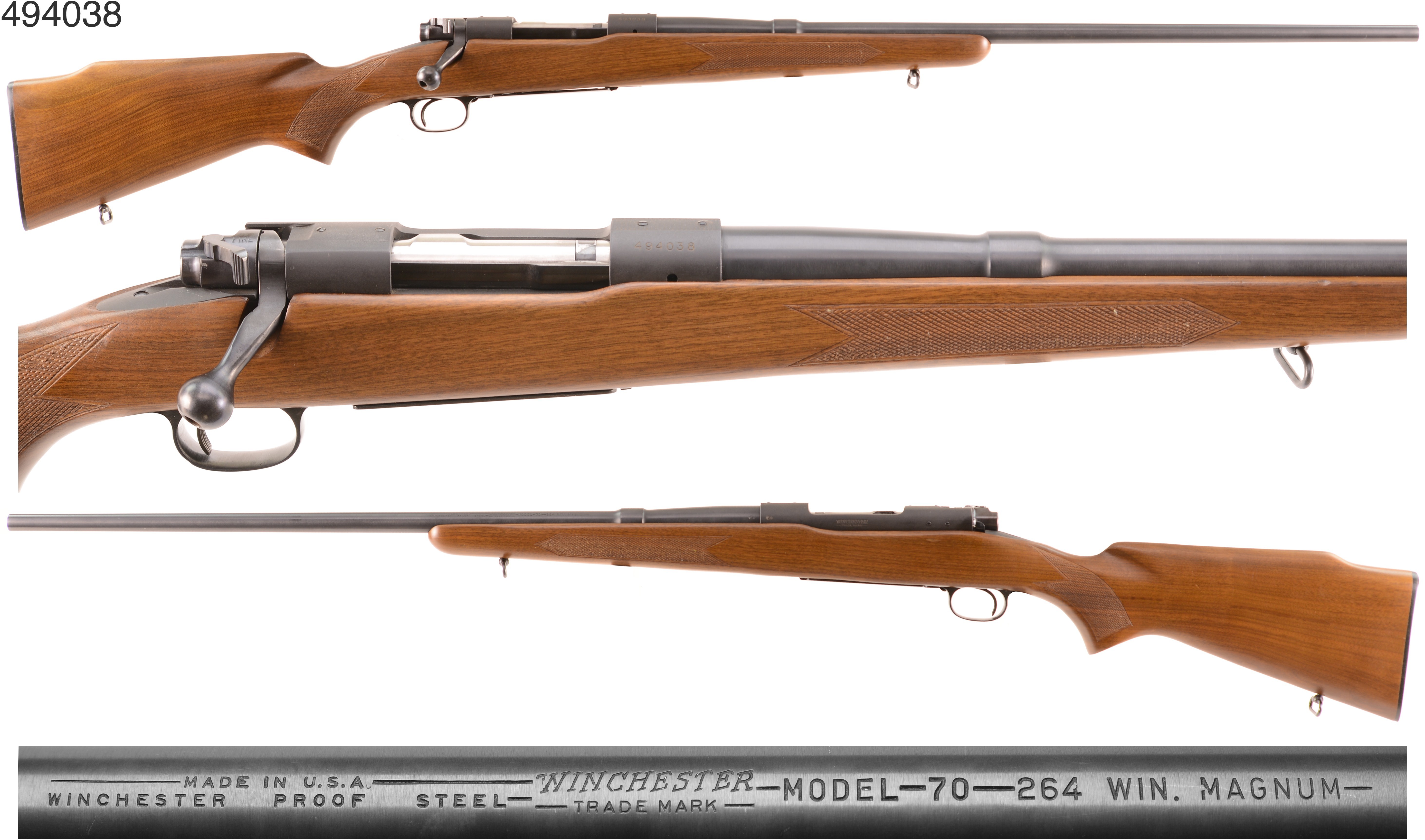

For reference, here are some pics of a M70 close to yours (S/N 1099) with original sighting equipment).

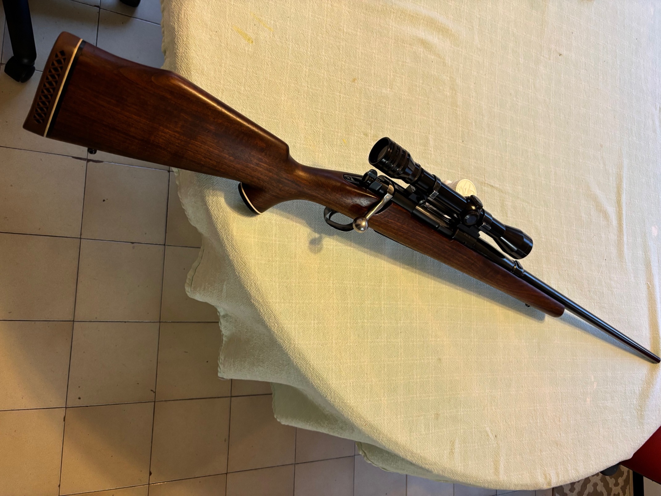

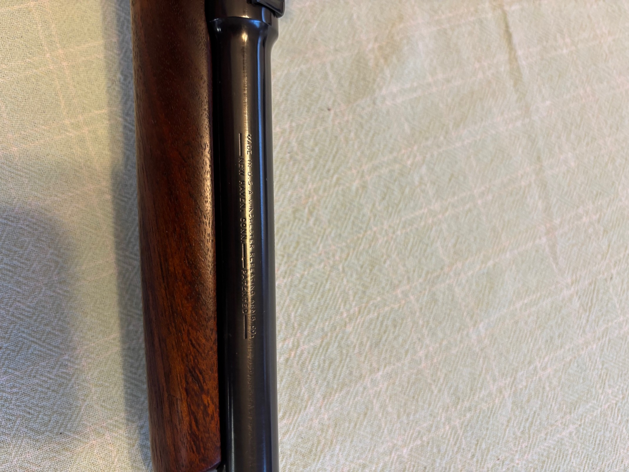

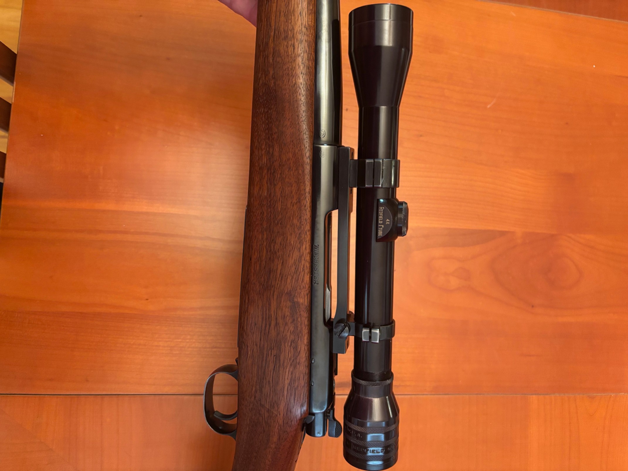

These are the pics George sent me.  Exposed barrel mark photos pending.

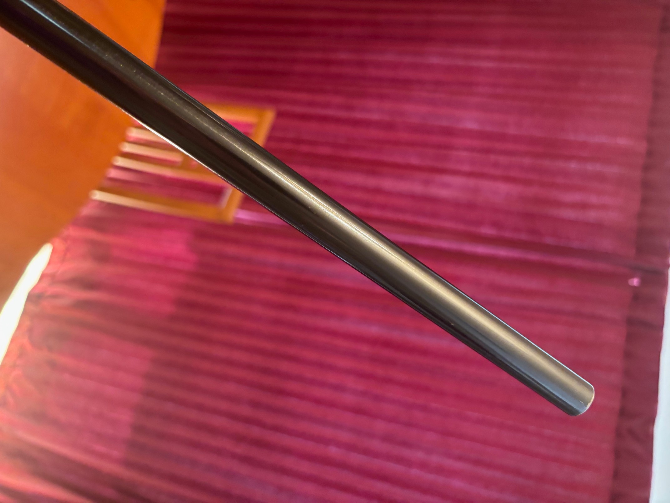

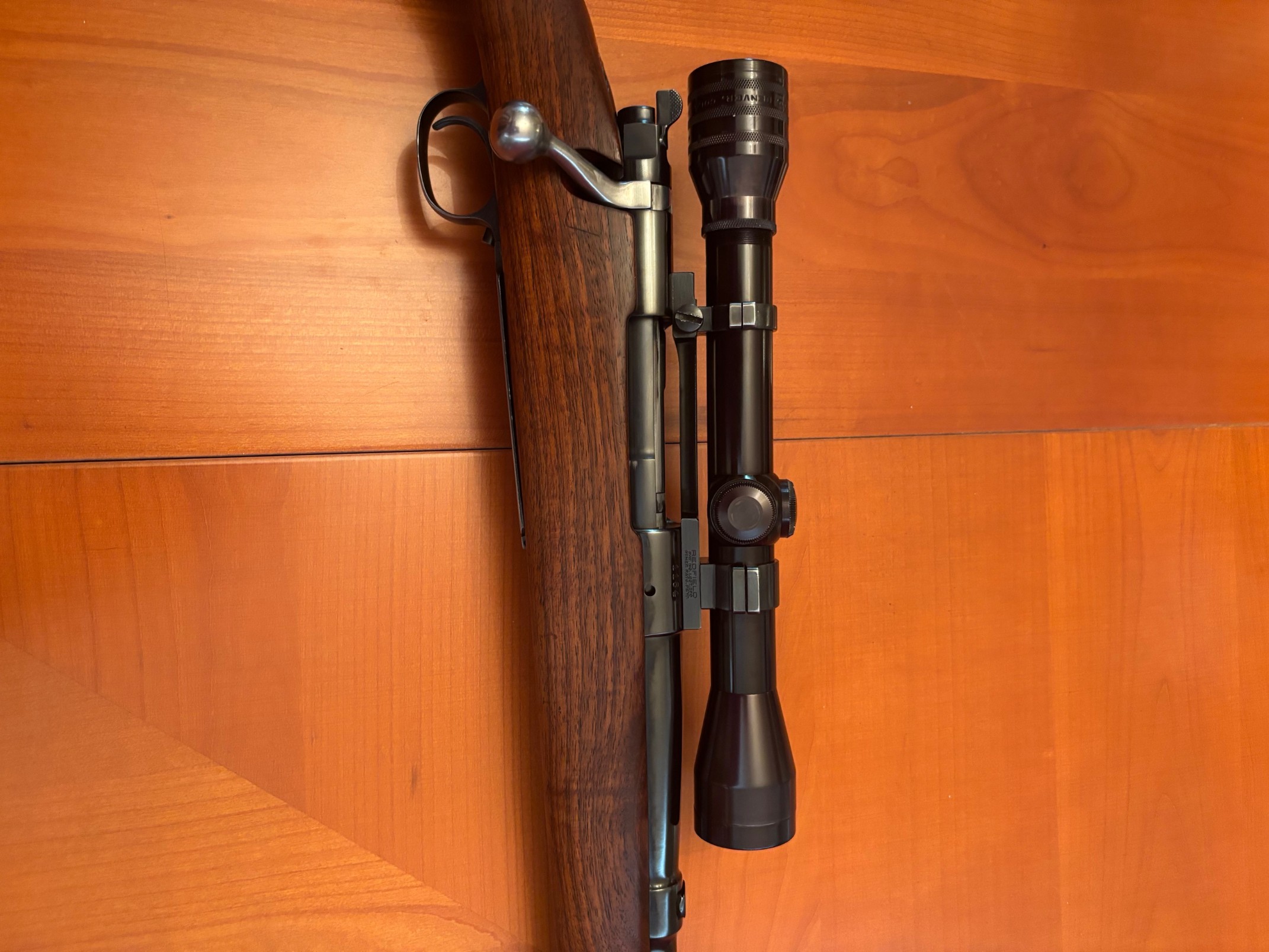

I believe that is an original Winchester barrel that has been reduced in contour, in the process of which the integral sight ramp was turned off.  Then it was polished and reblued by the hot salts process. The barrel rollmarks visible in the photos have been “pulled” [softened at the edges] by a buffing wheel. I wouldn’t have been surprised if the barrel had measured a couple of inches shorter than 24″.
Lightening standard weight Model 70 rifles was once a popular thing to do before development of the Featherweight style in 1951-2. Usually it involved turning down the barrel and shortening it to 20″ or 22″ from 24″, substituting an aluminum buttplate and floorplate, and removing wood from the stock.

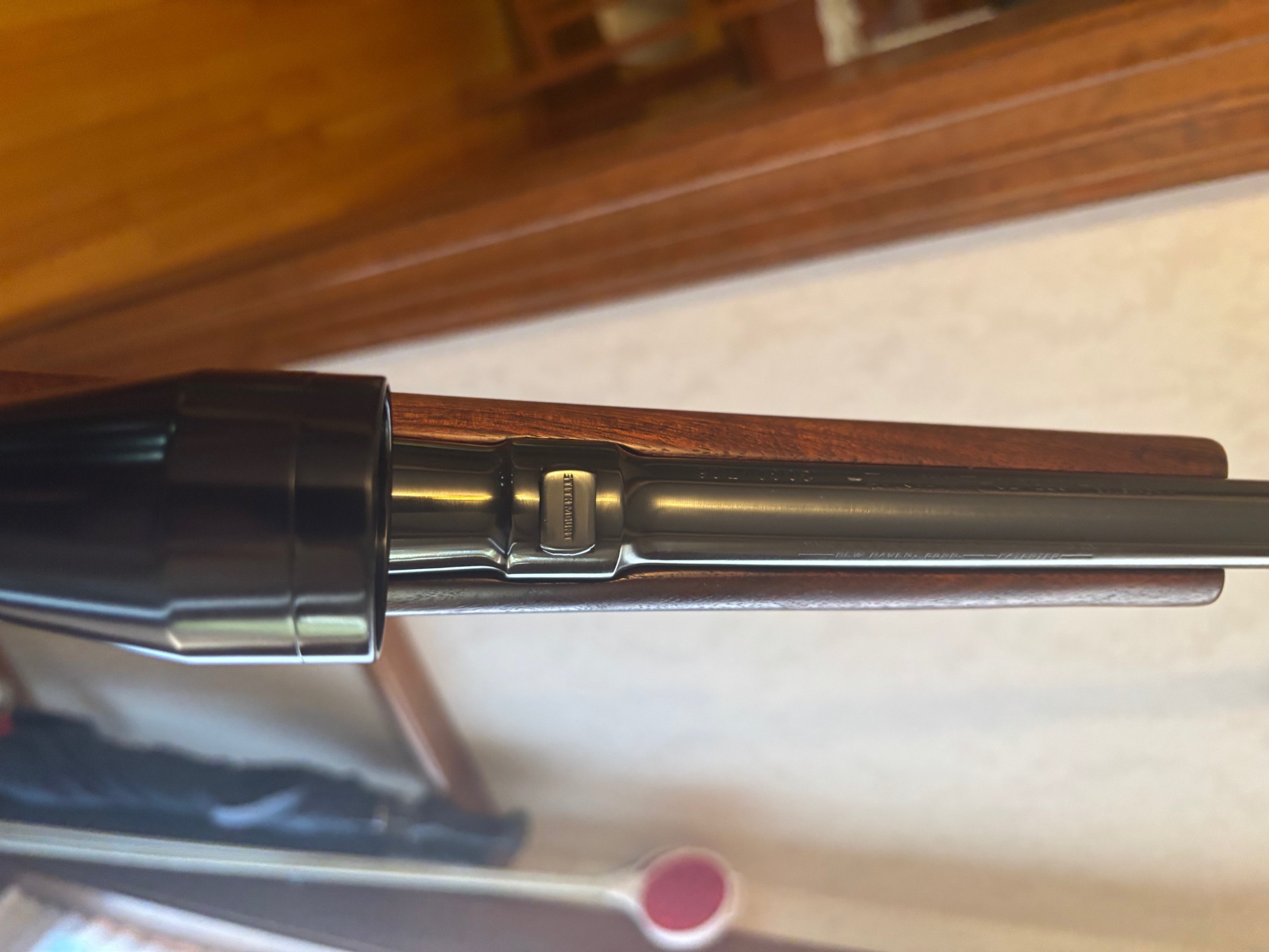

The piece in the rear slot is a blank made by Stith of San Antonio for the purpose of filling and protecting the female dovetail. Lyman, Marbles, etc make similar blanks for that purpose, too, as you know.
I can’t see enough of the stock to see what it might be. The pair of mortises in the barrel channel to accommodate the rear sight boss do not look as crisp as they were normally cut by the factory. They are also rounded or “washed” — perhaps in the course of refinishing the stock, or even altering it from an un-bossed barrel channel.
Because the forearm appears to be so “squared off”, as if it were shaped on modern automated equipment, is there any possibility this is a late pre-64 Featherweight stock adapted to this barreled action? I cannot clearly see the tang of the action but I would presume it is a cloverleaf tang because of the design and position of the safety lever. It would be useful to see the inletting of the stock. I believe [unless Lou says otherwise] every Featherweight action had a rounded tang, not a cloverleaf, and would not have mortises for a sight boss or a hole in the forearm for a barrel tensioning screw.

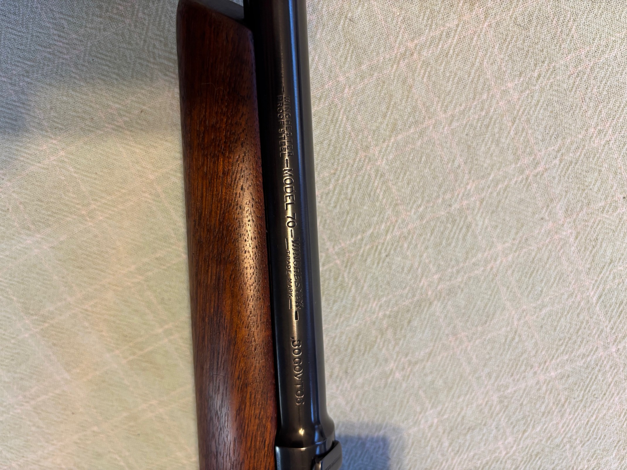

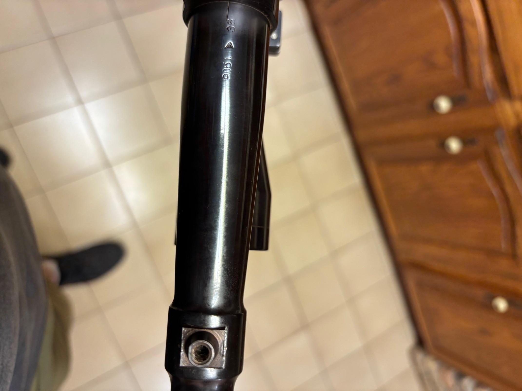

Lou / Bill, I just emailed Lou the add’l pics showing the stampings on both sides of the barrel along with a full pic of the rifle, including a barrel close up.  One of my previously sent pics show the underside of the barrel stamped “36 1906” which I understand to mean barrel manufacture date of 1936 in the .30Gov’t06 caliber.  So I think the barrel is legit?  But I’m still trying to figure out having no front sight? Your thoughts?

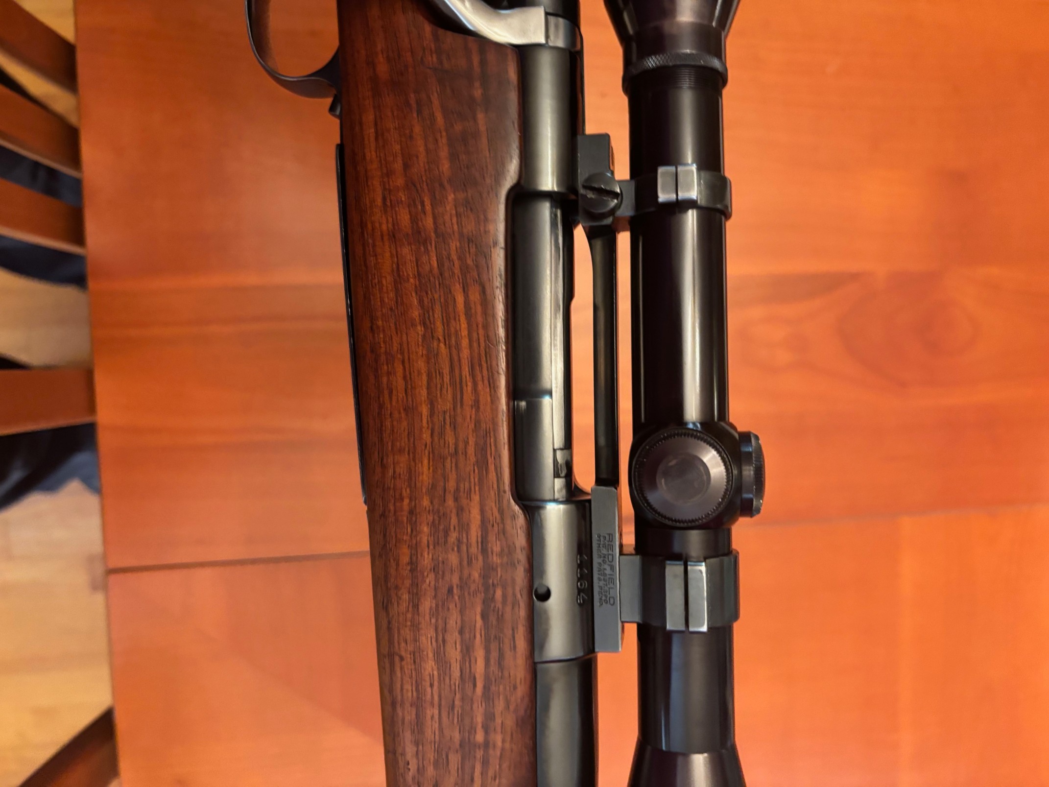

Bill- I’m sure it’s an aftermarket stock (like a Weatherby Vanguard profile).  I measured the barrel at 24” muzzle to bolt face. I’ll send an additional pic of the tang to Lou to share with you.  I believe it’s a clover shaped tang- if you can confirm. Lou has the other pics also.  Thanks again gentlemen!

I failed to mention the bolt handle, from which the original blueing has been removed and either left in the white or plated. Because the action is an early one,  Lou can say whether the bolt would have had to be altered to clear the ocular bell of a scope. That would explain the change of finish. Or,  because bolt handles wear their blueing with use, perhaps the owner who ordered the gun refinished preferred it that way.

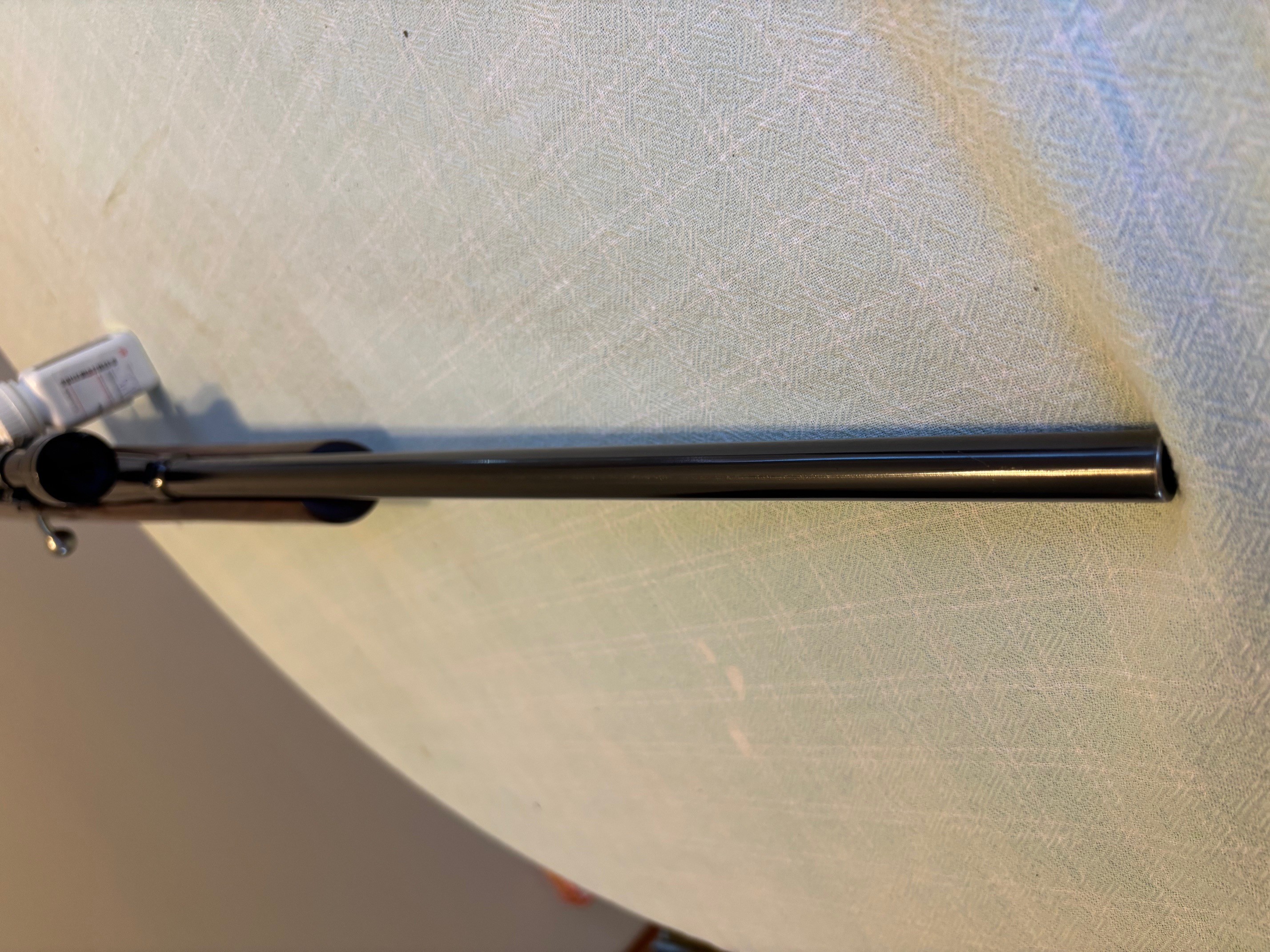

Sorry… I was tied up for a couple hours… Embarassed Here are George’s additional photographs…

George,  Yes, that is an aftermarket stock on an early Model 70 barreled action that has been refinished.
It has no collector value but is likely a perfectly sound hunting rifle.  You might want to have a gunsmith check the headspace but otherwise take it to the range and see how it shoots. I bet it will stay within 1.5 to 1.75 MOA and there’s no game animal.in America you can’t hunt with it.

There is little doubt in my mind that the barrel on your rifle was originally made with an integral front sight ramp that was subsequently removed, after which the barrel and receiver were both polished and reblued.  Winchester did not make standard contour barrels without front sight ramps in 1936, and as I said above, when a Model 70 was ordered “without sights” at the time it only meant that dovetail blanks were installed in the ramp and rear sight dovetail instead of sights.
By the mid-1950s, Winchester did make true “sightless” barrels and even cataloged it as a $5.60 “Extra” beginning in 1960.  But…  When they left off the silver brazed ramp they also omitted the rear sight dovetail.  The fact that your ’36 dated barrel has a rear sight dovetail is further evidence that it once had a front ramp.  I will post photos of a genuine factory “sightless” standard contour barrel from 1960.  This is a standard Westerner 264 WIN MAGNUM, something that could be ordered from Gopher Shooters Supply in 1962-63..
As far as what to do with the rifle…  Just my opinion… Since, in addition to the barrel modification, the receiver has been reblued and the bridge has at least one non-factory F&T hole, the gun cannot be returned to “original configuration” even by replacing the stock and barrel.  Also, finding a ’36 dated 30 GOV’T’06 barrel and a truly correct (for 1936) standard stock would be difficult and certainly cost more than twice what you have in the gun.
