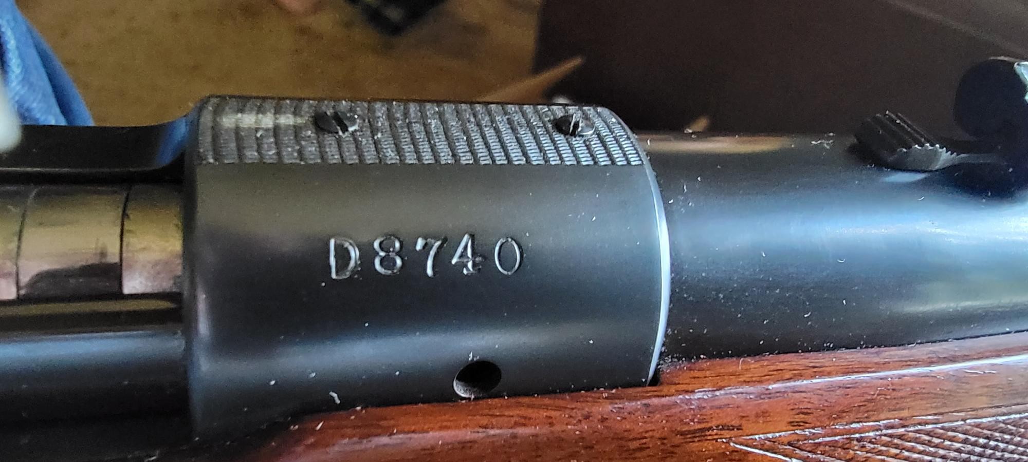

m70do.jpgHello
I have a prewar model 70  the serial number is 3 digits with a D prefix and O suffix I have read that the D prefix is for is for duplicate serial number what does the O suffix represent
Thank you in advance

James,
Winchester did not ever use a “D” prefix letter or an “O” suffix letter on the Model 70. Duplicate serial numbered guns were hand stamped with an “X” suffix when they occurred.

Hi Bert
I am trying to figure out how to post a picture
Forum Posts: 14866
October 17, 2022 - 3:34 am
james alfano said
Hi Bert
It appears that you were successful.
Why do you believe that it is a pre-64 rifle?

m70ddo1-1.jpgm70ddo1.jpgPre war model 70
I can try to post a better picture
Thanks for the replies
The receiver has the cuts for stripper clips that tells me it is an early model 70
Sorry for the double picture
October 17, 2022 - 9:31 am
james alfano said     what does the O suffix represent
Looks like a zero to me.

Have you checked the bolt to see what s/n is marked on it? I agree, the last digit appears to be a zero, but done manually possibly since it is not as deep.

My understanding is that Winchester initially used a “D” prefix to denote duplicate M70 serial numbers.  According to Roger Rule’s book this applied to M70 serial numbers below 10,000.  For anyone interested, Roger shows the example of S/N D8690 (very close to yours) on p 126.  Above S/N 10,000 (still in 1937) they changed to the more familiar “X” suffix to denote duplicates.
I agree that the last digit is a zero.  The minor misalignment in numeral height and spacing seems to be an inherent property of the die marking machine used to apply serial numbers.  So my best guess is that your rifle’s S/N is D8740.  I can only imagine that the guy in the Polishing Room applying M70 serial numbers was having a bad day when S/Ns 8690 and 8740 were applied…  Wink

Interesting, but I have my doubts about it being accurate.  What I am struggling with is why the Winchester Polishing Room employees would have used a “D” prefix to mark a duplicate Model 70, but not on any other models to identify a duplicate serial number?  For all of the many different models that I have been surveying/researching, Winchester simply did nothing with the duplicate serial numbers through the year 1939.  In 1940 (I do not have an exact date yet), they began adding the “X” suffix.  I have documented duplicate Model 94, Model 64, and Model 71 serial numbers that are pre-1940 with no prefix or suffix, and then in 1940 (and beyond), with an “X” suffix.  Currently, I have identified (79) duplicate Model 94/64 serial numbers that follow this pattern.
In regards to the subject Model 70, the “D” suffix does not appear to be hand stamped.  It is too correctly sized, aligned, and of uniform depth.  When a duplicate serial number was identified in the Polishing Room, the numeric digits had already been machined stamped which then required someone to hand stamp an “X” (or presumably in this case a “D”).

I was recounting what Roger’s book says on the matter and have never seen a “D” prefix pre-war M70 first hand.  The (not totally clear) photo in Rule’s book does look very much like the OP’s photo and the two guns are eerily close in S/N assuming his is #8740 (including the “D” appearing rather too well aligned with the digital S/N).
I can’t imagine how Roger could know that the change from “D” prefix to “X” suffix that he describes occurred around S/N 10,000 (Sept 1937), unless he had access to factory documents that I haven’t found.  There can’t have been so many duplicated S/Ns that finding them would be a regular occurrence.  Absent documents, or an extensive survey like yours, I think that’s one of those “best guess” statements based on personal/anecdotal observation…

I agree that the “D” prefix on both S/Ns 8690 (Rule’s book) and 8740 (Jim’s photo) looks more like it was part of the serial number than a separate after-the-fact stamp.  But given that there are (at least) two “D” prefix guns numbered very close together suggests to me that these are the factory applied serial numbers, not a random somebody’s after-market restamp.  But there was nothing I can think of in the way of design changes going on at that time in 1937 that would have occasioned, even temporarily, a change in the S/N stamp to include a letter.  As far as I know, the only design change affecting the receiver that happened somewhere around that time was the change to the diameter of the bolt stop plunger, and that may have been implemented months earlier.  The other 1937 changes affected the floor plate release button and bolt sleeve, but those “new” parts were compatible with any receiver…
