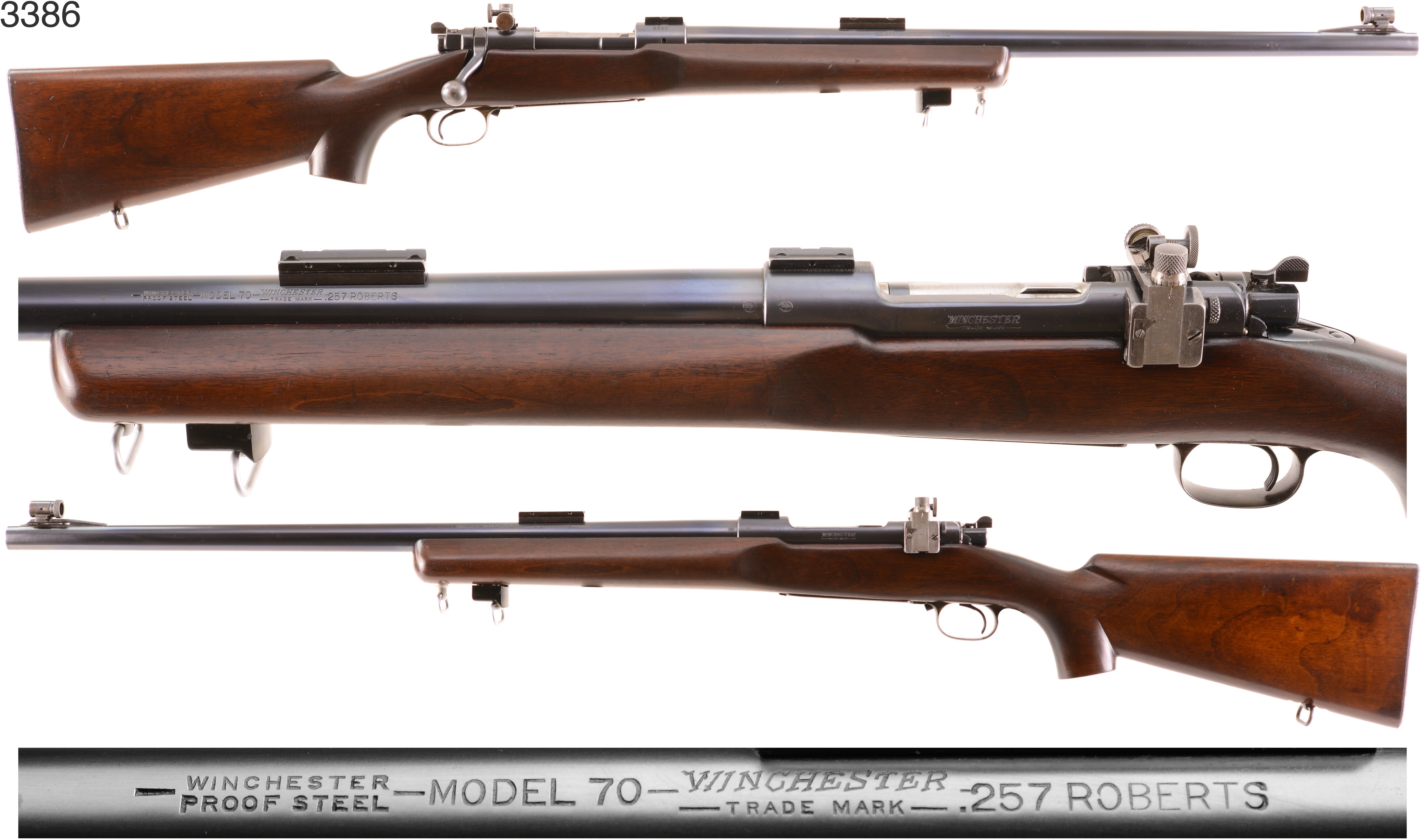

FWIW… So far I’ve only had good experiences with Redding’s Auction house in Gettysburg.  For a business that auctions a lot of firearms, it seems to me they have fewer really questionable M70s than others. Last year I was able to get a genuine and intact 1st variation (ramped) M70 Target rifle in 257 ROBERTS from a Redding Auction.  Try and find one of those with all its parts still attached!!!
Here’s a Redding gun that IMHO is collection worthy:
