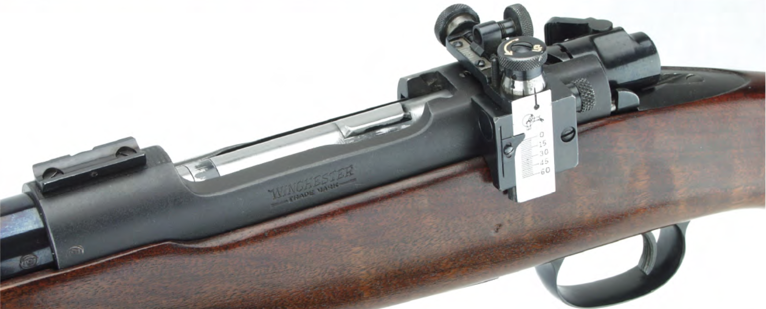

FWIW… Below are pics of the sights that were on S/N 351439 when I got it.  This rifle is a documented Van Orden Sniper, so it has the uncataloged uncheckered standard stock, but the reason I post the pics is b/c these sights (which I did not add) are IMHO the period correct variations for a 1955 M70 target rifle (so probably equally correct for a 1954 gun).  Two things to note…  The Lyman 48WH is a half-block sight with the internal coil spring, not the leaf spring on the left side, and the blocks have Winchester “dimples” on the left.  I think that 1954-55 falls into the overlap zone between the earlier leaf spring and later coil spring 48WH, and the dimpled versus undimpled blocks, so either would likely not raise any eyebrows.  But this is what’s on the gun I’ve got:

Regarding the holes in the receiver, a 1948 M70 could have ether a type II-1/2 or type III-1 receiver.  First photo below (borrowed from a Frontier Guns GI ad) is a 1947 type II-1 Super Grade (S/N 73894 in 22 HORNET).  Note that it has a cloverleaf tang, but smooth bridge that is D&T (two holes) for a scope.  This one also has a factory Lyman 48WJS receiver sight of the “half block” variety that did not require the stock to be cut out.  The Lyman 48WJS design was changed in 1947 and the Lyman receiver sight option was cataloged through 1949, so this combo is factory correct:
Second photo (borrowed from pre64win.com) is a 1948 type III-1 Super Grade (S/N 94869 in 270 WCF).  It has the oval tang, but the same smooth D&T bridge.  This view shows the two receiver sight mounting holes on the left side.  Those six D&T holes (four on top and two on left side rear) would be factory original on any type II or III receiver (with a couple exceptions, but that’s another story… Smile). Any additional holes, e.g. on the left side for a scope side mount, would be non-factory:
I’m a bit perplexed by your description of the sightless barrel.  I’m not sure what you meant by “no dovetail for a front sight”.  The standard M70 barrel in 1948 was 24″ long with a forged INTEGRAL front sight ramp.  Like this (again from pre64win.com and Frontier Guns):
Did you mean there was no ramp, or that the barrel contour is not standard?  IMHO it would be highly unusual for the factory to omit the integral front sight ramp entirely.  Is the barrel still 24″ in length?  Sometimes people would shorten these barrels by about two inches (removing the ramp) to make the gun handier.  When the factory did get around to making “sightless” barrels (a cataloged option from about 1960), they omitted the front sight ramp (which by then was a brazed on, not integral, part) but they also omitted the rear sight dovetail from the barrel boss.  If your rifle has a dovetail for the rear sight, as in the second photo above, it’s very likely that it once had a front sight/ramp as well.
