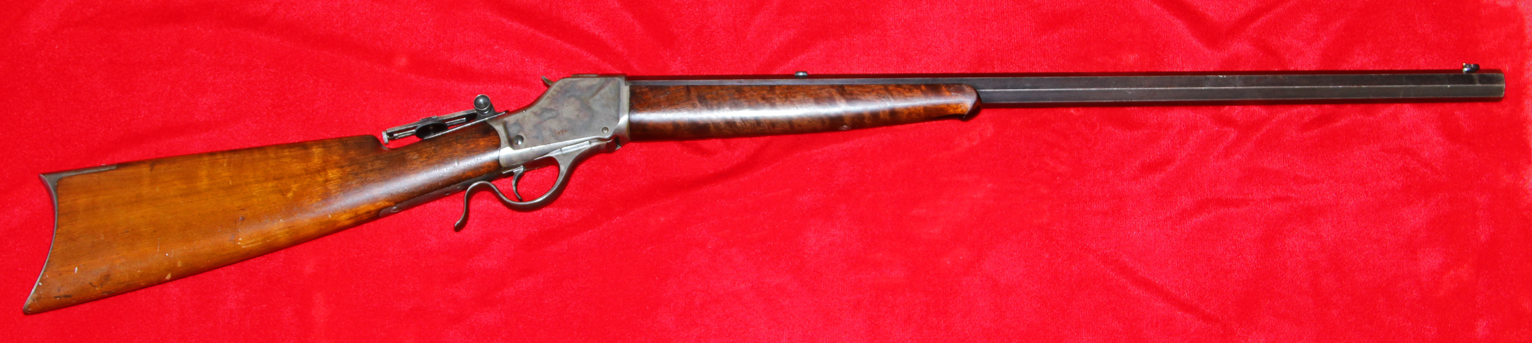

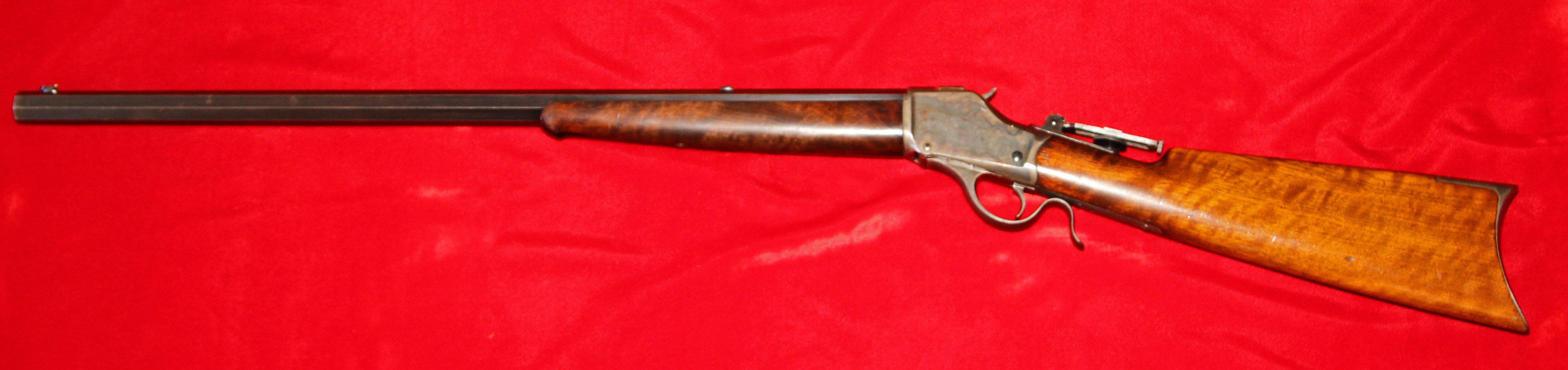

Never owned a Hornet, but I do use the brass to shoot this.

December 13, 2025 - 6:44 pm
Chuck,  that’s a very nice High Wall. A little overbuilt for its chambering but never mind. I assume a .223 groove barrel or is it .224 and the .223 bullet of the Hornet was just because of the availability of the Springfield barrel to Whelen et al.? I always wondered.
Nice! I’ve noticed while perusing Barnes and Woodard’s book the 22 Hornet case is useful to the reloader. I wasn’t aware that 22 Hornet brass stretched excessively, food for thought. I think most manufacturers discourage the use of reloaded ammunition as a matter of course, Bill. Factory ammunition has come a long way since I started reloading but I think my rifles (and wallet) still prefer my reloads.
Most do because their General Counsel are not noted for their XL cojones, an exception being Bill Ruger’s guy, Stephen Sanetti.
The 22 WCF shoots a 45 grain .228″ bullet.  Same diameter as the 22 Savage High Power just a lighter bullet.
