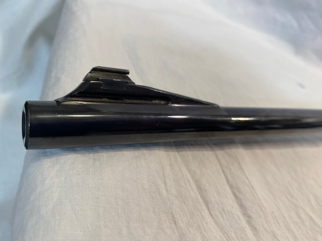

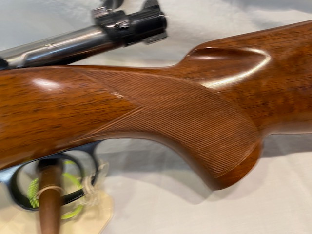

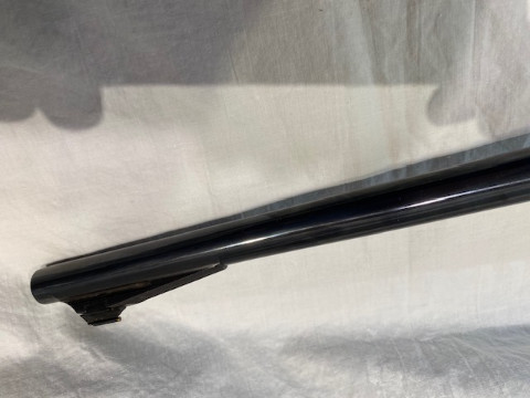

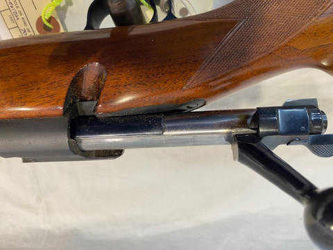

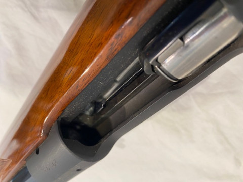

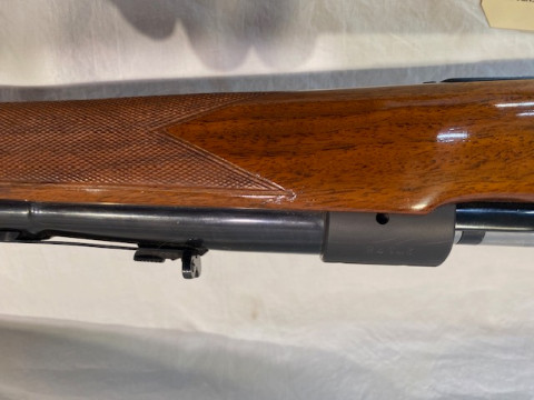

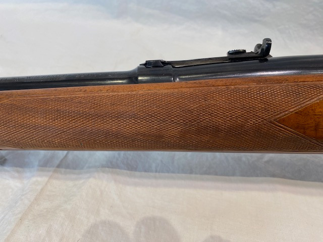

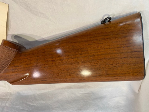

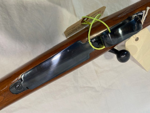

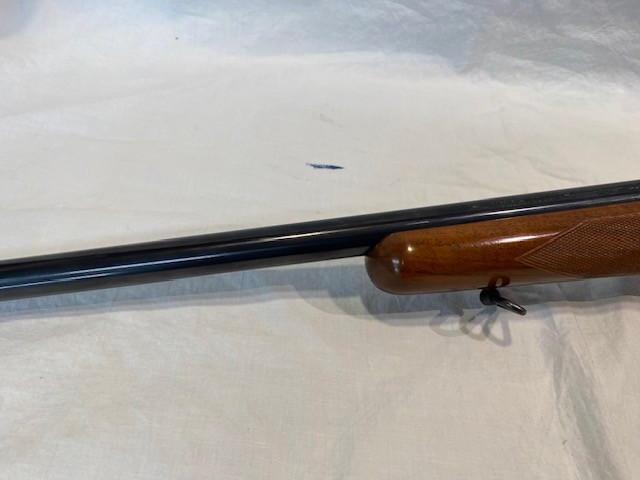

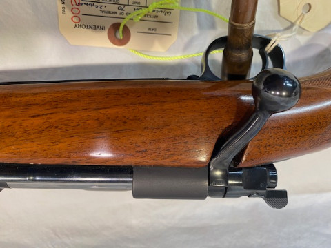

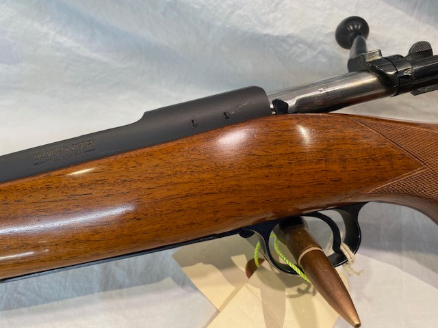

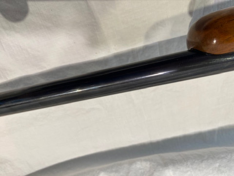

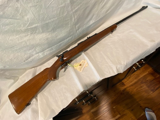

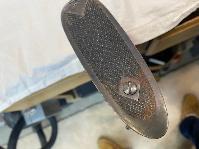

Hi, Y’all-newbie here.  I have come across what I believe is a real find.  It is a 1940 Model 70 in 22 Hornet being sold by the original owner (now 91 years old). He states that he put about 20 rounds through it, then put it away in his safe.  So.. anyone have an idea of the value?  Win-70-1.jpegWin-70-2.jpegWin-70-3.jpegWin-70-4.jpegWin-70-5.jpegWin-70-7.jpegWin-70-8.jpegWin-70-10.jpegWin-70-11.jpegWin-70-12.jpegWin-70-13.jpegWin-70-14.jpegWin-70-15.jpegWin-70-16.jpegWin-70-17.jpegWin-70-18.jpegWin-70-19.jpeg
The remarkable thing is that the gun appears new! Sorry about the picture orientation!

The pictures look nice, but aren’t enough to go on, for me to give you a number. With him being 6 yrs old when the rifle was mfg, we know at least one other person owned it, and with his 20 rounds added to whatever the original owner threw into it, and sent them downstream, how’s the bore? I’m assuming it’s in very nice condition. It’s a rifle that I’ve been looking at, for a while, and have handled a few. I would have to handle this one, before I threw a number on the board.

Looks like an extra hole in the bridge (pic #11)? If so, substantial hit to collector value. Might just be the lighting/pic, but is the wood proud to the butt plate? Again maybe just the lighting/pics, but the bluing on the bolt handle and barrel look pretty shiney in a couple shots. The bluing wear on the butt plate relative to bluing on the rest of the gun is a concern

I cannot assess this rifle from the photos.  It looks “correct” insofar as the parts I can see, e.g. the Lyman 31W front sight…  But to my eye it also looks 100% refinished, wood and metal.  How good is the provenance???  Is that a “shop tag” on the gun???
Pre-war M70 barrels were rust blued.  This looks like hot salt immersion blue (maybe it’s the photos).  Even though some M70 wood finishes are pretty smooth, they don’t look like a Weatherby…  Again, maybe the lighting.  Checkering looks very “fresh”, but sometimes near new pre-war M70 stocks look like that…
One more thing…  When Winchester rust blued barrels the muzzle face was deliberately protected from the acid rust vapor.  So the muzzle face should NOT be blued.  If it is, then the gun’s been redone…
So…  A genuine unaltered 98% or better pre-war M70 Standard Grade 22 HORNET is probably a $4000 rifle these days.  A refinished/restored M70 Standard Grade 22 HORNET +/- a hole in the bridge is still a $1500 gun unless the receiver is Swiss Cheese…  Whatever you do, make sure it’s still a 22 HORNET…  Many of these rifles were rechambered to 22 K HORNET and NOT marked, since you can fire regular 22 HORNET ammo in a K Hornet chamber (that’s how you make K Hornet brass)…

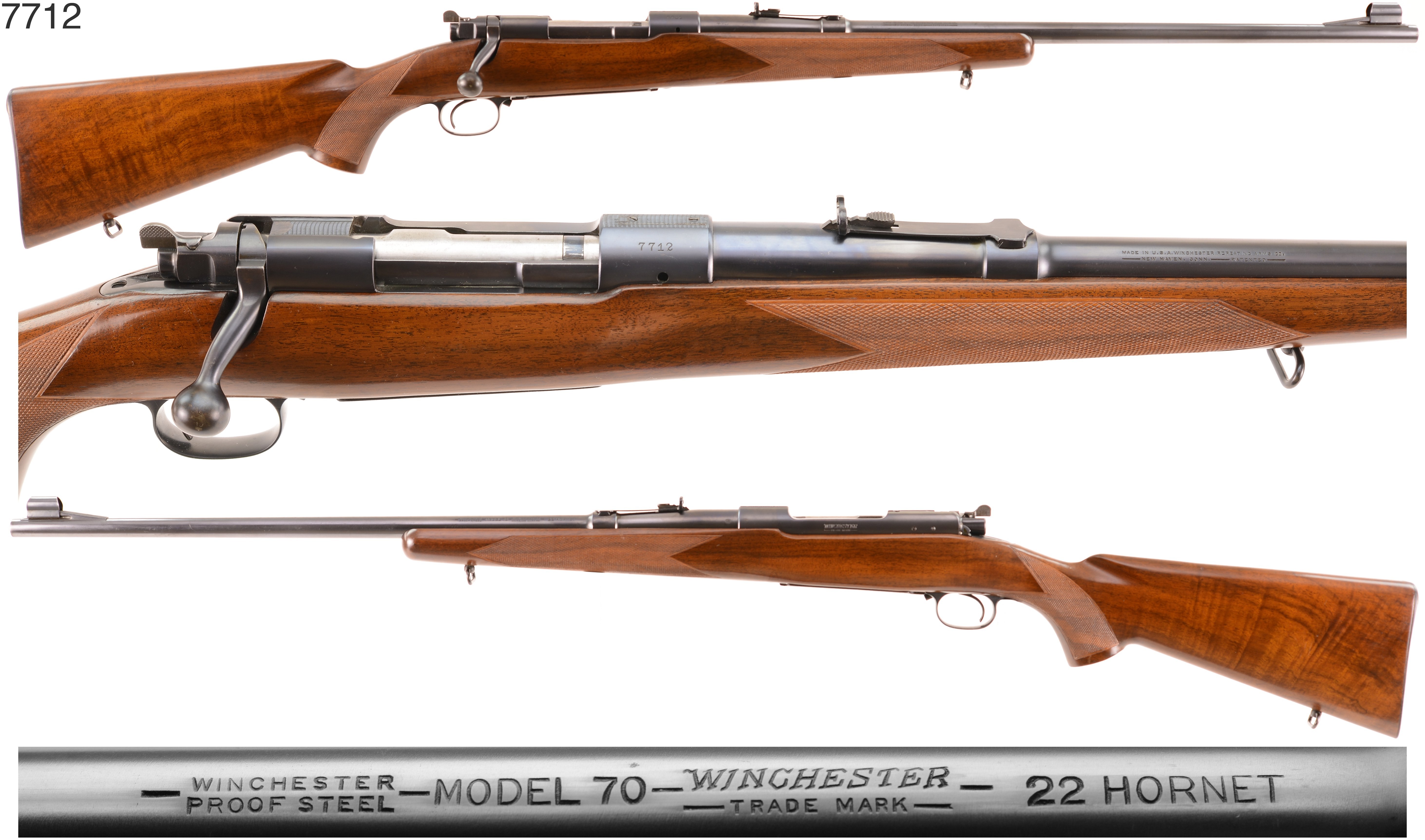

Here is a pretty legit high condition pre-war M70 22 HORNET (of mine) for comparison.  This one is very close to “new” condition so should also be approached with caution.  Laugh

The barrel and bolt handle looks aaaaaaawwwful shiny and the condition of the steel of the buttplate is in stark contrast to the barreled action. As Ted has noted.
The outer edges of the buttstock appear not to mate with the outer edges of the steel buttplate, suggesting the stock was sanded with the buttplate removed, which would conclusively indicate a refinish. In addition, there appear to be dents in the wood filled with uncracked stock finish.
If memory serves me, the stock of a 1940 standard style Model 70 was finished with a sprayed nitrocellulose lacquer, which over 85 years would be expected to darken and take on an amber patina I do not see on this stock. The buttplate doesn’t appear to have spent virtually all of its life in a dark safe. Even in a dark safe, away from UV rays, the lacquer would be expected to oxidize and darken over three quarters of a Century. [CAVEAT:  as photographers know, lighting can effect color, including tone, tint and saturation. A conclusive opinion of wood finish originality is difficult to give absent a hands on inspection in known lighting. In close cases enuine experts can differ and a sample of the finish would have to be spectrographed to settle it.]
I would want to go over the steel with a magnifier and an angled light to look for additional evidence of a reblue. Even I can spot a really amateurish attempt but it gets hard to near impossible fairly fast after that. Dr. Ron Stadt, an advanced Winchester shotgun collector and himself a skilled craftsman teaching industrial arts at the university level, wrote that if the steel were properly processed a reblue was impossible to detect. Many collectors disagree with him but every art critic I’ve met is sure he or she can’t be fooled, either.
An all original standard grade Model 70 Hornet with no extra holes, in actual 98% condition, might have once brought $4500 and up but i don’t think there’s as much bloom on that rose as once. People buy them as shooters too, so there’s certainly more floor than under a 30/06. Reblued with refinished wood is anybody’s guess but I’d say maybe $1500 to $2000 on a very good day. In these matters my opinion is worth slightly less than what you paid for it.

I’m in full agreement with Zeb, as far as Ted K, and Louis expert opinions. Those would be a couple of the best go to guys for me, on the model 70, as a few others are also very astute, on them.
I most certainly didn’t notice the extra hole on the bridge that Ted pointed out, as I lost my ambition with the pictures or lack of better pics. IMO!
Louis pointed out something that I also had my doubts on, and that was the tone of bluing or the color of what appears to be re blued or re finished. Looks to be more than just bad lighting to me.
I would ride these guys backs any time it came to a model 70, and value they’re opinion, as they might have saved you some valuable $$$!

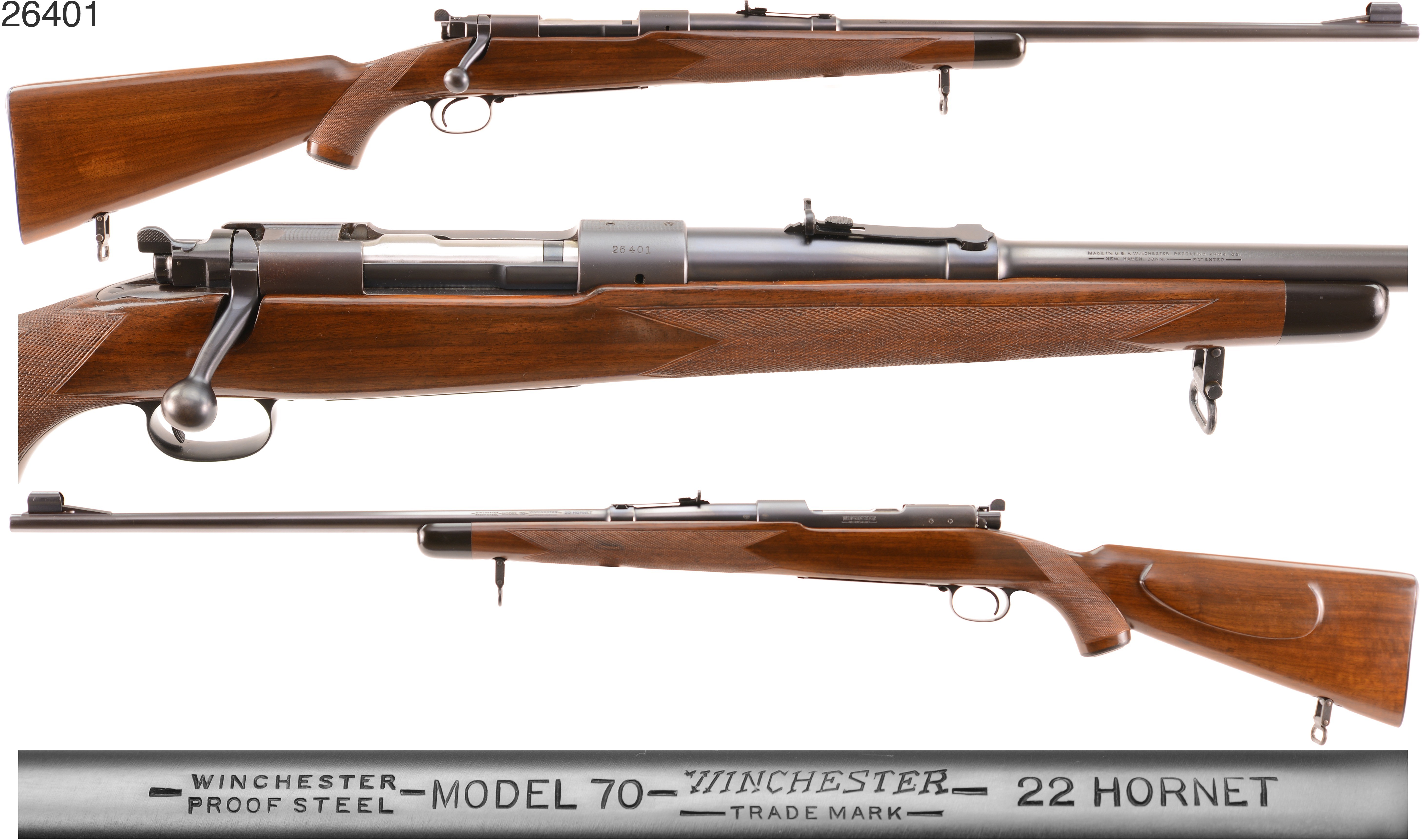

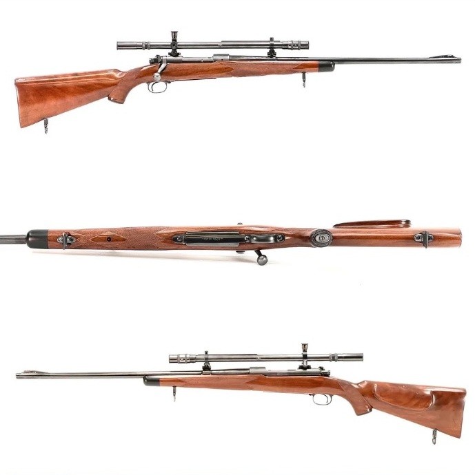

Question for the members…  What’s this one worth nowadays?  It used to belong to Vic Vanb, who used it in his M70 displays at gun shows.  Pre-war (s/n 26401) from 1939, near new condition.  Vic was a stickler for originality, and you’ll note that the front swivel base position on this one is close to the black fore end tip, a feature only found on early Super Grade stocks…  Most likely a legit 1939 Super Grade IMHO…  I paid $5581.25 (including Buyer’s Premium) for it in November 2019.  Probably too much, but I’ve never bought guns as an “investment strategy” and I like this one…

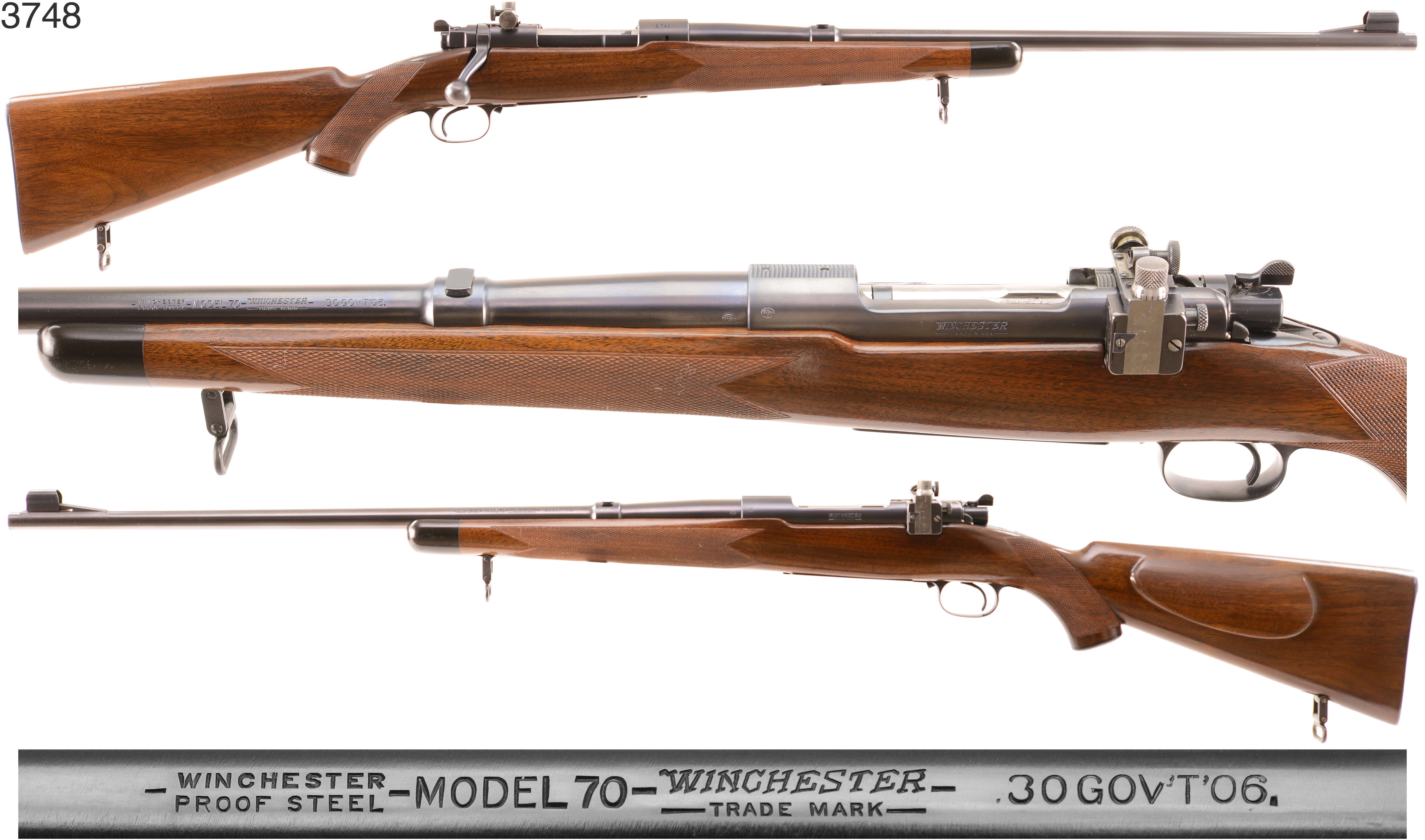

IMHO the “quintessential” Model 70 is a Type I-1 Standard Rifle in 30 GOV’T’06, b/c that’s what’s pictured in the early catalogs.  This clip from the 1938 Salesman’s Handbook and corresponding rifle.

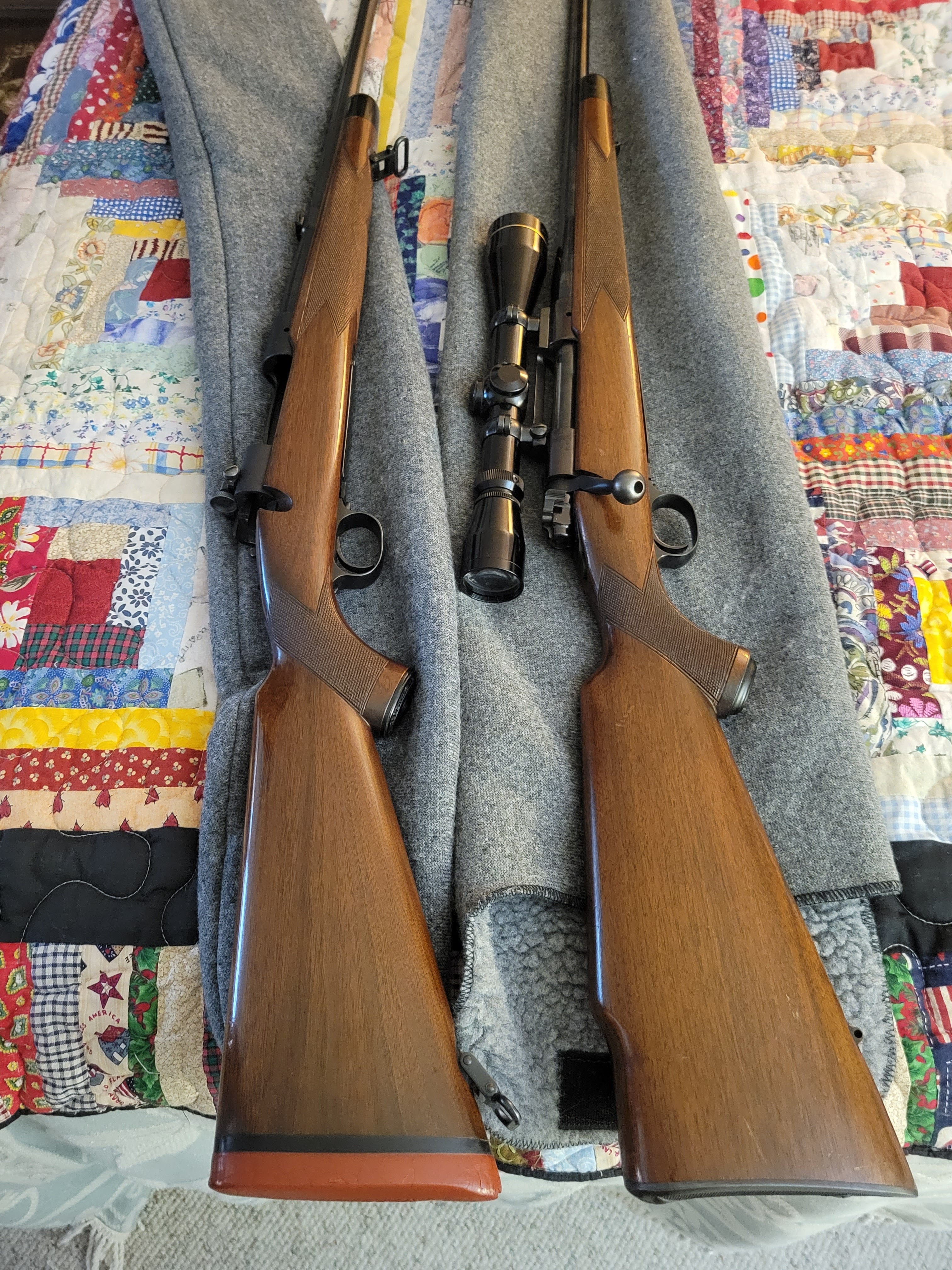

I had a 1951 Standard in 270 with the same Stith Streamline Mount and Weaver K3.  It was missing more blue and some of it had turned to plum. The lacquer had flaked off in places. Ren Wax. Auctioned it on GB and it closed a little shy of $1,100. Our friends at Pre64Win got it and I always wonder whether they parted it out or refinished it.
Anybody who calls himself a Winchester collector and sneers at a nice 1955 Super Grade 30/06 is a moron with no real understanding of our hobby.. Like a corpse, he’s unpleasant to be around and probably smells bad. He just doesn’t know it.
The Model 70 that will rest in my cold dead hands is the 1950 Super Grade .30 Gov’t ’06 I illustrated. It now wears a Lyman 48 WJS-H and a Redfield Sourdough up front. Because I like the way it looks and carries. When it wore a Leupold 2.5 – 8 VariX III it would consistently shoot Winchester 180 grain premium factory into 1.2  moa for 3 rounds. A joke by current long range standards but if I could hit a coffee can lid at 300 yards, it was all I ever wanted. I will not shoot at an unwounded game animal past about 250 yards. Not the rifle’s fault; too much coffee.
