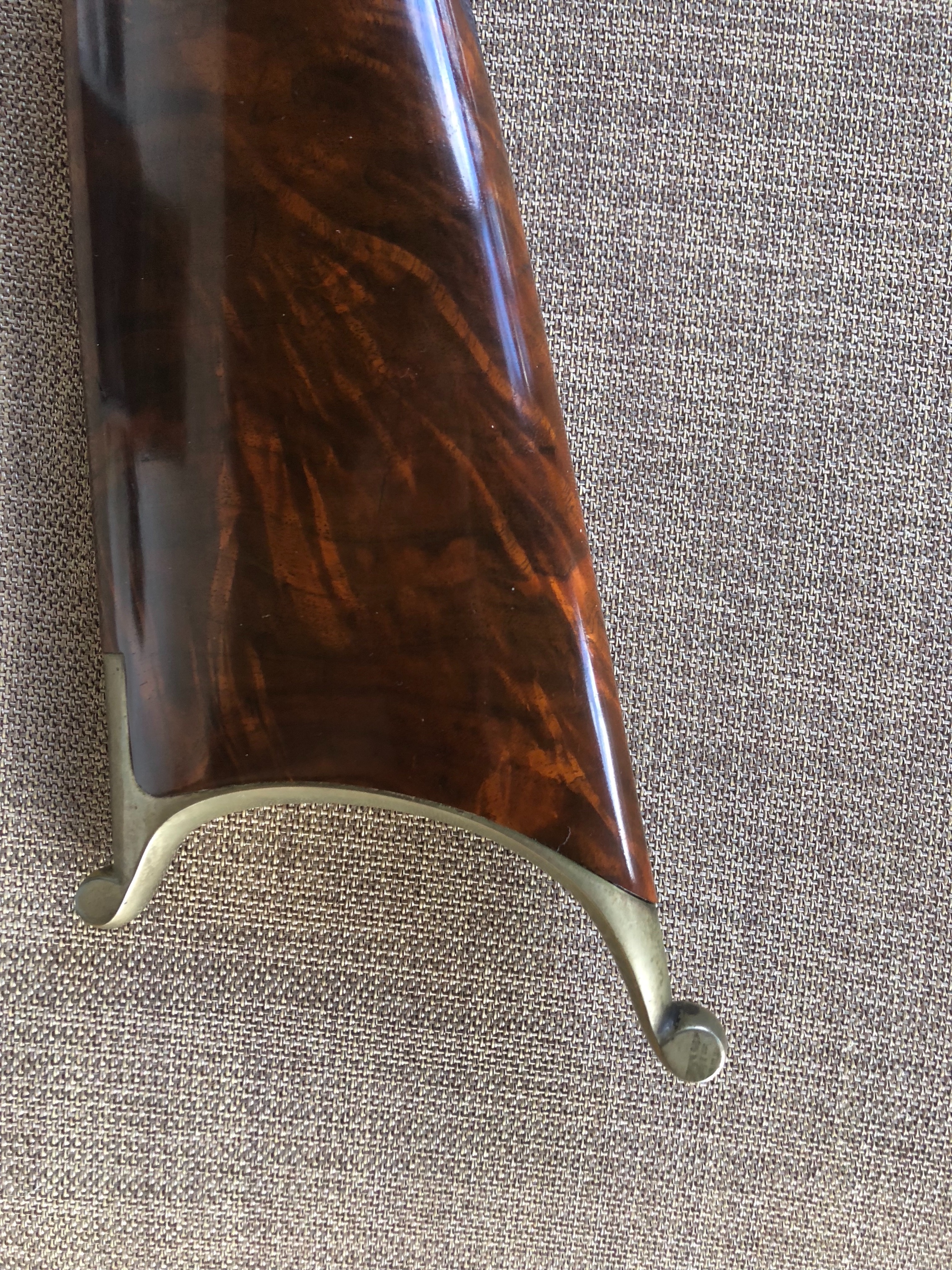

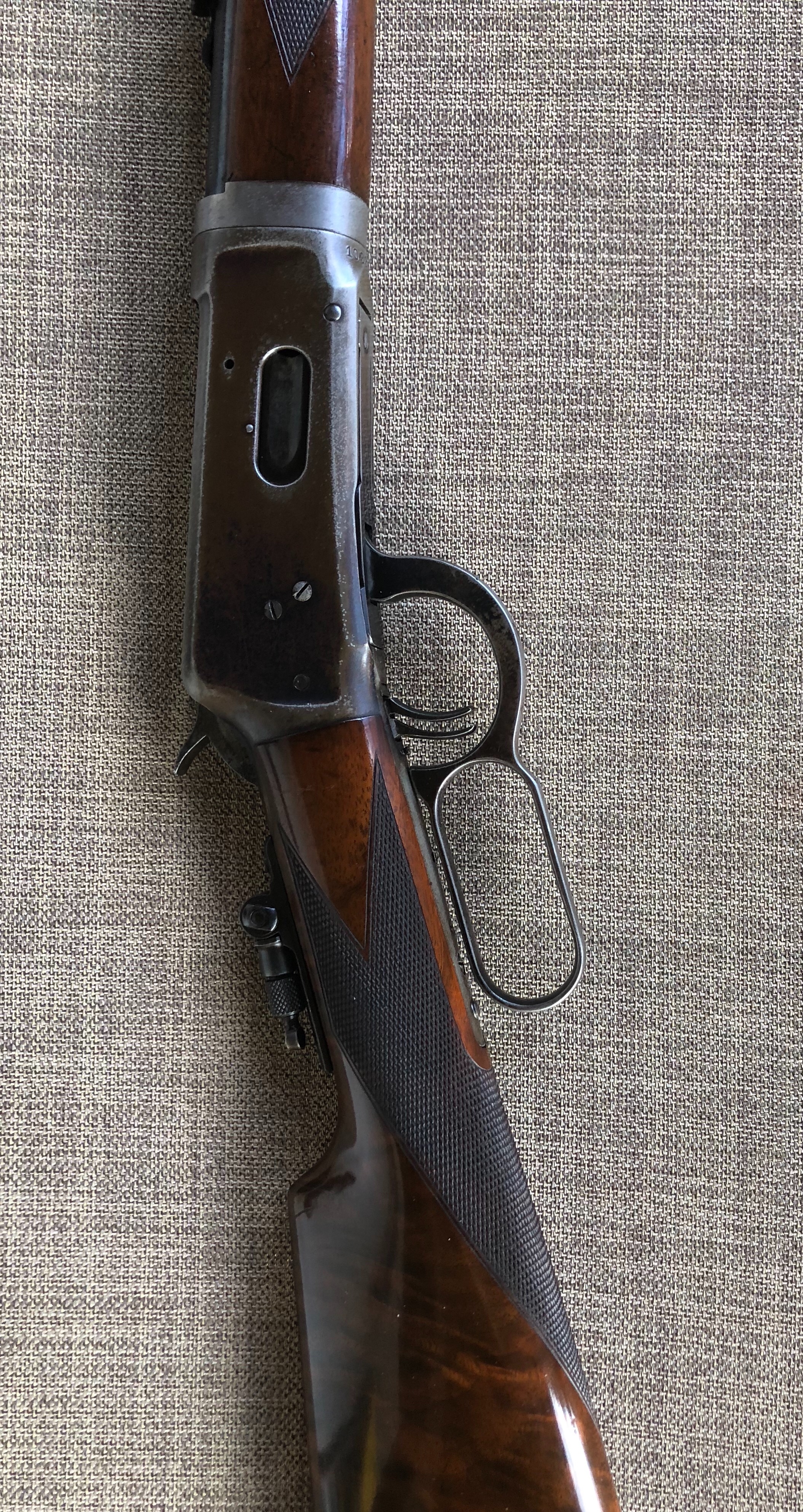

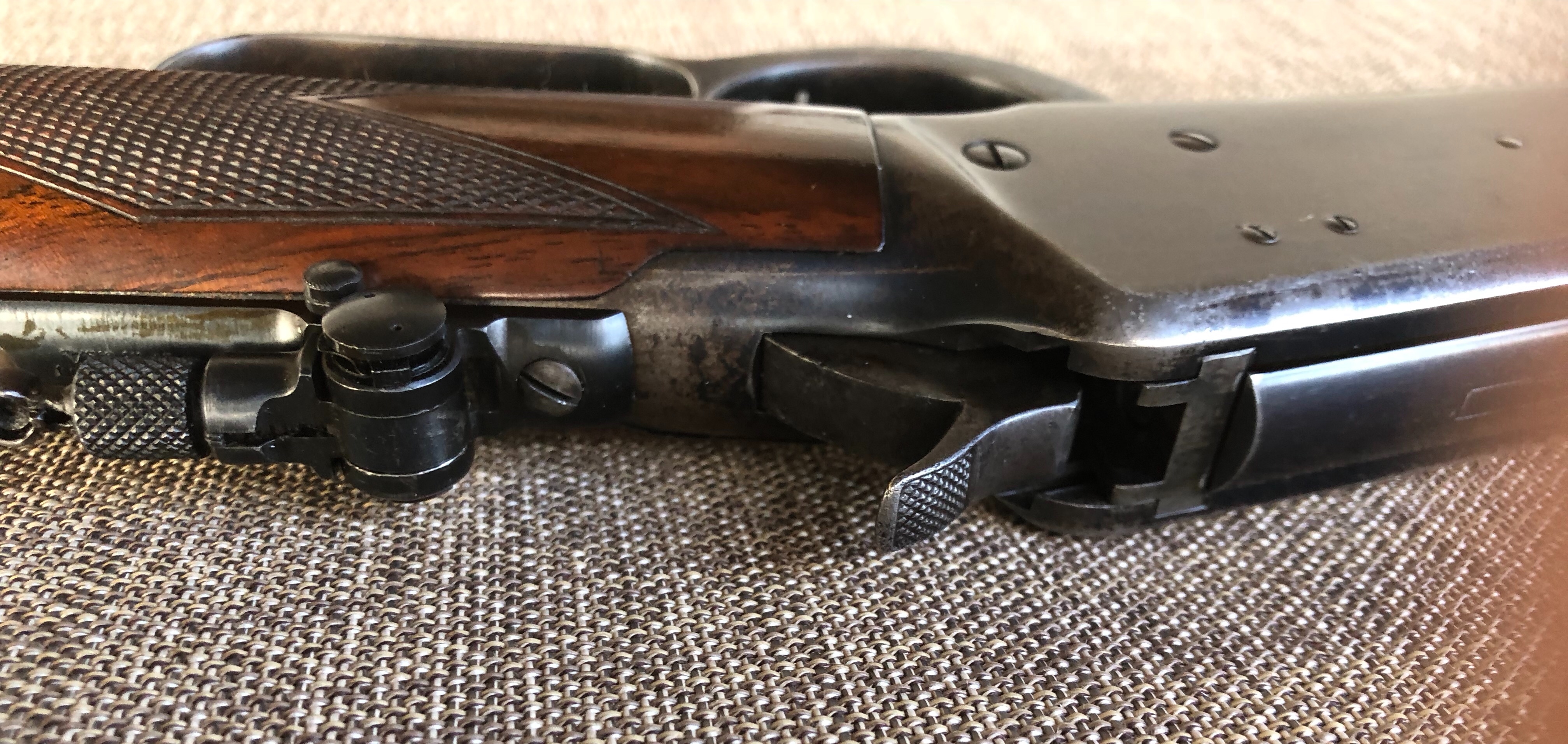

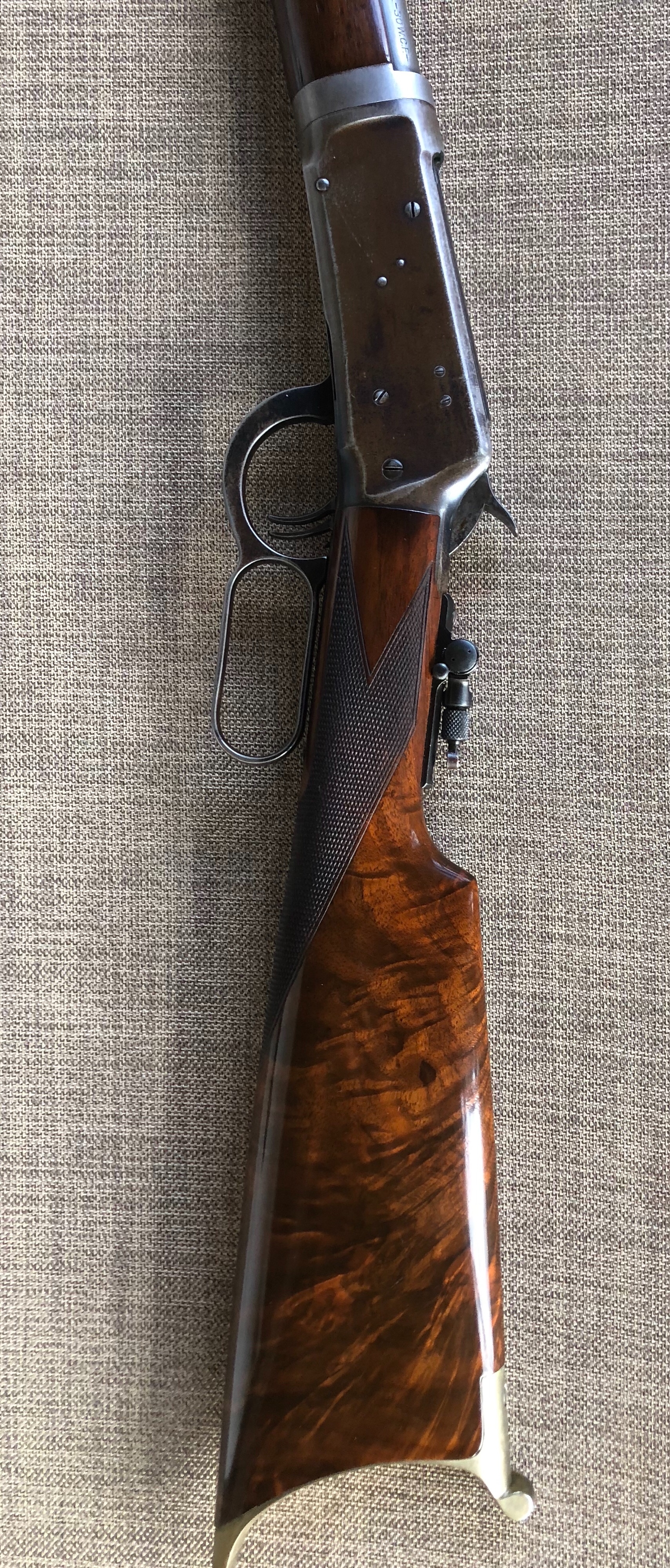

7ADA2D63-CA32-4017-B5F5-9C73467BF290.jpeg49127431-235D-459C-8A9A-132AEA958D7C.jpeg0C0D438D-1297-44D4-B42D-E51E378C0707.jpegB6096100-63AB-461E-9AEB-4E48E561AEAD.jpegEA0041E7-14AF-48B9-8C03-57158F830BEB.jpeg6F6F4F09-8C10-4C4E-B695-7BE785D9E78C.jpegE8BA0EBA-BDC4-4F74-9F11-9747A7164868.jpegDC0CEE39-BED8-4D69-8B41-BB6B94A7F755.jpeg103AD8AD-B6DC-4BC7-9275-A29C153CF99F.jpegHello everyone, Here is a model 55 I bought when I  was a young man. I thought the gun was cool. I had ask the forum if they ever made Deluxe model 55 rifles and Bert explained that they did not offer deluxe 55s but you could order special options. To be classified as a semi-deluxe or deluxe the stock would haft to have a pistol grip. So someone went to great expense to have a xxx fancy straight grip stock put on this rifle. Even though it’s not original it sure is cool. Any thoughts on the set triggers originality?

Your Model 55 Rifle appears to be factory original in all respects, and you are correct in that someone went to great expense to special order it as it is today.  Based on the configuration of your rifle, it can be classified as a “Fancy” Sporting Rifle, with a special order straight grip butt stock.
Have you ever taken the butt stock off of the receiver frame, or removed the Swiss butt plate?  If you are so inclined, carefully remove the butt plate and the butt stock.  You should find a matching assembly number marked on the under side of the Swiss butt plate and on the end grain of the butt stock.  You should also find a matching assembly number marked on the left side of the lower tang and possibly on the butt stock in the inletted area for the upper tang.
