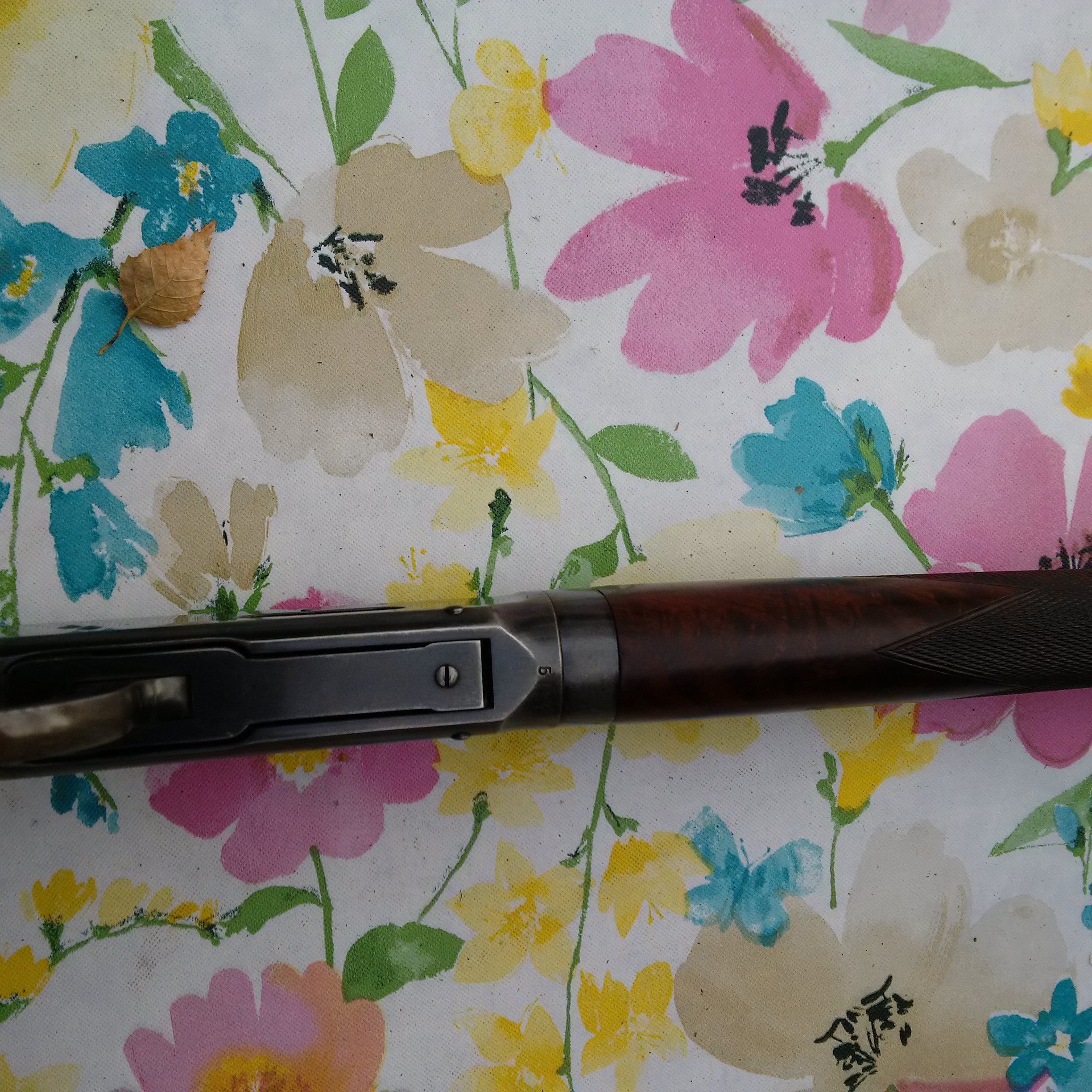

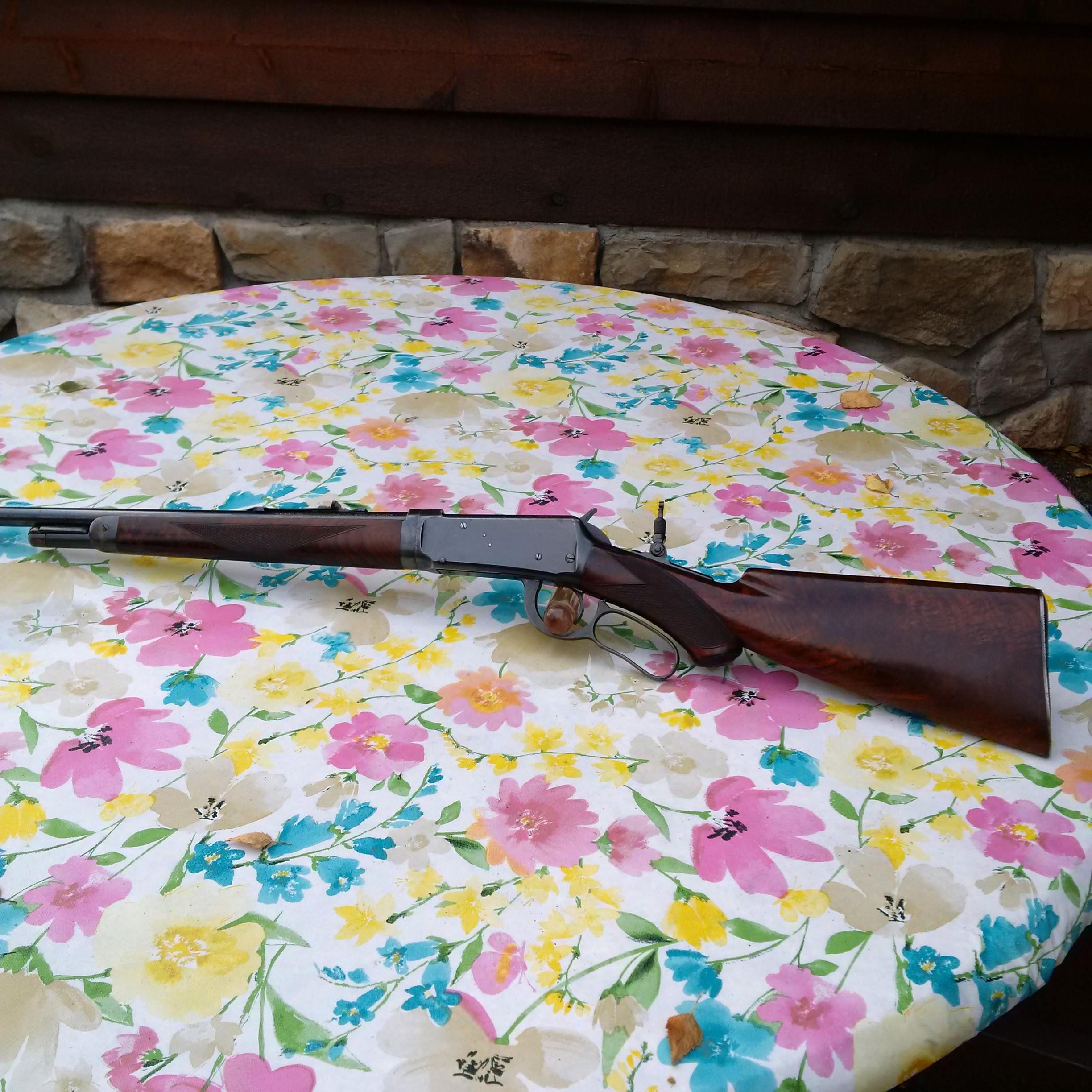

model55.jpg555.jpgModel 55 with H-style checkering and capped pistol grip – I have always called it a deluxe – serial number is 5.

Burt, what an awesome rare winchester. Wow!!!
I agree, that’s one heck of a M55….. thanks for posting.

Burt Humphrey
Forum Posts: 673
April 1, 2005
September 16, 2017 - 5:14 am
thanks – it has been in my safe for 40 years – I had not thought about it in a long time and then I saw the post inquiring as to whether they ever made a Deluxe 55. As I said, I have always called it a “deluxe” but Bert set me straight about “deluxes” several years ago. As Bert said Winchester apparently did not offer a deluxe version of the model 55 in their catalog so we are left with what collectors want to call a deluxe, or semi-deluxe – there are lots of opinions on that. I like Model 55’s and any new collector should tuck away a nice one, if they can find it, before they are gone or too expensive. I also have a near new standard grade 55, serial #42. I always wanted to have a checkered Model 53 – that is a rare one. I have only seen two of them and passed on one in 44 wcf many years ago because it was only about 70% – big mistake on my part!
Burt,
Serial #4 is currently for sale on Guns International and is in the same configuration as your serial #5.  The price is kinda steep.  Yours appears to be in much better condition.  Thanks for sharing the pictures.  She’s a beauty.
