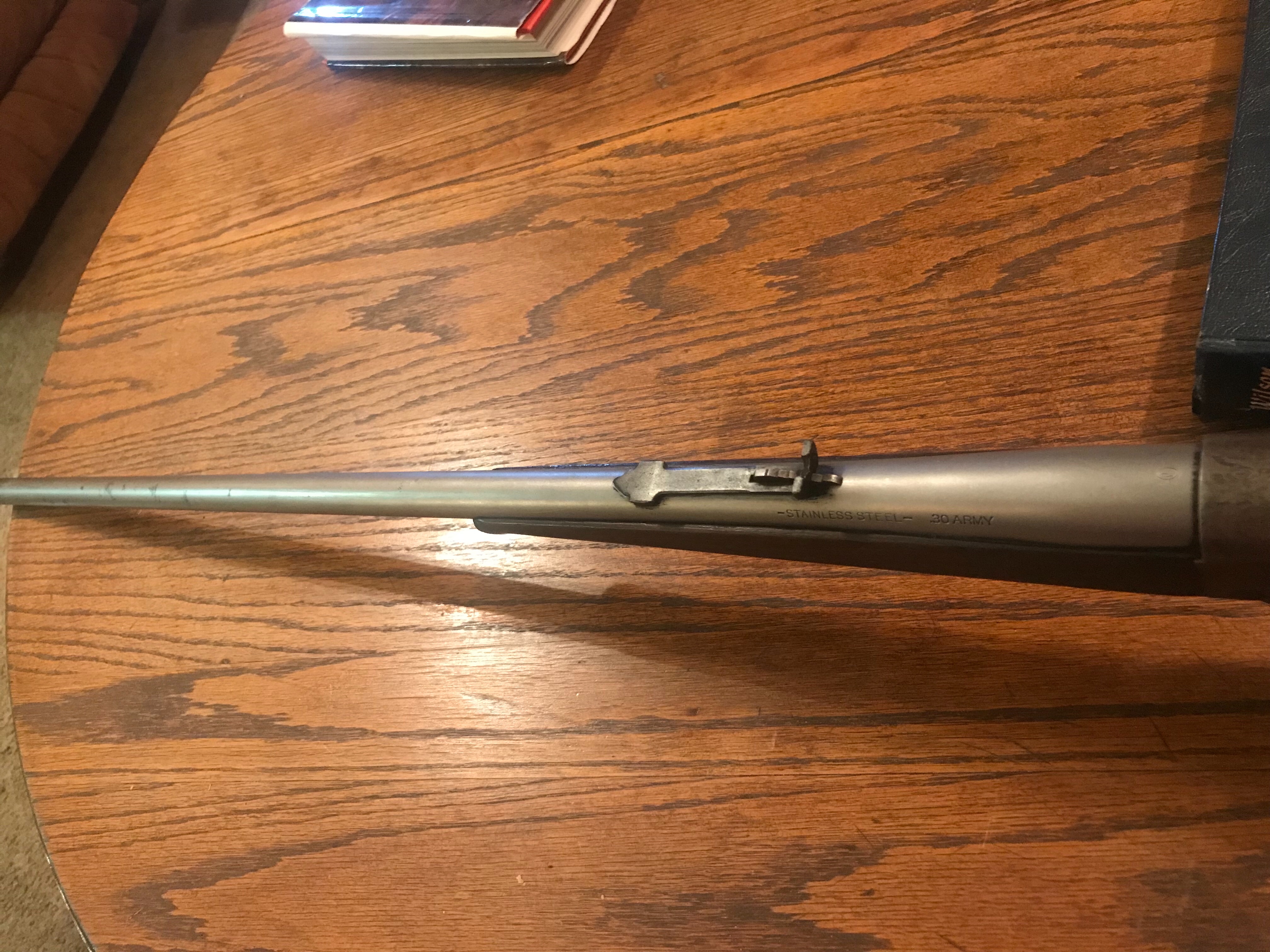

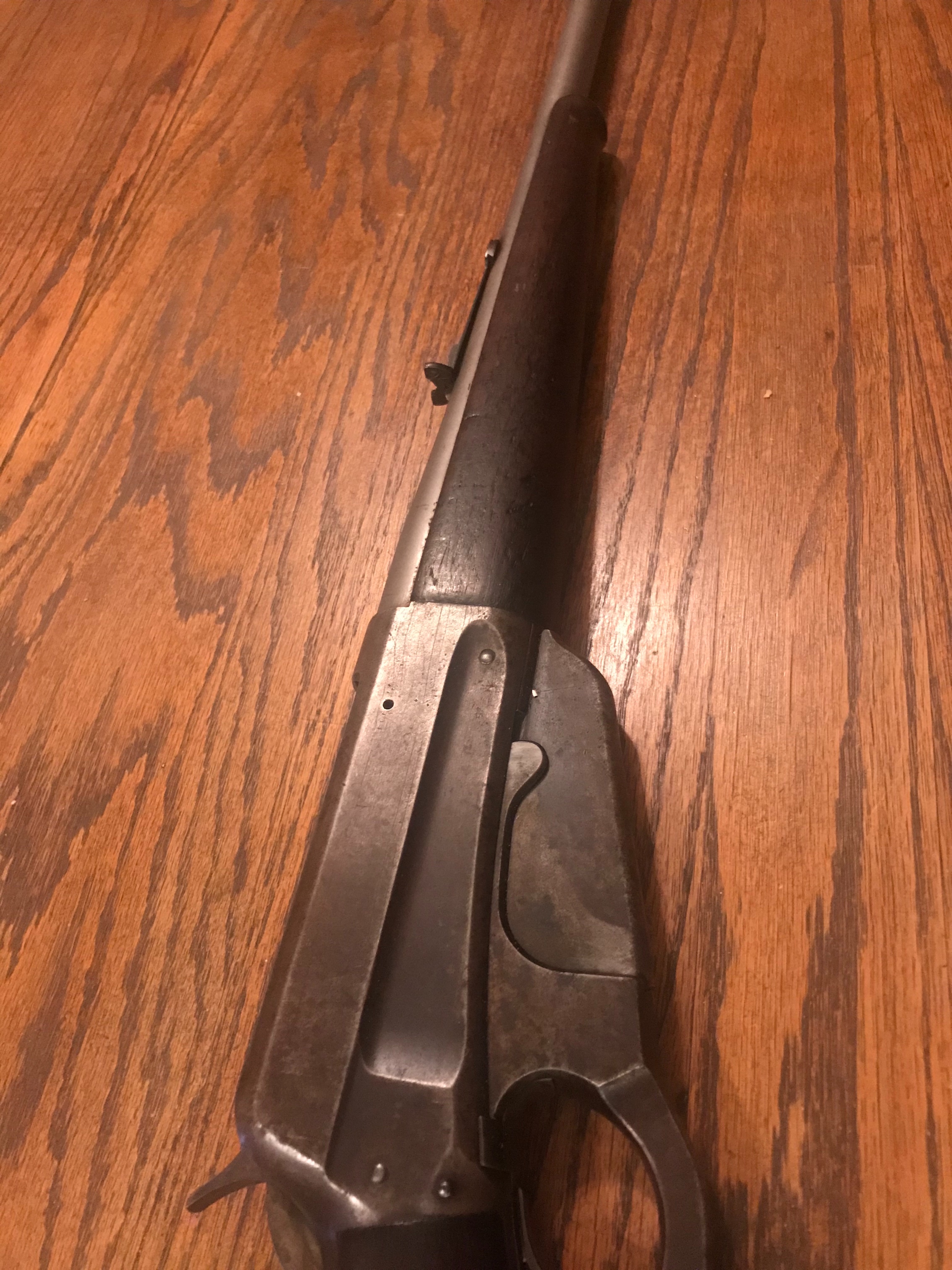

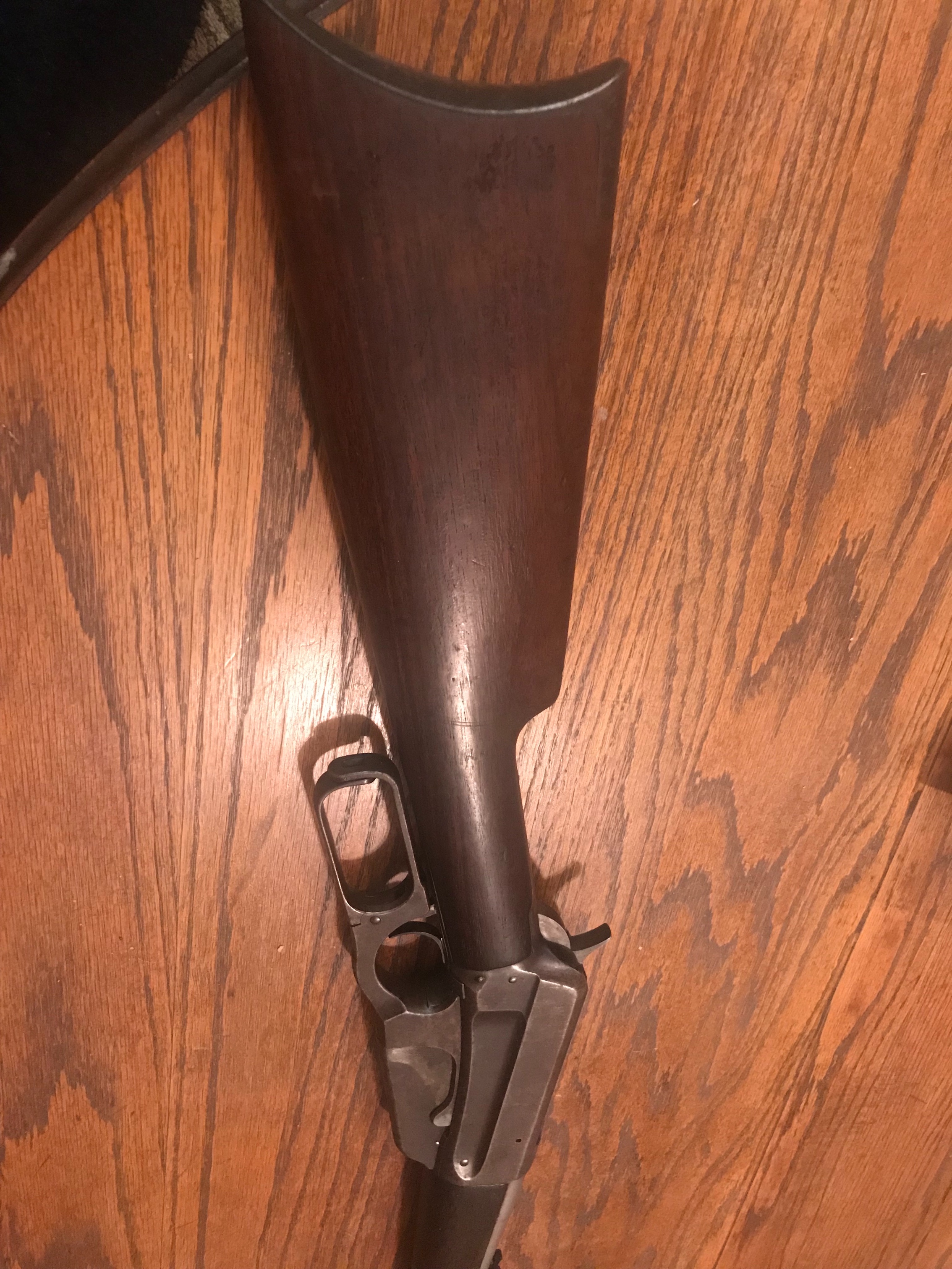

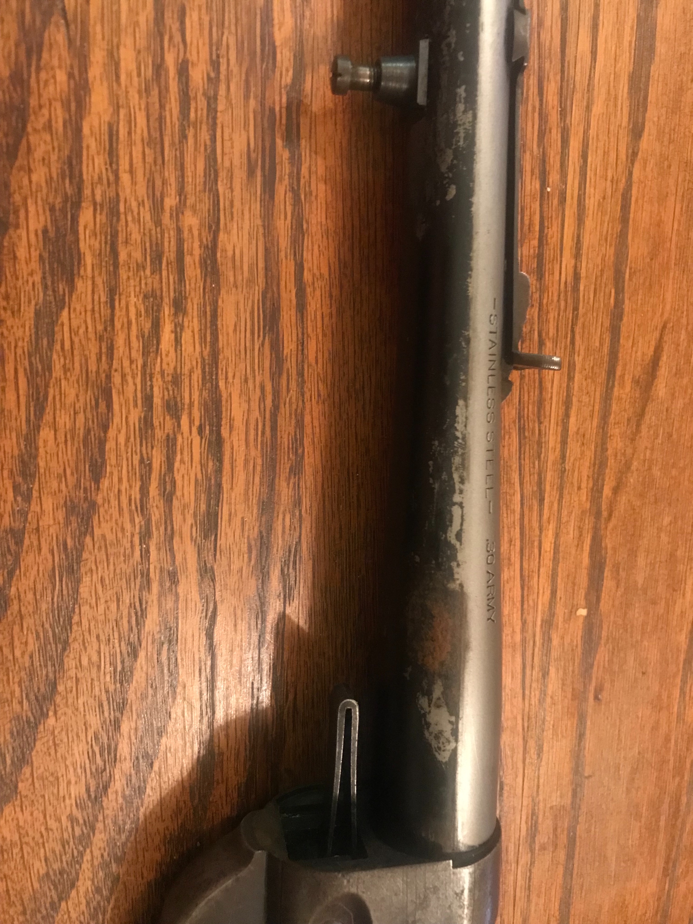

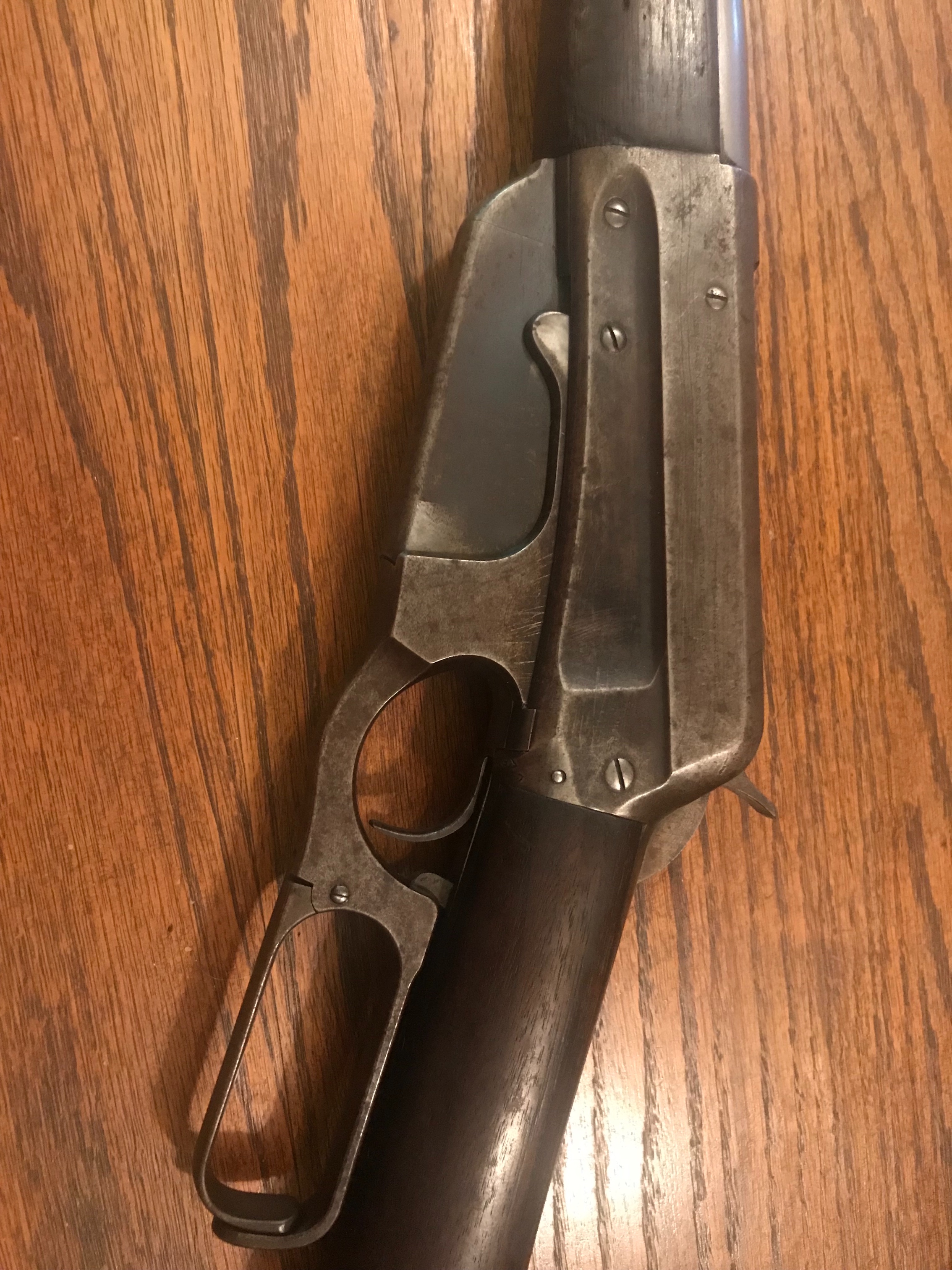

F768110C-7DA7-4DFD-9423-6C53A66CE121.jpeg13C73EAE-E921-4BF1-A9A4-E5F764970EFE.jpegDE22FA78-9DF3-410B-9AAE-FED019F300B5.jpeg5593CA5D-B71C-48A0-9D56-D991E2D41D4A.jpeg45FC0149-AD81-4B83-9E6A-E8FFAA6794FD.jpeg9E969A5E-DCDF-4A4F-85EF-40C864DB74BD.jpeg8227717E-3170-475F-A1A4-BCBE7C580FD9.jpegI picked up a few Winchesters yesterday at a small estate auction.  I’m looking for info on this Model 1895 with Stainless Steel barrel and low serial number.  I looked through my Madis books and couldn’t find anything about it.  Any info would be much appreciated.
WINCHESTER BABE
Forum Posts: 14937
December 10, 2017 - 7:07 pm
The first thing that I would do is call the CFM and get a research sheet for it.  The next thing I would do is pull the forend stock off, and inspect all of the markings stamped on the underside of the barrel.  At a minimum, you should find a 2-digit year number.  Hopefully, it will also have a work order number stamped on it, and the research sheet shows an R&R with the matching order number.  If you do take the forend stock off, please post pictures of what you find.

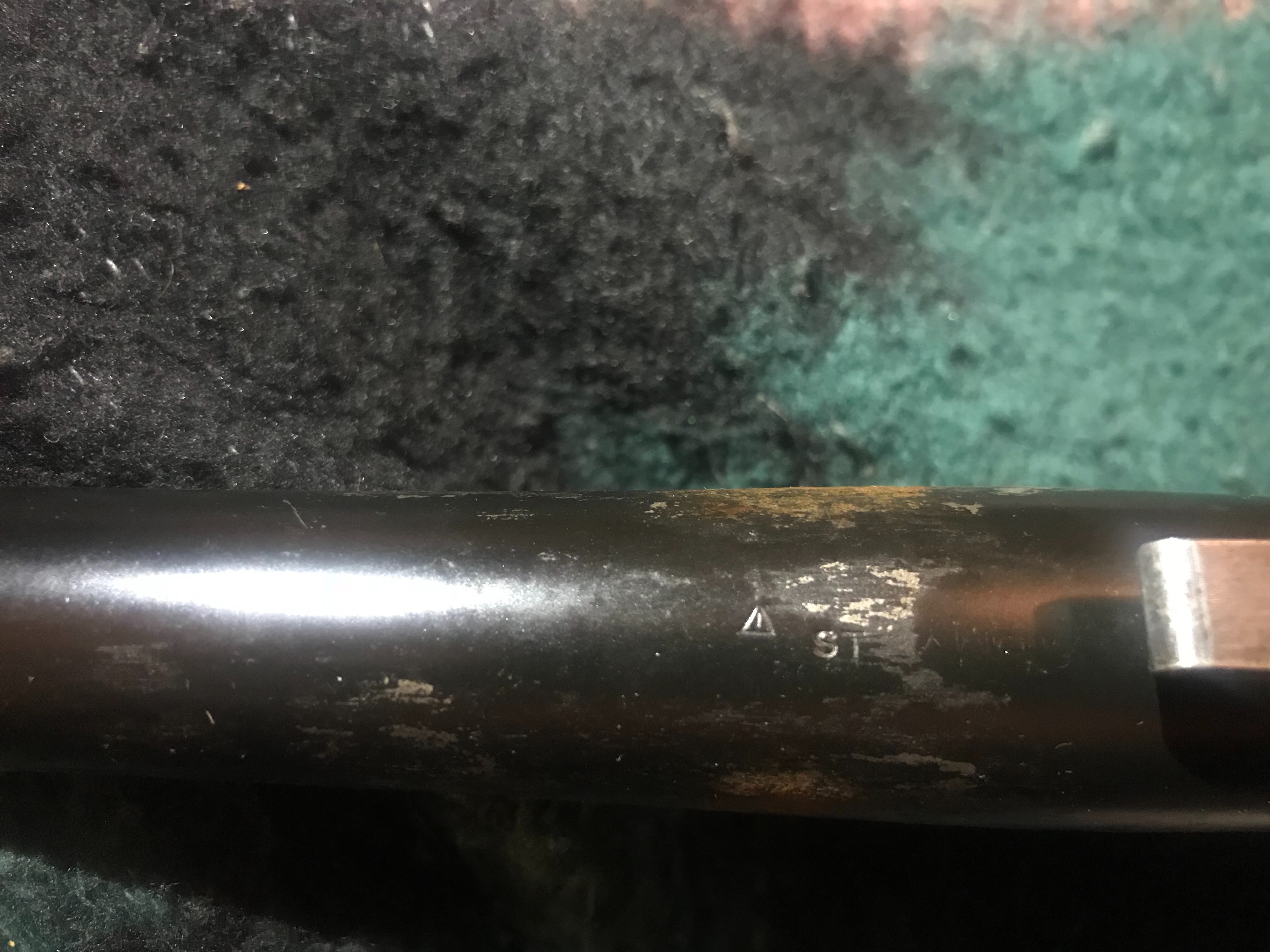

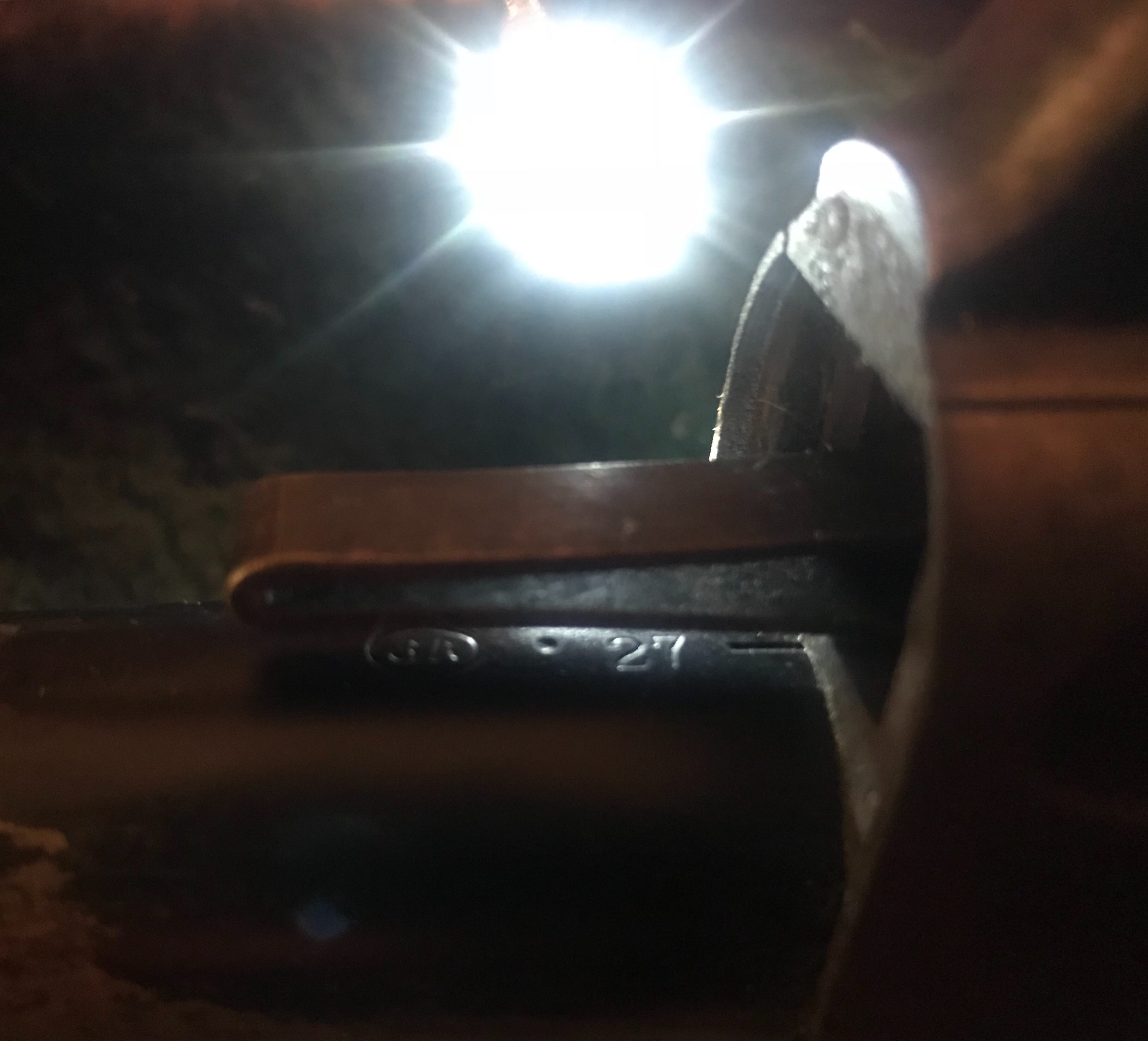

5194C2C0-F044-4ACE-8D97-86E1E84DC466.jpeg5E685024-CE5E-43CD-B63A-80E34718FA53.jpeg0E32043E-4B69-4E61-8D5F-84EE225BD7FD.jpegI am a member, thanks for the clarification.  Here are the pics from under the forearm.  The 2 digit number is 27, there is also an ST, also ARMY  and there are a couple markings that I can’t tell what they are.  Does this mean that it went back to the factory for the barrel in 1927?
WINCHESTER BABE
Forum Posts: 14937
December 10, 2017 - 10:38 pm
No, it does not necessarily mean that it was sent back to Winchester in 1927.  The barrel was manufactured in the year 1927.  There is no way to know when it was installed unless the ledger records show an R&R in 1927 or later, which in unfortunately unlikely.
The “ST” marking is shorthand for “Stainless”, and the “ARMY” marking is the caliber.

The rifle was originally made before PW proofs were used by Winchester. Now the rifle has proofs on both barrel and receiver. That is a good sign that the barrel was replaced by Winchester sometime after 1927 at Winchester. Winchester did often/usually proof mark the PW on such a rework on both the receiver and barrel after test firing the reworked rifle. If the barrel was sent to an outside of Winchester gunsmith for replacement, then the barrel would have a Circle P proof and none on the receiver. Winchester did not always do everything the same way over the years. But I have a 1895 early serial with similar proofed replacement plain steel barrel and receiver as well.

Your logic is sound on this, but unfortunately, it is no guaranty that Winchester did the work.  There are simpply way too many fake “WP” (Winchester Proof) stamps out there in the hands of people with less than honest intentions.  This is not an absolute, but in general, there should be a work order number stamped on the bottom of the barrel, and it should match up with the order number recorded with an R&R entry.
