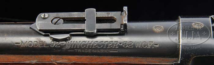

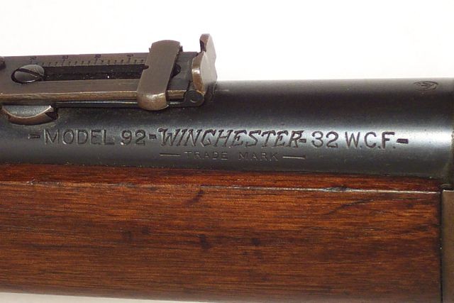

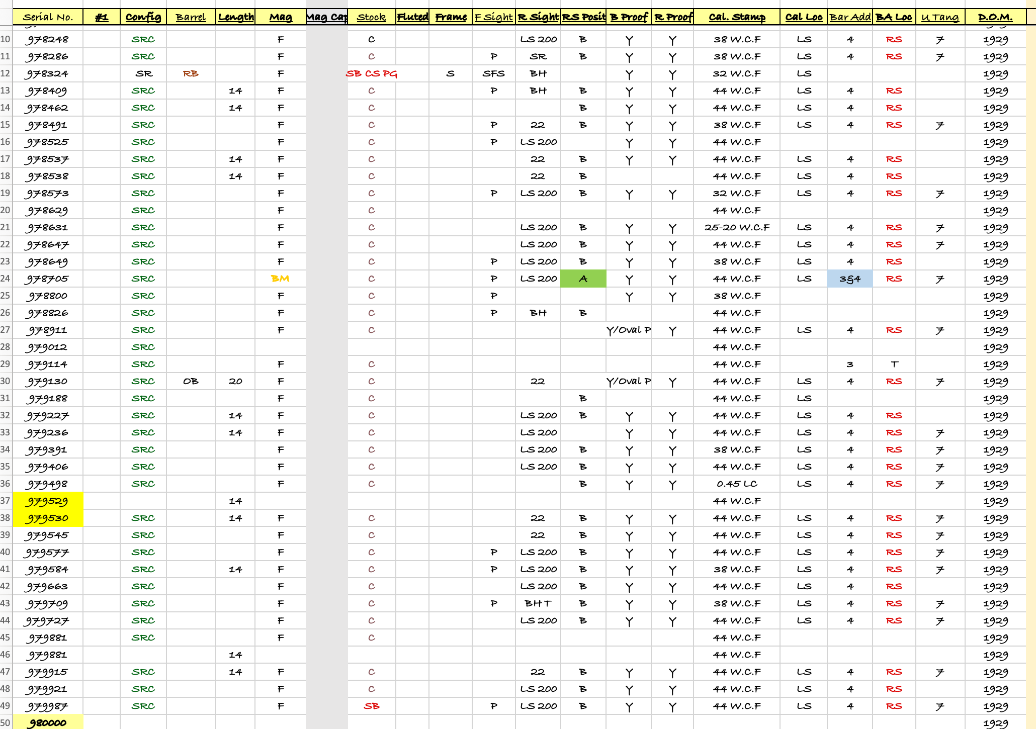

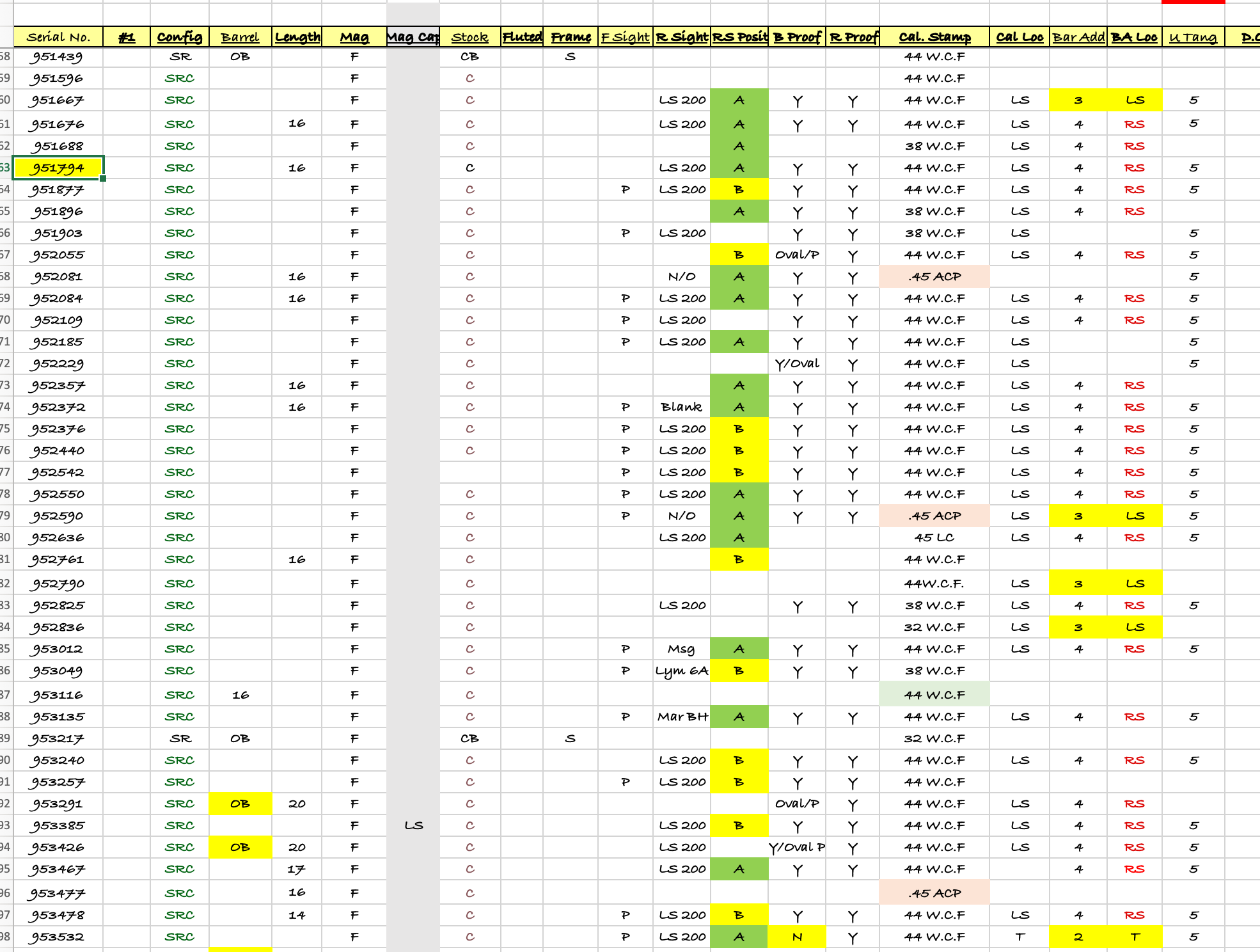

During the year 1926 Winchester began to produce barrels on which the rear sight dovetail was position a bit further from the receiver face.   This was done in order to allow for a longer buckhorn rear sight to be used on the carbine instead of the much more typical folding leaf sight.  In the attached portion of my spreadsheet the position is noted as either “A” (in green) the original location, or “B” (in yellow) the new position.  This difference gives the appearance of the Model designation on the left side of the barrel and the barrel address stamp on the right side as being positioned differently when in fact it is the dovetail that has moved.
Between serial number 951154 to 956039 of the Model 92’s I have seen (91 so far) EVERY one is a saddle ring carbine. 44WCF is by far the dominant caliber with a small number of 38 WCF examples. That is a span of 4885 rifles. Within the rifles that I have sampled, 16 have a 16 inch barrel, 4 have a 14 inch barrel and 1 is a 17 inch barrel. So 23 % of the carbines within just this small group are “trappers”! Therefore 1,123 trappers were made JUST in this interval!! These rifles really are not rare.  I would also begin to question the idea of “special order” regarding these guns.  I doubt that each one was made for “Bob in Idaho” who requested one but rather Winchester knew that people wanted then and therefore just made a bunch, warehoused them, and sent them out as later requested.  The second portion of my spreadsheet show the same sort of occurrence but with 14 inch carbines.

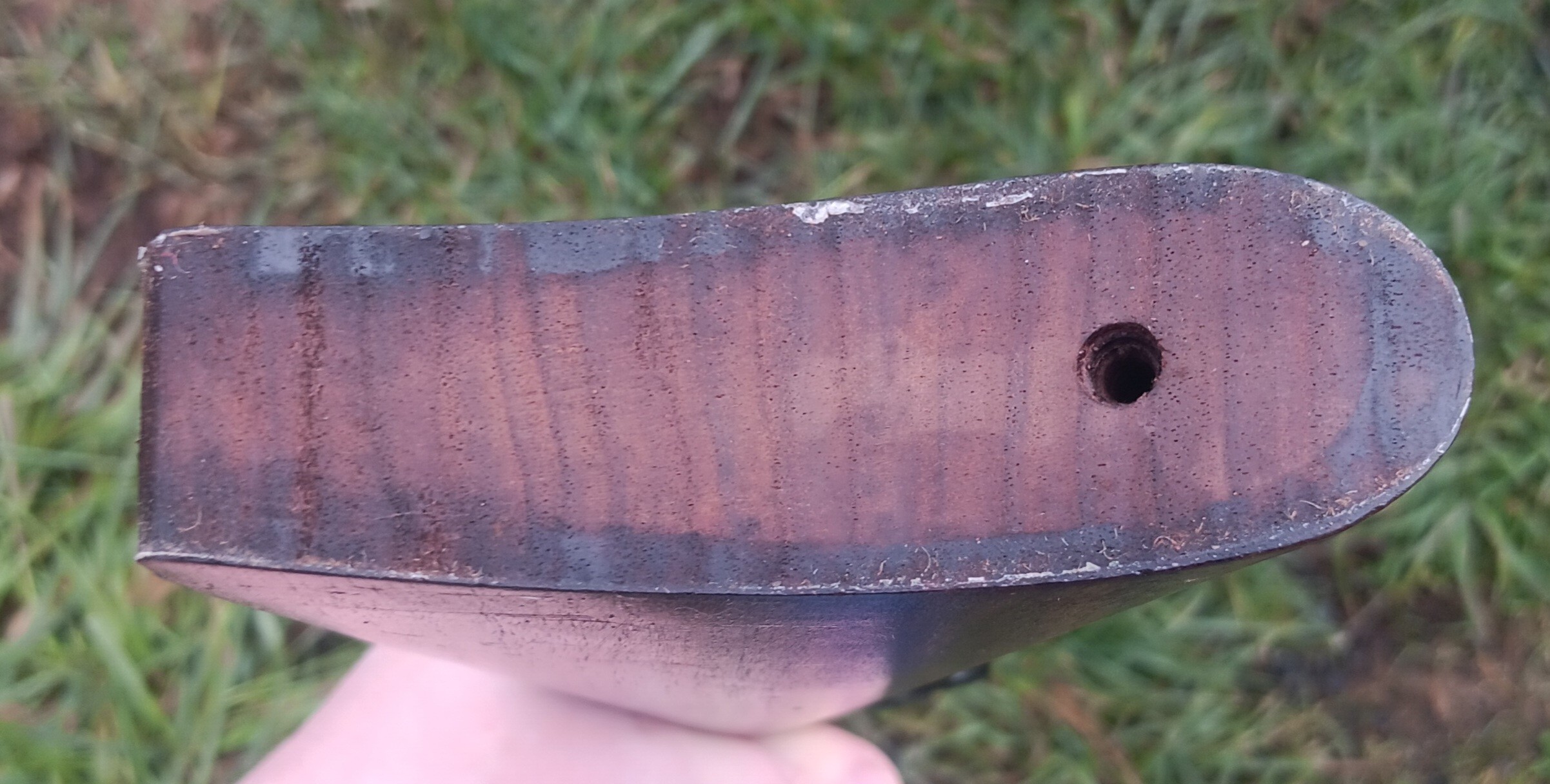

A few more pictures,

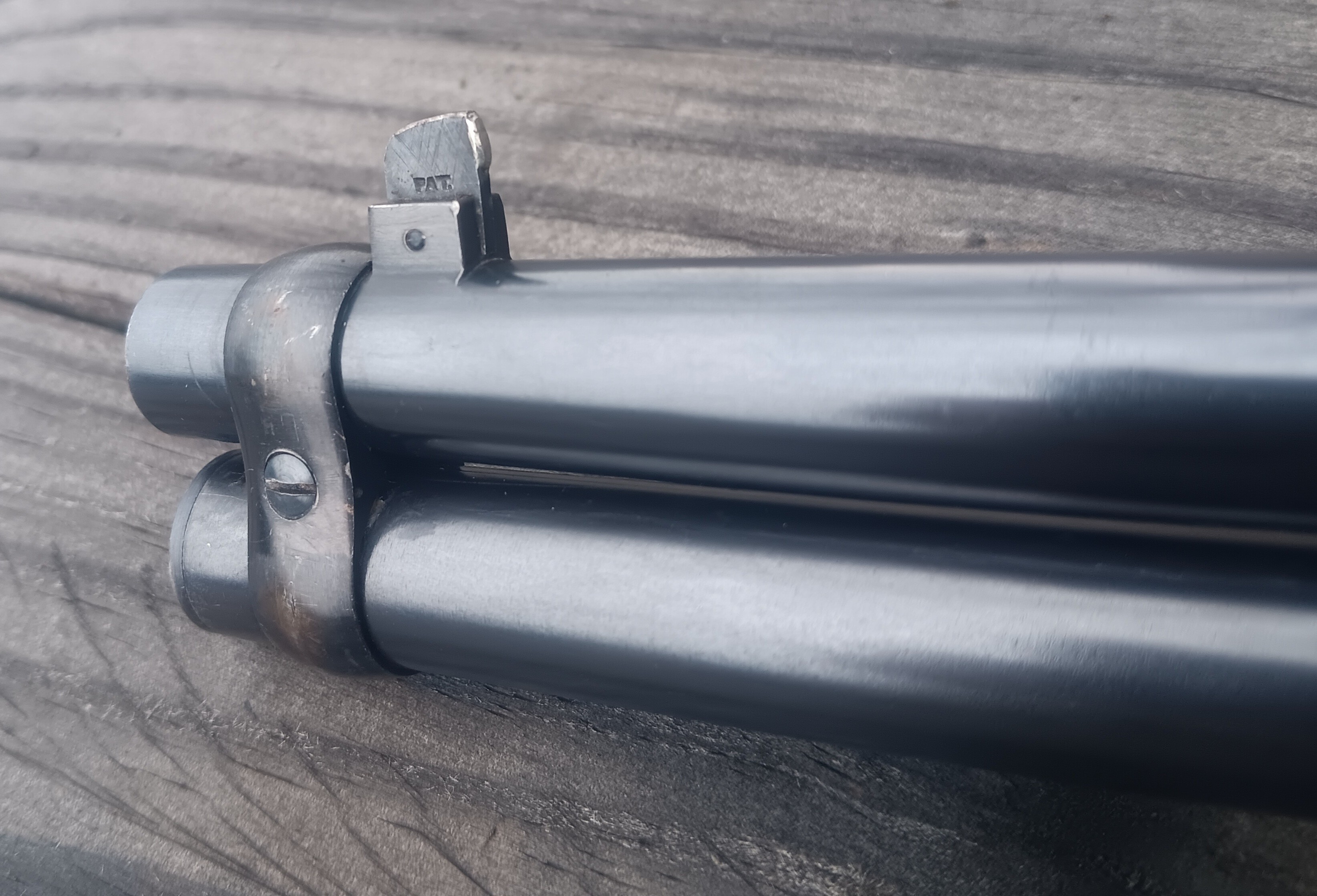

The Front sight has a silver insert perhaps,

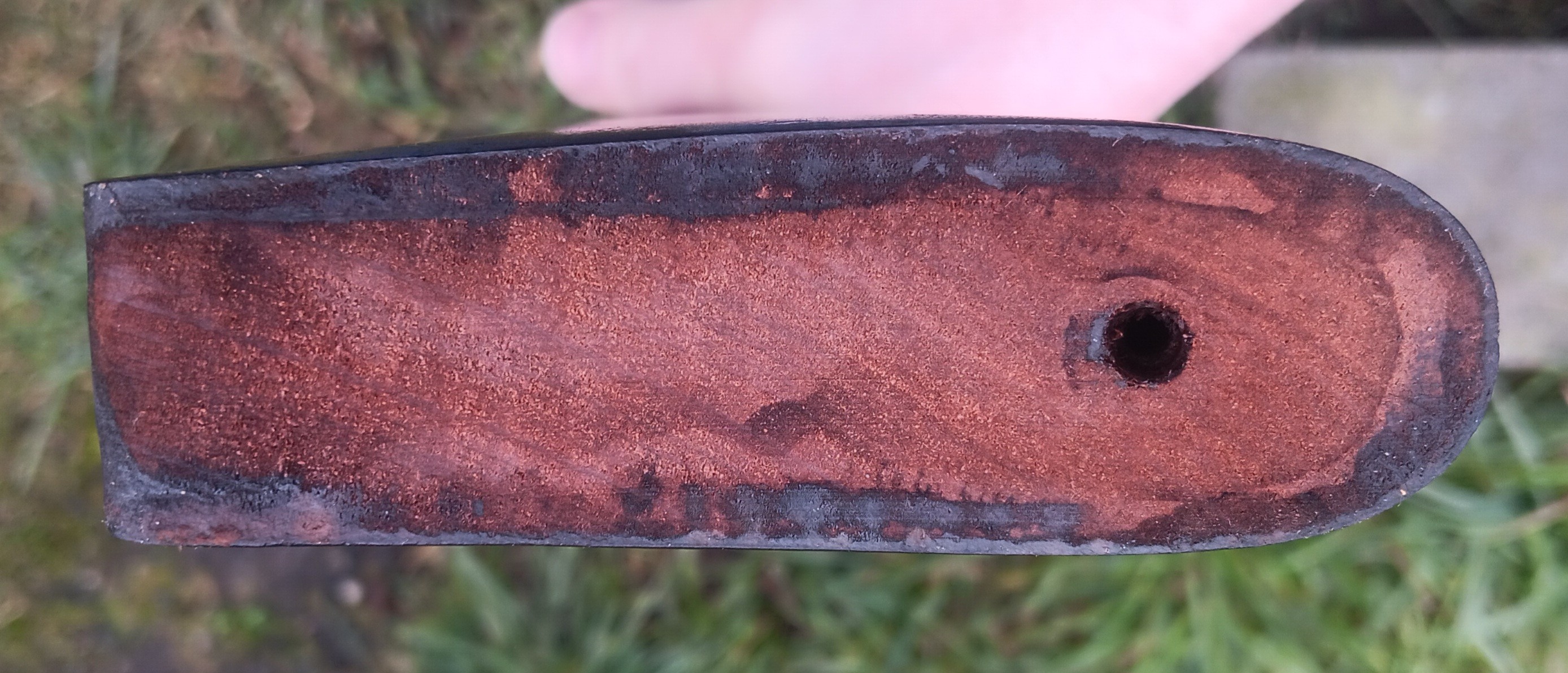

Trapper with the buttplate off,
Compared to the gumwood stocks from an 1894 I own
Bert, does this change your conclusion on the stocks at all?
January 28, 2026 - 6:53 pm
Vic,
I am leaning towards it having walnut stocks versus gumwood.

Is that front sight base part of the barrel or soldered on?
February 27, 2026 - 2:17 am
It appears to be an integral sight base.
wolfbait
Forum Posts: 413
March 6, 2011
February 28, 2026 - 10:29 pm
Would that be a standard feature when examining a trapper?
March 1, 2026 - 1:58 am
wolfbait said
It really depends on the specific time frame when the barrel was manufactured. Early barrels had a silver soldered base piece, then it changed to an integral sight base, and still later back to a soldered sight base.
