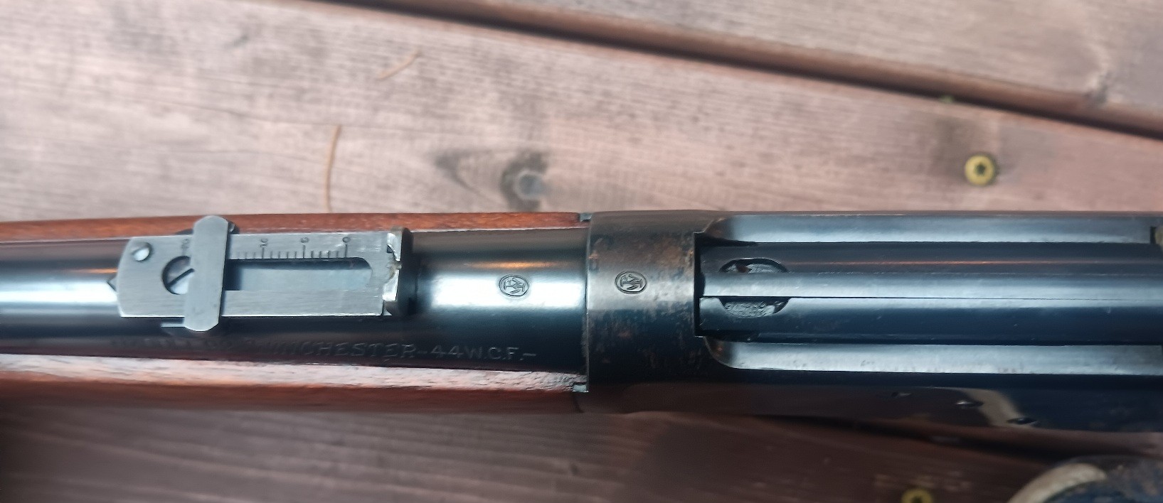

Hello,
I apologize, I’m not as familiar with Winchester lever rifles as I am enthusiastic.
Perhaps some of the authorities on Winchesters can tell me more about what I just bought.
Description as follows:
This is a classic Winchester 1892 trapper carbine chambered in 44 WCF (44-40). It features a 16-inch barrel, 7-round magazine tube, saddle ring, adjustable rear sight, and blade front sight. Overall, this Winchester is in good condition with normal age-related finish wear throughout the barrel, receiver, and stock. The metal was refinished at some point. Bore condition is good with well-defined rifling. Based on serial range, this Winchester was manufactured in 1925.
Price was reasonable and appropriate for a refinished rifle, so I’m not worried that I got burned, but I’m curious if there is still interest in a refinished rifle given the “trapper” configuration and if some more knowledgeable collectors would be interested in volunteering their thoughts about this particular rifle and about production numbers and history of the short carbines.
Many thanks

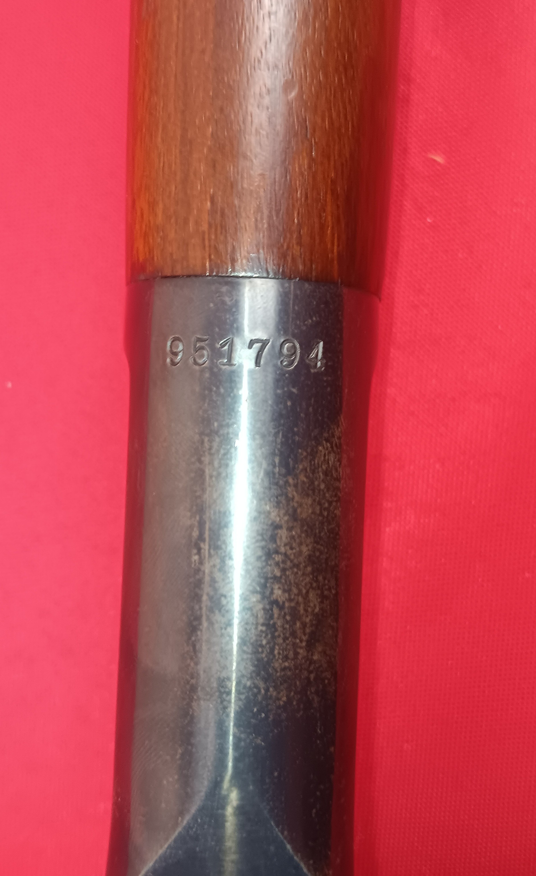

SN is 951794
Unfortunately the pictures I posted are all I have available until I receive the rifle

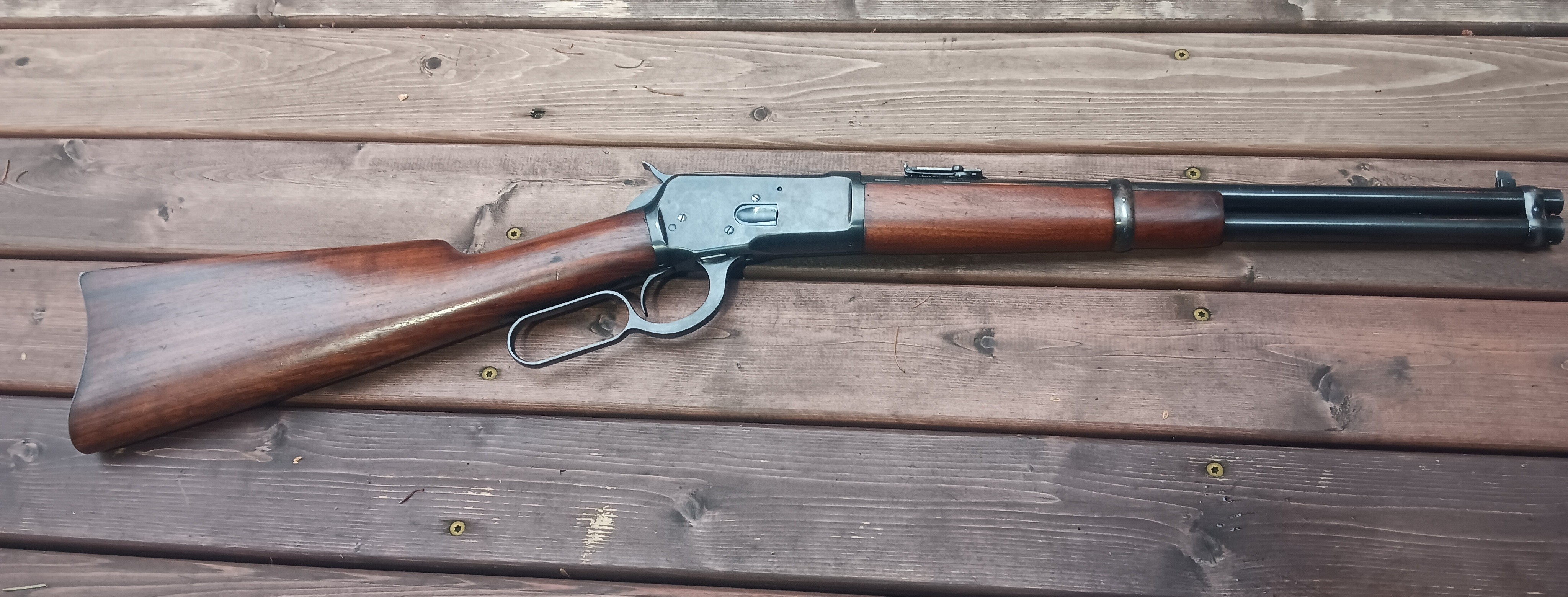

Yes, we need more pics.  From what I see, it looks like a nice little carbine.  Hard to tell, but the refinish looks well done, doesn’t look like the wood was touched either.  Trappers are desirable and hard to find.  Most have seen very hard use.  Again, better pics may tell a different story, but from what I see, I like it, refinished or not.  The value is now determined by what you paid for it.

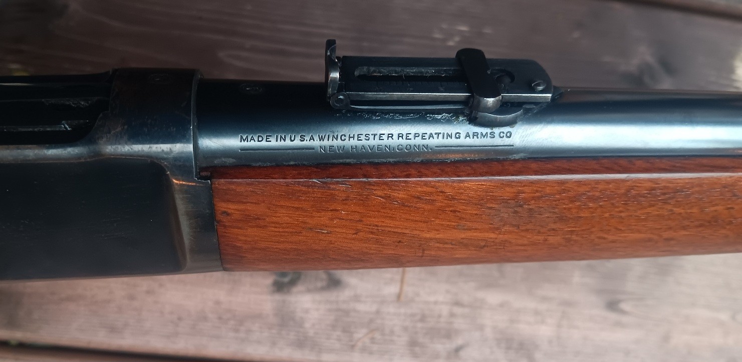

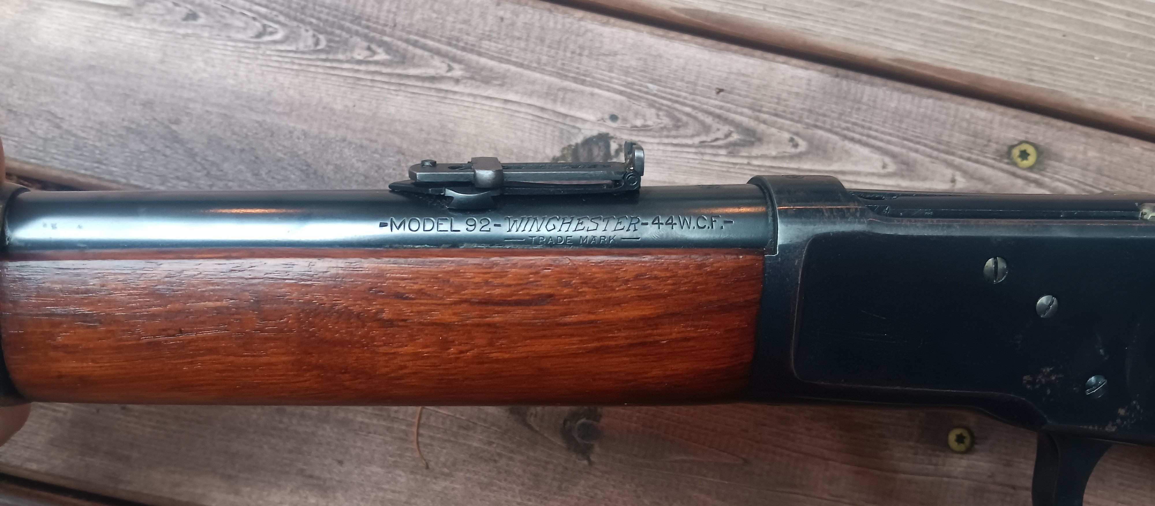

As I said, unless more and better pictures tell a different story, you did very well.  Please be sure to take good clear photos of the barrel address and caliber markings.
November 14, 2025 - 6:02 pm
Based on what I can see of the gun in the pictures you posted, the $1,200 price tag was a very reasonable price to pay.  I personally would have sprained my hand trying to fish the money out of my pocket as fast as possible for that gun.Cool

Thanks for the pics of your rifle.  Please post more and clearer pics when you get it.  Based on the pics you have I am not all that certain that the rifle has been refinished.  Please include pics of the upper tang of the receiver just below the hammer and the W/P proof stamps on the top of the barrel and receiver.  Based on the serial number the gun was manufactured during 1926.  As you can see from the attached portion of my survey data Winchester made a large number of 44 WCF saddle ring carbines with a number being fitted with 16 inch barrels.  These might rate as a bit uncommon but certainly not rare by any measure.

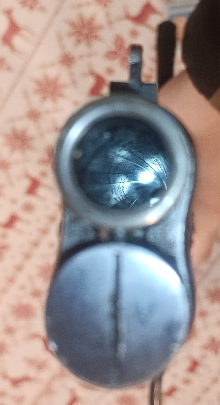

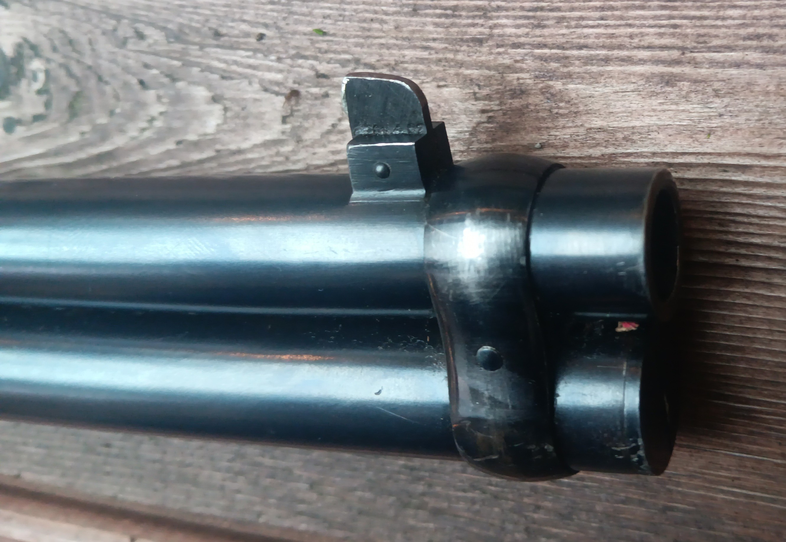

That trapper is a screamer! The muzzle detail picture shows originality.

I too find this carbine interesting, as we do understand how hard they are to find in any condition. I also am sitting on the fence, and anxious to see more pictures of it, to try to evaluate the originality of the finish, or not. It sure looks good to me.

The members here been such a help to me that I dont mind sharing that i bought this rifle and a few others through an online shop that periodically has consignment guns including vintage Winchesters for very reasonable prices.  Members are.welcome to PM me for the shop name.
I hesitate to raise my hopes, im still going to assume that im looking at a very good refinish,

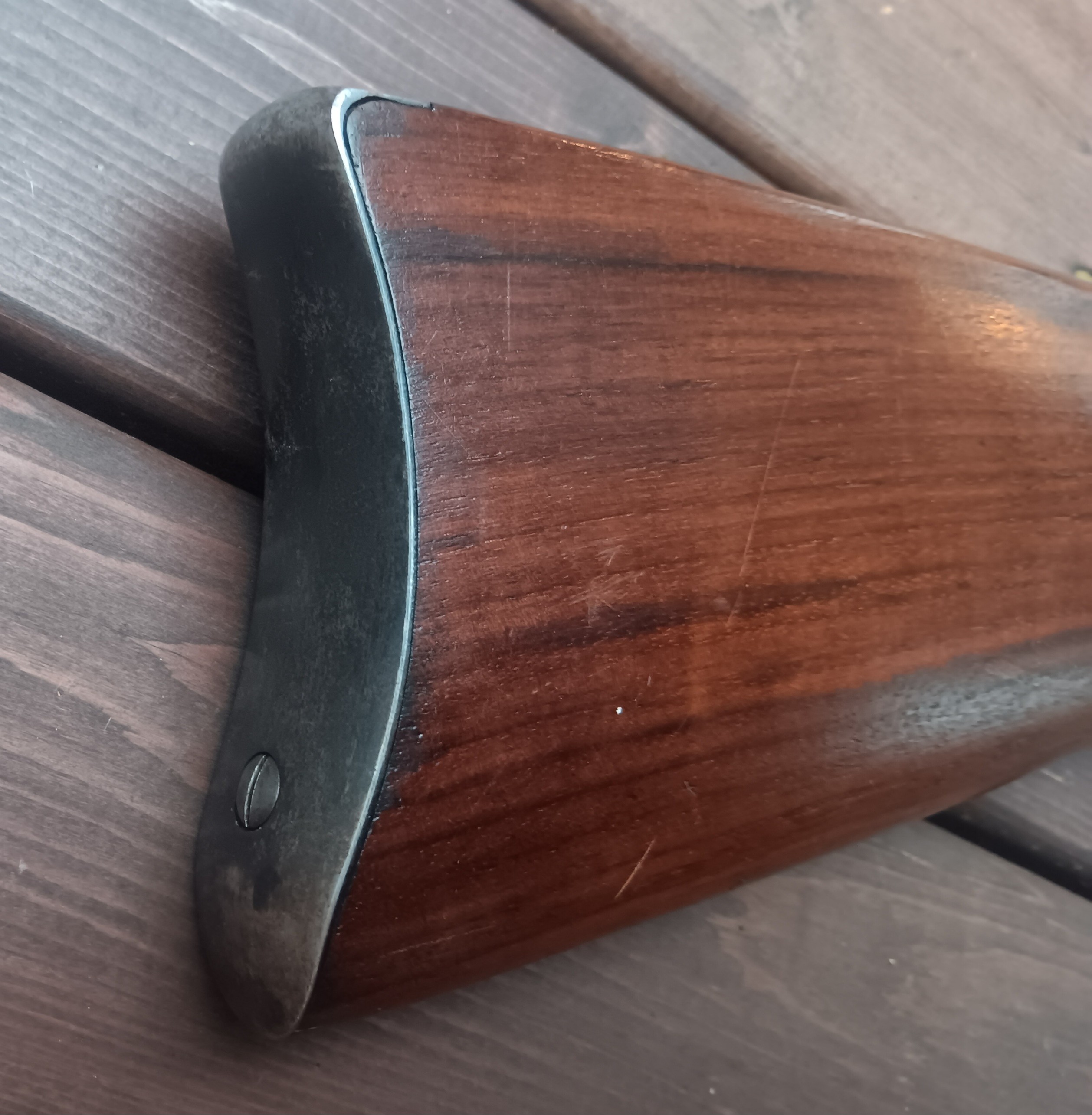

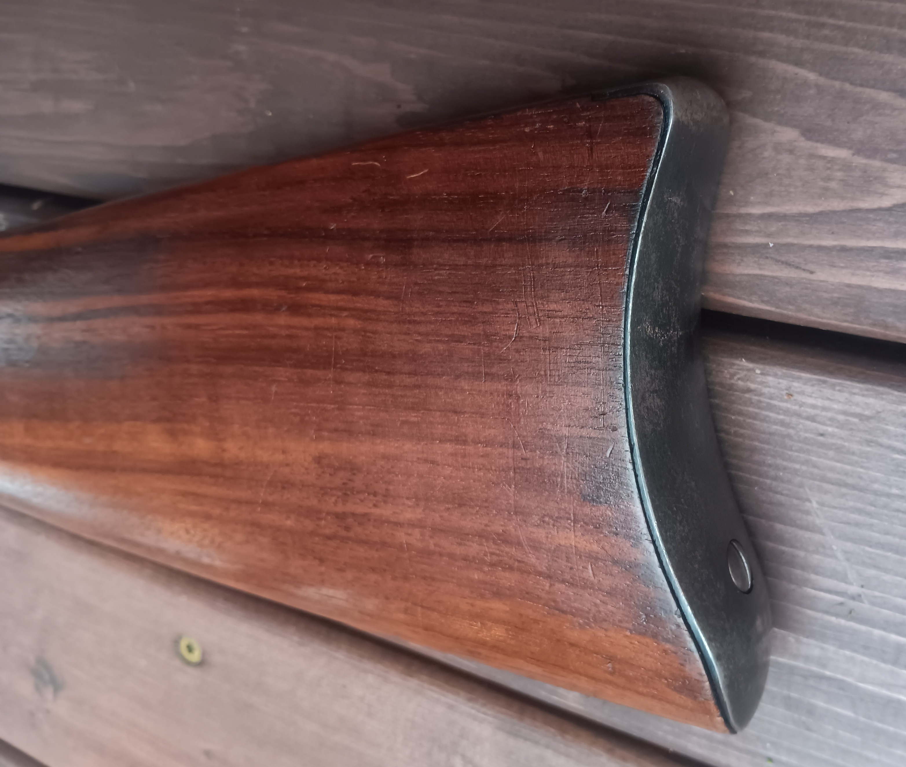

But enough people have chimed in with real tells that indicate.originality, such as the presence of factory polish marks and patchy bluing around the muzzle consistent with Winchester practices, but its all speculation until the rifle arrives in a few weeks.

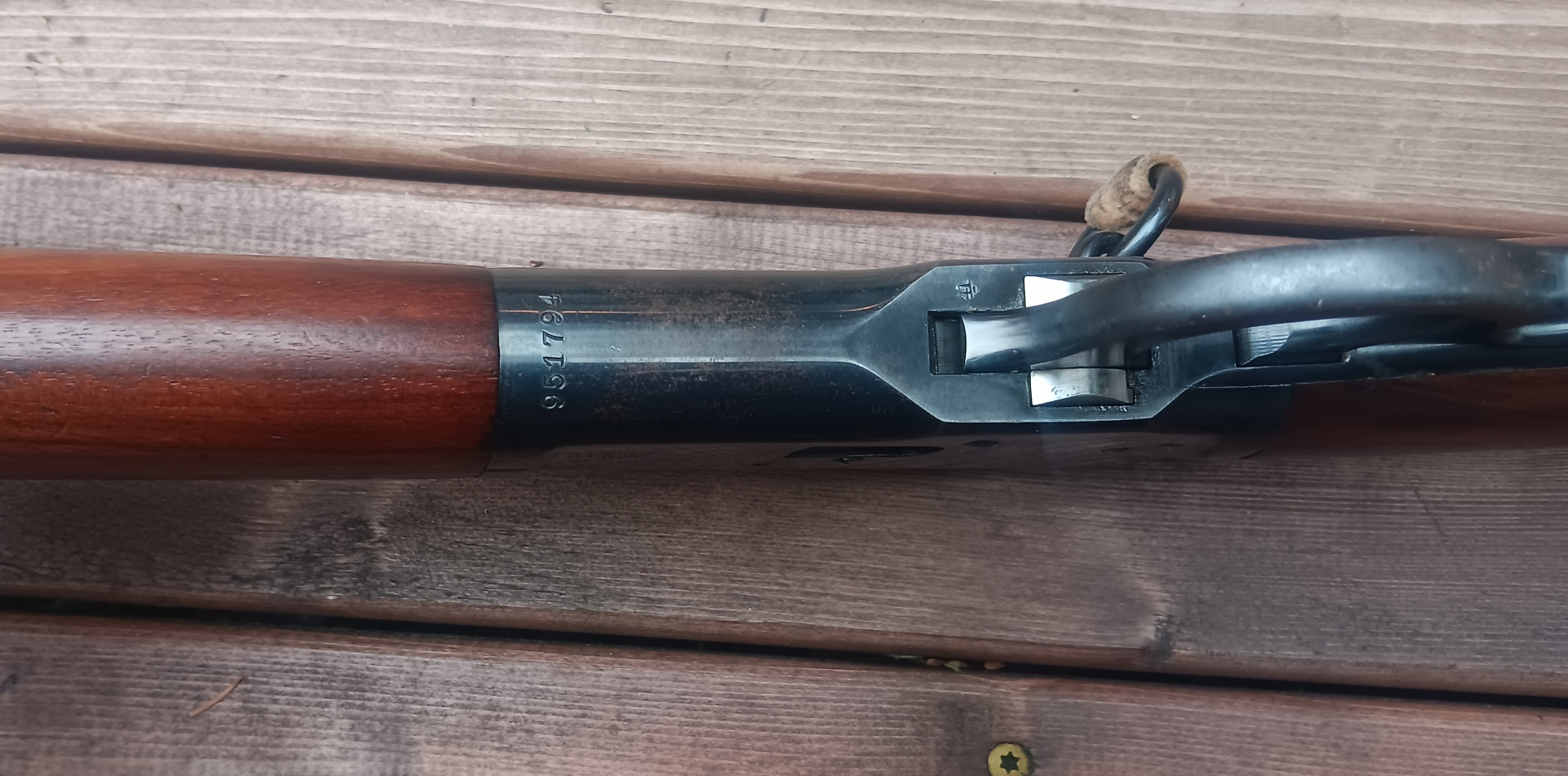

I emailed admins some better pictures, hopefully they can make them work. Its a beautiful rifle in person.
January 10, 2026 - 10:34 pm
Here are the pictures… very nice Trapper!! Cool
