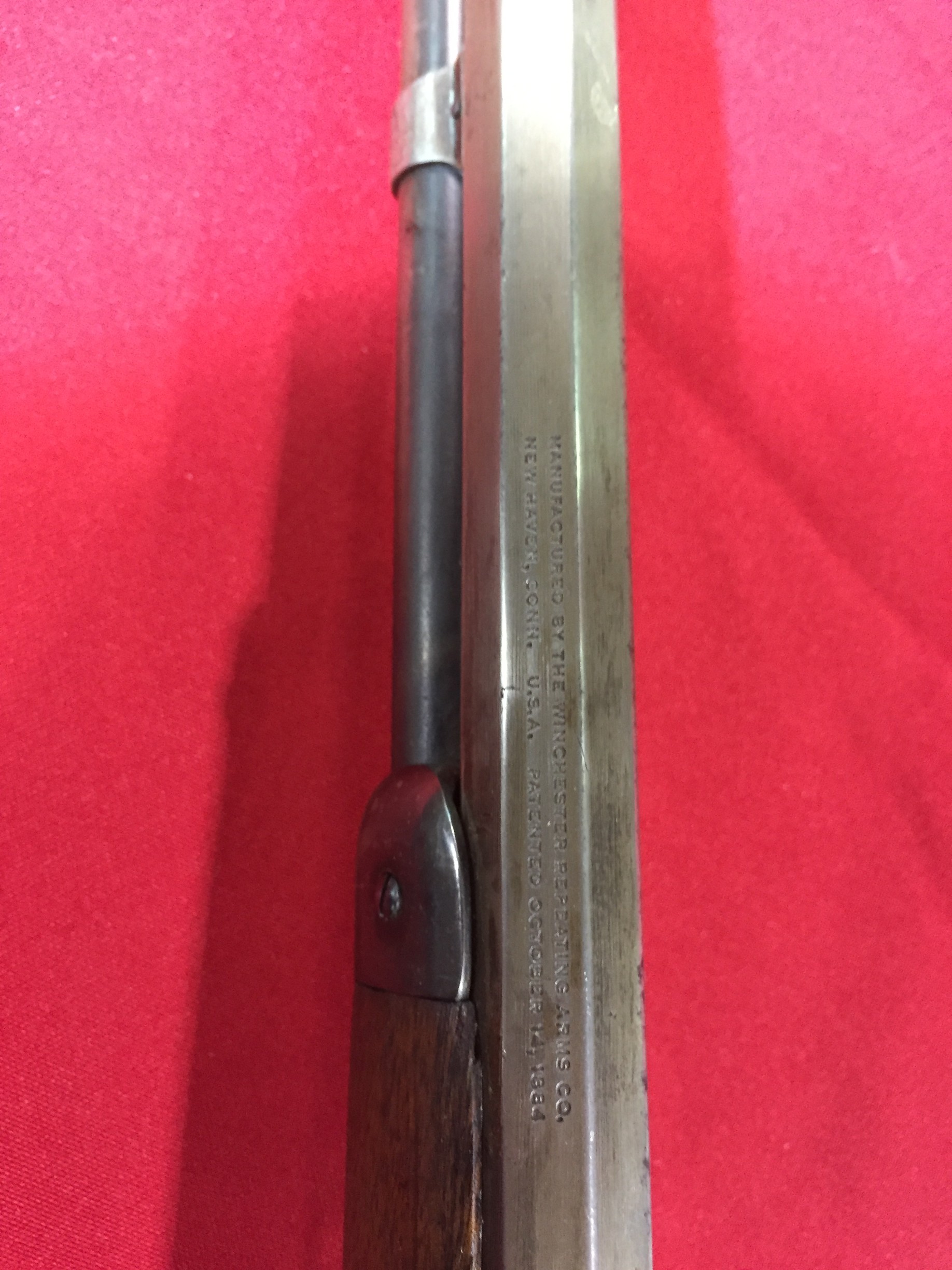

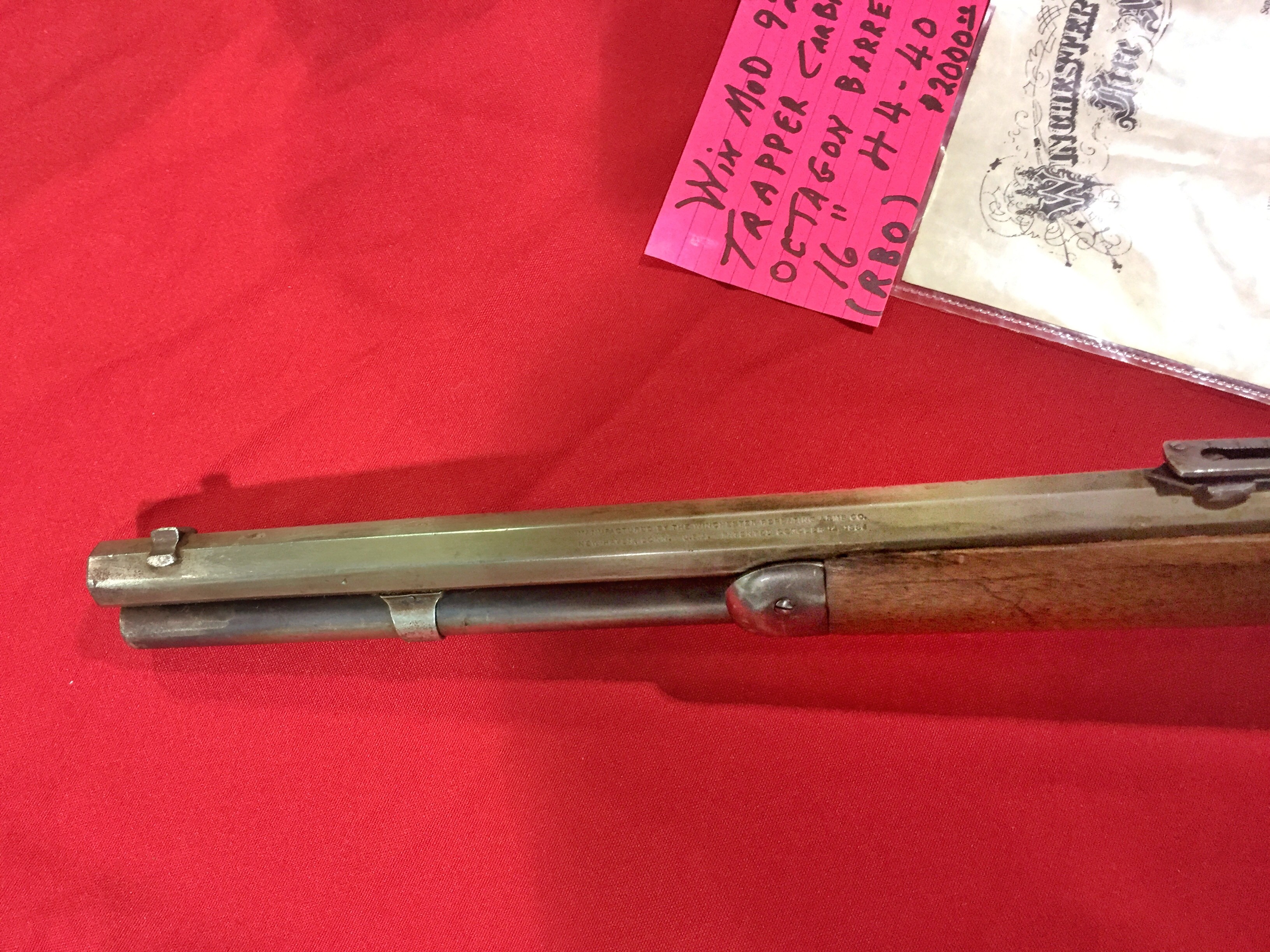

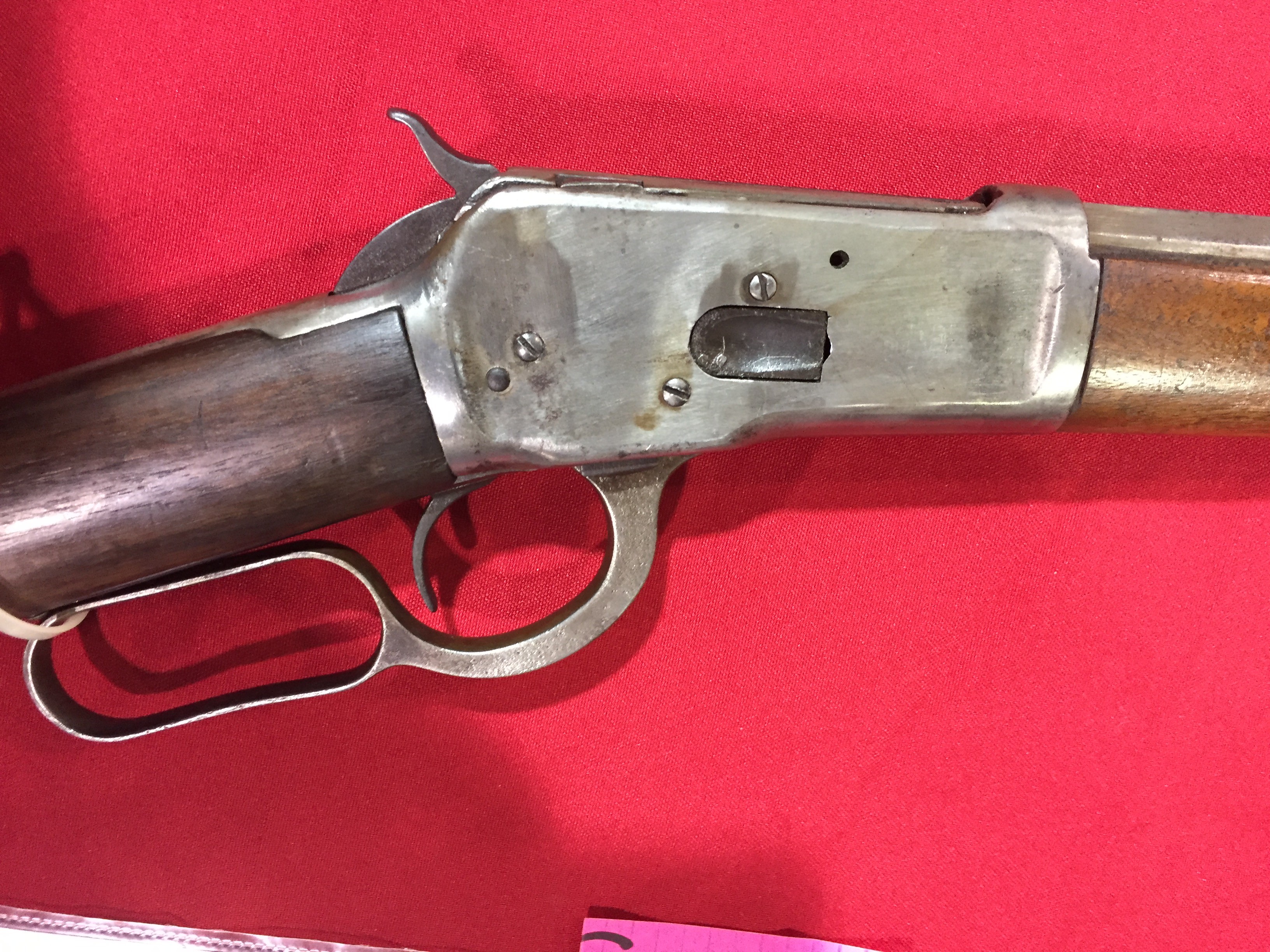

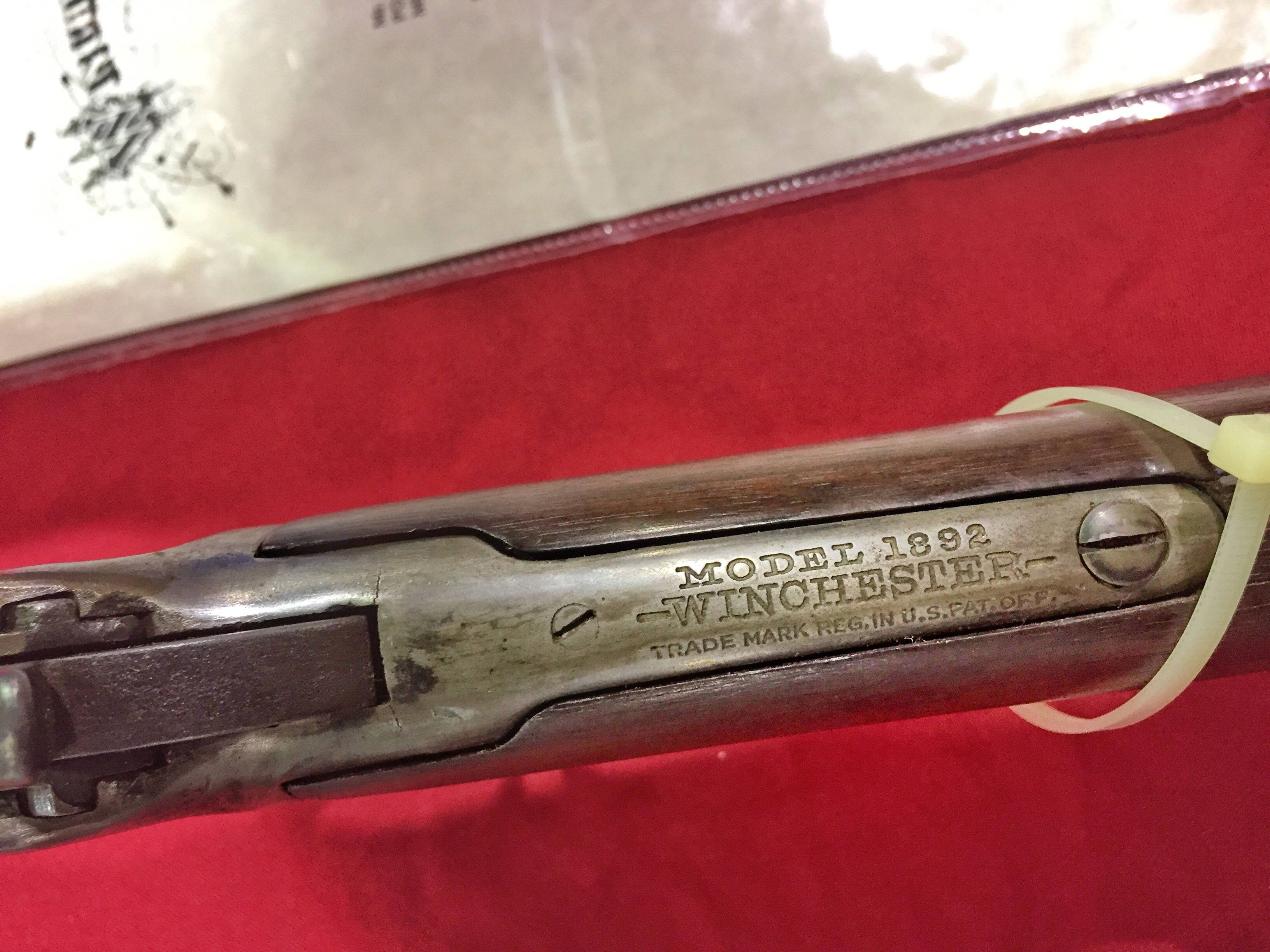

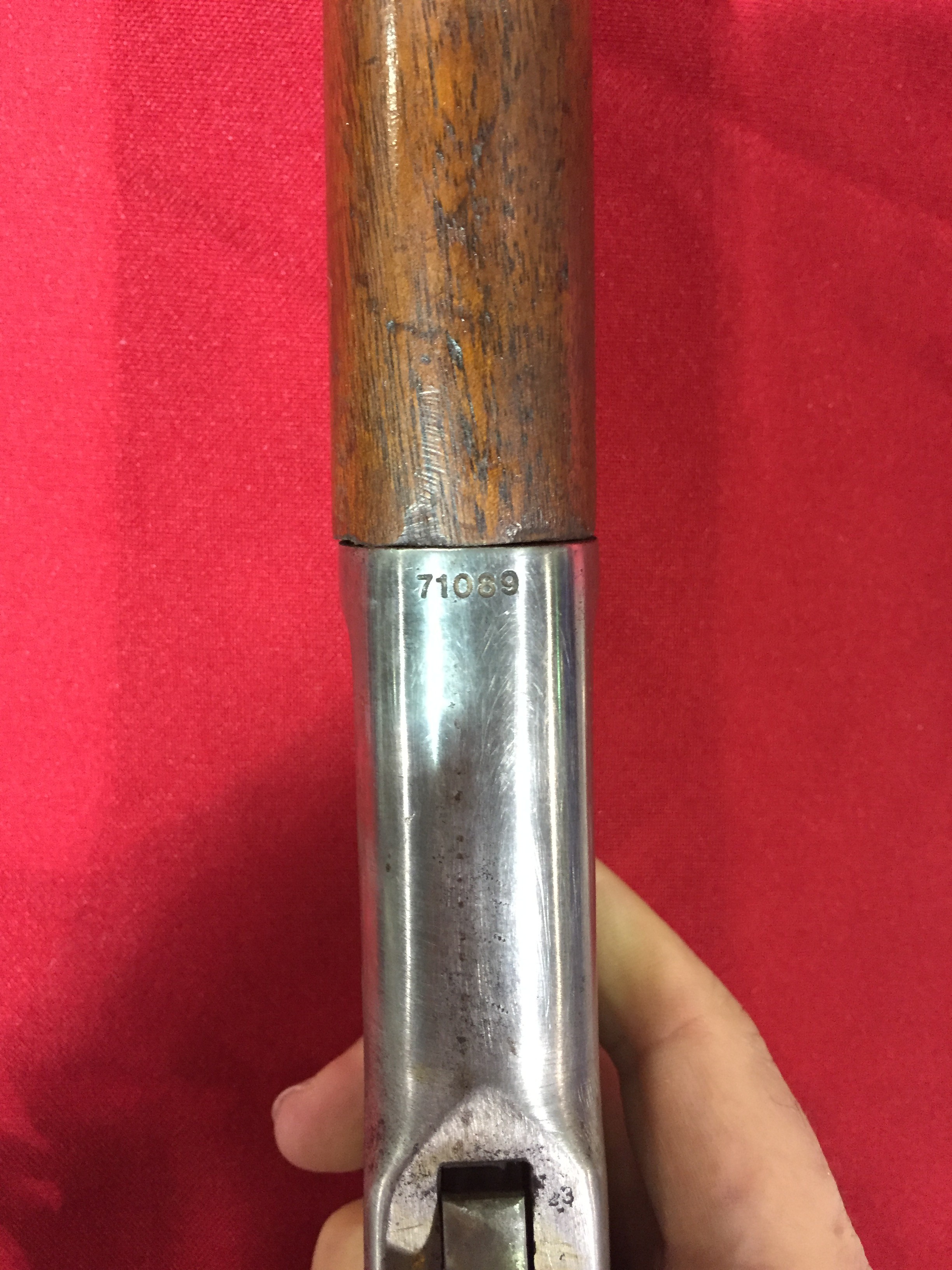

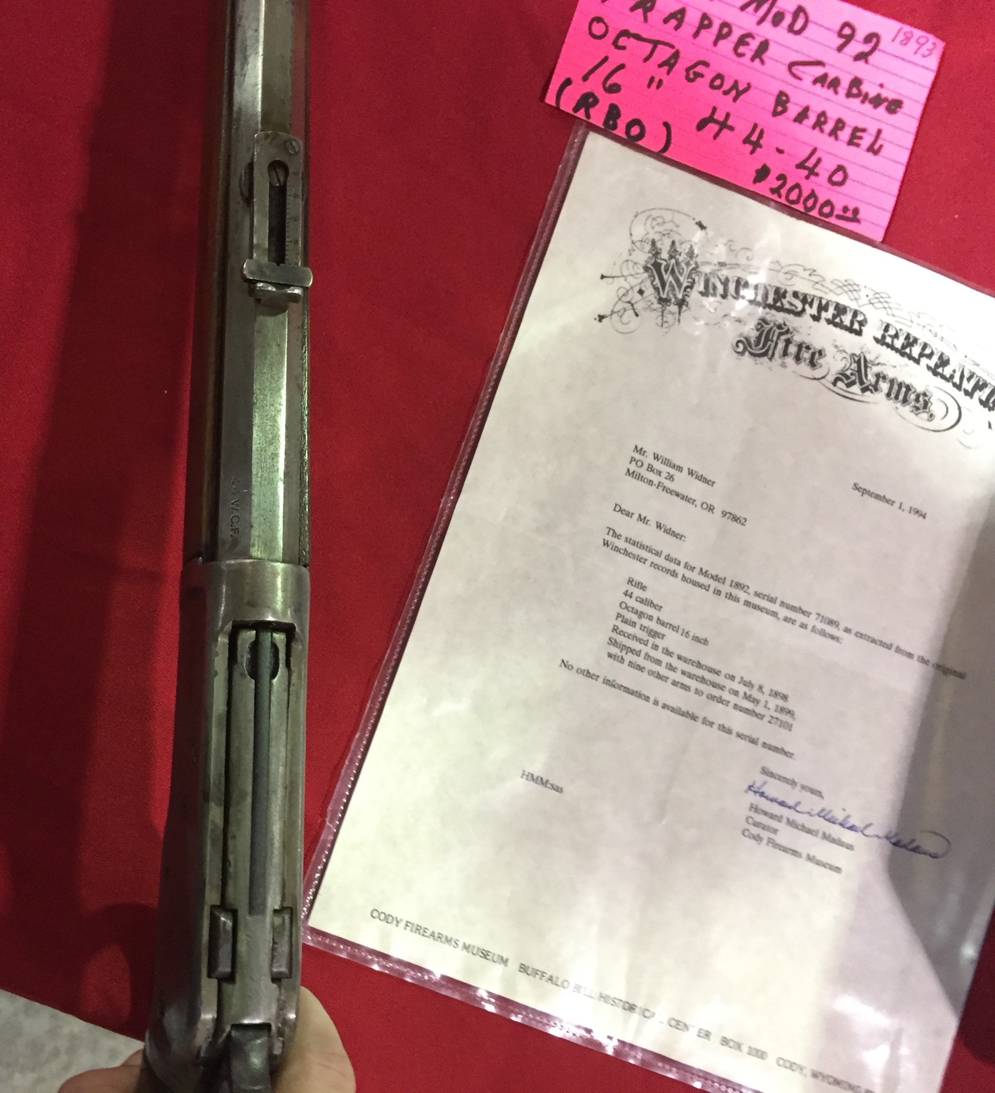

I received a PM on Saturday from a fellow member who also lives in Houston and who was attending the Houston Gun Collectors show this past weekend.  He had spied a 16 inch OB sporting rifle in 44 WCF at a table and the price was $2000 and a copy of the factory letter was there also.  Too good to be true.   How could you go wrong??  Apparently the gun had a lot of lookers and discussion.  BUT there are a million things (slight exaggeration) wrong in so many ways with the whole thing.  1. SN 71089 was originally manufactured as a 44 WCF standard SRC.  2.  The font style of the SN is totally wrong for that range.  3.  The “letter” states the rifle was in and out of the warehouse in 1898 and 1899 when in fact the real rifle was built and shipped during mid 1897.  4.  The upper tang on the receiver has a number 3 style tang stamp which did not come into use until 1909.  5.  Both the caliber stamp and the number 3 style barrel address, which did not come into existence until 1904, and both were not positioned on the left flat until 1910.  6.  On a 16 inch gun the rear sight would be located closer to the receiver face that the position on the shortened barrel.  7.  The barrel address is positioned incorrectly relative to the metal end cap.   8.  And I would be that if I had attended and had a ruler that the front sight and magazine retaining band are not positioned correctly.  9.  And last but not least (thanks Al) the letter is a fake also!!!!
Sorry that I could not have attended due to previous commitments because I would have loved to stand there and question the seller about all this and GLADLY point out the errors to any and all who walked by.

Thank you for the education.  Seems this model 1892 was put together from a mixture of parts? Do you think the letter is a fake?  Are you working on a Model 1892 book?  It would be nice to have a reference.

The “letter” is ABSOLUTELY a fake!!!   Yes a book will eventually be written and produced.  Until then send pics and ask questions guys.  Happy to help.

Look closely at the letter.  “16 inch” has obviously been added to the letter by an amateur after the fact. It doesn’t even line up correctly and looks to be a different/lighter font.  Also, on legit letters that I’ve seen “Octagon barrel” and “16 inches” would be on a separate lines–not added together on the same line.  What a joke…
Don,
I was driving, actually sitting at a red light and looked at the first photo of the barrel address and just starting laughing at how phony it was.

I see what you’re saying about the barrel type and length.  The letters I have say:
Barrel Type:
Barrel Length:

Shouldn’t the letter also have an embossed seal in the lower right hand corner?  I see it’s dated 1994, when did Cody begin using the seal?

I’m the person who was at the gun show and sent pics/questions to Michael.  A big thanks to Michael for posting the pics and info.  Andy Kessner, another WACA member, was at the show.  He looked at the rifle and in less than 30 seconds concluded it was a really bad forgery.  Word spread from there.  As Michael wrote, there were plenty of people interested in looking at this fakery.  I lingered by the seller’s table for a few hours on Sunday and engaged several people about the rifle, making sure the seller knew I was telling them it was a fake.  I overheard him say to another vendor he was going to call security on me but he never made good on that promise.  Too bad!

I am so happy that you reached out and asked vs getting with me AFTER a possible bad purchase with most likely no chance of getting your money back.  This rifle was certainly one of the worst examples I have seen of a fake and altered rifle.  You were very much correct with the “too good to be true” feeling to send up warning flags.  To everyone else please do the same as Greg did.  Shoot me an email or message if you have questions before you pull out your wallet.  I can’t promise that  I am sitting at home waiting at the computer but I will do my best to get back to you ASAP.

Looking at the letter (first picture) I can see a very slight emboss. you have to zoom in as far as you can.
