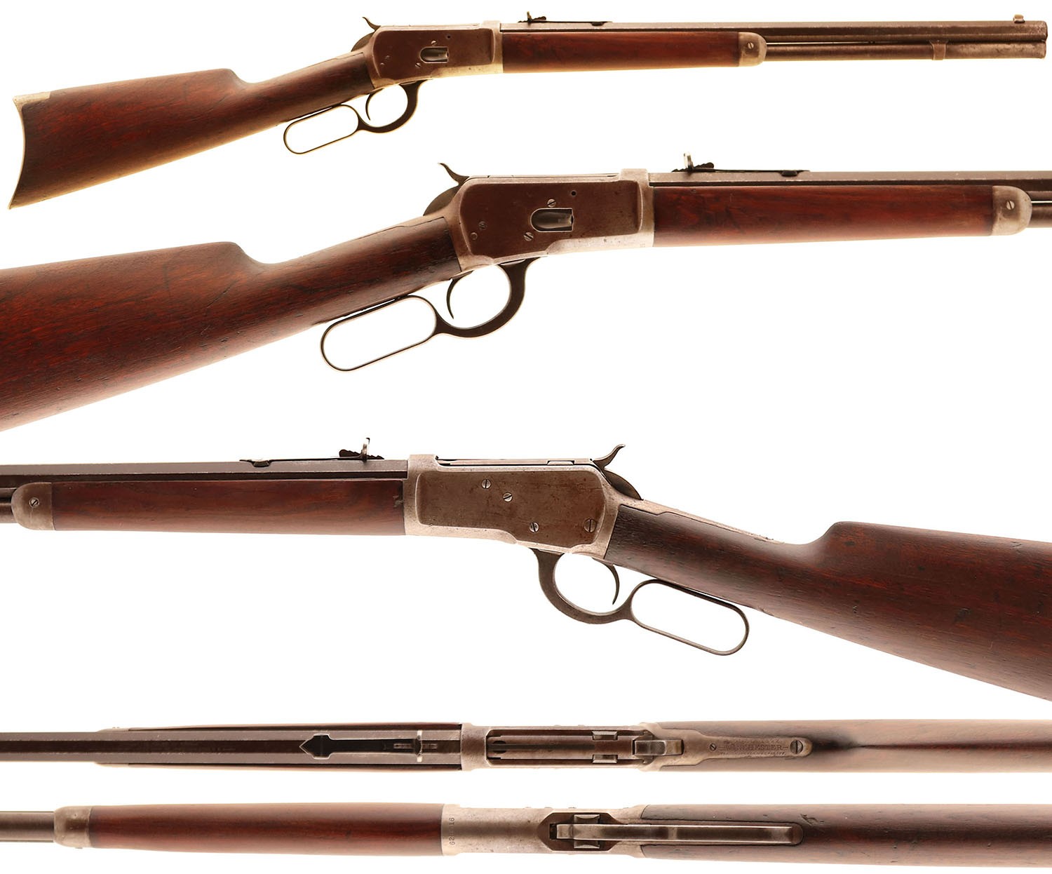

Good morning,

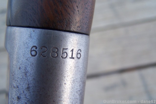

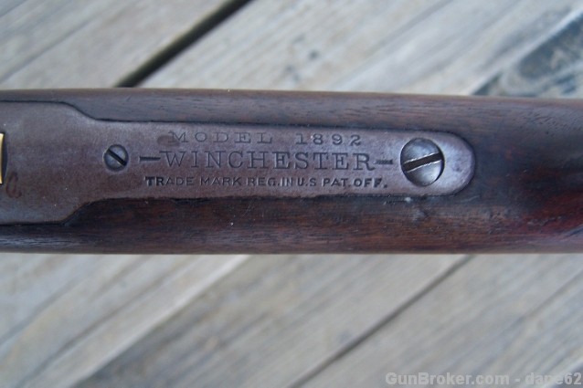

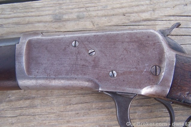

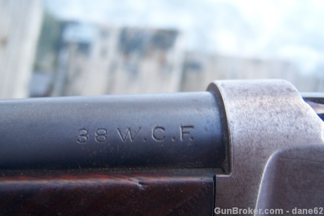

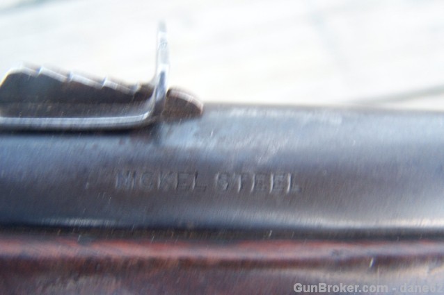

I was cataloging the current listings from Ward’s Auction and came across this Model 1892 with a 20 inch octagon barrel.  It looks like a correct short fore end wood and the rear sight is located closer to the receiver face.  The problem arrises from the fact that this rifle was listed on Gunbroker.com back in 2013 out of Houlton, ME as a 38 WCF round barrel sporting rifle with a Nickel Steel barrel.  THAT is much more uncommon than a 20 inch gun by miles!!
pix884837775.jpgpix913059694.jpgpix041594083.jpgpix230803052.jpgpix279911924.jpgpix385112658.jpgpix416636142.jpg
And the pics from the Ward’s listing:
Make a note someplace to look out for this again some place else.

On the rarity factor of the rifle’s original configuration, I was not tuned into the rarity factor of nickel steel markings on a .38-40 round barrel rifle.  I just checked a .38-40 I have with 24 inch round barrel and full magazine.  The serial number is just short of one million, yet no nickel steel marking.  What serial number range do these markings fall in?  Also, more common to find these markings among the other chamberings?

Nickel steel barrel in any configuration or caliber are extremely uncommon for Model 1892 rifles.  And thanks for the kind words.

Let me add, it looks like the barrel and magazine tube they added have condition issues.  Unsightly would be my term.

The wards pictures look very deceiving compared to the Gunbroker versions.

Like, “who switched the barrel?”  Just kidding–no reason to believe they know the gun’s past history.  By the way, is this a ser. no. for which there’s no record at Cody?
Forum Posts: 6913
February 16, 2020 - 7:26 pm
Serial number only for this gun, no other records.  I doubt that Wards knows or maybe even cares like most dealers.  They take the word of the consignor and don’t research each gun.  Buyer beware everywhere.  Do your homework and don’t buy guns sight unseen.  Say thanks to Michael.
February 16, 2020 - 8:30 pm
Chuck said   Serial number only for this gun, no other records.
What I figured–the fakers are smart enough to pick guns that can’t be documented.

I checked Wards and they updated the descriptions with the info you gave so the bidders were aware and they still overpaid.

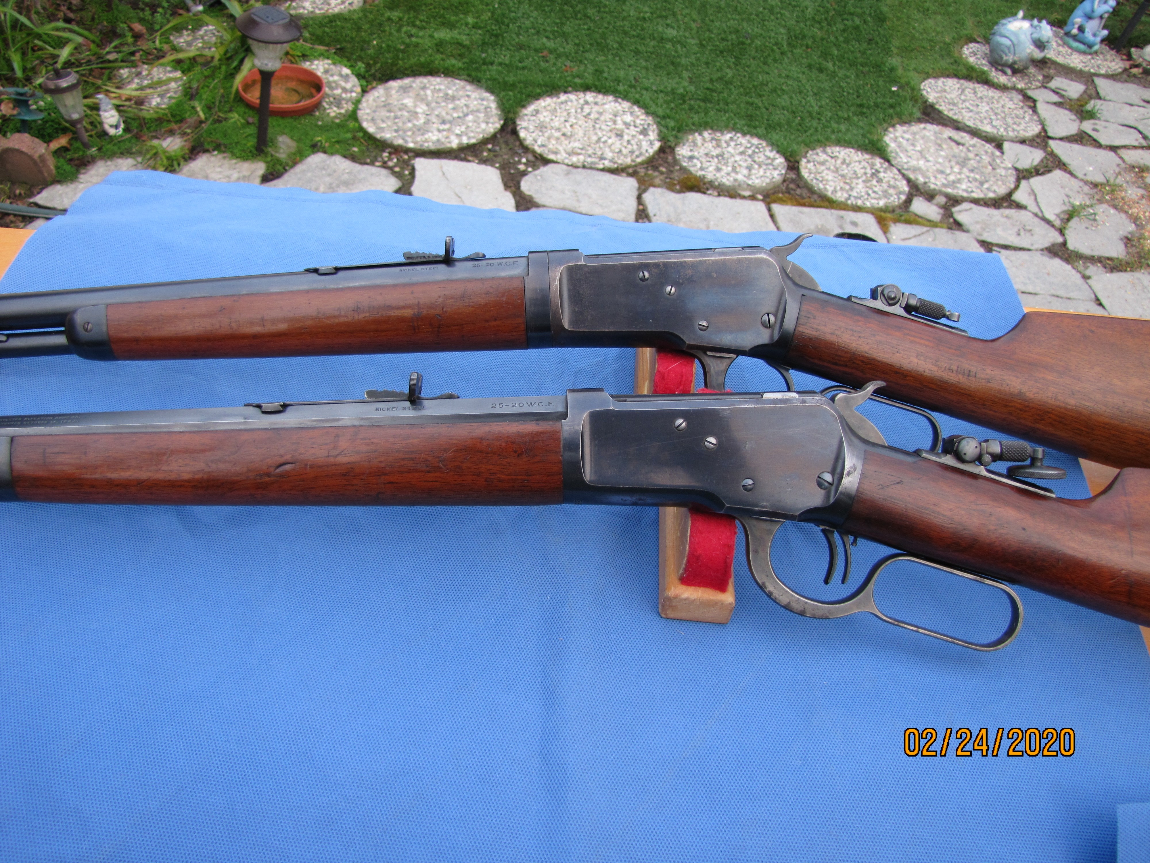

Thank you Michael for the continued up dates.
I am also pleased to know that the “Nickel Steel” barrels are recognized as being “uncommon” and thus more collectible.  In 40 years I have managed two.  Serial #400784 a 22″ Round barrel take down (has shorter forend).  Serial #623492 24″ octagon with double set triggers.  Unfortunately to late to letter.
