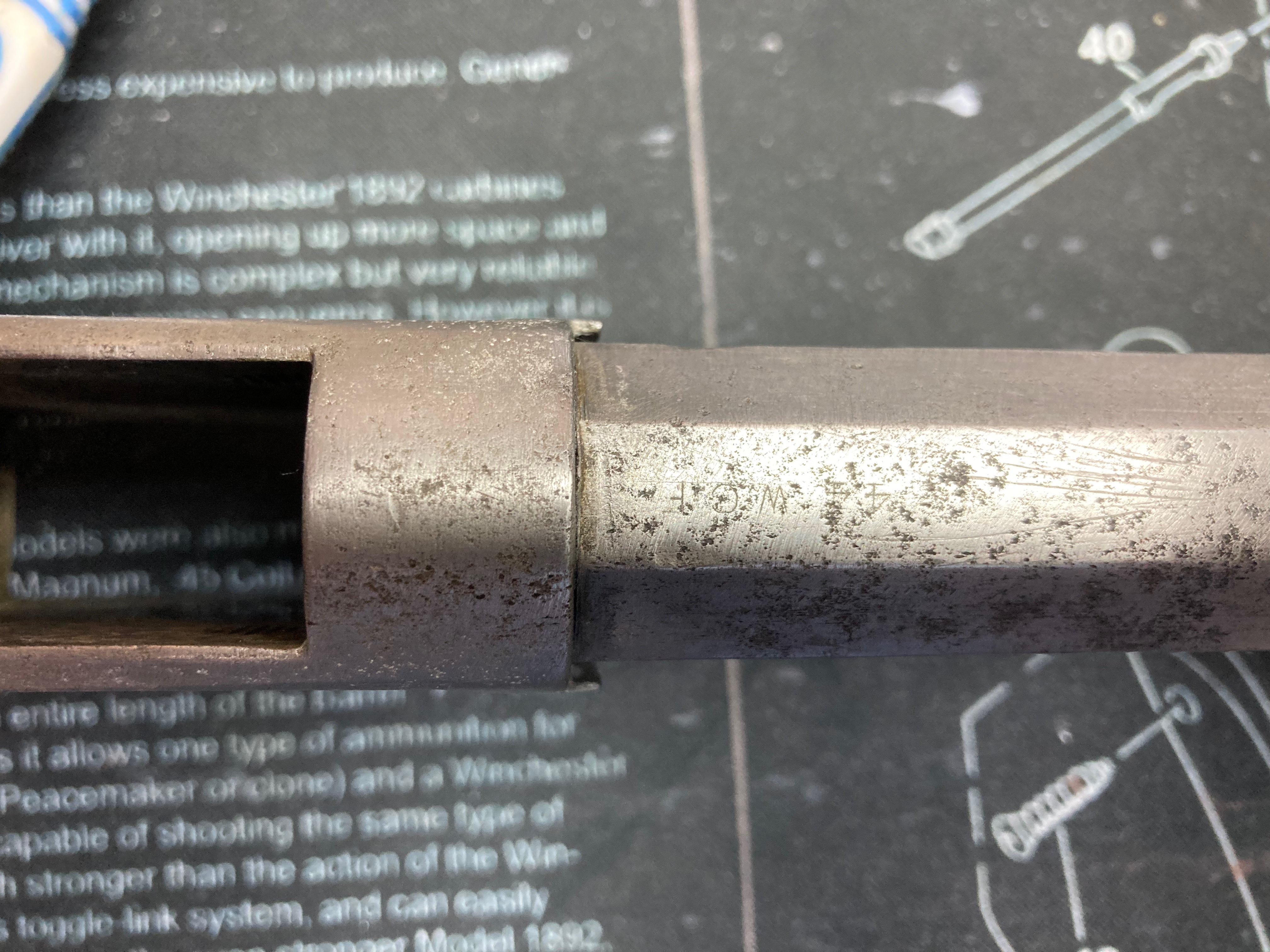

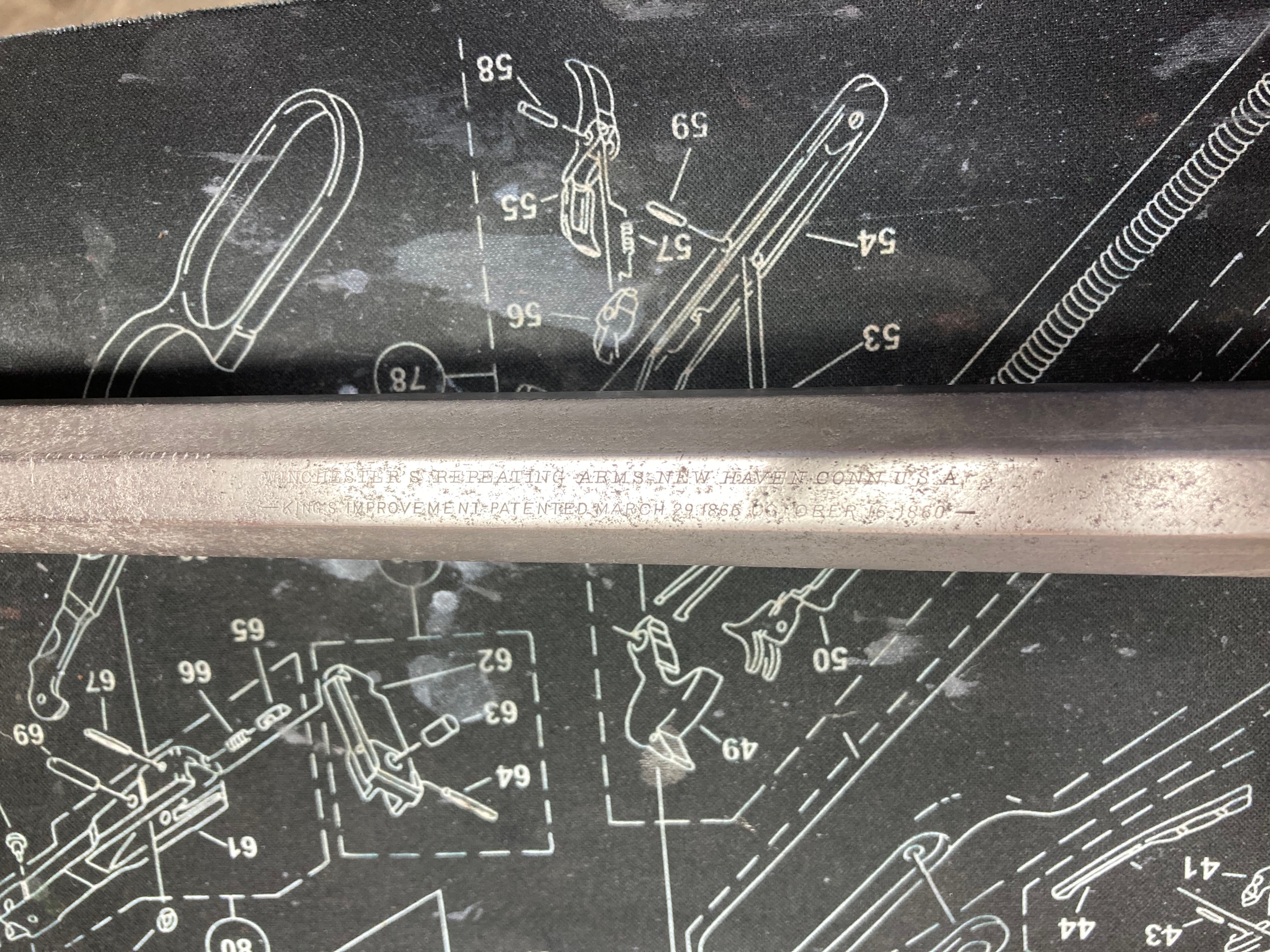

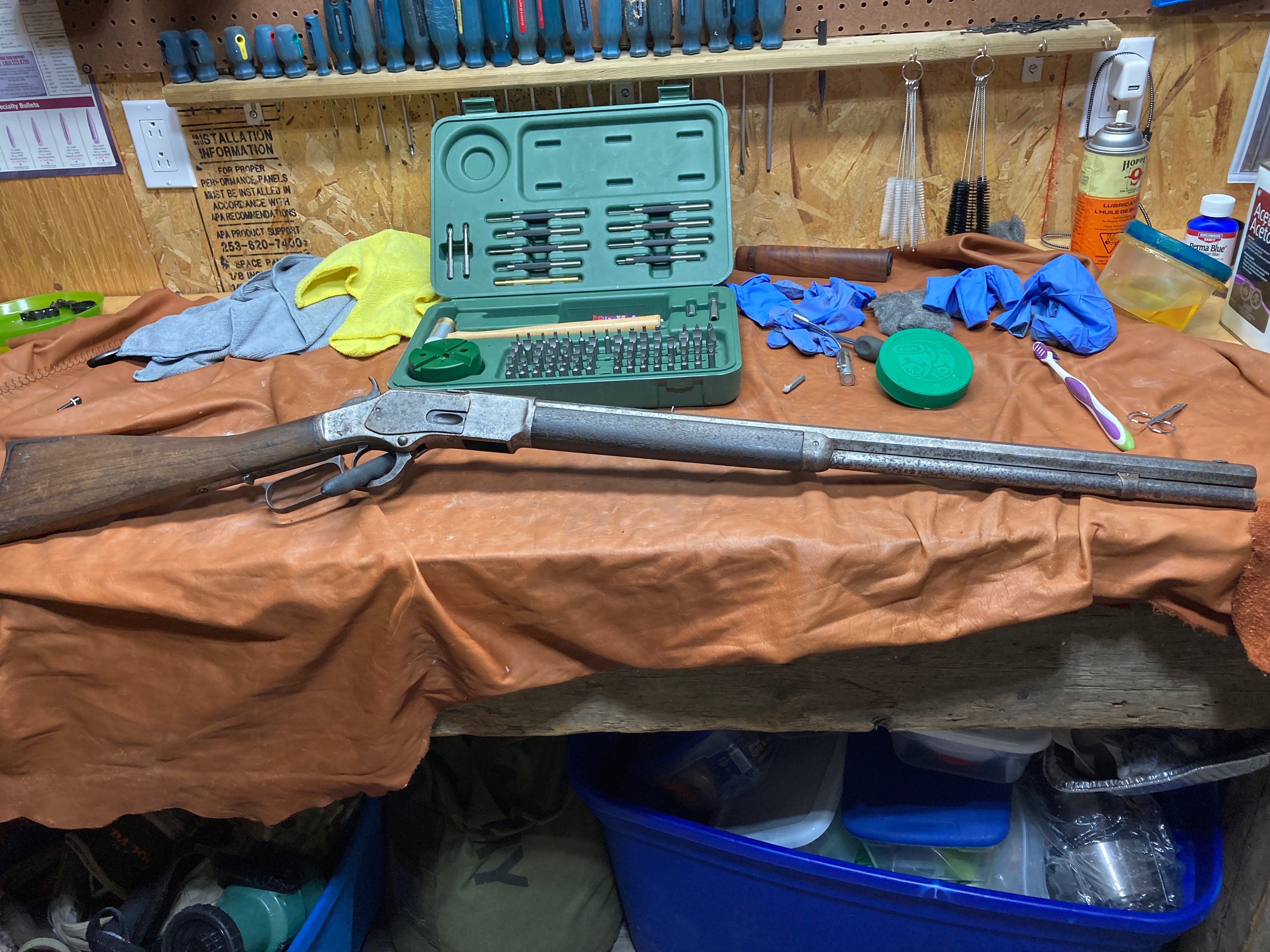

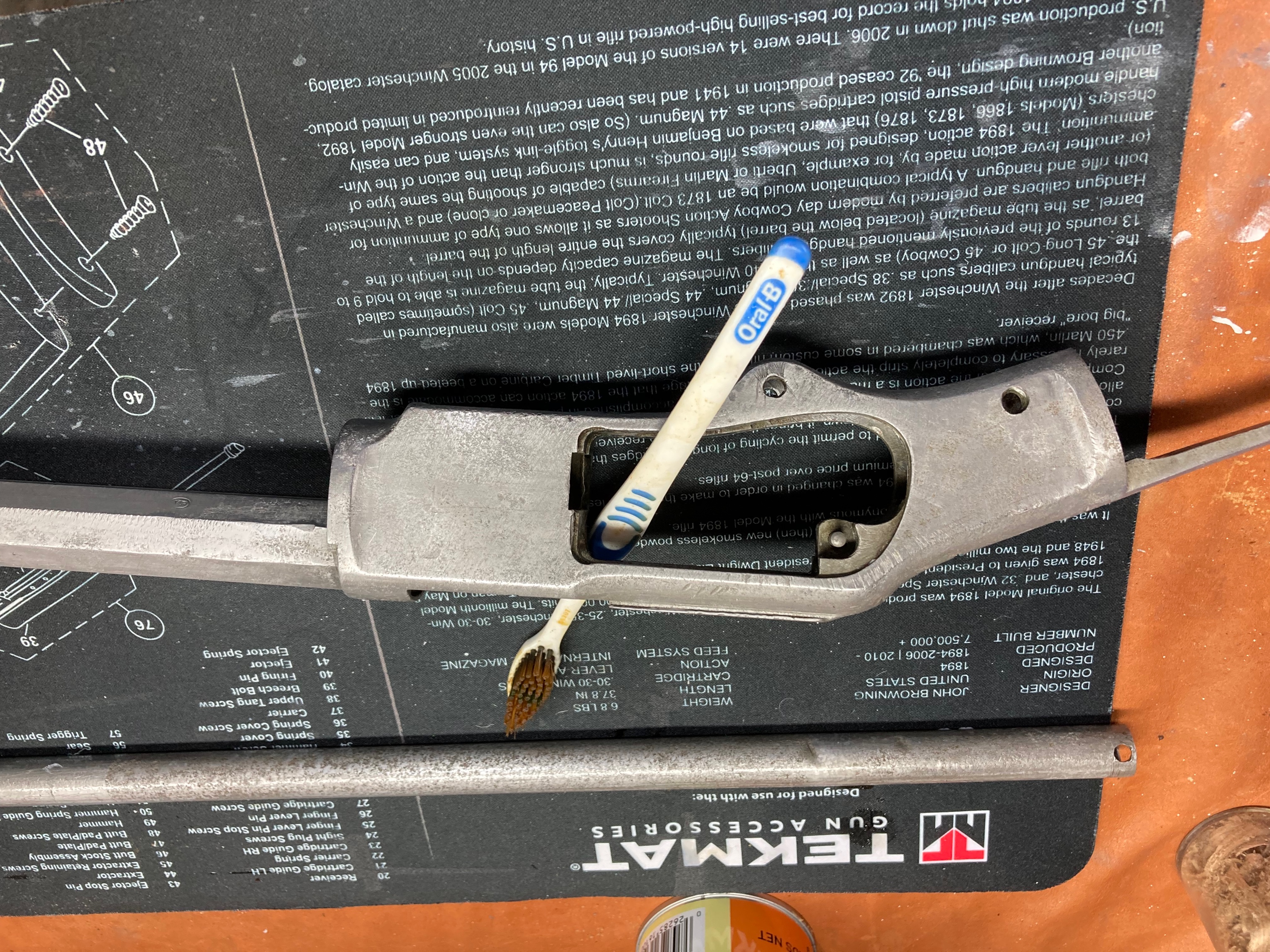

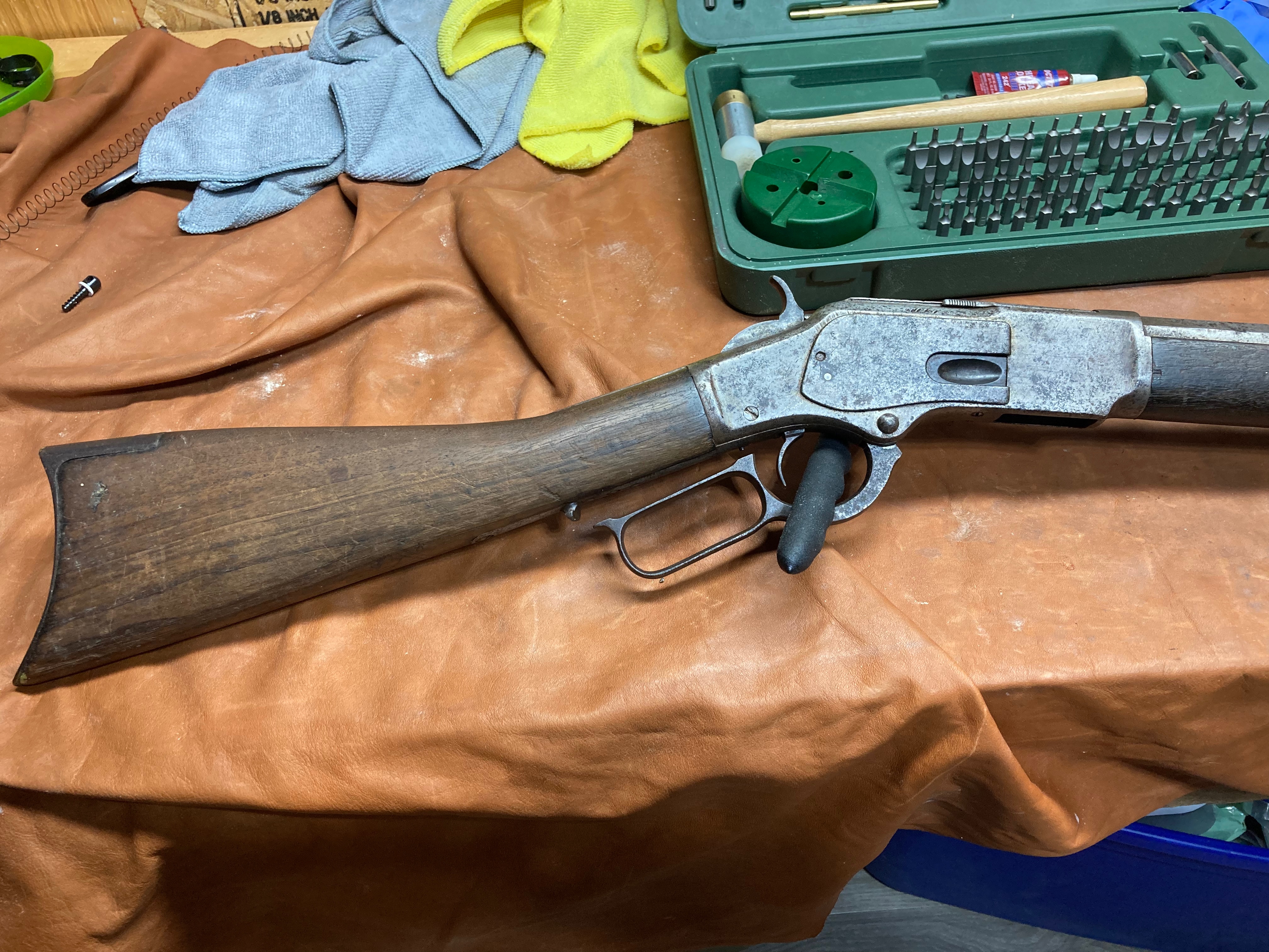

08AE8AFD-A286-42DC-B2ED-6272DF75A227.jpegC8D0D583-1D75-4D4C-878E-82FA7FB62FBF.jpegE8B0DCE1-C5C3-4714-9001-27ED5969D998.jpegA2954BA6-E76F-44F3-834F-C51527231204.jpeg72EA02E5-F7AA-4077-8D2E-BF45E7D3BBC2.jpeg8953CDCC-00D2-4CD1-92D6-8CA41FF6BCDC.jpeg9E1C4369-4E76-46DF-92B6-DEA81858D476.jpegto start I sent the parts in a basin of evapo-rust. then I took each piece and sanded them to remove the rough effect. I used 800 grain wet sandpaper. I don’t want to remove all the scracht it’ the story of this gun but I would have to polish and then blue.
October 10, 2021 - 1:35 pm
Well, I admire you’re restraint in starting with 800 paper–I’d have started with 400.  Given the terrible condition of the surface, I think it might look better if browned, rather than blued.  It’s easy to find out:  apply one of the commercial browning solutions, & if you don’t like the results, wipe it off with your Evaporust.

I see someone already has tried to clean up the gun before you got it. They used a file on the receiver. The gun will look better with a browning rather than a blue finish.
