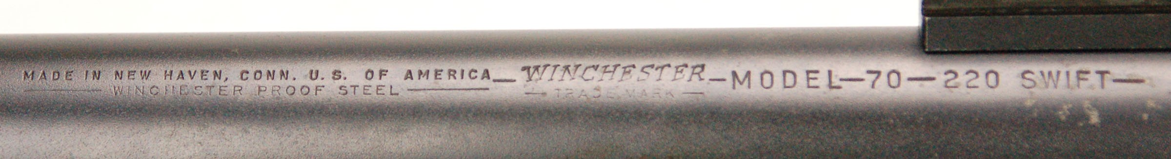

I have a pre 64 model 70 on the way in 220 swift. It was made in 1951 174075 is the serial #. It has a matte finish. I have seen that finish over the years but not too much. What can you tell me about it? It appears real but I’m not 100% sure. Any help would be appreciated.

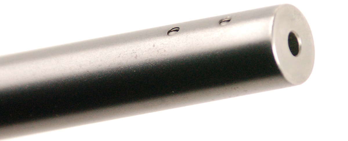

Hi mustanggt-
Your rifle has a matte finished stainless steel barrel.  Typical of the day.
When Winchester starting making stainless steel barrels they did not have a good way to “blacken” them.  The initial attempt was a baked on black lacquer, referred to a “Japanned” finish.  Very black, very shiny, not very durable.  So what they started doing was to bead blast the stainless barrel, then iron plate it, then use a regular conventional bluing process to blacken the iron plating.  The matte surface was supposed to conceal any minor inconsistencies in the plating/bluing process. You can tell these barrels b/c the muzzle was protected during plating and is always bare stainless.  Also, sometimes the plating will flake off revealing a bare spot of stainless steel (as in the pics below).  They’re also stamped with the letters “ST” under the barrel.
Many of the early (1935-1937 dated) M70 220 SWIFT barrels were made from regular Winchester Proof Steel which was polished and rust blued, but thereafter to my knowledge they were all made in stainless.  Late in production the factory adopted a process to directly “blacken” the stainless steel and those barrels are also polished smooth but the finish is kind of a duller/grayer color than their regular blue.  In the 1951 time frame they all have the matte stainless finish as on you rifle.
