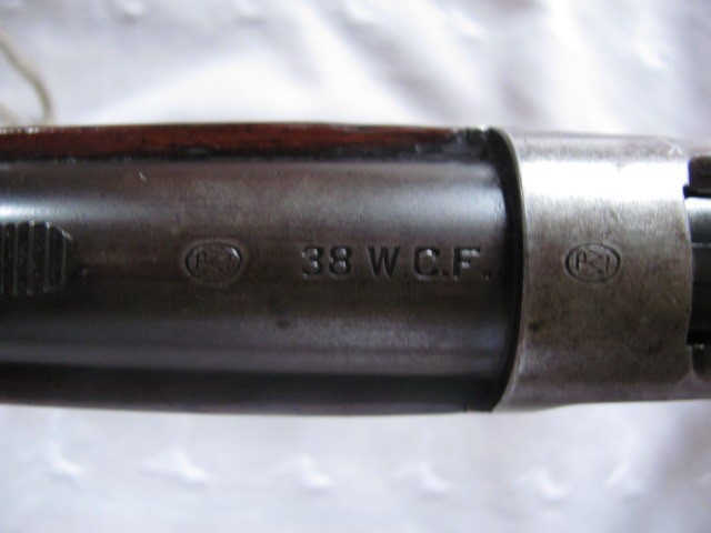

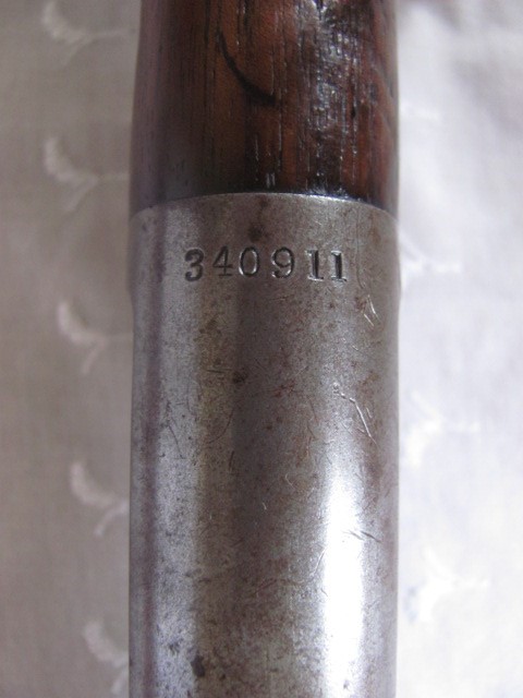

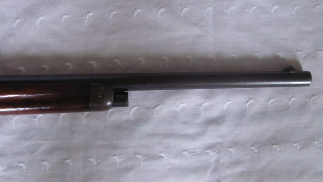

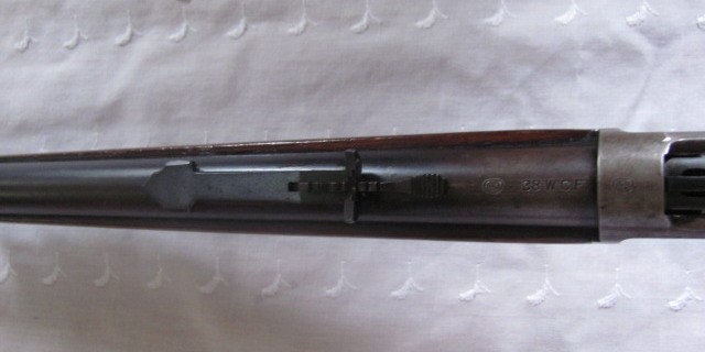

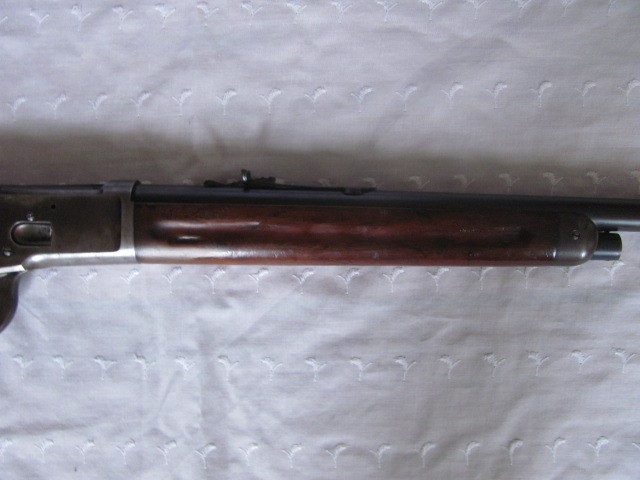

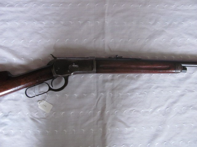

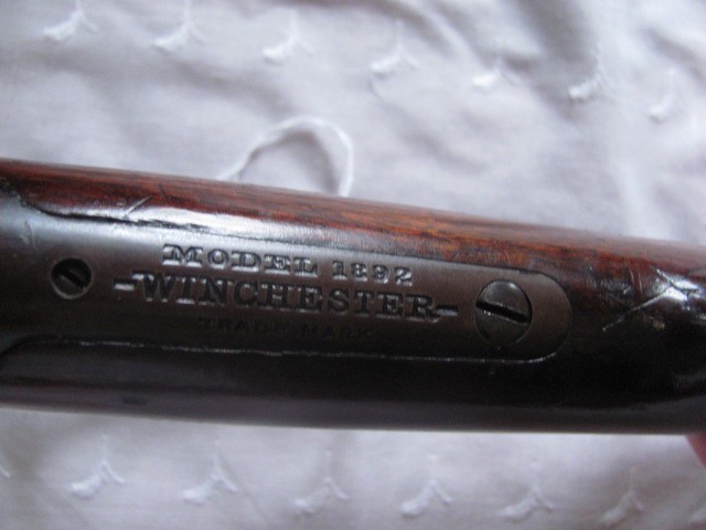

I first captured this rifle with SN 340911 when it was for sale on GB out of Sherborne, NY.  It was a cut down round barrel in the original 38WCF caliber.  Both the caliber stamp and barrel address were located on the top of the barrel as they should be in this SN range.  Now the rifle is being offered as a full length barrel and magazine in 44 WCF BUT the caliber stamp is on the left side which is not correct.  The front and rear sights are from the original gun the wood has also been switched out. Photos of the original gun are attached.
Buyer beware yet agin!!!

From a collectors standpoint the value is zero since so many things are not original.  As a shooter it is probably a $600 cowboy shooter gun that 98% of the people would never have any idea it is not “correct”.  And to them it doesn’t matter.    The “turd in the punch bowl” is that it is being presented/priced as if nothing is to question.
