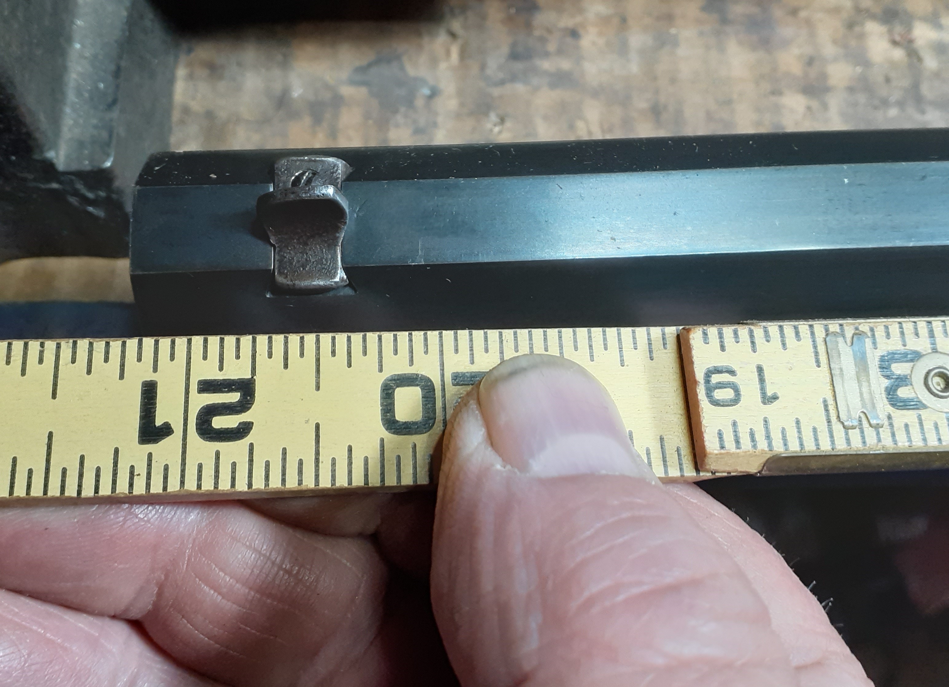

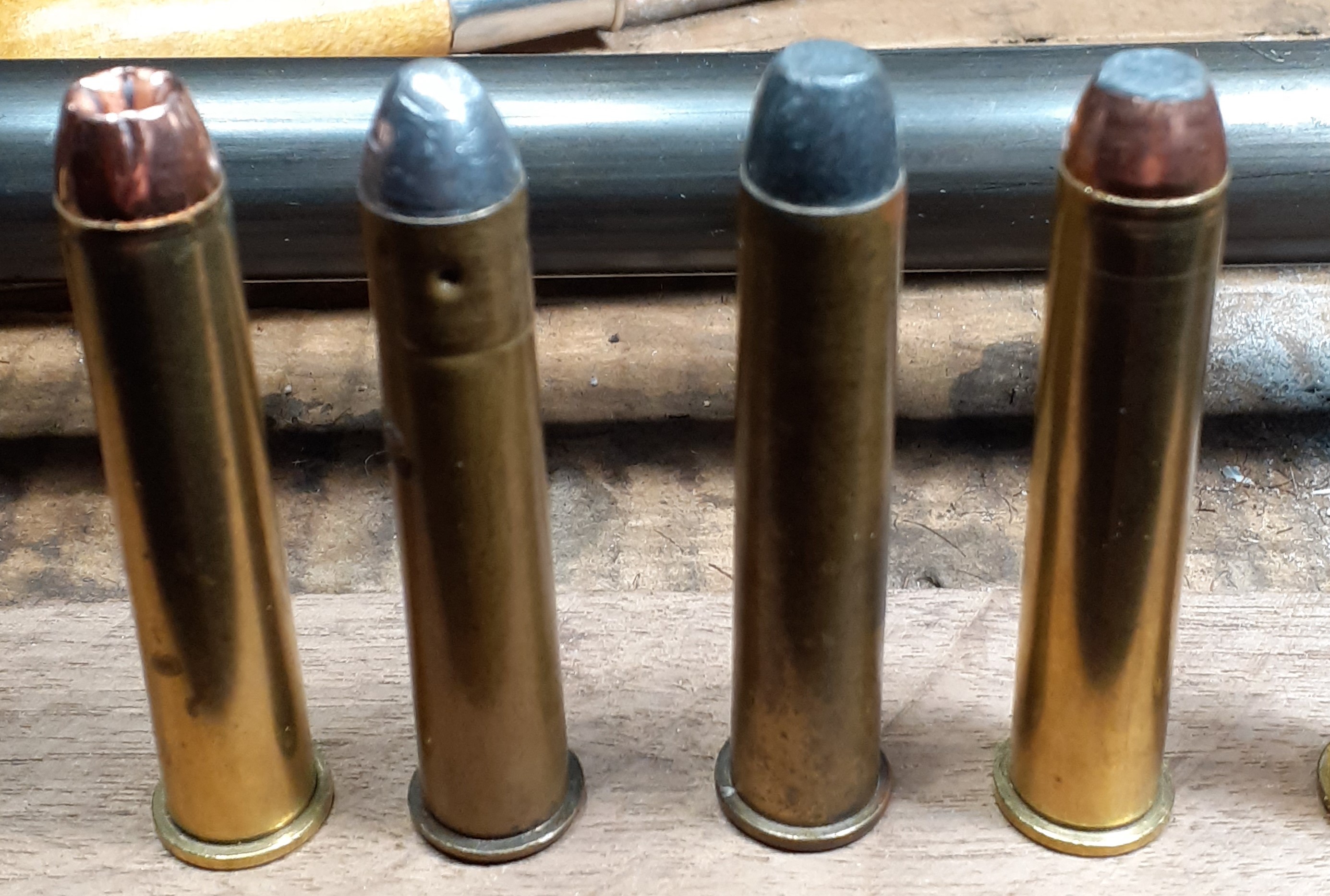

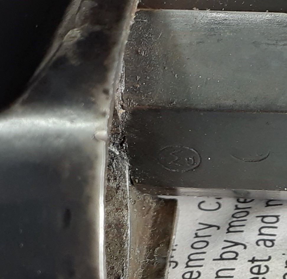

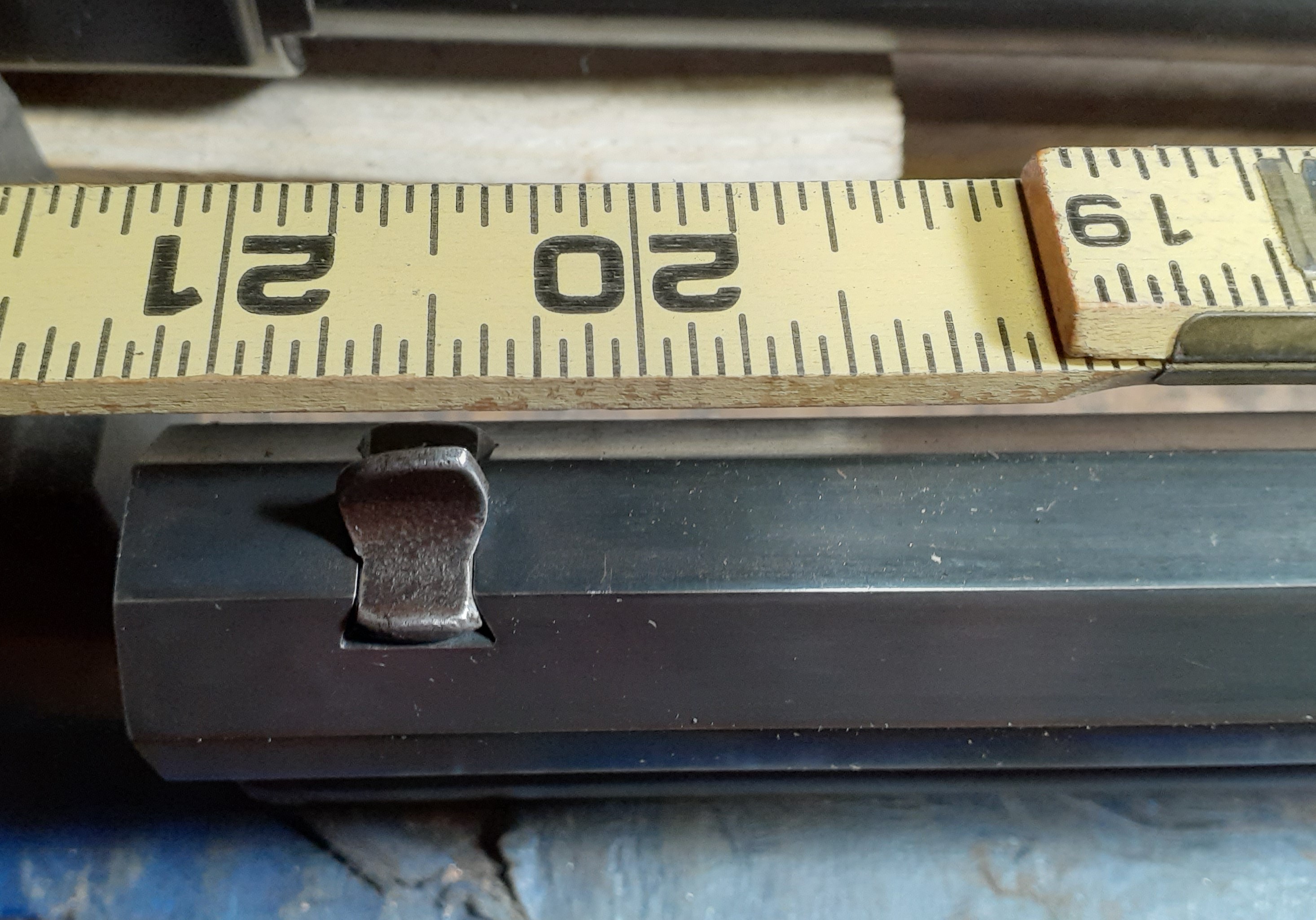

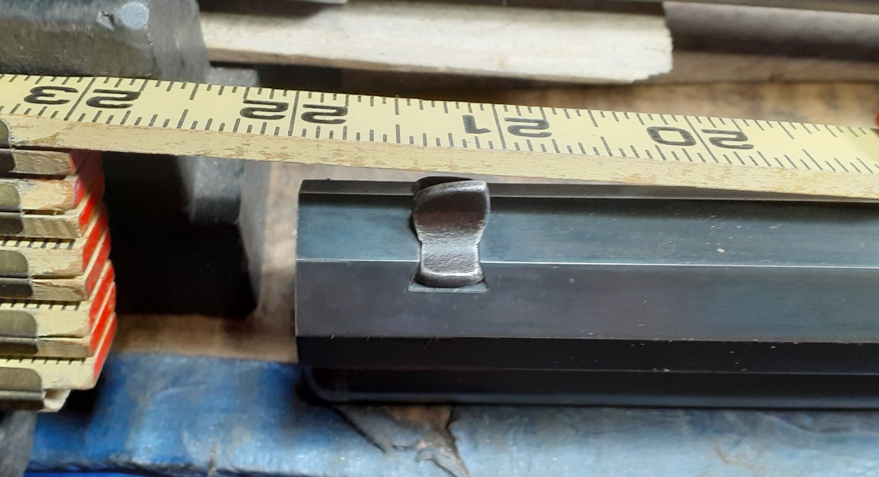

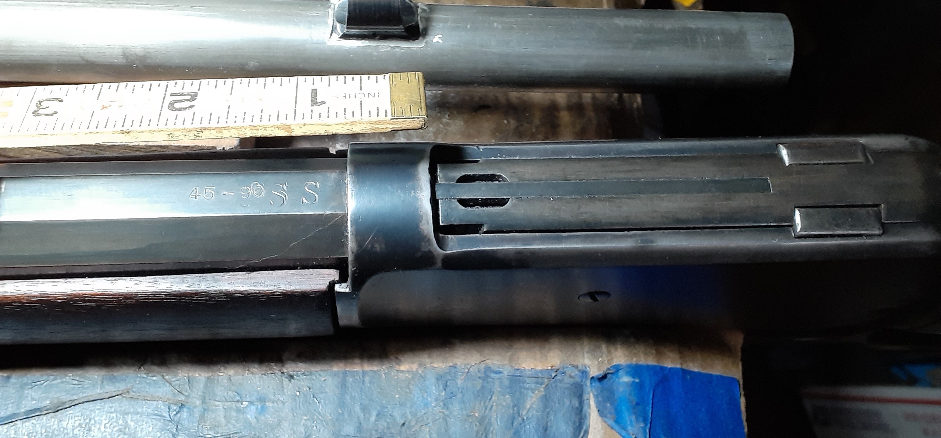

  With a  stick rule. A  Winchester barrel  length in manufacturing is  overall length,  to  the cartridge rim. This is  22 ” from  the cartridge rim.  the length from the muzzle face  to  the shoulder  is 21 1/4″- that  would  be a short  rifle barrel-  as in the above  web site sale  ,straight octagon, 15/16 th”–every  dovetail and  cut  was  factory 1886,  in  the  white , has a  machine surface, oval proof. the  two center cartridges are 45-90 WCF  on Rem-UMC  300gr  express  rifle cartridges,  the Rem is  factory, other a reload.  Compared to  the 45-90 SS cartridge  with 45-90  case   squeezed  to a .451  bullet. .07  thousands   smaller  than  45-90 WCF bullet at.458.,see why it  was  not used.20221028_12164117761.jpg20221028_12172517760.jpg20221028_12173317759.jpg20221028_12174417758.jpg20221028_11104117747.jpg20220919_19404017371-1.jpg

Without re reading the entire post again, this barrel has been modified by someone other than Winchester.

Ralph,
Your pictures of the barrel length clearly show a non-factory cut-down (shortened) barrel.  Additionally, the front sight is too close to the muzzle.

  were it a finished blued barrel  i might agree with you, but  the front sight  dovetail is exactly 1 inch  from  the muzzle  face , right as rain as far as i’m concerned. every  dovetail  extractor cut,  threaded hole  for  the magazine  tube  was cut, threaded  at Winchester factory, who else  used the Winchester oval proof.  In  the white  with machine marks,  the last   teen threads   to  the reciever had to be  triangle filed to seat  to the shoulder and exrtactor  cuts lined up perfectly. you’re beginning to sound like Democrats..I say it’s  factory short rifle barrel, but you’re entirled to any opinion you chose, so am I..
According to John Madl’s book, the edge of the front sight to the muzzle face should be 3/4 inch.  Looking at your photos, it looks like yours is only 1/2 inch.  Not sure where your 1 inch measurement is coming from since your photos contradict that statement.  Sorry, but I agree with Bert.  Muzzle diameter looks too large as well–also indicative of a cut-down barrel.  No hard feelings from my end if you disagree.

I guess I don’t see anything to lead me to believe this is factory. Proof marks clocked to the underside of the barrel, fore-end wood looks wrong and does not match the cap, rounded mag tube plug and odd length screw attaching it, crude caliber stampings, front sight placement, and a very oversized muzzle.
