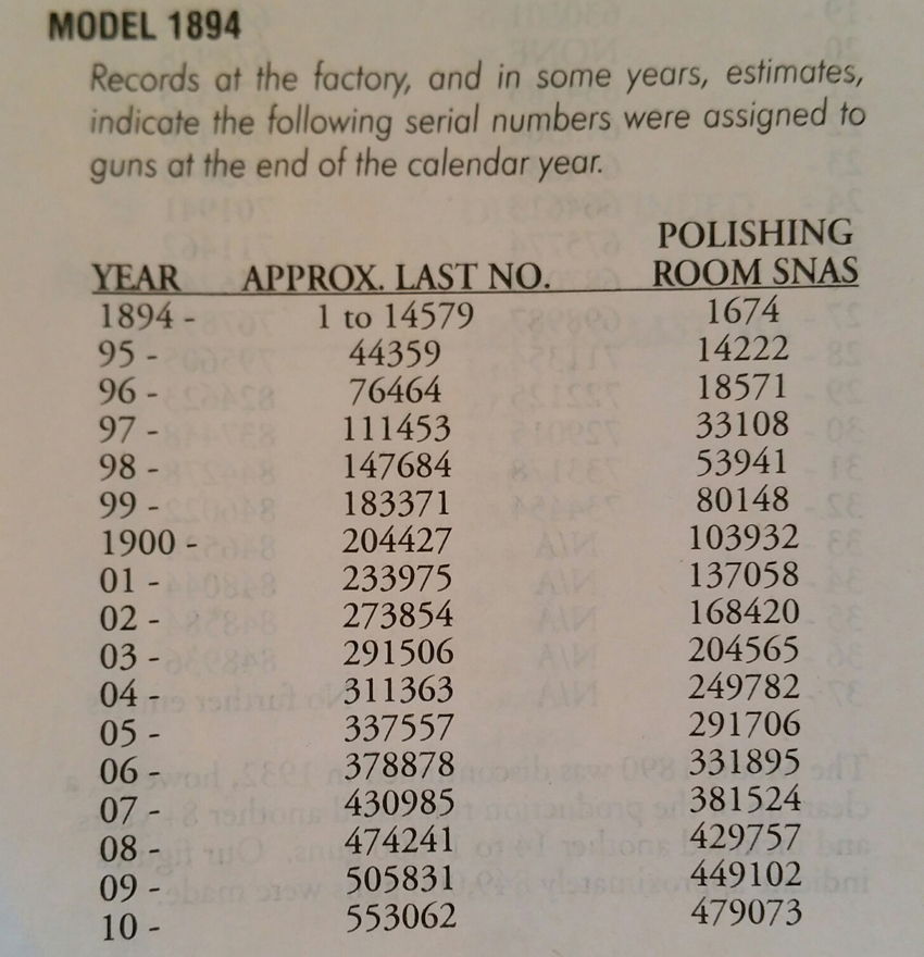

Model PRR Madis Delta
1873 525750 525922 (172)
1876 63911 63871 40
Hotchkiss 84551 84584 (33)
1885 82381 84700 (2,319)
1886 118646 119192 (546)
1887 64842 63953 889
1890 64748 64520 228
1892 103328 165431 (62,103)
1894 53941 147684 (93,743)
1895 19567 19871 (304)
1897 63867 34203 29,664
Lee Navy 13679 & 15000 – 20000 13389 5,290
    Total (123,109)
My final comment to those of you who disagree with using the correct serial numbers is this… blatantly disregarding established federal law (whether you agree with it or not), and intentionally choosing to use an outdated and proven inaccurate list of serial numbers, is both foolhardy and dishonest.  If that is what you choose to do, you are not portraying Winchester collectors in a positive manner.

Call me an outlaw but I agree with you Mike.  Ive expressed some of the same sentiments in prior posts.
And to put this in a more accurate light, the graphic above shows a loss of 159,220 (according to the graphic) firearms from the antique side of the ledger.  As for any gains on the antique side of things may I offer my congratulations to the collectors out there for which it is beneficial.
