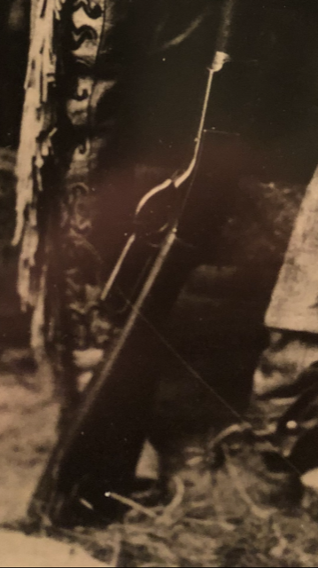

The important part is the side of the receiver to tell if its a 73 or 76. My guess it looks like a 76. If you could get a real high resolution picture or scan and email to me where I can use a photoshop program to play with contrast.  I might be able to tell for sure.

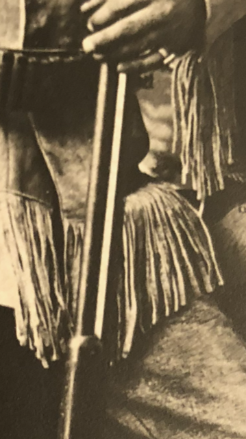

Looking at the cartridges in his belt, I would say it’s probably a ’76.

Compare the length of the frame of the rifle with the length of the lever–looks much longer than proportions of a ’73.

I agree with all the others.  It is a 76.  Look at the length of the lifter.  And the pistol could be a Merwin.  Hopkins and Allen made pistols for Merwin and Hulbert.

It is a 76! Look at the overall length of the elevator and the lever, to long to be a 73.

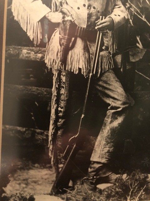

That’s not a Merwin & Hulbert.  Look closely at the last photo.  It’s a Colt 1878 DA with a 7 1/2″ barrel.  See the sharp spur behind the hammer?

I also agree it is an 1876 and the revolver is a Colt 1878. I think I can ever see the what appears to be the Colt Pony logo on the grip and a lanyard ring common on that model although certainly a better resolution would help to be certain.

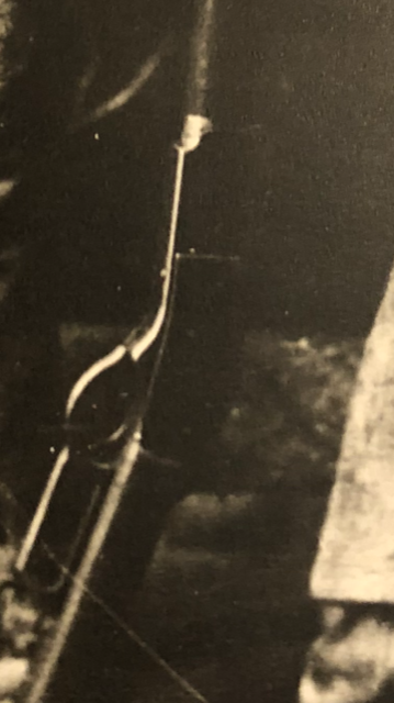

April 12, 2018 - 4:38 pm
Thank you for the help, I do believe it is a model 1876 based on the shells in the belt and the opinions of the rifle.  I attached a close up of the receiver showing the placement of some screw if they tell anything.  Thank you also for the information on the pistol.  I didn’t want to hijack the forum asking about a non-Winchester firearm.  The man in the photo was an avid buffalo hunter and spend most of his time in the Arapaho Nation as a government surveyor.  The only firearm I have of his is a #2 Remington Rolling Block.  Unfortunately, my late father regretfully chose the rolling block over the Winchester in the photo at age 10 (1940) because it looked more modern and had 31 notches cut into the leather sling (now lost).
So in looking to replace the 1876 what would be the ideal buffalo cartridge?  The barrel appears to be octagon when it is compared to the tubular magazine?  What is the price range for a good to excellent condition clean original rifle?  Is this a “beware of fakes” model rifle and any suggestions on spotting one?  On GB I see several that note “missing dust cover” is that a big deal to replace?  Is this a strictly blackpowder rifle or is there a place to buy some light smokless loads?
