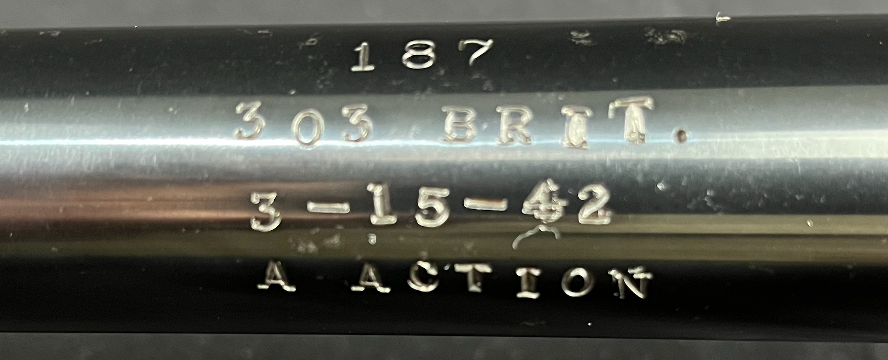

Yes…  The 9×57 should work fine through a M70 action.  According to factory M54 blueprints (where both cartridges were cataloged), the internal parts (magazine box/follower/spring, extractor, ejector) of the 9 M/M were the same as used for 30-06.
In the world of fakery, therein lies the problem… A 9 M/M is nothing but a 30-06 with a “new” barrel.  Ditto the 300 SAVAGE, which is a 220 SWIFT with a “new” barrel…  Anybody wonder why take-off M70 220 Swift barrels are so easy to find?  It’s not b/c they were “shot out”… Wink
As for the 303 British… I don’t know how well it would work either… Seems you’d need at least one slanted partition in the magazine box to keep the rimmed case from jamming, like they used with the semi-rimmed 220 Swift.  But I don’t know about 303 British cartridge OAL in a partitioned M70 magazine box.  OTOH, Winchester made a gazillion British P14 Enfields in 303 during WWI, so I sure they COULD have figured it out (if they ever wanted to…)
FWIW… Here’s a “genuine” 303 BRIT barrel stamp (from the #6 test barrel that was in my earlier post.  The current Forum setup doesn’t seem to let you enlarge thumbnails anymore, otherwise I would not repeat this…
