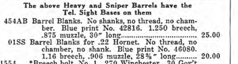

Winchester did, in their parts catalog, offer unchambered barrel “blanks” for the M54 (below), so they were catering to the cartridge enthusiast/developer.  But the barrel on your M70 has the “WP” definitive proof as well as the “circle P” mail order proof, suggesting it was originally chambered in something, albeit not marked.
I’d bet it was a 22 HORNET barrel ordered without caliber mark by someone planning a custom re-chambering…  The “22H” under barrel stamp denotes 22 Hornet.

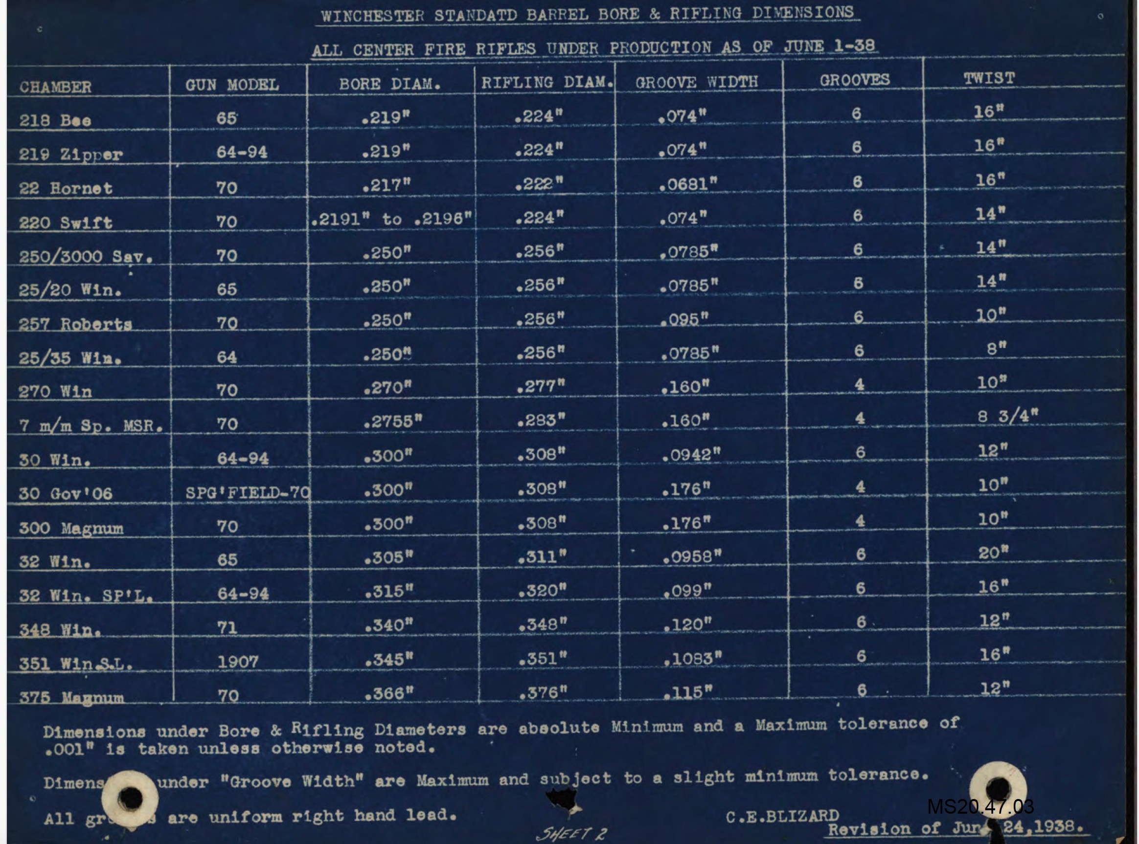

FWIW, the barrel specs in 1938 are in the blueprint below…  22 HORNET bore 0.217″, groove diameter 0.222″, 6-groove, twist 1 in 16″…

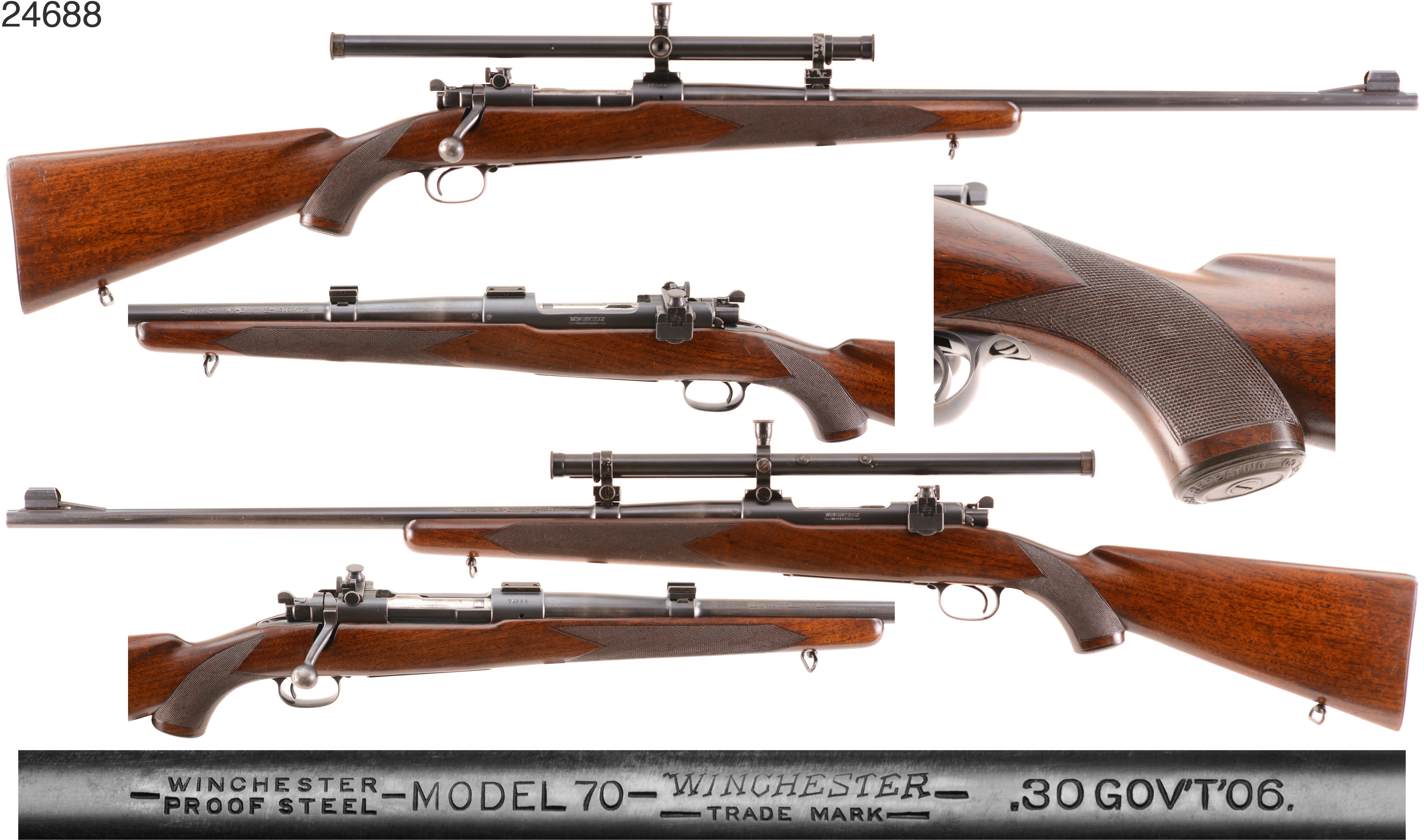

IIRC… Pre-war M70s (without drilled bridge) could be scoped with a Lyman BK code cross dovetail block in the rear sight dovetail and the usual 0.185″ tall block on the FRONT receiver ring…  Kind of like this pre-war set-up I did with a Lyman 438 Field Scope on an undrilled 1939 30 GOV’T’06 Standard rifle…
