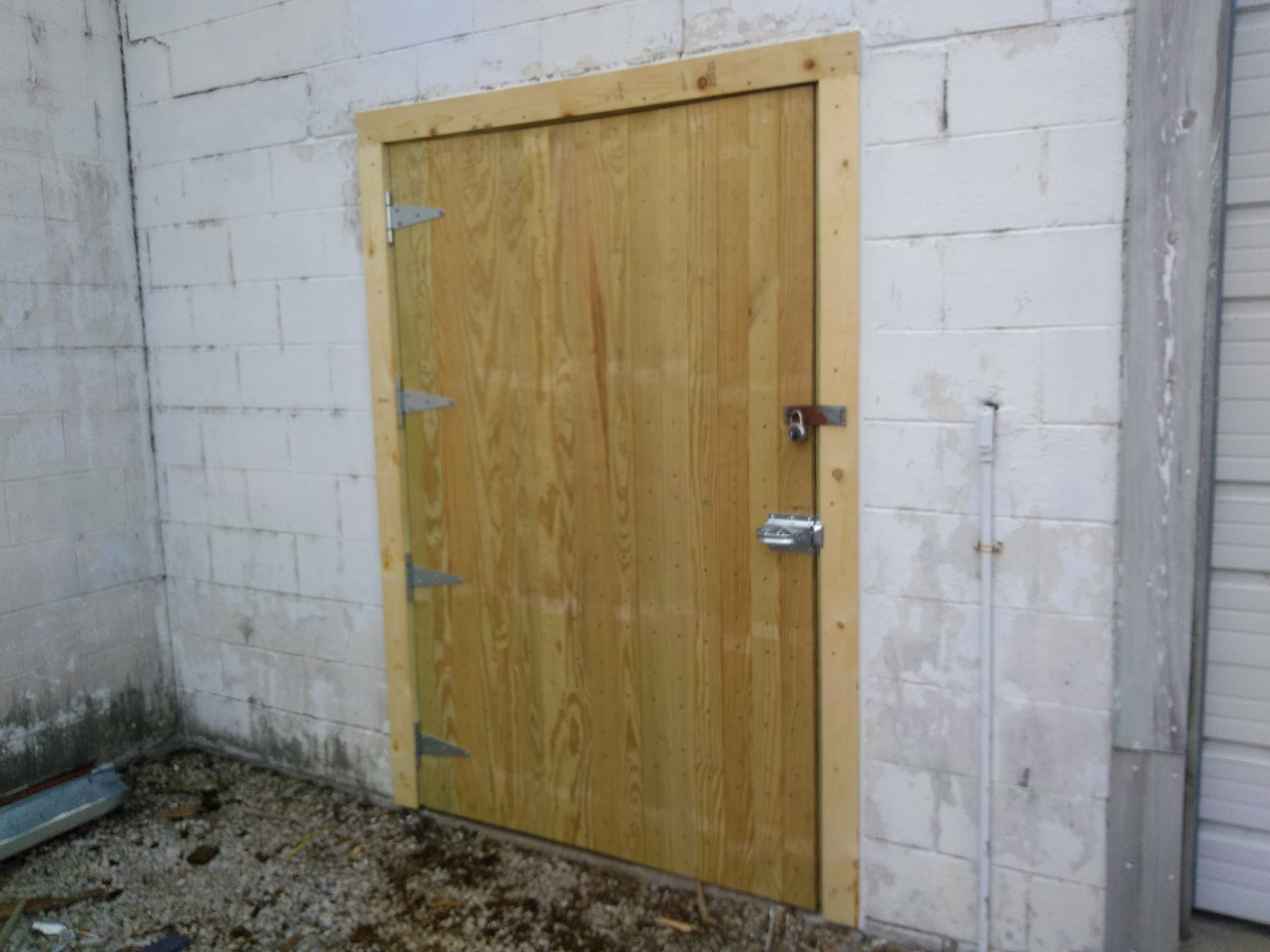

This spring I made a new door for my shed. It was a double layer wood door with each layer layed crossways to the other. I was using treated tung and grove board and my co worker who was a wood worker said its going to shrink when it dries out so I put the board tight to each other. Funny thing when it started to rain for a week it swelled up in the frame and started to bow out. I was really proud of my work up until then.
That’s why ship lap or tongue and groove works so well.  Properly fit it has room to swell when wet and shrink when dry and never show any gaps. Putting things cross grain to each other adds strength but maybe not so good for expansion and contraction?  A good example is then fancy boxes are built for pistols and such.  Often times the end grain is banded with a nicer piece to hide the end grain.  This band is cross grain to the main piece.  In time many of these tops crack because the expansion and contraction due to humidity changes is no longer possible.  Thus the crack.

I had made lapped wood doors out of plain untreated pine with no tung and grove and put them tight together but painted them right away and had no problems but it was the advise I was given and told I should let the wood dry out before I paint.  Now I know better. At least it was a shed door and not a deck. Either way it was a 100% improvement to the looks.

I generally let wood dry inside before I cut it up.  Some times I let it sit for awhile after I cut it.  Even sitting on dry concrete will cause it to cup on one side. Always use stickers between the floor and the layers of wood.  I didn’t realize that the wood was not sealed before the rain.

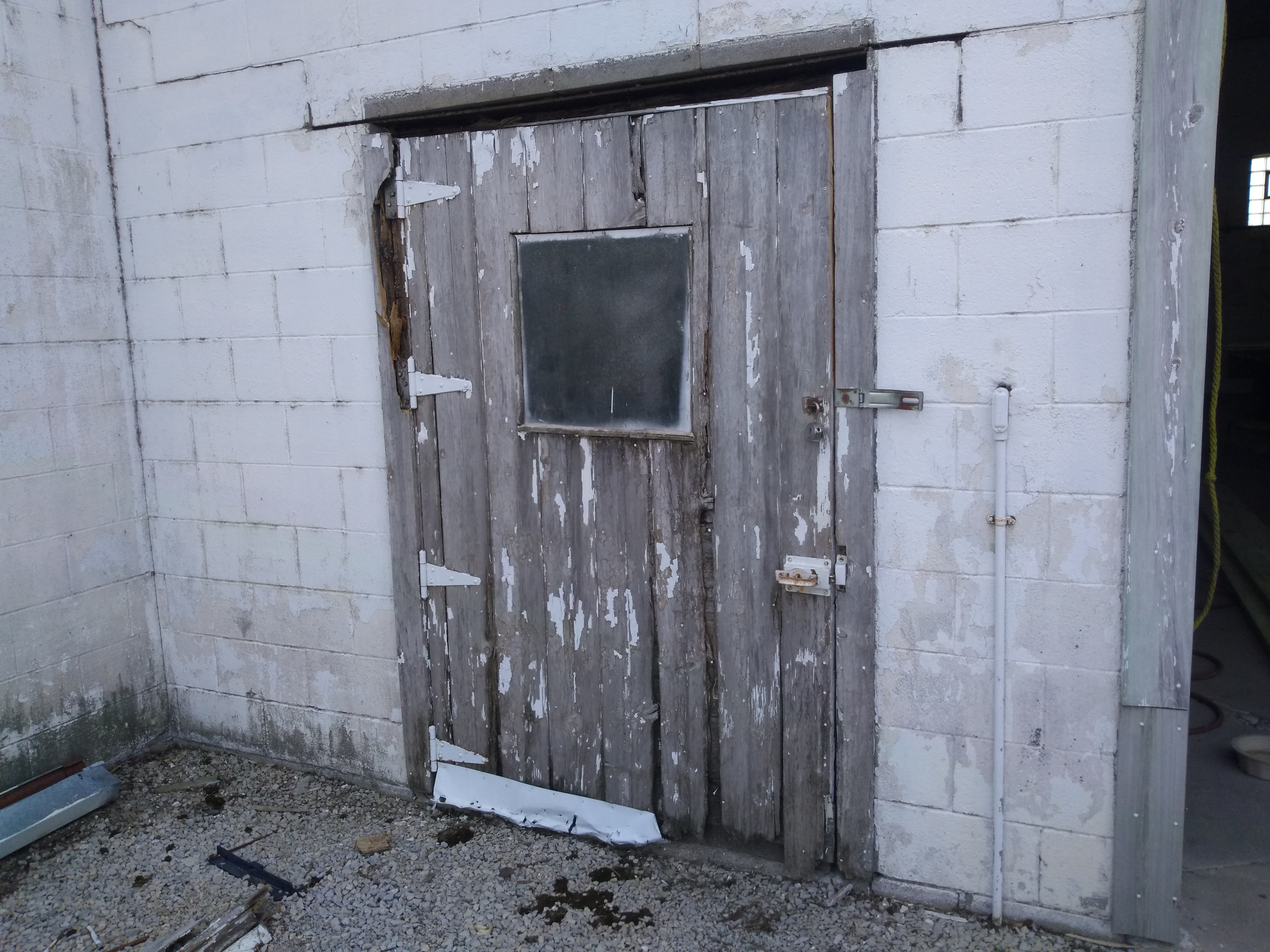

Door looks a lot better than the old one.
