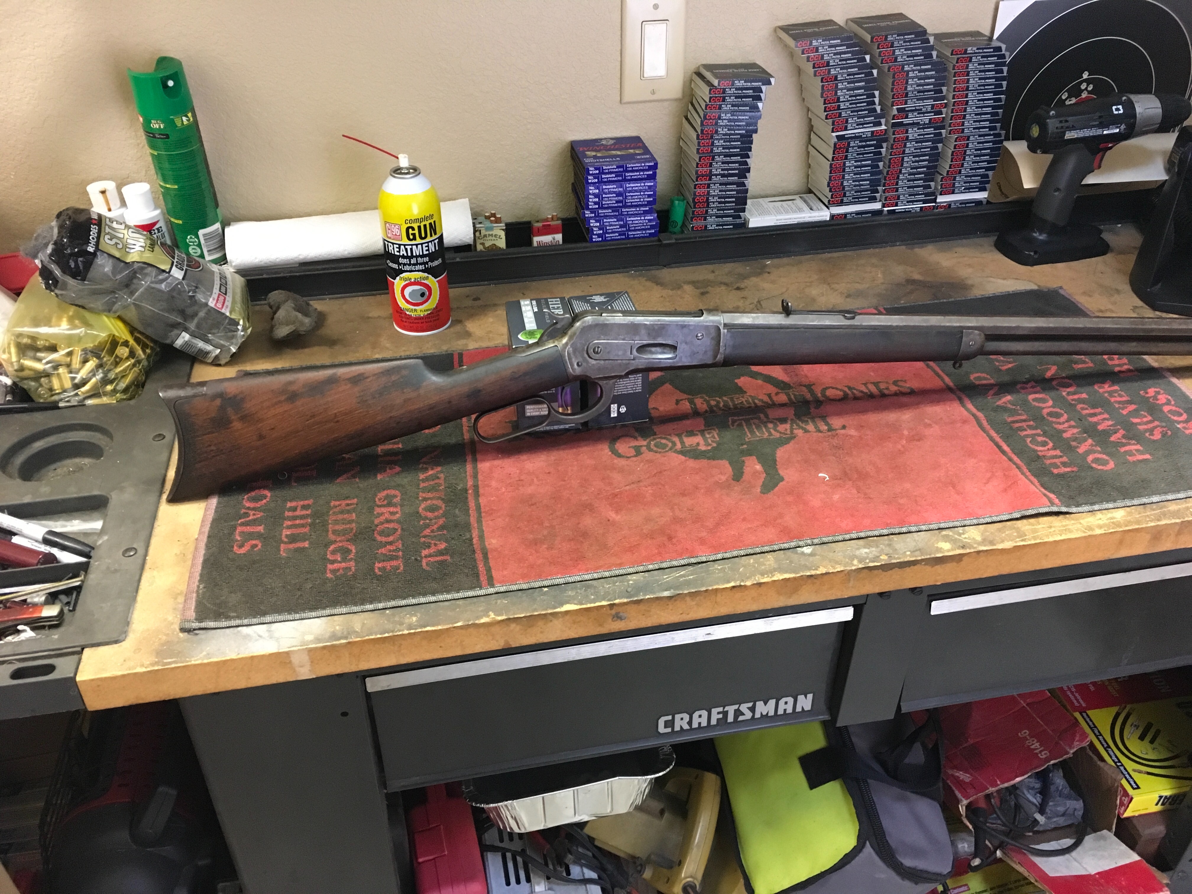

576848CB-E7C9-4269-B8AE-5E1B2D367A20.jpegI know that refinishing a gun generally kills the resale value.  But what about cleaning up the stock a bit.  This 1886 in 45-70 has basically no bluing left and the stock is turning black.

That’s a beauty – I’d leave as is!!!

Hand rub some oil on the wood and then leave it alone.

Perfect as it is….

I’m not sure you’d be able to get that stock to clean up much and if you were successful it would lose some of the character that I admire in it now. I’d give it a gentle cleaning to prevent/mitigate rust and if the wood looked dry I’d rub a little BLO into it. OTOH it may look nice if you clean it up with mineral spirits and apply a tung oil finish. I’ve done that with neglected, oil-stained stocks and have been happy with the results.

The last thing he needs to do, since oil is probably what has turned it black.  The standard treatment for military stocks which are often times drenched with oil is to wipe them with solvent-soaked rags.  Might start with paint thinner or turpentine, but their oil cutting action is weak, so it might take lacquer thinner to have any noticeable effect. I’ve used carbon tetrachloride for that purpose, but like many other effective products it’s now banned by the EPA.

I agree with the boiled linseed oil.  It was used by the factory.  Excess oil running onto the wood over a very long period or water damage usually causes the black areas.  BLO will soak in and refresh the wood.  For those that want to go further add a small amount of True Oil.  If character is your number one preference mild soapy water will clean it and then you can leave it alone.

I went ahead and cleaned it up a bit.  Mineral spirits had no effect.  I went after it with 0000 steel wood and after much effort I can at least see some color and wood grain. Still black in spots, but didn’t want to remove any wood, or at least very little. I didn’t try to remove any dents, just get past the black finish.
i then put one coat of true oil on.  I’ll let it hang overnight and see how it looks.  I don’t want any gloss, just protect the wood.

I understand, but it’s not exactly a high dollar gun.  The bluing is long gone and whatever finish was on the gun was blackened.  Who knows what was put on the stock over the years.  There was no protection.
I picked up some 45-70 shells and I’ll see how I like it after I try it out at the range.
