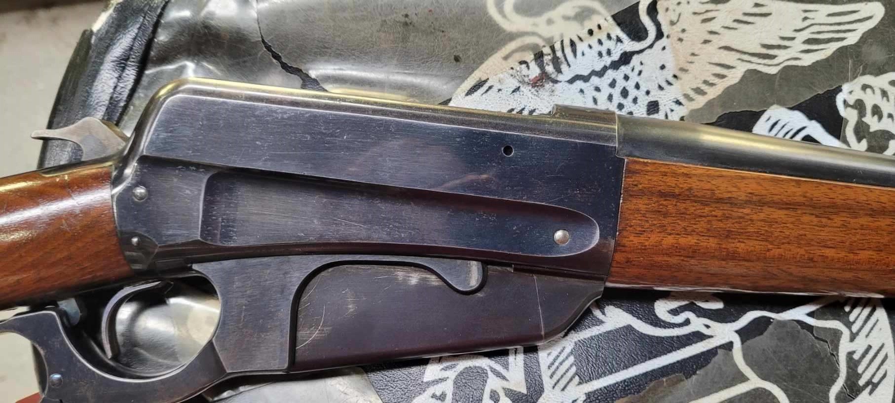

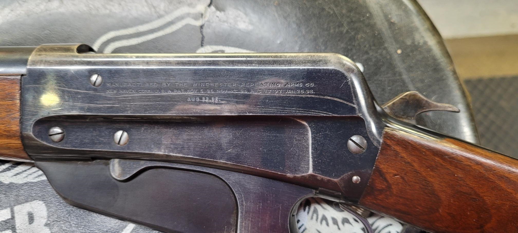

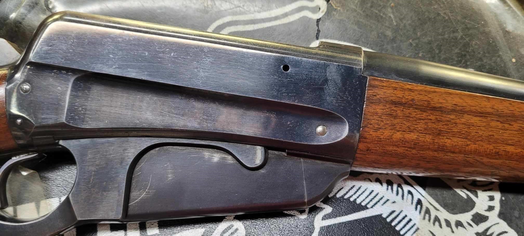

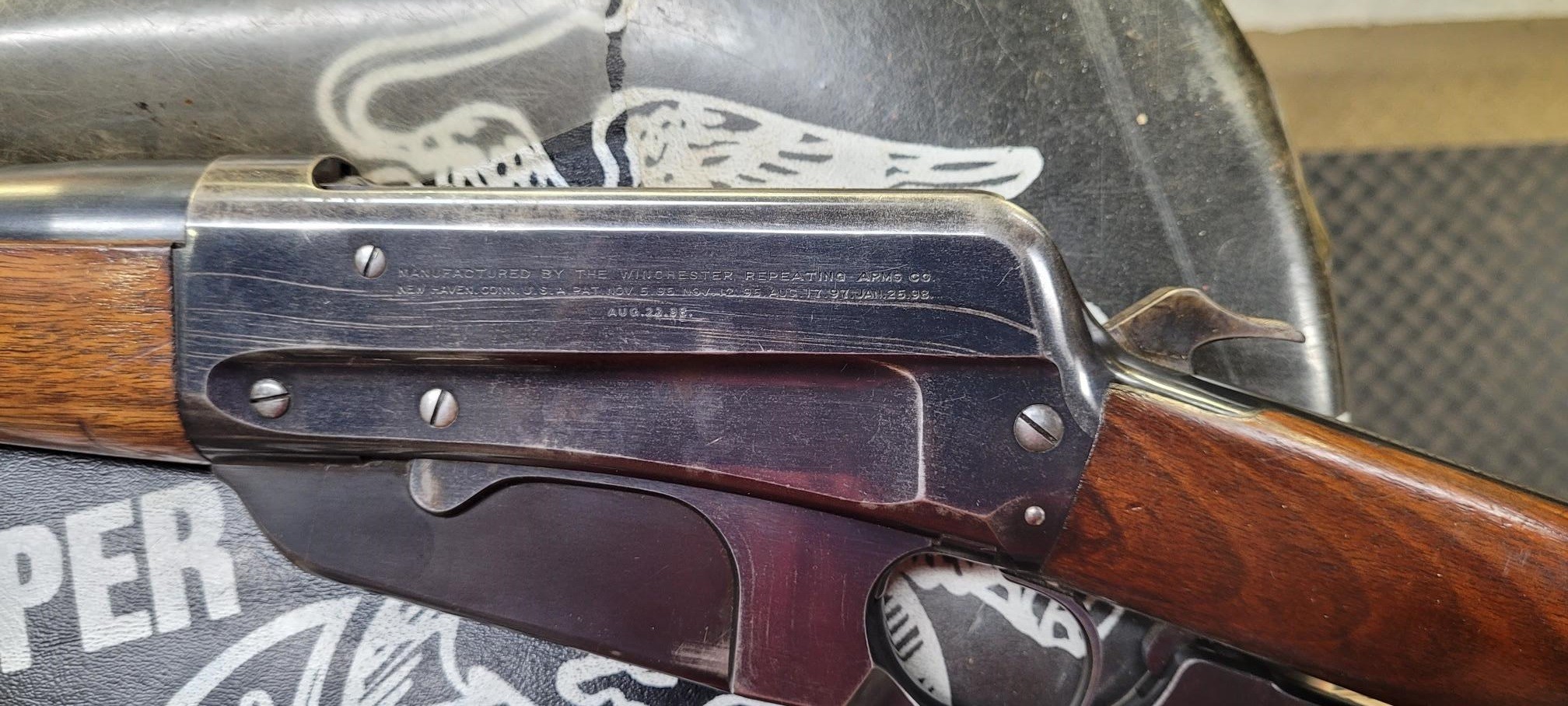

Hi All,
I’m looking at a Winchester Model 1895 (1899 DOM) that the seller claims are “scratches” running horizontally on the left side of the receiver.  I asked him to send me some close-up photos of both sides of the receiver and here’s what he sent.  To me, they look like forging marks/striations and not actually scratches as he describes.  I can live with forging marks/striations; they don’t bother me much and actually prove the finish’s originality.  However, “scratches” of this magnitude would bother me to some degree.  Reading Kassab and Dunbar’s 1895 book, forging marks/striations are fairly common on the receivers of earlier Winchesters, and this one dates back to 1899.  I’m leaning towards forging marks/striations, but wanted to get some opinions from all you experts out there.

Leaning towards a little of both.  To me, the right side looks like scratches in the finish, the left side, the more obvious marks, look to me like forging marks, but there also appear to be some scratches in the finish as well.

Thanks Chris.  The main ones I wanted to draw attention to are on the high point of the left side of the receiver near the patent markings.

I’m with the little of both group, but I reckon that main you you asked about is a scratch.

I don’t remember seeing forging striations being so wavy (left side) but someone can comment on that hopefully. I think right side is definitely cleaning scratches.

Forging marks on the 73’s are quite wavy. I would say you have both.

I’d say majority of what you have is forging marks, especially the longer marks. If those were in fact scratches the lettering on the receiver would be disfigured and not still nice and crisp.
Some of those smaller marks, I’d lean to be more like scratches.
Overall a nice high condition beautiful model 95.

Thanks everyone for your assessments. Looks to be mixed bag of forging marks and a few scratches.  To Maverick’s point, the lettering on the receiver is still nice and crisp so leaning towards forging marks for the most distinct lines.  Also, if those largest lines were scratches, you would think they would have extended to the wood, which they do not.  I may be purchasing this model 1895 in the very near future, just waiting to gather funds.  I’ll provide an update after an in-hand inspection.

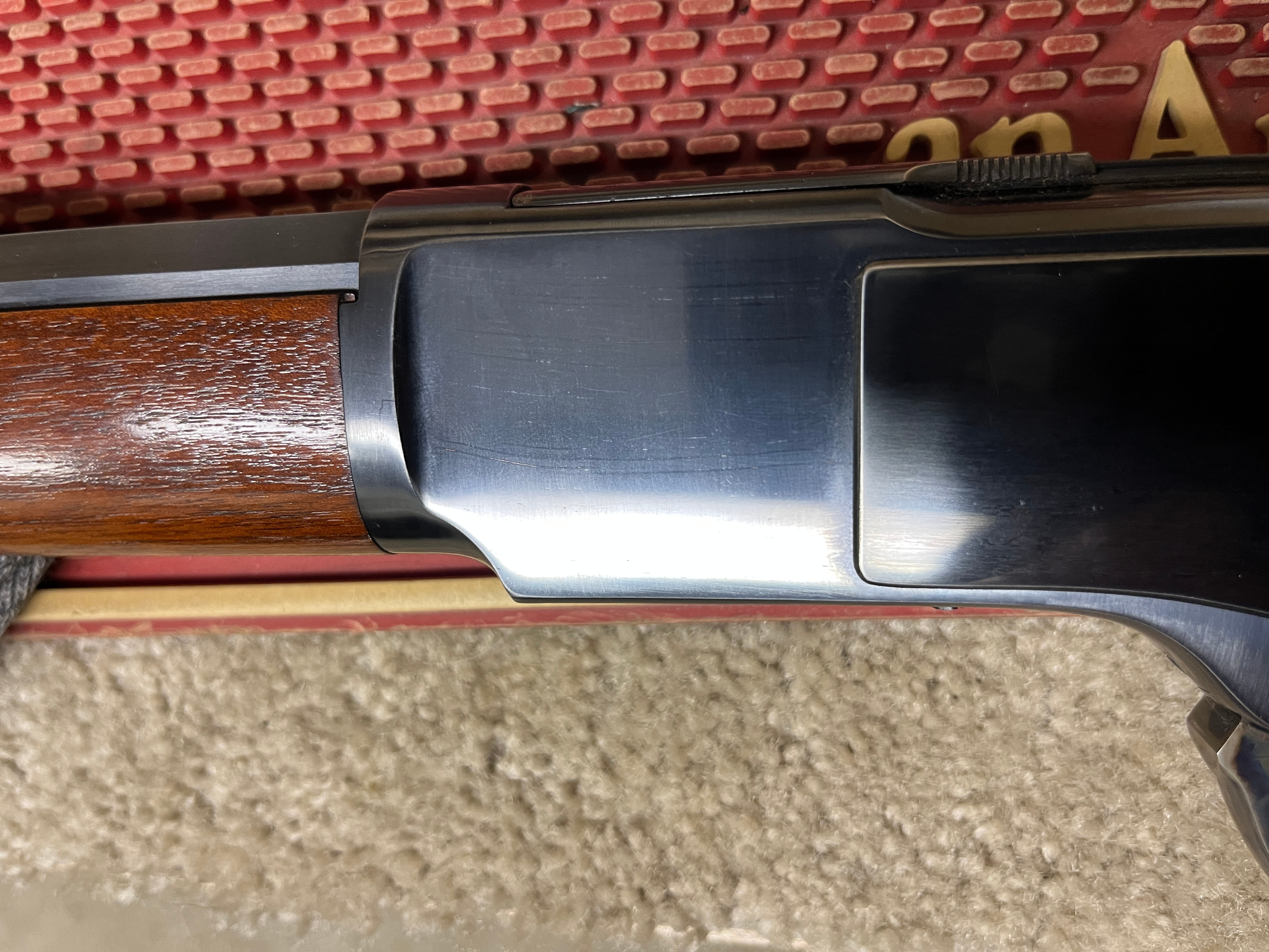

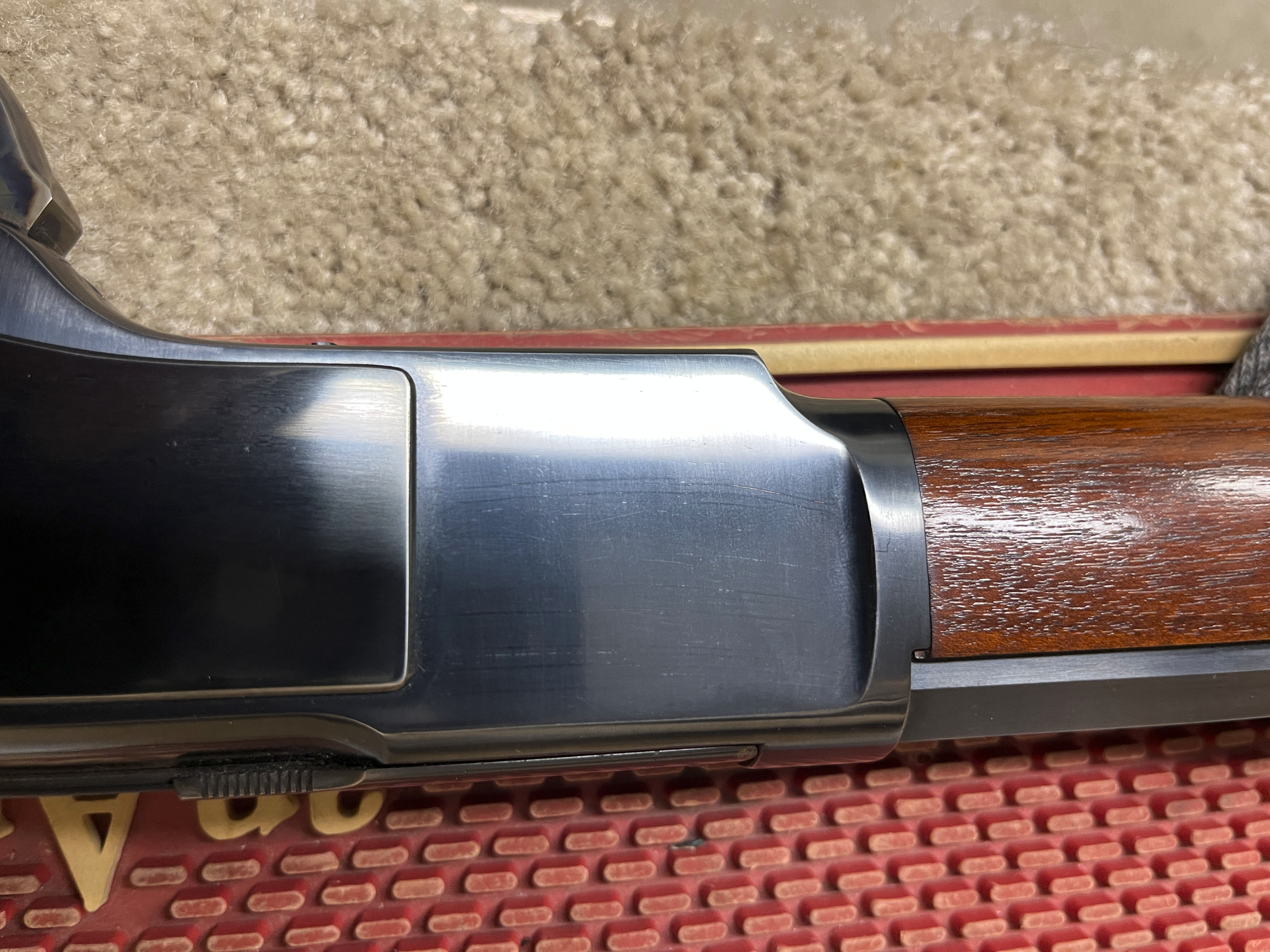

Forging lines will show up in refinished guns for the same reason they show up on original guns. It just takes time. Here is a restored 73 from Roger’s that is getting forging lines.

On the left side, bottom of the receiver – is that not lines also? If they were “scratches” I think it’d be pretty hard to scratch both the side and the bottom.

This Winchester 1895 is an excellent example of forge marks.  When I see parallel lines that curve and look like this, I immediately think forge marks.  Not to say there aren’t some scratches since then.  If in doubt, look at the “scratches’ under a high power magnifying glass.  They will appear different if forge marks vs scratches.
