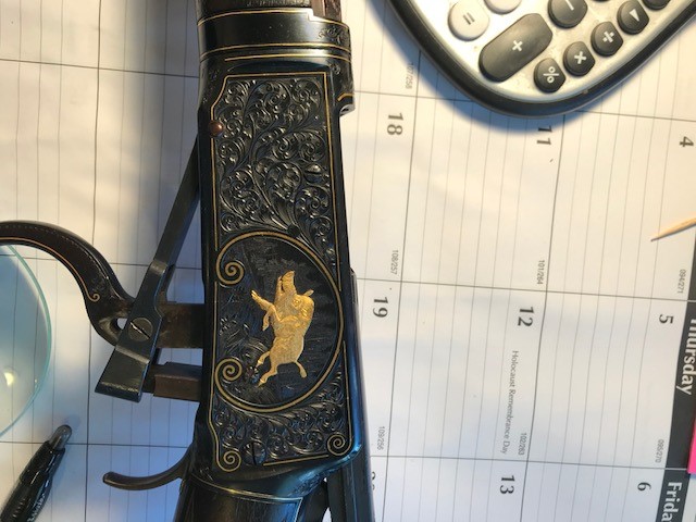

I’m wanting to help a friend evaluate and sell a few guns for an estate and this rifle is a bit of a puzzle to me.
Serial number 118497, T/D, 25-35, half round, half magazine, pistol grip, “deluxe” oil finish wood, checkering, engraved with gold inlay. I did not remove the wood to check for grade markings or assembly numbers. Engraving seems to be very good work but apparently it doesn’t letter as engraved, still waiting for the e-mail from Angela or Jesi @ CFM. I think they wanted to study on it a bit.

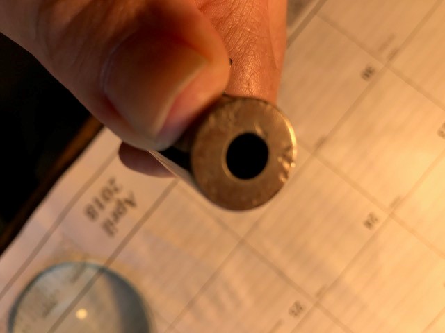

Found a few odd things that push me towards a non-factory engraving job. The barrel blue has a reddish color that may be correct but just doesn’t look right. The muzzle face is blued and has had some pitting partially polished out (see pics). The engraving appears to be signed on the lower right side of the receiver panel. First character is either unreadable or simply stray marks. Second character appears to be a “G” or “Q” and the remaining characters appear to be “AWA”. Outdoor pics not available today, could not get good image of signature. Rear Marble sight is not correct and the butt plate and other areas are highly polished. The engraving looks like a factory pattern but I haven’t seen enough to be a good judge of this type of work but it seems very good to me. Signature sounds familiar but that happens a lot these days.
What do we have here? I no longer have the rifle in hand but can send more pics and high-res pics to an e-mail.

Beautiful rifle< I have one similar ser#442502. I,ve had it a long time and when I purchased it ,I won,t say who from but He was promoting it as a factory correct ,94. Being in the un letterable range It could be hard to disprove but the old saying prevails”if it looks to good to be true it probably is., and it was . Luckily We agreed on a mutually acceptable price and I did buy it, it,s still a beautiful ,94 for display. Here are a few observations on Your gun in My humble opinion, from the photos You provided. The very first thing is the engraving does not letter nor does the inlay or gold trim, I just can,t imagine that as factory correct. The bbl. blueing is not a factory color, the screws ,I can see, have been turned indicating this gun has been apart, which would be very unusual for a piece in this condition. I see a few other marks that look to have been finished over. It is still a nice restoration and enhancment job and makes for a beautiful display gun.

Beautiful rifle< I have one similar ser#442502. I,ve had it a long time and when I purchased it ,I won,t say who from but He was promoting it as a factory correct ,94. Being in the un letterable range It could be hard to disprove but the old saying prevails”if it looks to good to be true it probably is., and it was . Luckily We agreed on a mutually acceptable price and I did buy it, it,s still a beautiful ,94 for display. Here are a few observations on Your gun in My humble opinion, from the photos You provided. The very first thing is the engraving does not letter nor does the inlay or gold trim, I just can,t imagine that as factory correct. The bbl. blueing is not a factory color, the screws ,I can see, have been turned indicating this gun has been apart, which would be very unusual for a piece in this condition. I see a few other marks that look to have been finished over. It is still a nice restoration and enhancment job and makes for a beautiful display gun.  P.S. Oh yeah and the corners on the oct. bbl. are not sharp and have been sanded at one time.

I do believe your assumptions are correct. I have never seen a “Wild Boar” depicted on a Factory Winchester Engraved gun, but that doesn’t mean a genuine one exists, but I doubt it. Also the barrel engraving does not look factory to me at all, especially around the caliber marking.

From looking at the pictures the color of the receiver & barrel are wrong and the engraving is not Winchester. Posting higher resolution pictures in better light would help.

Thanks, gentlemen. Good observations. I really liked the boar on the left side of the receiver but can’t say I’ve ever heard of another. Haven’t heard back from CFM but I don’t think there’s much chance the engraving is factory; they were wanting to look at something a bit closer before they wrote it up. The T/D, half-round barrel, half mag, checkered & oiled stock do letter so it was an interesting rifle even before the apparent restoration. The wood is a bit more worn than the rest of the rifle but I didn’t want to tie up the bandwidth with more pics.
I must admit, at first glance the quality of the engraving sure got my attention. I wanted it to be something that my eyes were trying to tell me it wasn’t. I may be able to use it for eye candy at the upcoming TGCA show, may even find it a new home. Must admit, I have no idea where to price it. Any suggestions?

The serial number on that rifle is not listed in the ARMAX survey as one of the (336) engraved Model 1894 Rifles.  Furthermore, the purple tint to the bluing on the barrel and the blued muzzle face are positive signs that it has been refinished by an amateur.
