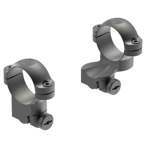

I think if it were mine I would buy a scope like what Mike suggests.  There might be an option to use one of the shorter scopes you have. I don’t know what type of mounts the rifle has but some bases will accept an extension ring.  You would use it in reversed position (if mounted on front ring or as is if mounted on rear ring).  I’m just speculating this may work.  You can go to Ebay and search, “scope extension ring” and you will see a couple of styles.
An early Christmas present is always fun!
LEUPOLD Ringmounts, Ruger #1 & 77/22 Extension - Medium Ext Matte (52306) - Picture 1 of 2Image Enlarger

Thanks for the answers and suggestions.  Someone on another gun forum suggested that if I turned the rear scope ring base 180 degrees I would probably have shortened the width of the base enough to use any number of 1” diameter scopes I have.

That might work.  It would sure be a simple solution.  Good luck!

Reversed the rear scope mount – it works.  Cycled 2 rounds without a hitch!
