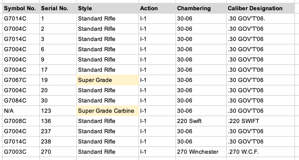

I’m afraid it won’t be much help, but the earliest SG that I have recorded thus far is S/N 19.   It goes against the popular wisdom that the first 100 or so M70s were all 30 GOV’T’06 standard rifles, but the gun does have all the correct early SG parts.  Of course, the fact that the first 100 were standard rifles also does not mean that the first 100 rifles assembled were S/Ns 1 thru 100.

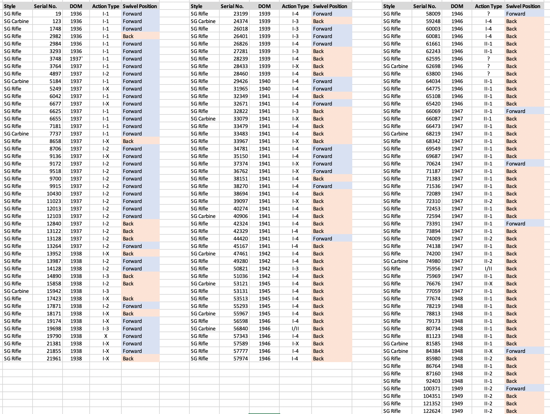

In the interest of trying to give a partial answer to the OP’s original question about pre-war SG serial numbers, I’m attaching below the interim results of a sub-survey I’ve been working on.  It’s a “screen shot” from an Excel spreadsheet, so I hope it’s legible:

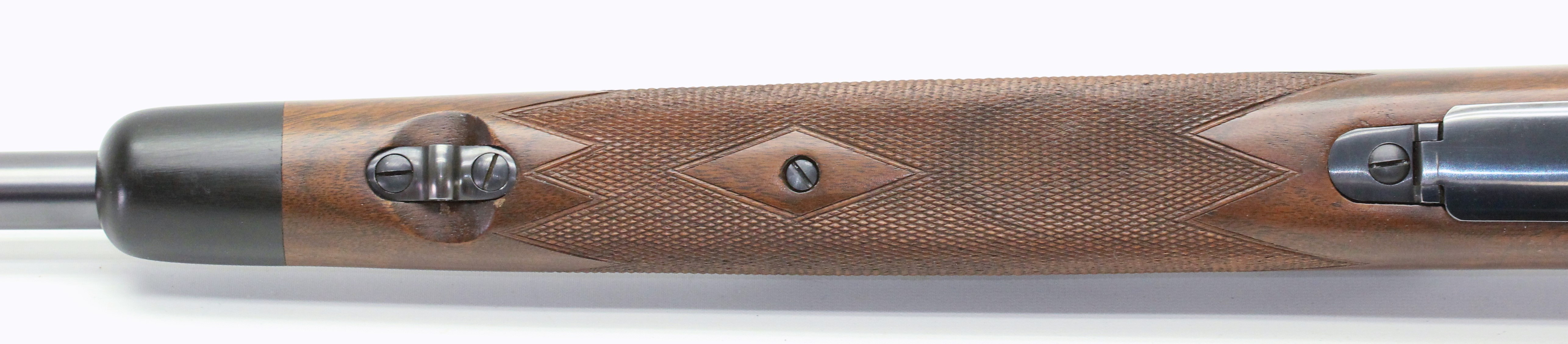

This sub-survey has been intended to answer a different question, namely when did Winchester change the position of the front sling swivel base on Super Grades from this:

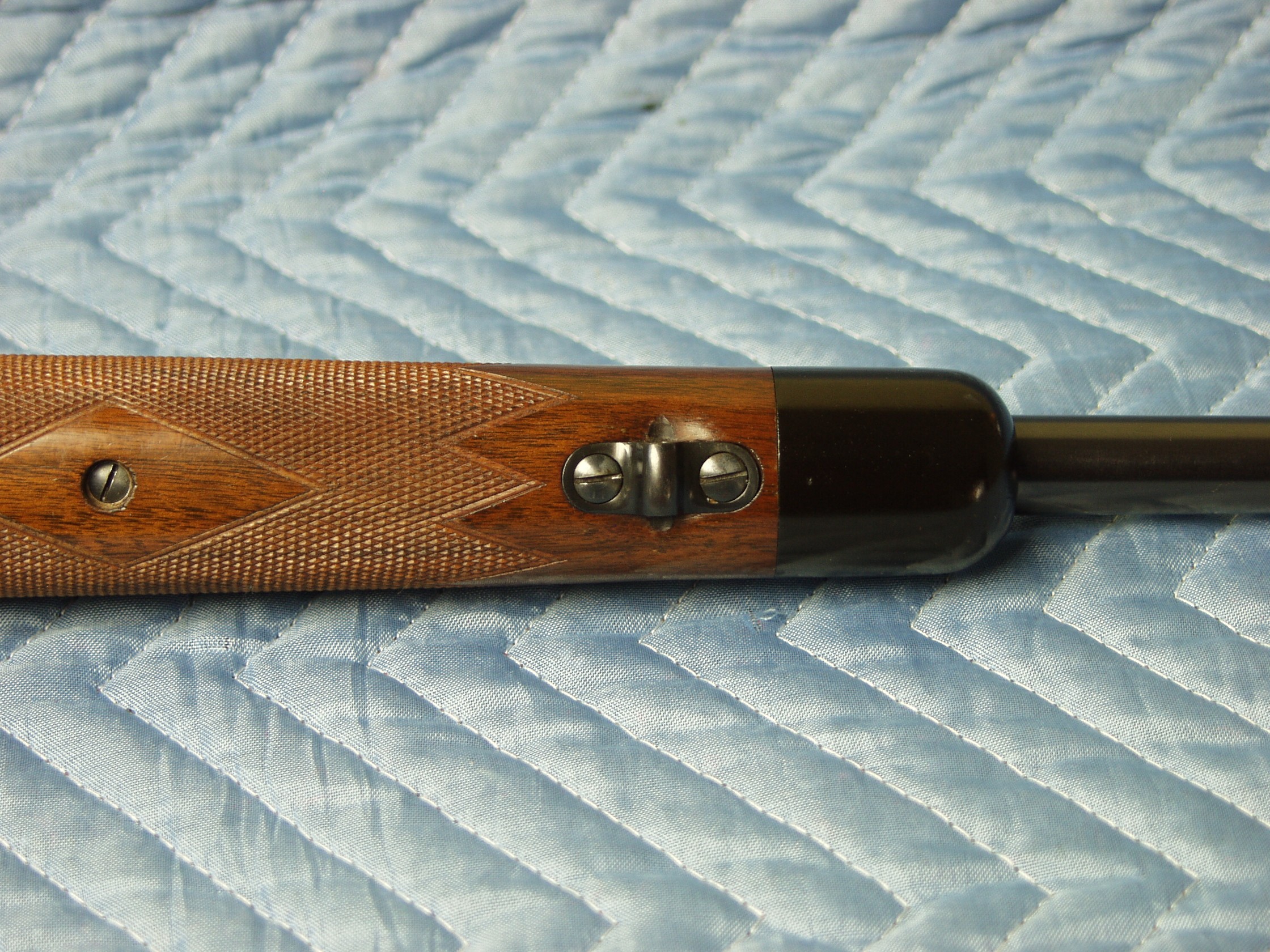

To this:
The spreadsheet does not include all the cloverleaf tang (type I and II) M70 Super Grade serial numbers I’ve recorded, only those where I was clever enough to remember to record where the front swivel was placed.  I also cannot vouch for the authenticity of all these rifles, since most were recorded from on-line sources.  But it does give the S/Ns about about 150 early M70 SG rifles.  Assuming that the sample is random, it suggests that very few Super Grade rifles were made before around S/N 2000.  So the OP’s rifle, if legit, would indeed be a very early one.
Hopefully BB is still checking in b/c I’d like to see some photos of the rifle in question.
As for the question the survey is supposed to answer, it looks to me like the change in swivel position begins to appear in late 1937 to early 1938, after which there’s about a two-year overlap period where either might occur.  Presumably this reflects the time it took to use up existing stores of the older stocks.  On a survey of this type we expect “outliers” due to subsequent “upgrading” or the occasional assembly of early S/N receiver at a later date, but I would tend to question the authenticity of a pre-64 M70 Super Grade with a S/N below about 12,000 that had the later style stock. Wink

Unfortunately the factory production records you seek were destroyed long ago.  The anecdotal observations of collectors are all there is to go on.  I cannot even assure you that the two earlier S/Ns I’ve observed in SG style (S/Ns 19 and 123) were in fact “Super Grades” when they left the factory, as opposed to havng been “upgraded” at some later date.  Same thing goes for the rifle you’d like to establish as “The World’s First M70 Super Grade”.  Without the non-existent factory records or some unshakable chain of custody from 1937 to the present (documented provenance), you cannot know that is a “genuine” Super Grade either.  The most a M70 collector can hope for these days is to establish that any given example is a “period correct” gun.
In my limited records to date, I have recorded the present day configuration 14 of the first 270 pre-64 M70 serial numbers (5% of the total).  Not bad for survey purposes but a long way, as you put it, from the documentation you seek.
