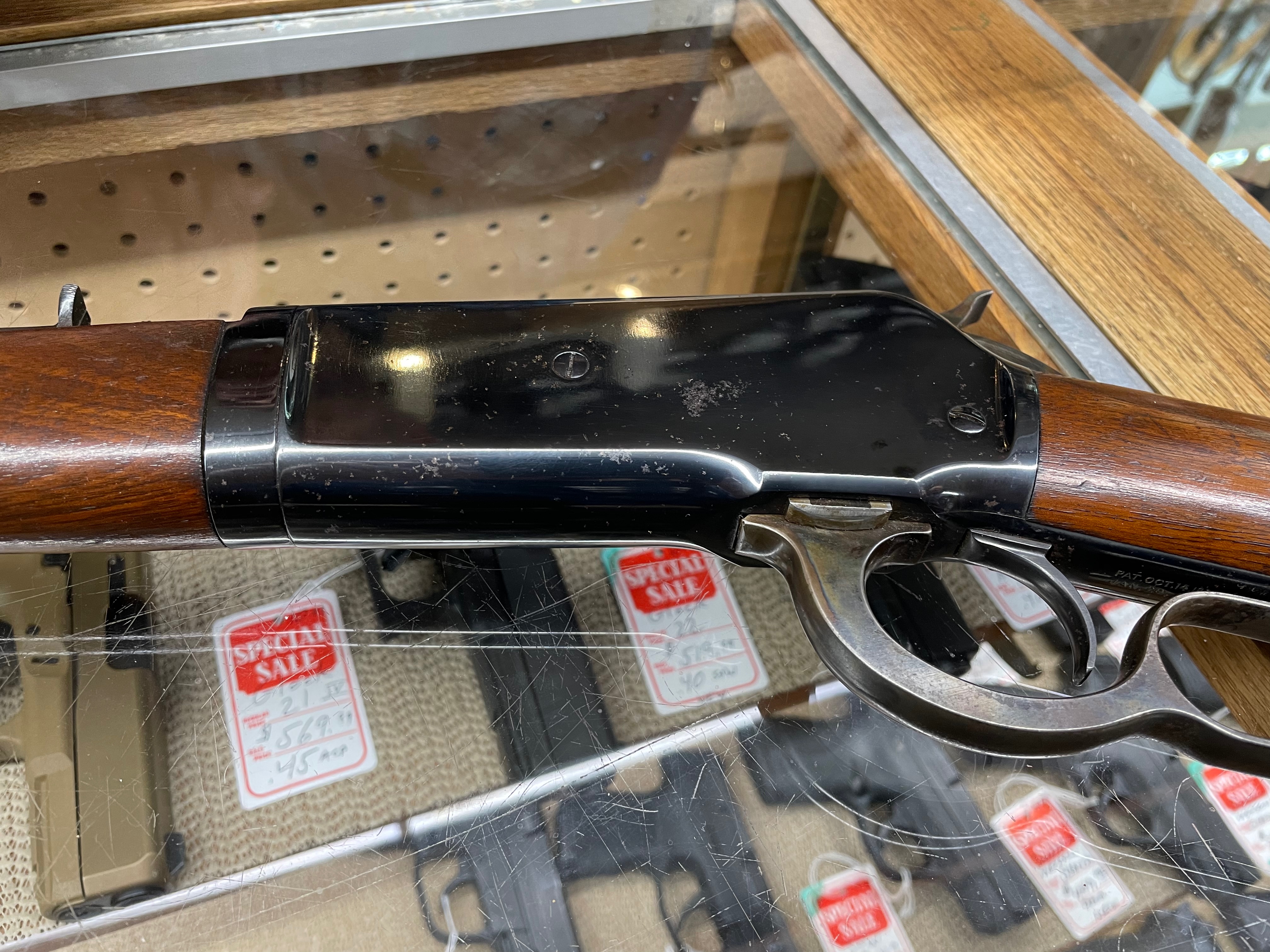

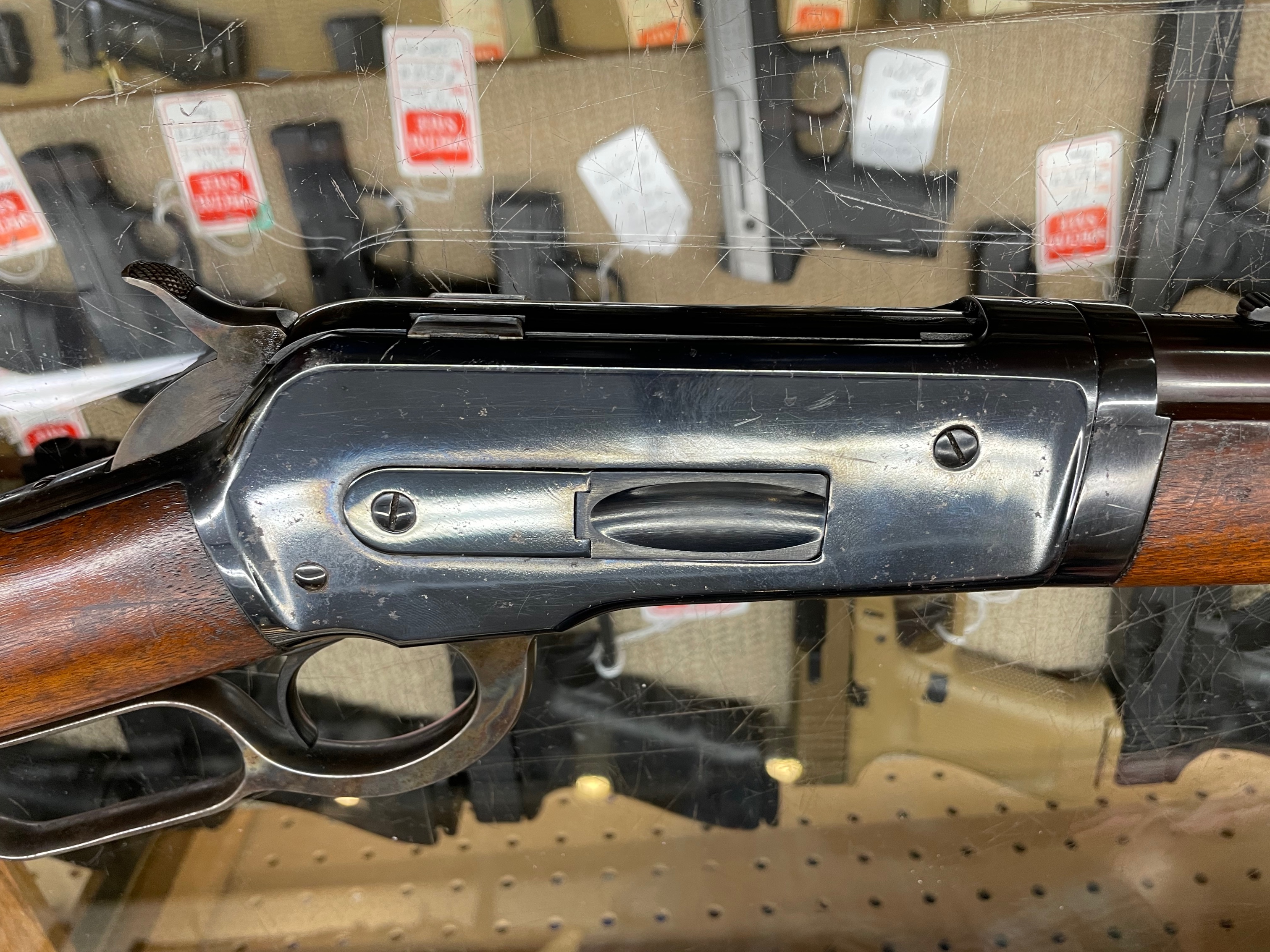

I found this rifle today at my favorite gun store. The gun is in excellent condition in every way. The receiver looks suspicious. It’s in just too good of shape. What do you guys think

Positively a refinished gun.

Looks as though it was spray coated.

absolutely it is. Refinish job like that are the ones you can spot from 20 foot away at a gun show. Dead give away is the barrel and the receiver are different colors. The receiver is black not blue.

The barrel almost always has more blue than a receiver (ie: 90% barrel/50% receiver)etc most commonly from carry wear. If this was reversed it might be less suspect but the black is still evident. It might also be a rebarrel.

The barrel is plum and the receiver polished black. It’s definitely not a sprayed on finish. The first thing I noticed was the sharp edges on the receiver were soft and the screw holes were flat on one side and rounded on the other. You can see other areas where a buffing wheel got too aggressive.
Thank you gentlemen for confirming my suspicions.

Somebody wore out a perfectly good buffing wheel on that gun.

They left a lot of the original pitting before re-bluing and you can spot the pitting pretty much all over the receiver.
