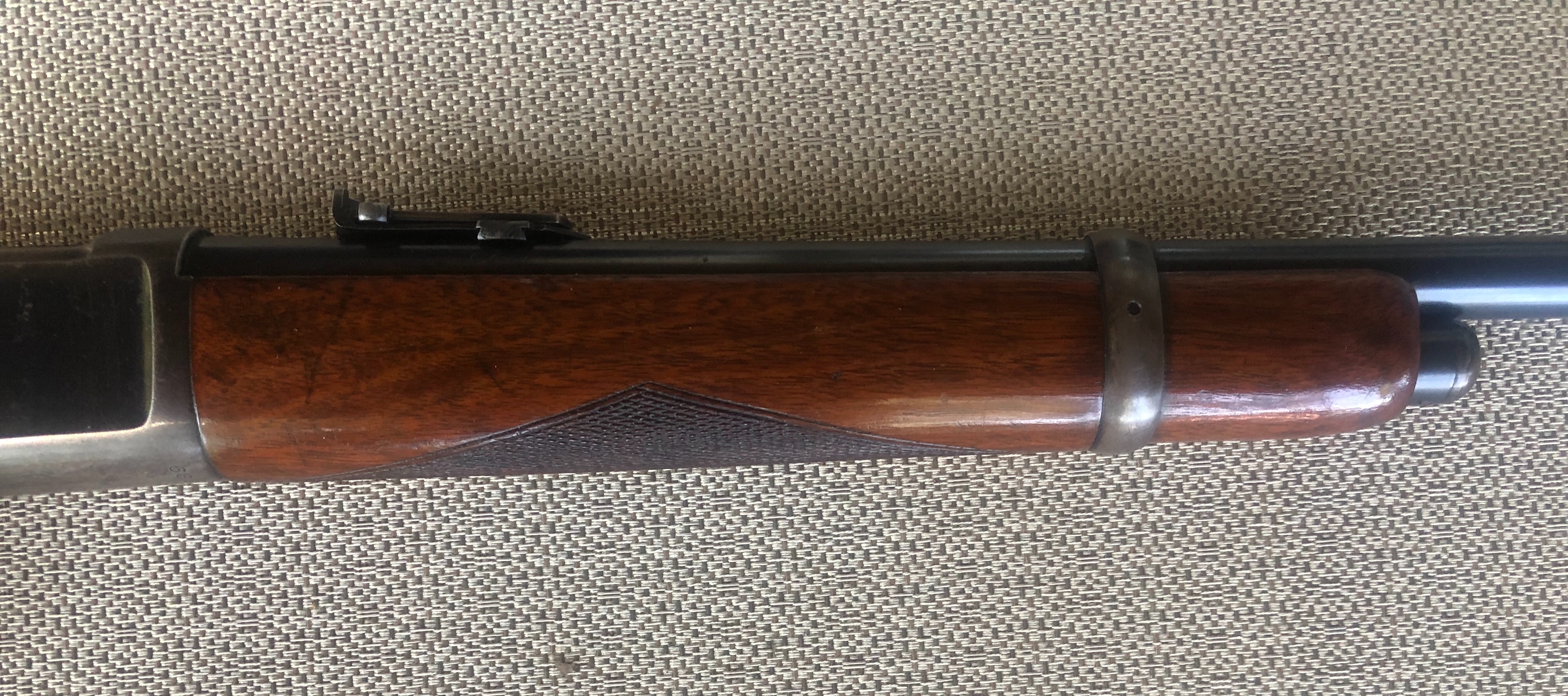

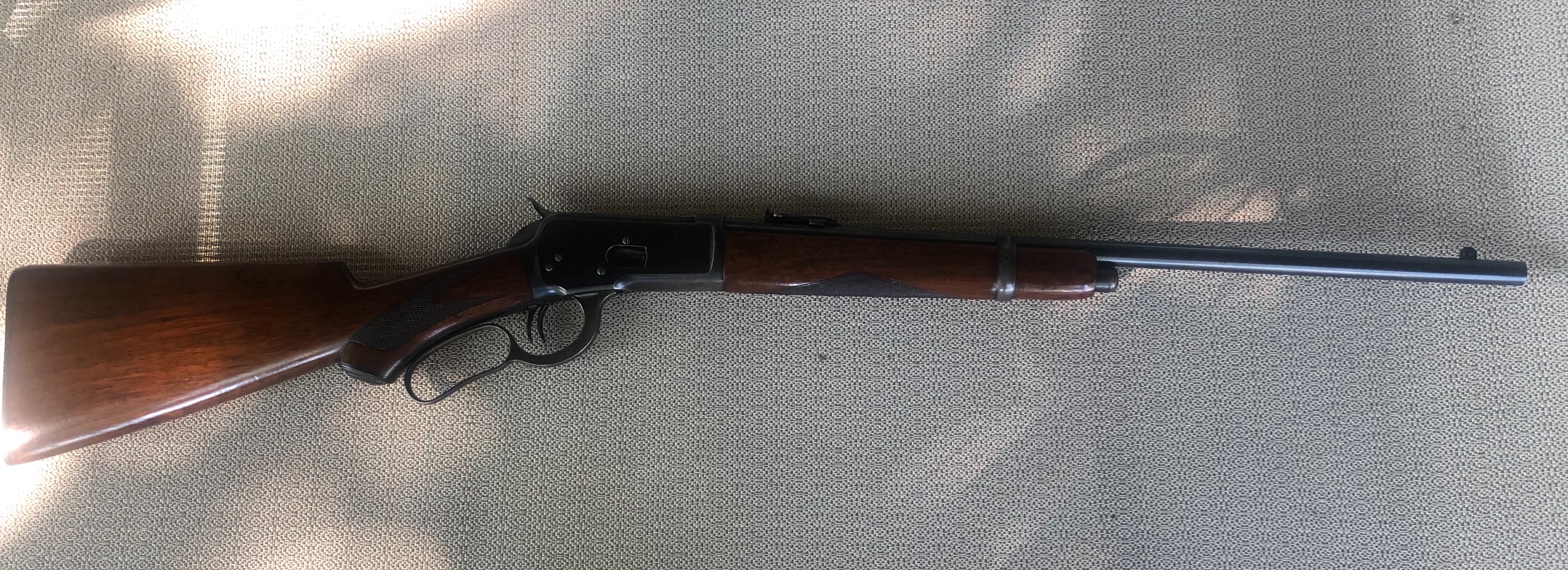

OfflineI’m a lukewarm fan of the 1892 and my limited observation is that the smaller calibers often have lousy bores. Every John Wayne fan wants an 1892 carbine in 44WCF so it’s no wonder my 1892 rifles are a relined 32-20 and a pretty decent 38WCF.
To address your question I can only surmise, based on my limited experience, that the smaller calibers are a joy to shoot and perhaps folks felt the same way 100 years ago. The fancy 25 and 32 caliber 1892’s were often recreational or “back door” guns and the 38 and 44WCF were working guns.
The 1892 Deluxe is indeed a beautiful gun to behold. I love the balance and feel of an 1892 carbine. Someday I hope to be fortunate enough to own a deluxe but quite honestly, I’d prefer a carbine. If I stumble across a Deluxe carbine I can afford in any caliber I’ll feel beyond fortunate.

Devoted specifically to 1892’s, not that I know of presently. Michael (aka twobit) is collecting information on all 1892’s, so he may have a better handle on what he has seen regarding deluxe guns and specific calibers. Just my general impression here, is that anything that is carbine, special order carbine or rifle in 38-40 will be harder to to find, some configurations in that caliber border on the rare side. Thats why most of the 1892’s Ive collect over the years are special order guns in 38-40.
Gerald, thats an awesome carbine you have there.
